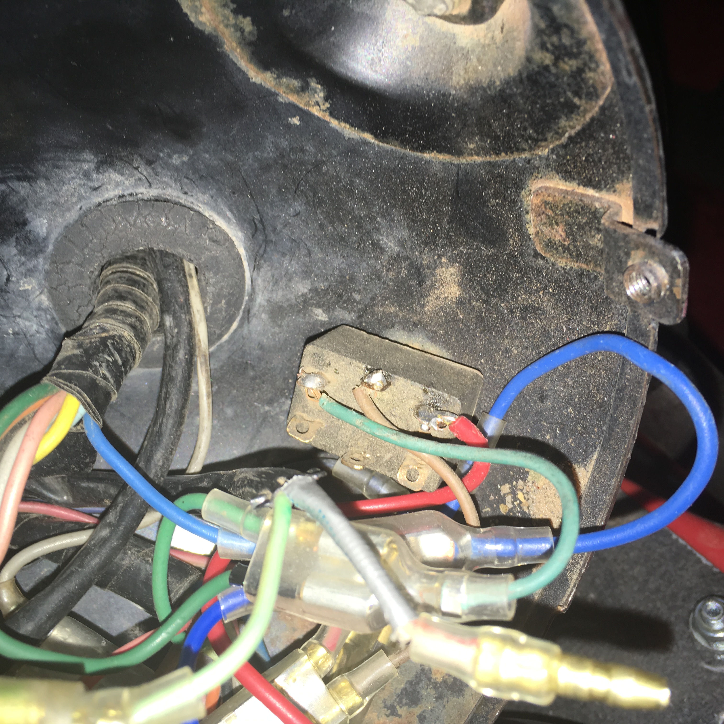

In all this wire pushing & pulling, I found just today that the brown wire recently broke off the AC/DC switch. Had to solder it back on. But, this broken wire is not the cause of my headlight failure. If you look at the previously posted picture of the wiring in the bucket, you can see it was still attached there. Now, back at it, testing again and confirming connections with the wiring diagram. This is getting old....

Um, actually - when I click on the photo of the wiring to look at the full size version. The brown wire is pretty clearly broken free from the solder stud.

Good eye Captain. I missed that on initial examination. It looks like the insulation is melted to the stud and that's all. Perhaps the conductor comes out at an angle and is indeed making proper contact but one can't tell from the photo. Victor, have you examined each and every wire with a voltage presence detector? There may be an occult breakage somewhere.
Well, the wire is back in place now. So I guess my golden question would be,
Is the disconnect of the brown wire sufficient to make the headlamp NOT work?
Good catch Captain! I guess I’ll know in a little while. Victor

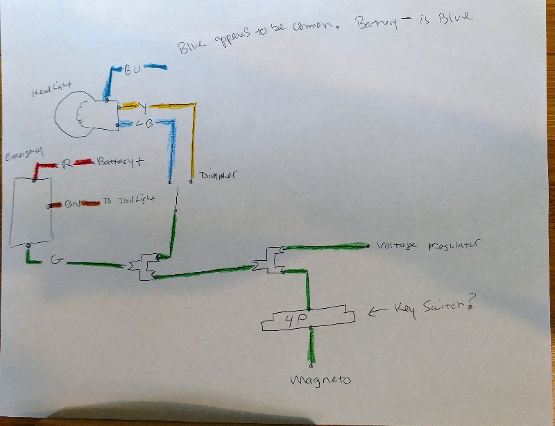

[attachment=0]IMG_20180404_135210279~2-800x614.jpg[/attachment
Excuse my drawing skills, no computer handy.
Simplified from supposedly a road toad diagram.
Test procedure
1. Verify 6v at red lug emergency switch.
2. Remove bullet plug connector where green wire from magneto connects to emergency switch and dimmer switch.
3. Place jumper from red lug at emergency switch to open connector where you just removed wire from magneto.
You should have 6v on light blue or yellow wire at the headlight dependant on the position of the switch. The light should be on.
If it is on you are not getting voltage from the magneto. If it is not on, open the blue wire connector closest to the headlight. Place a jumper from that point to the negative battery terminal. If the light comes on you have an issue between the circuit that this jumper bypassed.
If the light does not come on suspect the light socket if you have already proven the light is good.
Test procedure

Geary confusing with too many fingers i'm out. We need saddle time for Victor. Watching from the side. ------------ Clarence

Sorry Clarence, didn't mean to confuse the issue at all. I should have posted this on the other thread where I was trying to help Victor on this same issue. I didn't see a follow up so I assumed the discussion moved here.
Please don't sit this out. That could leave Victor relying on me. That's just scary
Geary
Geary

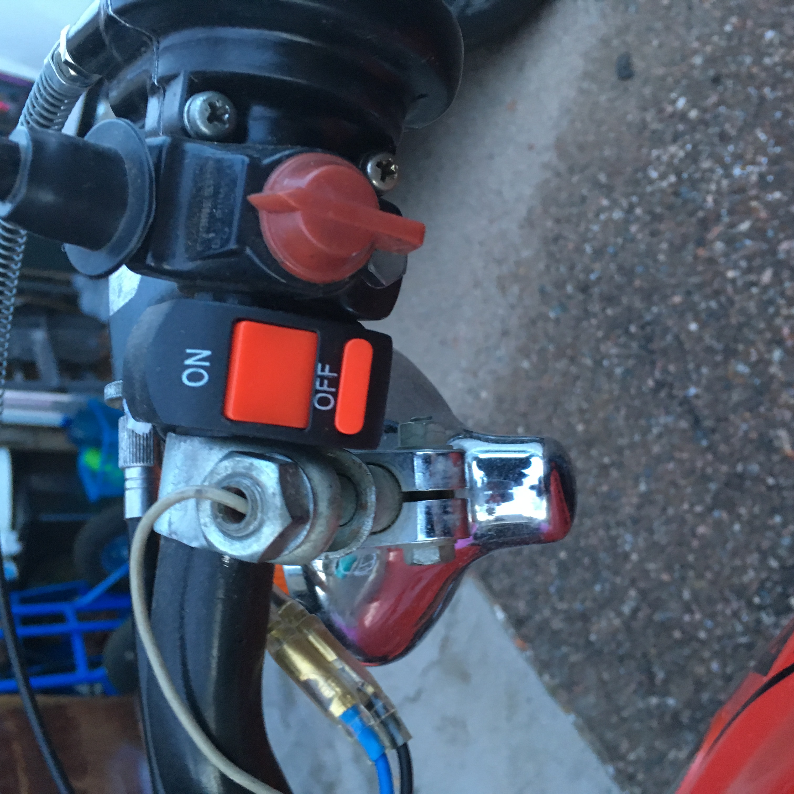

Don’t know if I ever showed the kill switches I bought for the Toads since their perch mounted ones wouldn’t work. But here’s what I got and where it’s mounted. Victor
Sweet scooter, Victor. Glad the issue is resolved. Just kibbitzing here, but you might want to consider placing a dollop of silicone sealant where the wires enter the hollow mounting bolts of the blinkers so that water doesn't run in there and cause all sorts of mischief and mayhem down inside the light housing. Some folks mount the blinkers to sit above the bars, but I think the low-mounted position is more protective of the light fixture. That does open the possibility of rain or wash water collecting in the hollow bolt and following the wire down into the light housing. That move might also provide a bit of strain relief for the wires and keep them from abraiding and possibly shorting to ground.
