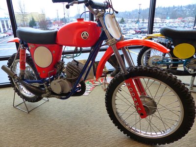

Wow, that is wild--how did the clutch get back there? Did it start out as a Super? Veeery interesting--Hmmm. Waddaya think?

Looks like a Lee Fabry creation. Paul probably knows for sure. It's one killer trick bike very nicely done for sure!
Just for fun....how many "tricks" can you see? I love it when people find the tiny obscure mods on my bikes.

Yup. That's the machine created by Lee Fabry. Among other things, he was determined to check out the difference in performance which might result from moving the clutch from the crank to the mainshaft. As I recall his comments, the modification was in the "cubic dollars" category and the clutch worked fine . . . but the modified clutch location didn't make the "night-and-day" sort of difference some folks expected.
Fantastic workmanship. Really nice technical features. Beautiful finish. A truly one-of-a-kind Hodaka.

What a beauty Wow wow wow . What radial head was used, I don't think it was Indian the head seems to match up to the cylinder perfectly. What a show piece.----------Clarence

Charlie R wrote:Looks like a Lee Fabry creation. Paul probably knows for sure. It's one killer trick bike very nicely done for sure!
Charlie R.
Air box number plate made from a road cone.

Lee always does great work and this bike was no exception!! The head is from a Zundapp 125 and then modified.

It also looks like the frame has been changed; ie. the engine sits lower (looks like the frame tubes were lenghtened to lower the entire engine). Anyone know what type of forks are on it? Is this one of the bikes he brought to Hodaka Days in Mid-Ohio, it looks familiar?
Re: Radical Hodaka 125 MX on display at the 2015 Siege Vinta
Yes the frame is lowered, Lee is a tall guy. This bike has been around for a long time. The forks I think are Betor.

That would be my work. It took hundreds of hours and many thousands of dollars. There is a full feature of it in VMX #20 from 2003. If you have
access- all the details are there. Also, on Siege's website there is a spread and an abbreviated story on it. I regretfully sold the bike to a friend
of Harry Taylors; George Eadie a few years ago. I built it on a dare. I was told by the "Elsinore" CR125 crowd in Ahrma sportsman 125, that I
could not possibly build a Hodaka to out perform the Honda. It took a lot of changes to do so, but when finished it would not only smoke a the
CR125, but would actually pull a stock Honda CR250 on a straight away!

The triple clamps are 1974 Honda CR250M, tubes, sliders and front hub are 1974 Yamaha YZ250A.

Mine was a 1993 KX80 Hinson set up on a custom machined and heat treated main shaft extended and broached to accept the Kawi clutch.
In material alone the clutch mod ran over $3000.00. After all the engine work to increase peak horsepower, the super combat clutch with
the best parts I could build it with would instantly fail. I launched one stock clutch through the side case! The KX80 clutch (as Ed said) didn't
actuate much better than stock, but would last and never slipped, dragged or failed.

THe cluve me that clutch on the Harry Taylor bike was of of his proto type dirt squirt 80 as well as the sand cast side cover. Harry gave me that whole assembly and I modified the primary drive on one of my bikes to use it , then Harry wanted it back to put the squirt back to origional so I gave it back , I I did have to use heavier springs to stop slippage. That same clutch can be found on the Pederson wild cat. Oh and Harry never did put the clutch back on the squirt , It went on his 125 race bike that Greg Watkins bought from him.

DOH! So I only remembered a small part of the comments on the clutch . . . the part about actuation. Seems like there might indeed have been a bit of "night-and-day" difference involved (i.e. exploding the crank mounted clutch out the side of the case VS not doing that sort of thing with the mainshaft mounted clutch).
