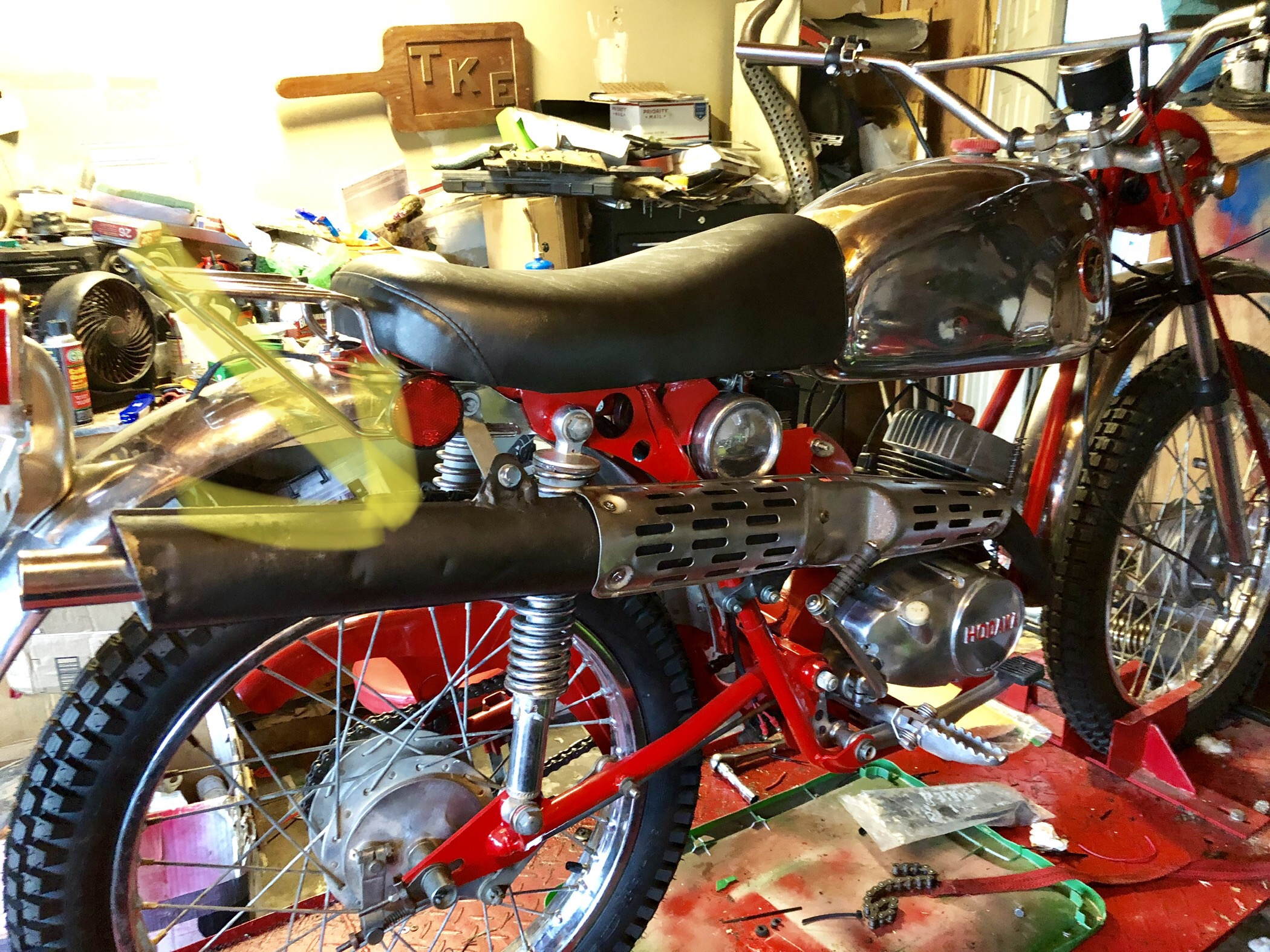

Now for a separate issue. There are small exhaust leaks on the pipe. One is at the yellow arrow, it’s leaking where the mounting bracket is welded to the pipe, & that’s an easy enough fix. But it’s also leaking exhaust where the screws hold the chrome spark arrestor cover on the end of the pipe. Is this something to be concerned with? Or is it a normal occurrence? Is there something which can be done to remedy the leak at the chrome spark arrestor cover bolts? Thx!
Re: Victor’s Ace B Project!
Ahh. Just saw that and no. Gasket is missing. I’ll get one from Terry! Thx!
