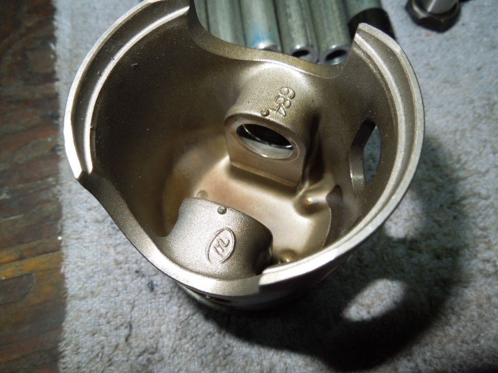

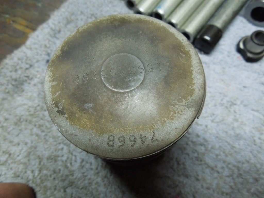

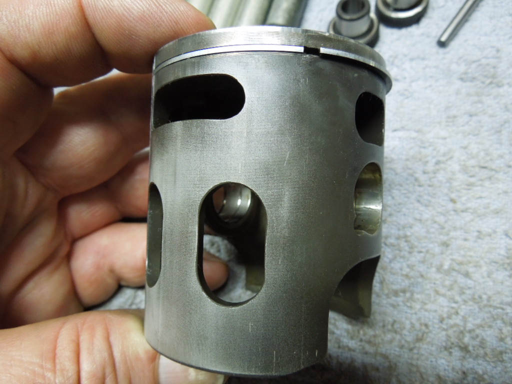

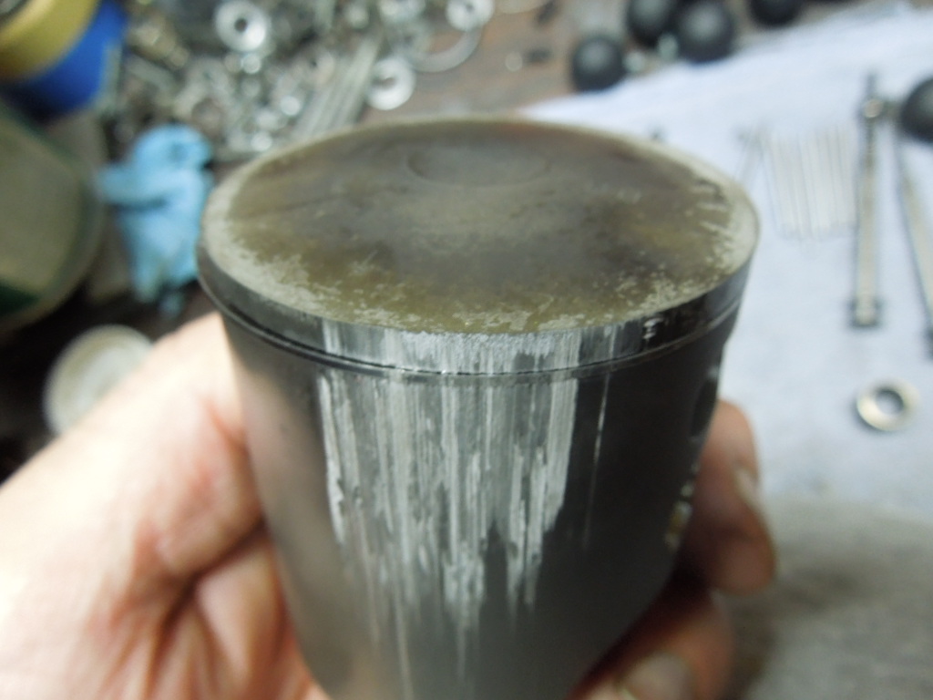

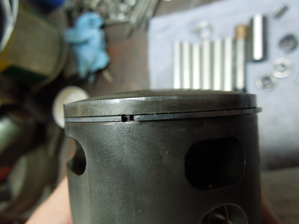

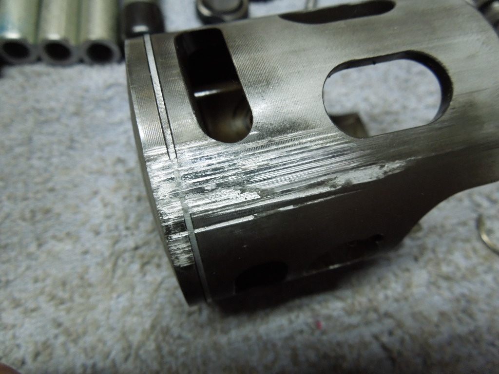

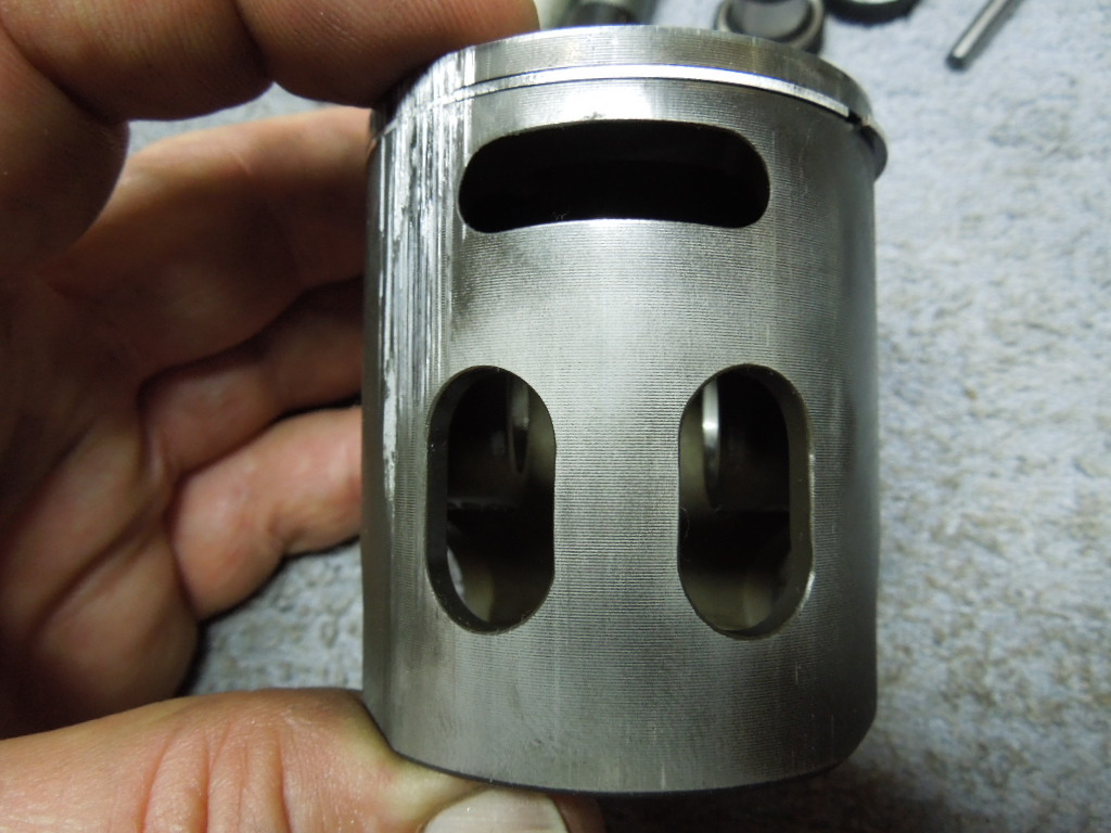

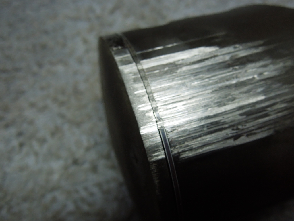

Ok bike arrived today and attached are pictures of the piston. No time for comments at this time. Lets see what you think.
Danny :D :D

I am still going with the main jet being to small for conditions. That sucker got really hot to melt the aluminum like it did. As I said, I had a bushel basket full similar to this one back in the day. I thought I was the speed king but soon learned how important jetting for conditions was.
Re: Tired Combat Wombat
I'm with Bill, It looks like a typical lean seizure complicated by new clearances and some early big demands. When we put in a new piston in the old short tracker we went up on the main and tried to get an easy hour on the engine by running it up and down the road at different speeds using some full throttle but at lower RPMs than race speed. The engine was disassembled and checked for wear spots on both cylinder and piston. Usually there were not any. Any wear points on the piston were sanded lightly and cleaned. Another series of easy runs for several minutes and we were ready to go. At the track we started rich and worked our way back to the original jetting. More time would have been nice on the engine, but it always seemed to work.
More oil in the mix could have been another approach (and not a bad one) but we had already added more lubricant through larger jetting. This engine was a race engine and needed all the fuel it could get. After the early work on the engine (I had some pistons just like Clarence's and Danny's), the engine was raced for years with no seizures at 20:1 oil mix ratio and was a consistent winner in three states for a long period of time with either my teammate or me driving it.
Wow, I started out to just agree with Bill and got carried away! :D
PS--I don't know if anyone is noticing but the three Musketeers from the past, Clarence, Bill and Max seem to all be on the same page. Maybe it's because we all raced for years and hundreds of hours in the development stage of the Hodaka. We've experienced this type of disaster and learned from it. It's not about us but I think we are all just telling the story of a remarkable time in motorcycle history!

The metal displacement here is not from lean heat, but from friction caused by contact between piston and cylinder wall. Lean heat would have attacked the piston crown. From the video, the bike did not sound lean. Actually, it sounded very good. Sorry to disagree, but running today's fuels in yesterday's bikes is more likely the cause of failure than jetting.

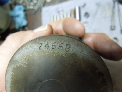

Look at the photo of the underside of the piston crown, and tell me if you see any signs of excess heat. Those signs would be coke ash. Light coking is normal. Ash isn't. I see no signs of excess heat. Plug is black, piston normal, sounds clean at full throttle. Where are your supporting symptoms of lean condition? Simply because you have always attributed seizure to lean jetting doesn't make it so. Let us know which diagnostic symptoms you are using in support of your conclusions. I have Staed mine, and stand by my conclusions. If lean jetting contributed to this result, it certainly wasn't the principal cause. I doubt jetting is wrong at all. I see no signs of leanness anywhere. All I see is a seized piston. Why it siezed is the question. Lean carb isn't the answer.

I'm going to insert my 2 cents on this subject....but you have to remember my 2 cents is worth about 1/2 cent. If you look at the outside edge of the piston there looks to be some detonation going on from maybe to much compression? or is there other things that haven't been talked about. DG

Detonation, surely, but unless running race gas, it is most likely attributable to running pump gas. Today's fuel, yesterday's bike. Where did I hear that recently. If the bike was detonating on race gas at 97 to 101 octane, timing might need retarding slightly. Otherwise, it's hard to find "high" octane fuel these days, and what we can find detonates readily due to low octane and modern additives.

Not having a Wiseco piston handy, I would wonder about the difference, if any, in dome height and profile of the Wiseco piston versus a stock Wombat piston. I know folks heavily into modern bikes who won't use Wiseco pistons due to inconsistency in the product. This is hearsay not science, but I would start with a comparison of the replacement piston to stock in terms of dimensions, particularly height above the wrist pin, and overall weight. I can't find any data from Wiseco regarding their maximum recommended piston speeds, and perhaps they don't even have such data. The Wiseco uses a keystone ring I believe, and for high rpm racing, I would prefer a piston with a Dykes as they seal better and are very hard to unseat due to rpm. Compare Ace 100 Pistons to Super Rat Pistons for example. The Hodaka MX bikes all used the single Dykes for a reason, and the Super Combat is rated for 10,000 rpm, which verges on insane imho.
Bottom line here is that the piston shows signs, but not signs of overheating. The erosion around the perimeter does look like detonation to me, but saying so here will lead to a refrain on lean jetting, which for the most part does not cause detonation. Not seeing any signs or hearing any sounds of lean burn, I look elsewhere. Pushing the piston beyond its limits and beyond the limits of pump gas is my suspicion.
