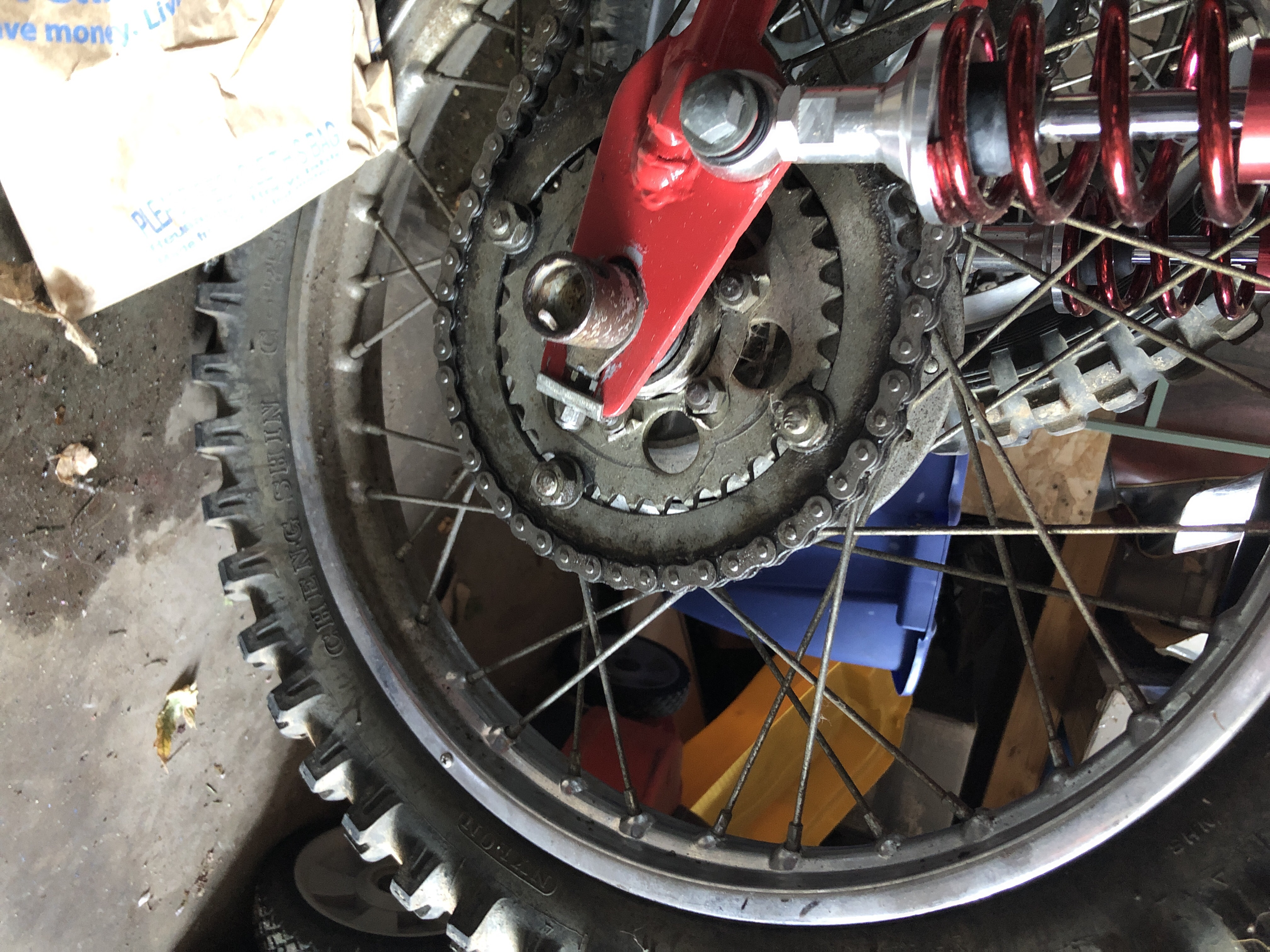

Bev. Finally remembered to take a picture of the overlay sprocket for you! Here it is!

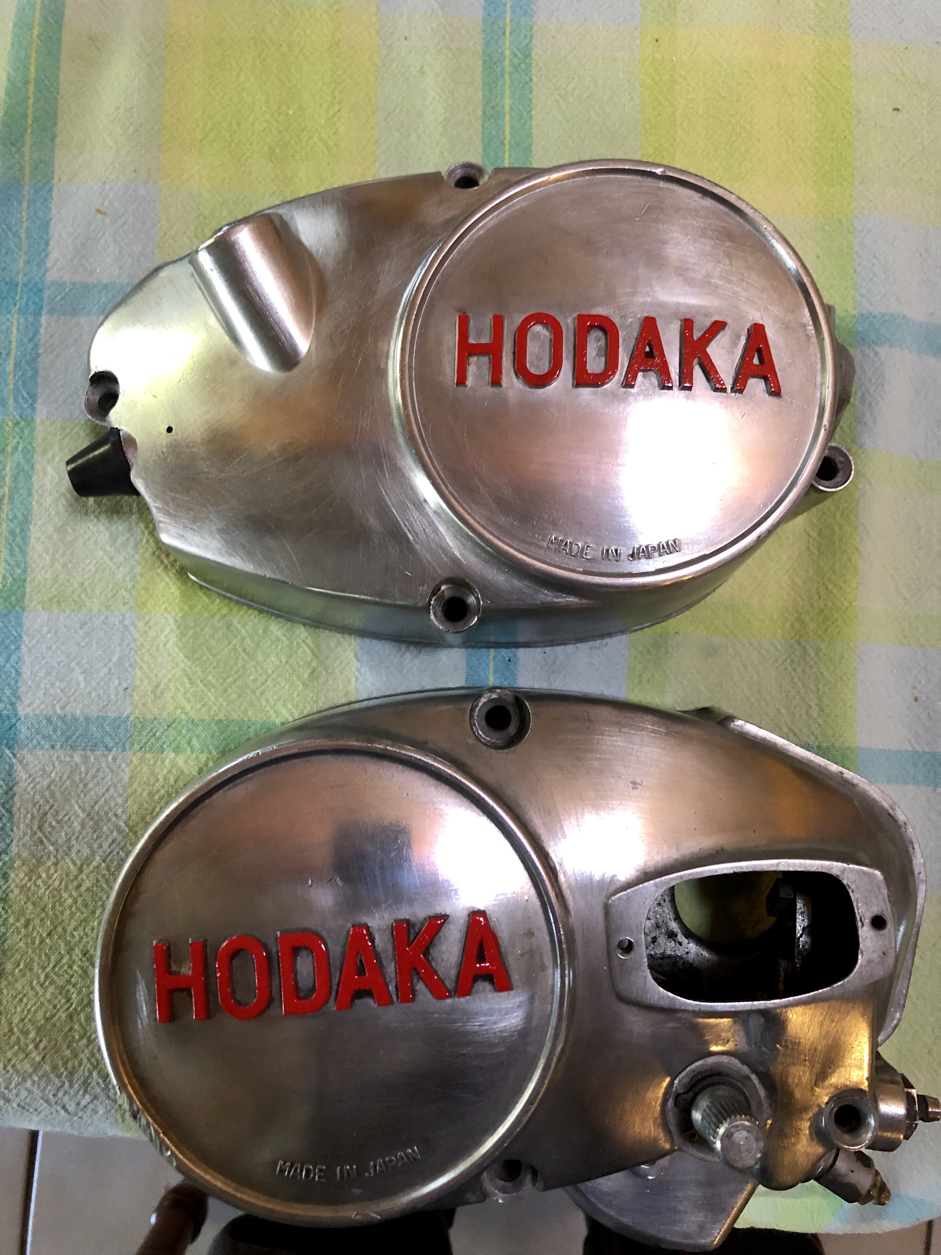

One down, one to go!

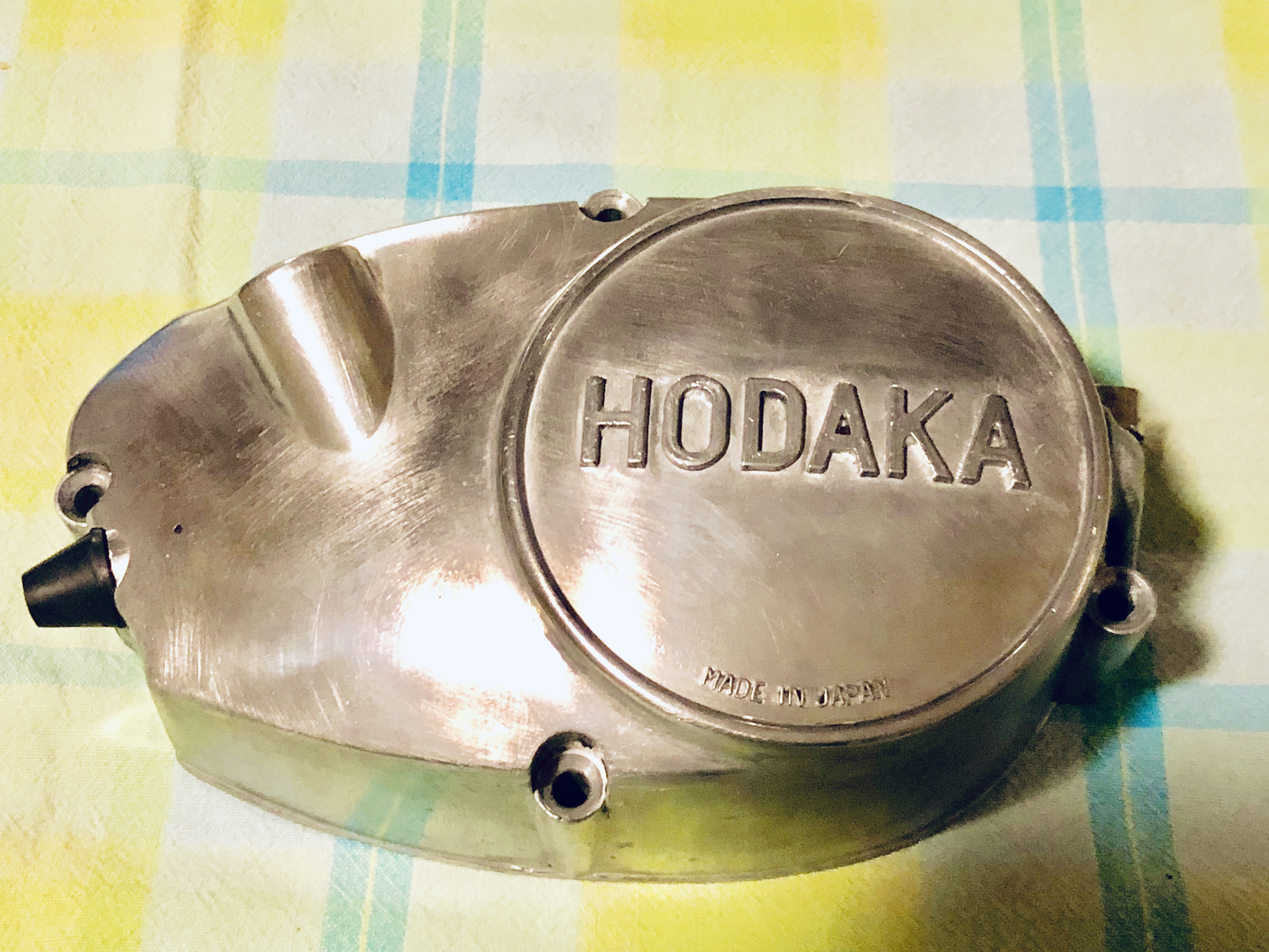

Shift cover now done as well! My nephew does like the red lettering!

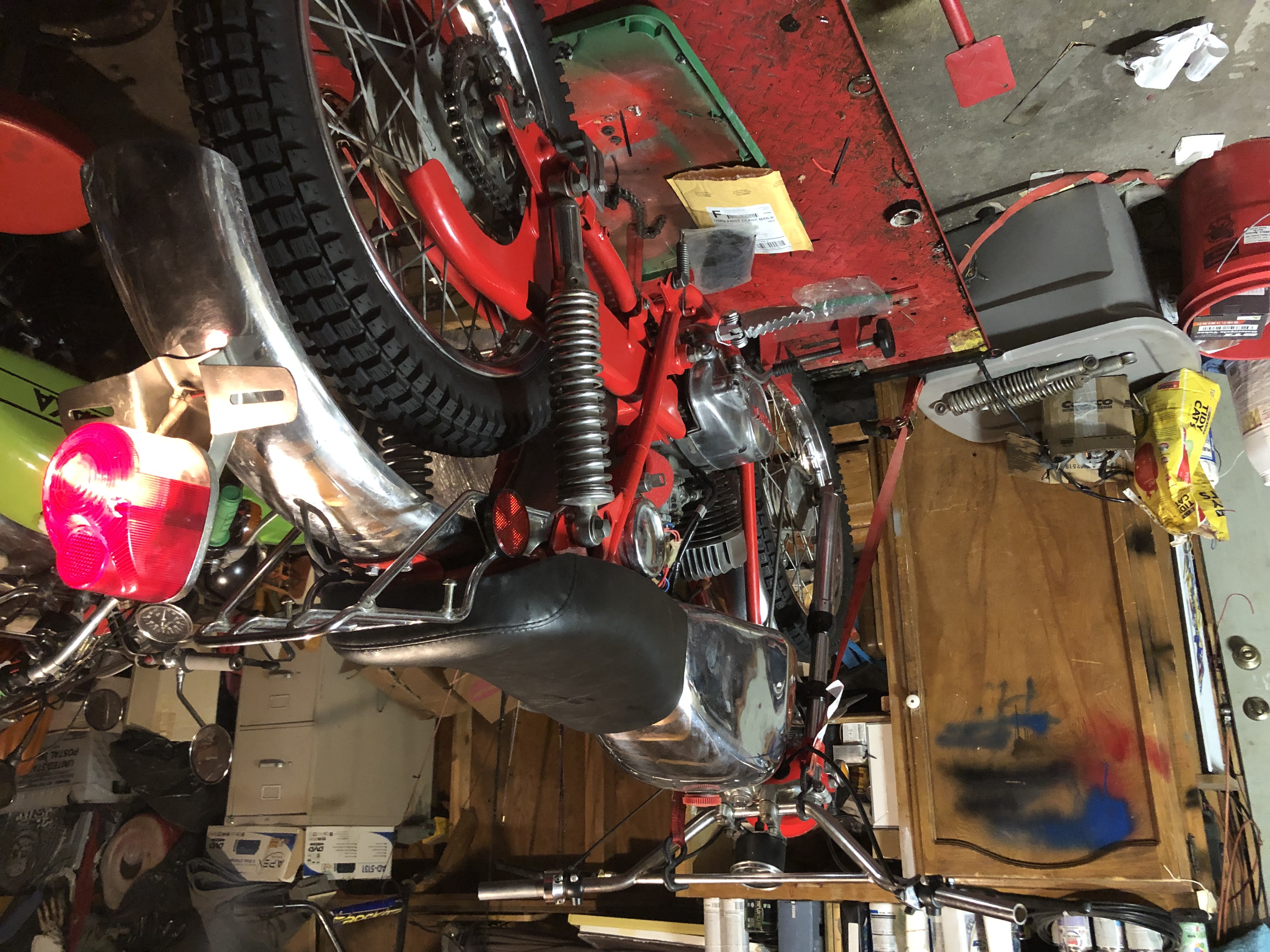

Parts came in from Alan today! Now I can move ahead and finish the Ace B, as soon as my back pain goes away.....
Re: Victor’s Ace B Project!
Well after 2 trips to the ER, 5 days of Morphine & Valium and a near 7 days of constant TENS unit use, I’m back down to just my regular meds and maybe an occasional TENS unit dose.
The good news is, it now doesn’t hurt any more to work on the Ace B than it does to sit in my recliner, so I spent 3 hours out in the garage working primarily on wiring.

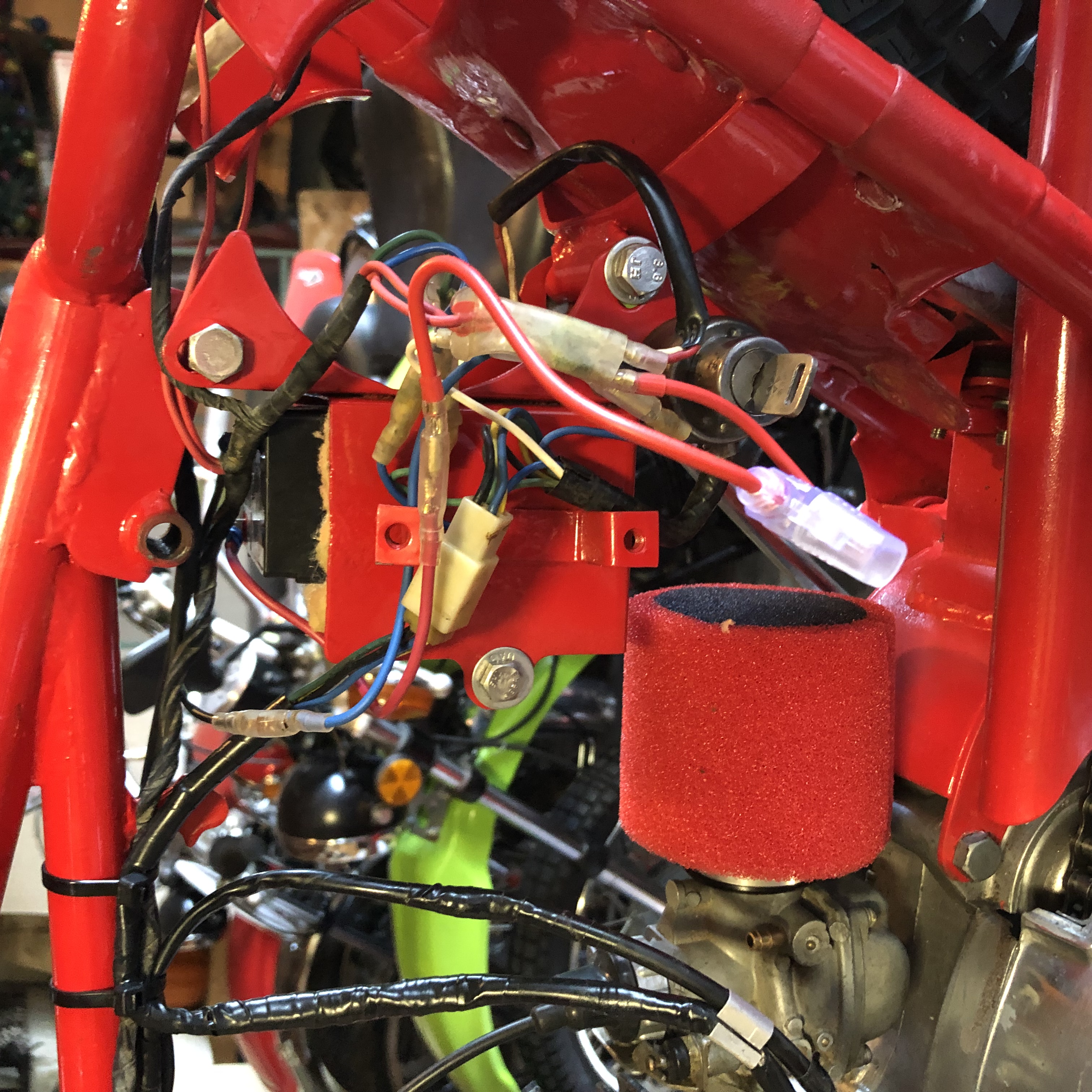

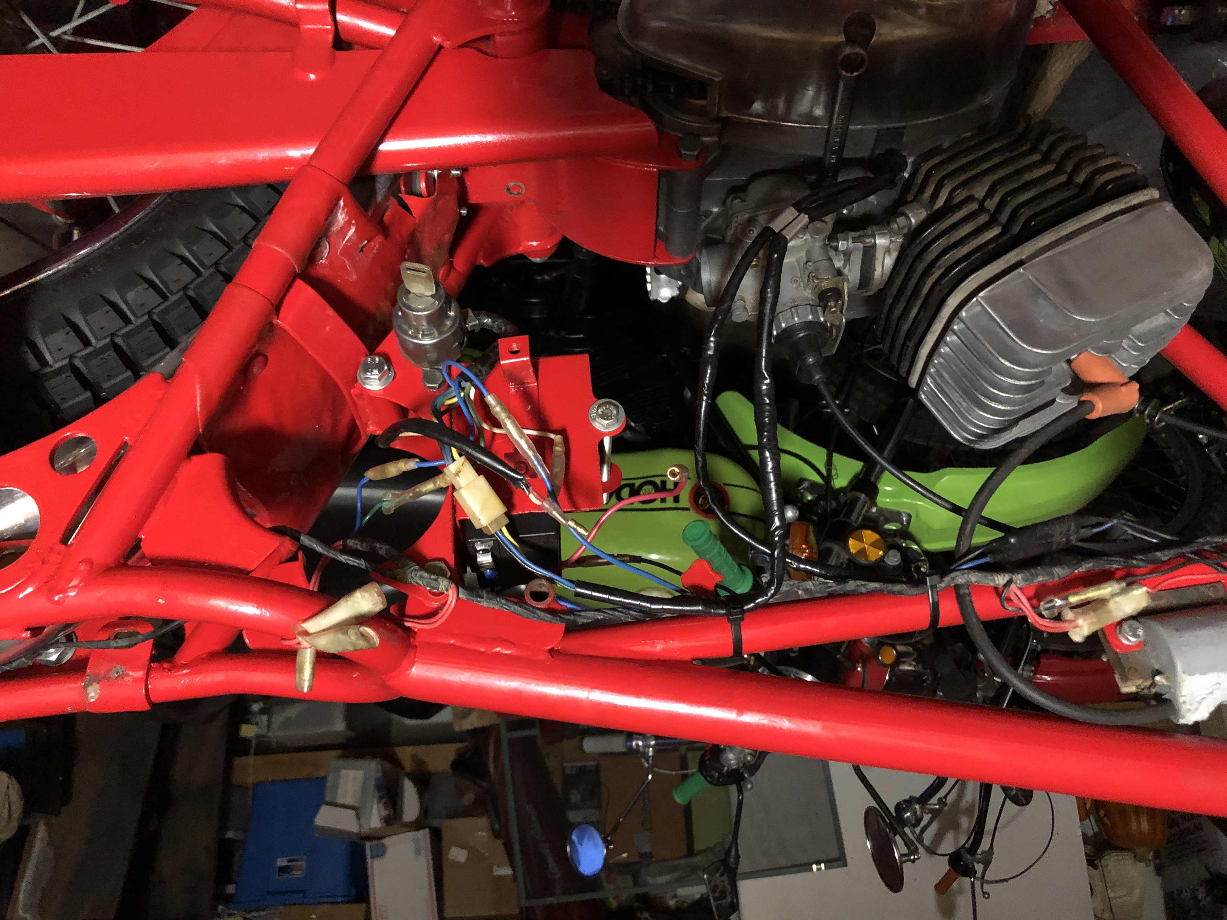

I also sanded and hammered out a small dent in the top of the headlight bucket which Allen sent me, and painted it! It should be dry and cured enough tomorrow, to be able to mount it and finish up the wiring.
Installed the horn, wrapped fresh electrical tape around the main harness wires coming up from the stator, power wire brushed the ignition switch & key clean, combined the best of parts from the 2 tail light assemblies I have to make one really good one. Only thing missing there is the reflector holder which mounts to the tail light.
I also need that small plastic Hodie logo cover for the left side of the battery box. Anyone got a spare with which they can part?
Electrically what’s left is to install the brake light wires, front & rear, install the AC/DC emergency switch into the bucket, and complete the wiring connections inside the headlight bucket! Maybe need to find a brake switch spring or two in my containers of loose parts! Also going to change out the light/horn switch which I repaired with the one Alan sent me which only needs a light cleaning! And I need to add the fused link between the ignition switch and the positive side of the battery! I’ve said it before, I really like using the mini blade fuse holders when redoing these bikes. 5 amp mini blade fuses are easy to carry and much less fragile than the old style glass tube fuses.
A few pics just to show progress has occurred! I may actually be bolting on the exhaust, adding oil & premix, & kicking this one over soon for its first new “Ring-a-ning-a-ning-a-ning!” Getting close!!!

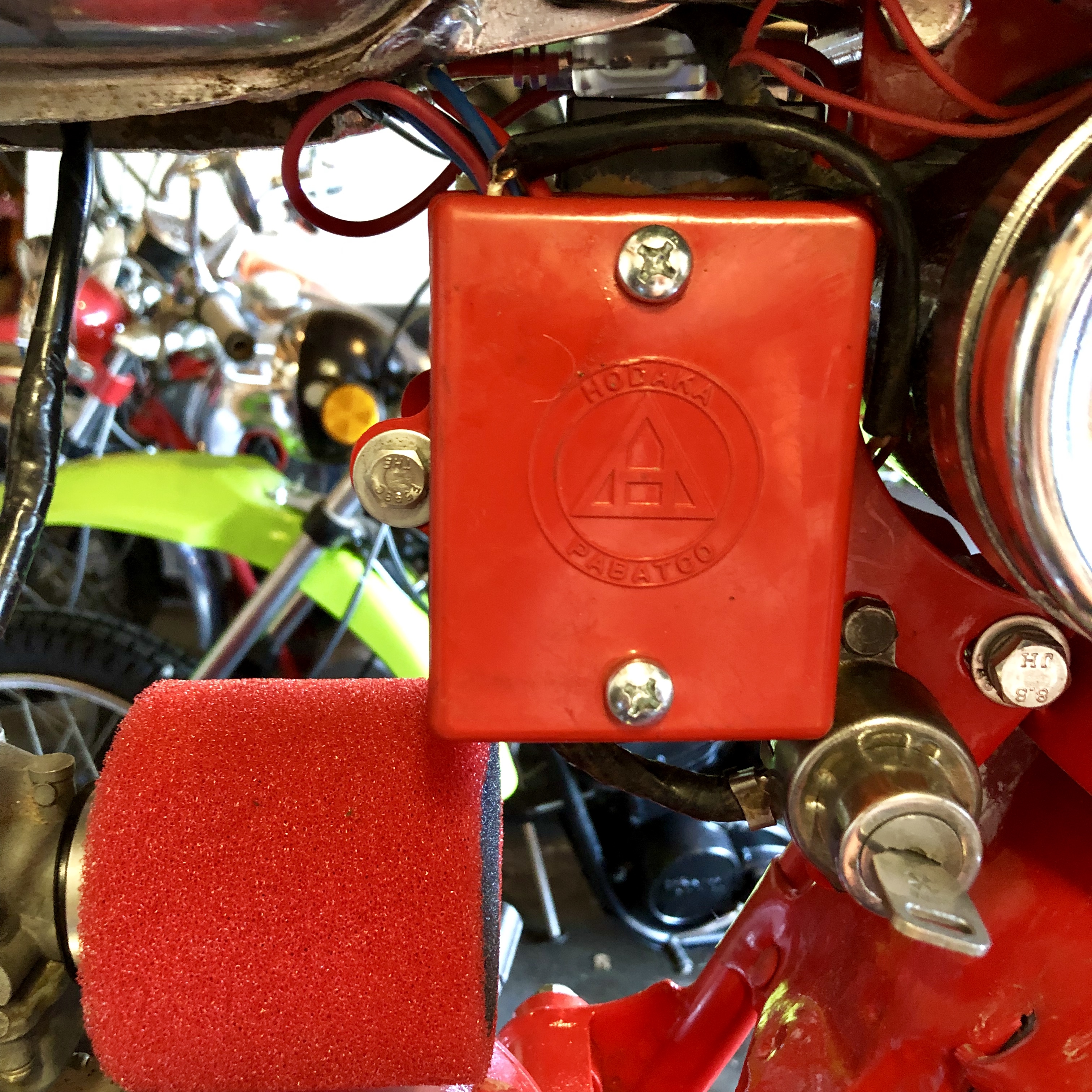

Well, Terry had a used wire connector cover which he mailed out to me today! As soon as it arrives I can paint it so it looks fresh, and mount it once it’s dry!

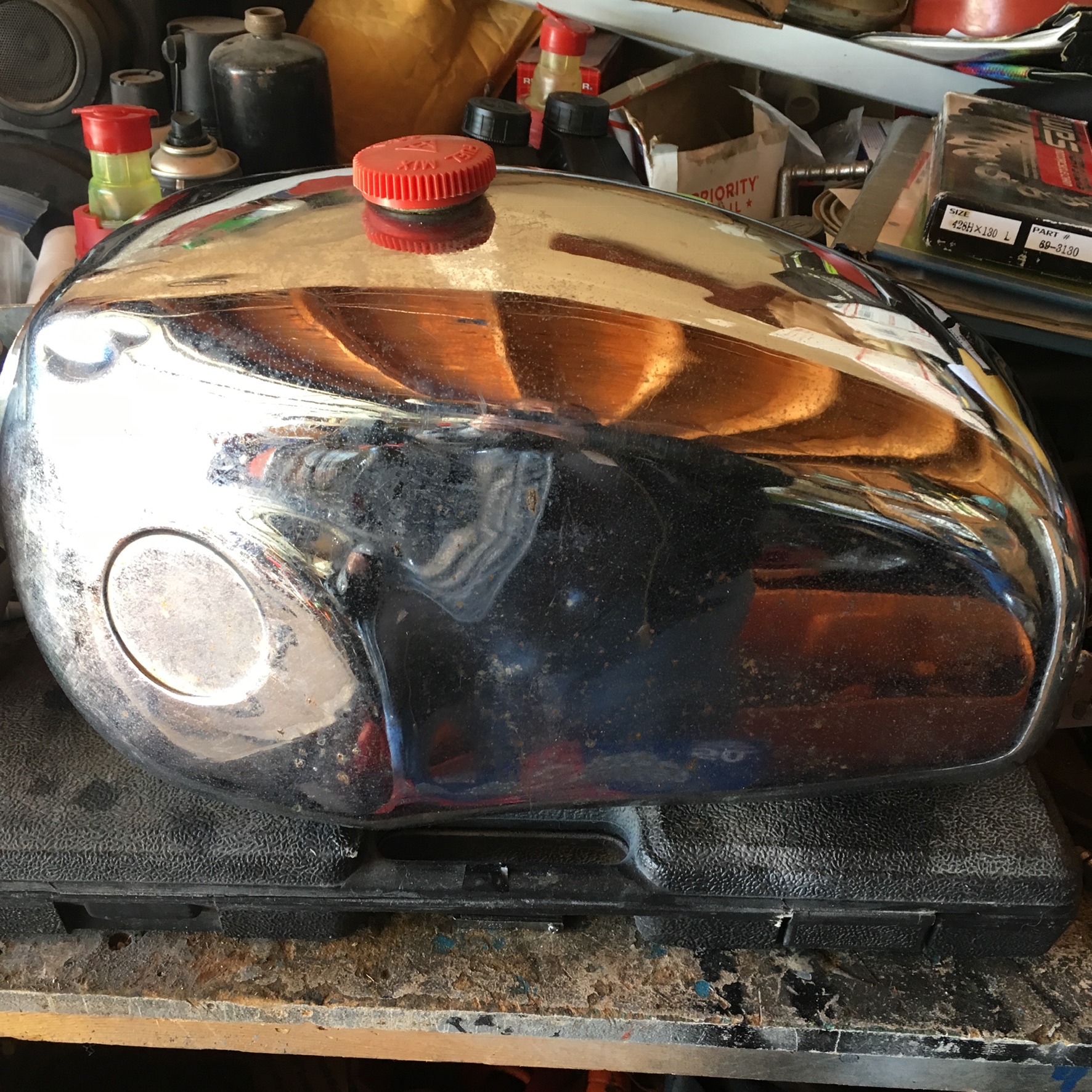

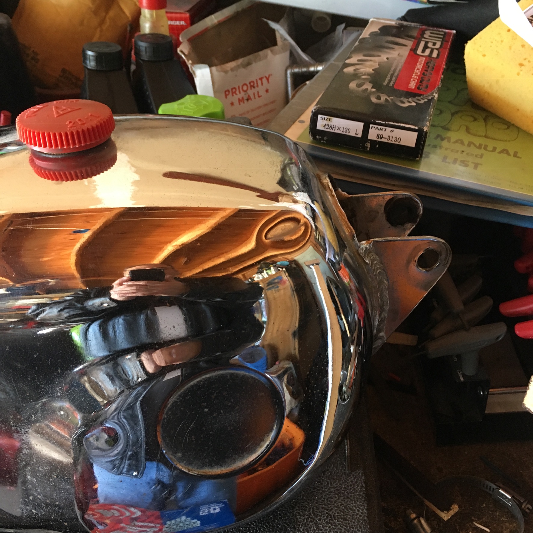

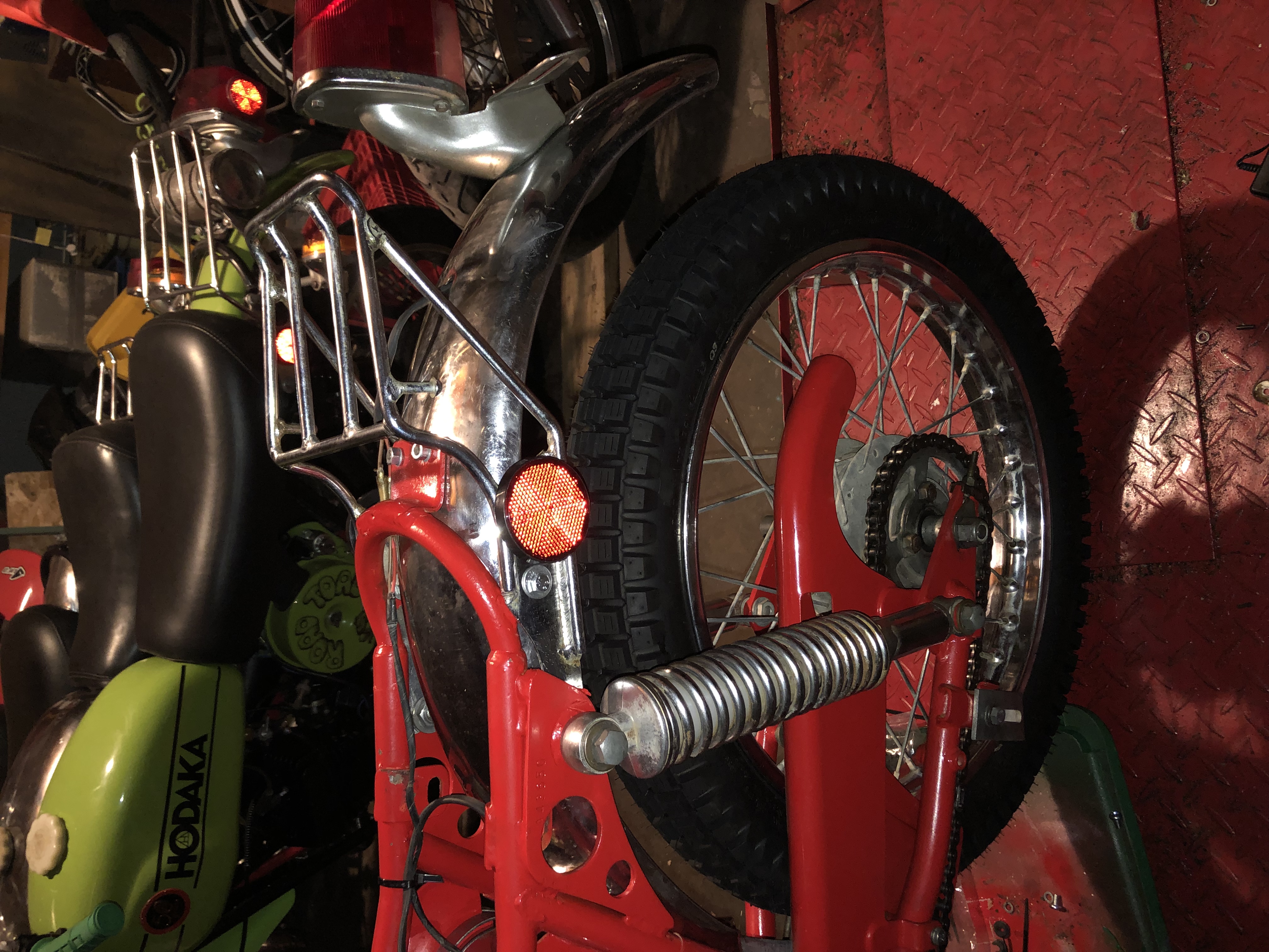

I found my box of Red Reflectors & mounted a set on the rear rack. The front brake is now working & I will be headed out to Ace Hardware for a few different springs to get the front brake light working properly.
I bought a 1” diameter steel ball bearing. I’m off to the garage now to weld the ball bearing onto a section of rebar which I can bend into different arcs that will, hopefully enable me to tap out the 2 dents in the front of the gas tank! I’ll keep you posted on if/how well this contraption works! These are the 2 dents I’m attempting to remove!

Good luck on the dent removal. Those tanks are a very heavy gauge metal. Hopefully it will work, keep us posted.

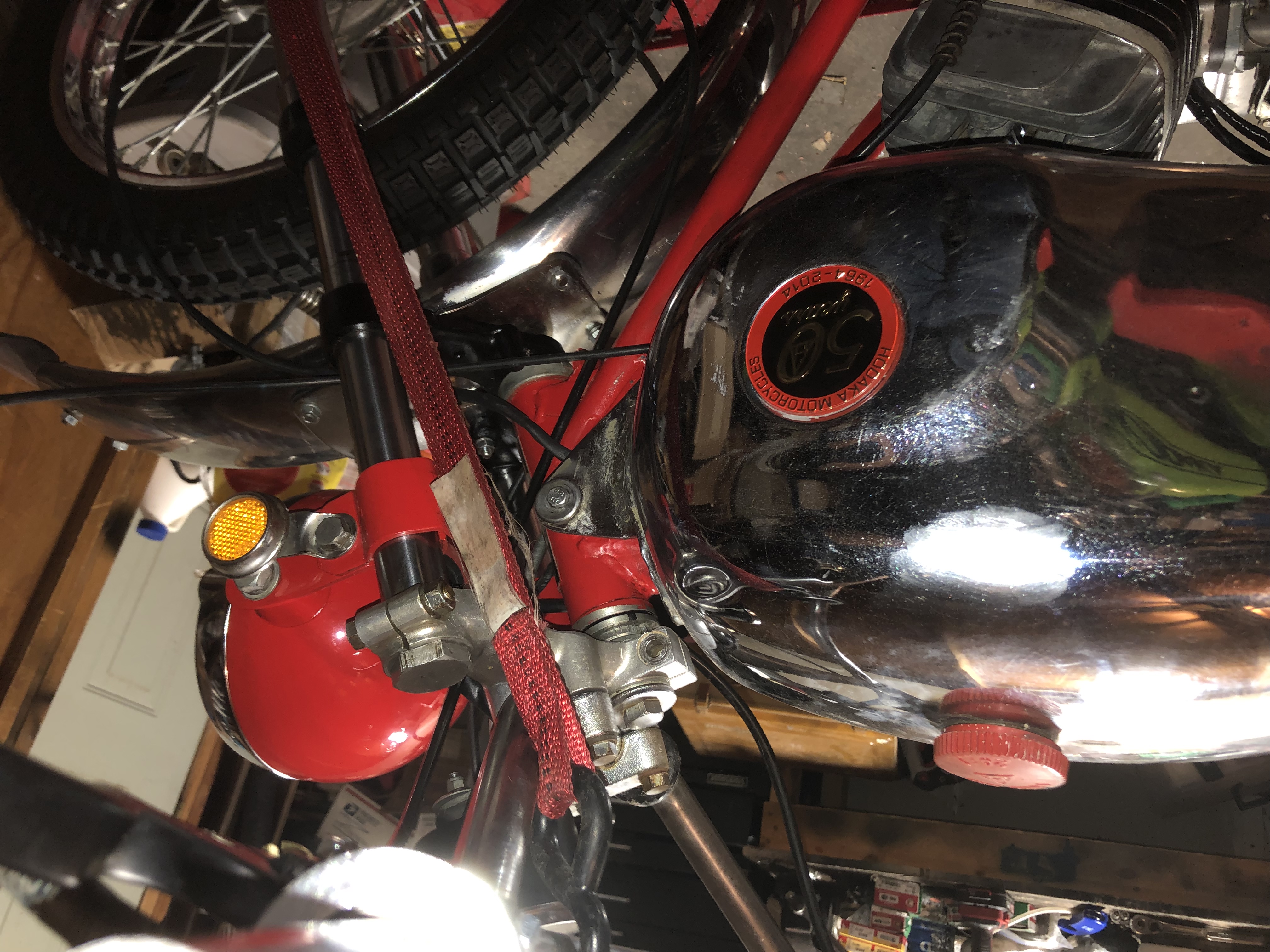

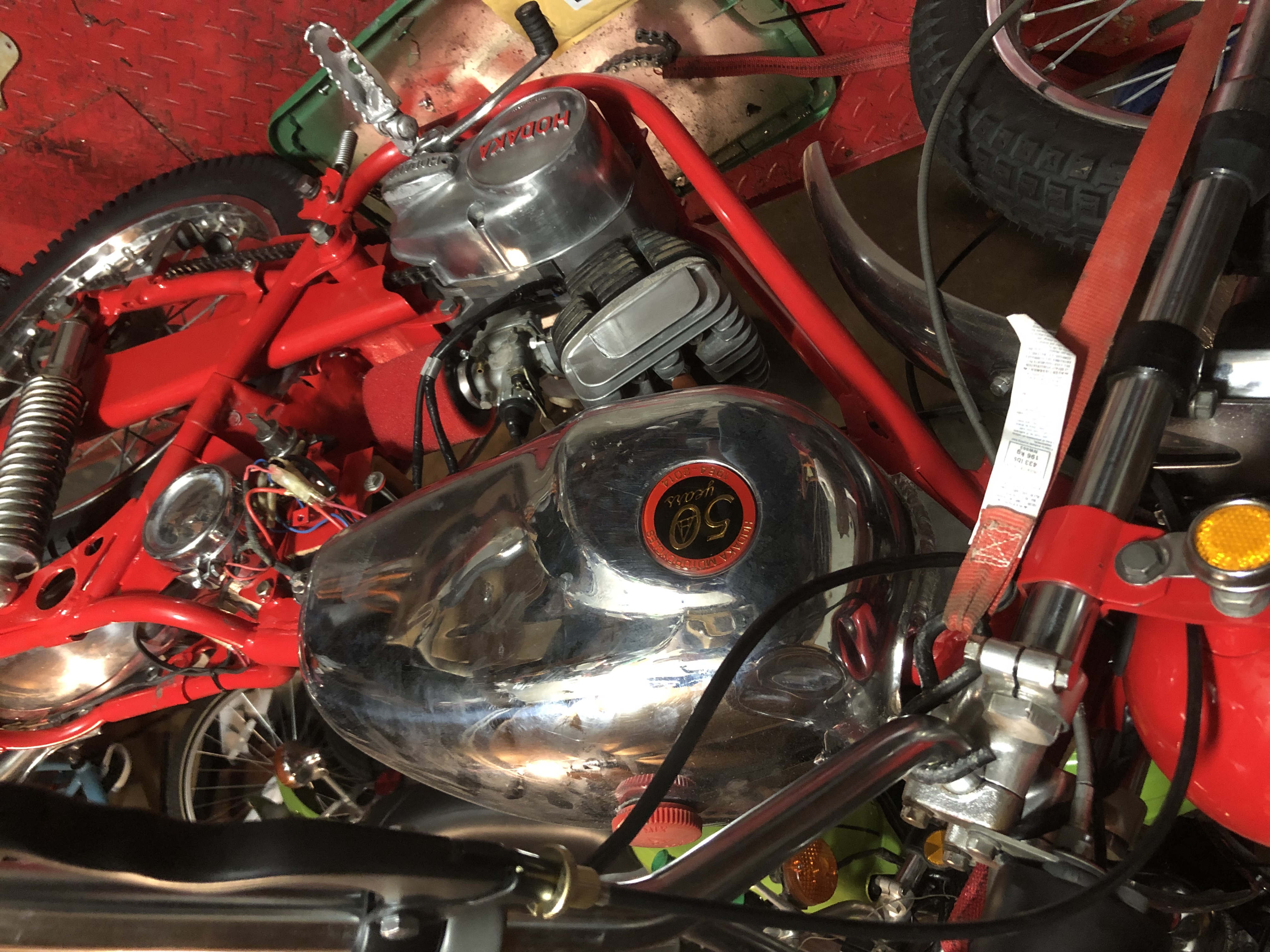

Well, I was able to make the tool. But to my surprise, the tank had been lined in the past, and rather thickly. So, it appears the liner was absorbing way to much of the impact. It was like trying to hammer out a dent with a piece of very dense 1/4” foam between the dent and the hammer! So the tank is just going to stay like it is. Maybe If another Ace tank comes along.....

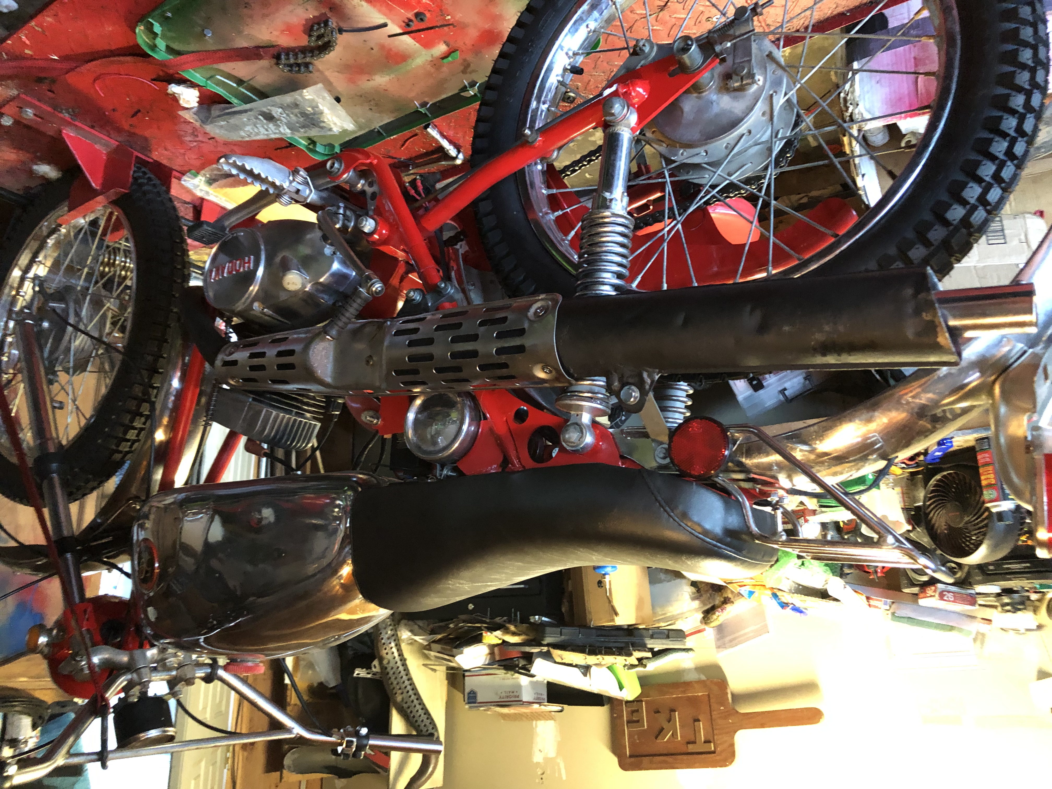

Everything on but the exhaust, a mirror & grips! Can’t get exhaust to line up by myself. Maybe tomorrow a grandson can help me.
More done today!!! Got my wire cover from Terry & got the exhaust mounted!

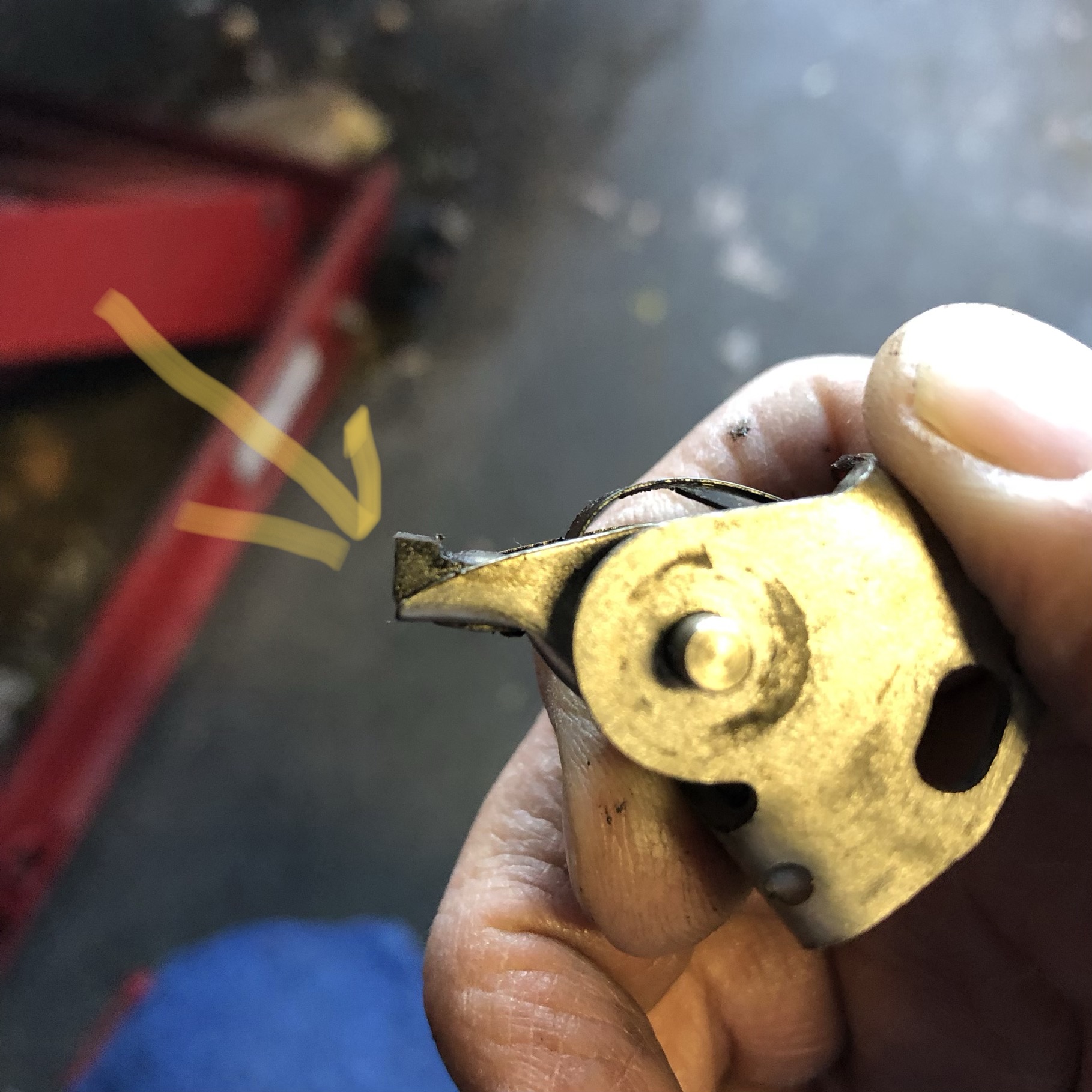

Looking for spark but not finding it. Had a very difficult time gapping the points but I think I accomplished a good gap. I’m not sure the condenser I mounted is good. But I have 3 new ones I bought. Going to swap out the condenser this weekend. If it’s not the condenser, I found another coil, an un-rebuilt one, but complete. Sooner or later I’ll get spark. Just hoping for sooner. I may have to replace those points as well. But I’ve only pulled the flywheel 3 times so far.

Well I tried gapping the points, but when I removed them I figured out why they wouldn’t work! Installed new points and condenser. You can see how worn the old points were!

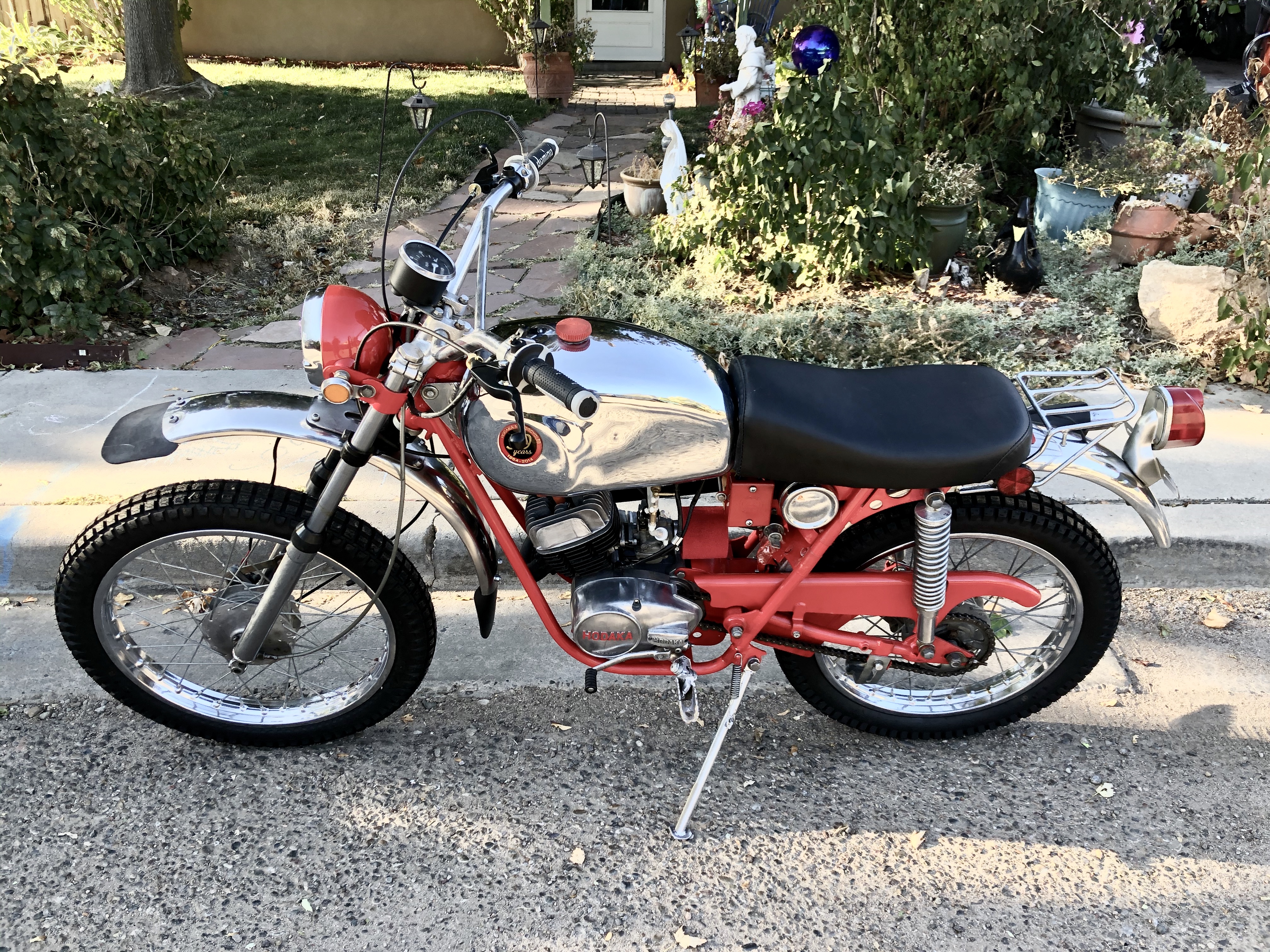

Well, today, she is officially done! Waiting for Saturday morning to get her for the first start up! Just need to go buy mirrors!
