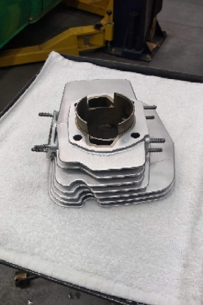

I’m still trying to get my 03 cylinder off the cases. Piston is stuck to the cylinder. I sprayed it with PB Blaster and left it to penetrate. I’m hoping with the time it’s had to sit that it will come free with some tapping from a rubber mallet. Once freed, I’ll send it to Terry and see if it can just be honed and a Std piston & rings fitted back in. He at least still has Std Model 03 pistons.
I’ll have Terry send me a Model 03 bottom end rebuild kit and a HD kick shaft retainer bearing, & I’ll rebuild the bottom end while Hodaka Dave cleans up the cylinder.
Once the cylinder is removed, I will take the inner & outer cases, cylinder & head to be vapor blasted. I found a guy about 38 miles south of me who does it. Larry did a wonderful job with my CW vapor blast, but I think I paid more for packing & shipping to Larry than it will cost me to put the parts in a box, drive down and have the blasting done locally. I’ll post before & after pics when I get it done!

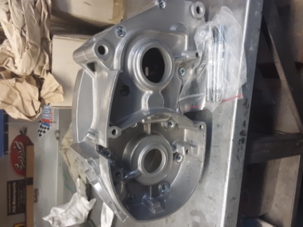

Bottom end assembly day!

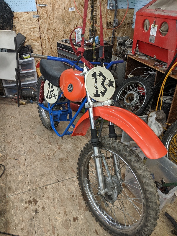

Re: Model 97 - Finally getting started
Fitted 1990 RM250 air filter and cage. Mounted Honda cdi unit. Test fit engine. Next is finish up clutch and pressure test.
Bob,
It would be if I was the one with the idea. Credit goes to Kelly and Greg, they put a great write-up in issue 2-24. I used an RM unit cause it was handy.

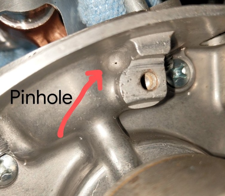

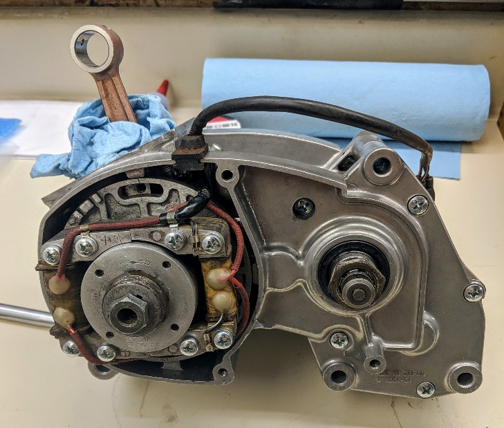

Pressure test fail. JB Weld to the rescue.
Can't post picture at the moment. Found a pinhole near the stator mount bolt hole. Try again after it dries.
