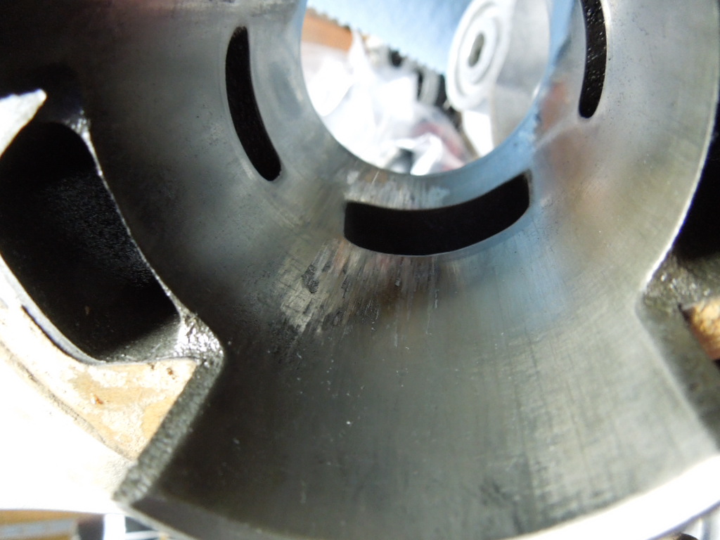

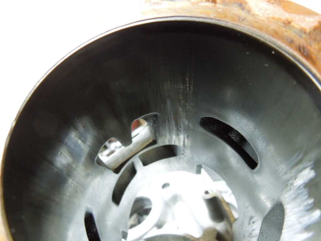

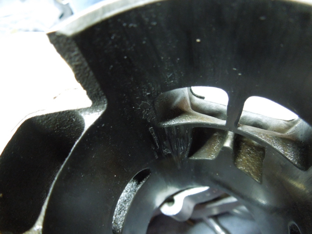

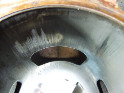

Well here are the pics. We had run the bike during testing at my home, Buds Creek on a Friday which was a practice day, and one race prior to the event. The race prior did not have the long wide open run and was very muddy. Engine survived and performed well. On this last race the temperature was in the 40's where as the prior race temp was in the 70's. Will participated in the practice laps during this race with no noted concerns. During the race he thought he noted something on the first lap. Second lap on the extended wide open run is when the engine fully seized. Bottom line looks like it was just to lean on top for the air temp and extended wide open runs. The video does not capture the moment the seizure occurred. Camera stopped working around the first lap. The color of the plug is not terrible but you can see the insulator is white at the bottom. Picture makes it look more tan. Also don't know the running condition the last few moments of operation.

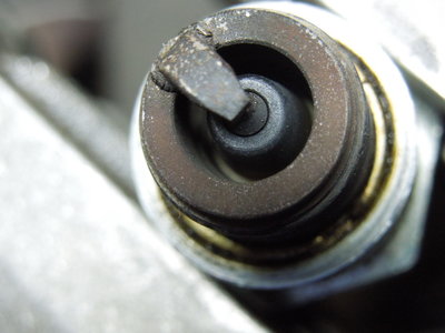

Plug doesn't look lean. Down at the bottom of the insulator is the coldest part of the plug. White probably due to limited run time. Color otherwise is normal. Seizure pretty general all over. Gotta ask, what oil and mix ratio? If leanness caused this it would be oil lean not fuel lean, I think.
- Posts: 2241
Re: Tired Combat Wombat
A different opinion The plug does not look normal to me. I say lean fuel. with the bike running it sounded dry and lean, wound very high. If you are jetted for good oil you can't run a poorer grade of oil. In my opinion you jet to what you are using. The air fuel ratio determines rich /lean. If you have to mix 20:1 you need a better oil. Yust me ----------Clarence What piston??
Not saying the oil made the fuel mixture lean (although presence of oil displaces fuel and can affect mixture, but that is another days discussion). Saying that the plug is black to brown, which does not suggest lean fuel. I was suggesting that the oil mixture was too lean for conditions. As in, 40:1 when it should have been 32:1, or 32:1 when it should have been 26:1. I didn't hear it run, so can't comment on whether it sounded lean, but while you can hear lean run due to jetting (if it is excessively lean) you can't hear oil lean conditions until the bike goes quiet.

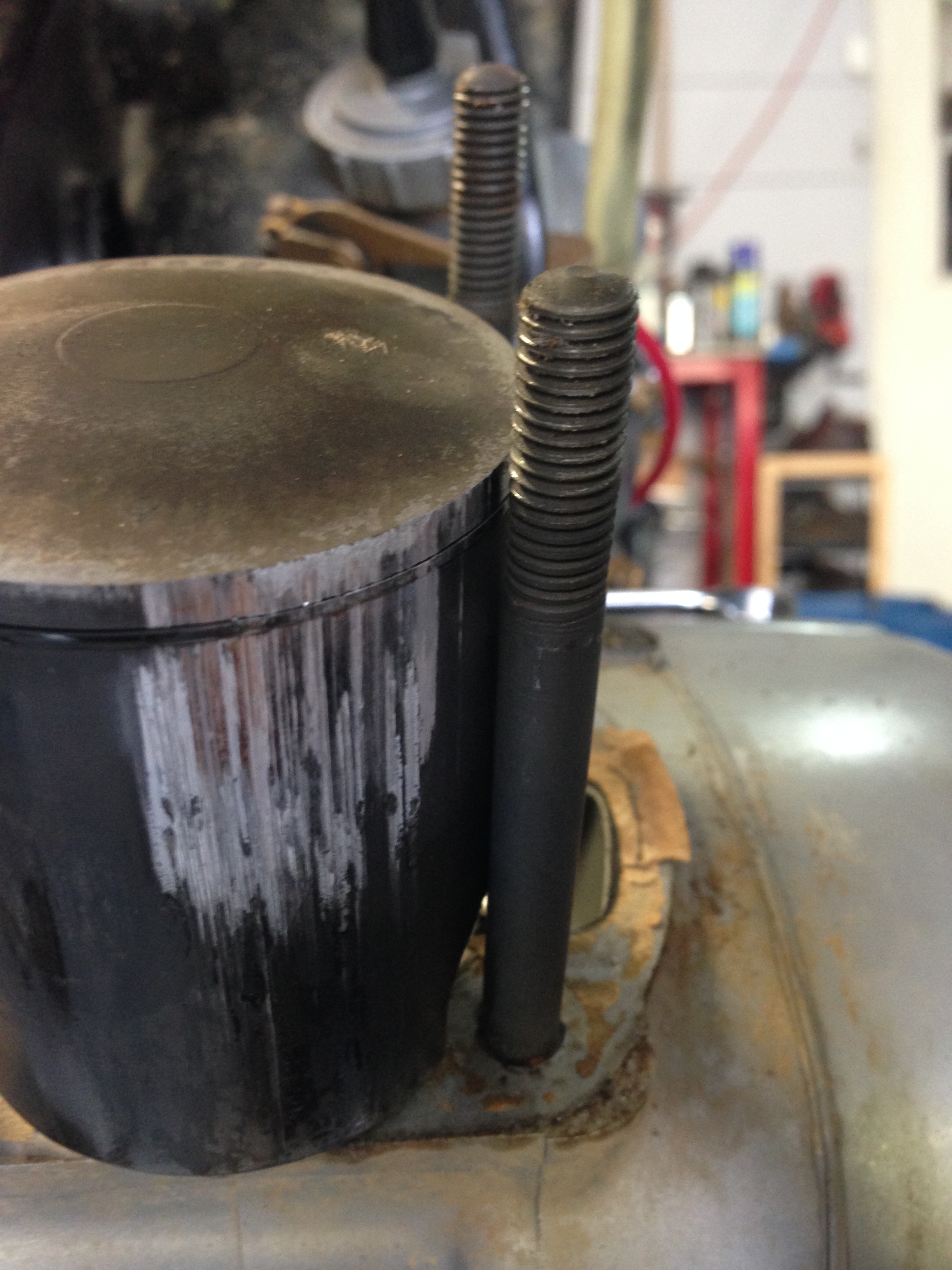

This looks like a lubrication failure from running too little oil for sustained high rpm running. Assuming the piston was set up tightly, as it should be, at high temperatures, pistons often will measure a slight press fit in the cylinder, and the only reason they don't go metal to metal is the oil film. If that film fails, seizure ensues in only moments. Which leads back to my question, what oil, what ratio? The plug itself doesn't look lean at all. In the photo it looks like a black insulator tip, and a brown ring. I would rather see the colors reversed, but if I had to guess on jetting looking only at this plug, I would say slightly rich to normal. The only other variable that comes to mind is insufficient ring end gap, but the displacement of metal isn't limited to the rings or the area below the end gap, so I am thinking oil related failure.
- Posts: 2241
The plug doesn't look black to me it looks silver grey the color it would be if I fried my motor?? And I would ask what piston old stock or new and what was the ring end gap?------Clarence

I shouldn't even get started on this one but; Hey gang, It seized because the aluminum piston heated to beyond its melting point and began to stick to the cylinder. This is almost always caused by too lean of mixture or lack of clearance. Too lean is not enough fuel AND not enough oil. Lean means not enough fuel to cool the system--It got too hot. Reasons for catastrophic seizure could be clogged cooling fins, obstruction of jets, lack of clearance, not enough break-in and/or too lean of jetting or all of the above or something I haven't even considered. 32:1 should be plenty with this engine and a slightly rich mixture with proper break-in. As for the spark plug, to me it means nothing, the evidence is the melting of the piston and the resulting seizure. Again, it got too hot. I must say and we all know, it's hard to tell when an engine is "broken-in" and first races should be on the rich side. Danny is no "babe in the woods" when it comes to engine building and I'm starting to suspect an obstruction of the main jet or perhaps a too short of break-in. We have lots of demands on race engines sometimes exceeding the limits of design.
The last picture of the piston appears to show the ring gap. If so it does seem to be enough. Just thinking, we've all stuck one it seems and we always end up with a bigger main. All just opinions of course!
Hey guys, thanks for all your input. All your thoughts are appreciated and we don't have to agree on everything. The discussion alone peaks my curiosity and makes me think.
1. I only have pictures of the piston at this point....same ones you are seeing. A closer examination may give some more info. Bike still not here. The piston and ring combination is one of Strictly Hodaka's new version Wiseco. Cylinder to piston clearance was .003 and the ring end gap was a little loose at .017. I did not bore the cylinder as seemed to be ok. Port openings were chamfered and ball hone used to re-surface cylinder. The coating on the crown of the piston appears to have come through in good condition from what I can see from the pictures. The skirt coating seemed to do a good job also up to a point. I have to wonder how it would have looked with out the skirt coating. Most of the seizure occurred toward the left side of the piston. Exhaust side from about middle to left. Intake on the left side only.
2 Spark plug color on the end of the insulator is as I would like to see and looks a little rich. Some things I do not know and some things noticed. Did the engine continue to operate for a few moments before completely failing and maybe affect the plug reading? Did Will back out of the throttle when seizure was noted? The base of the plug insulator is white and "may" be a better indicator of lean condition at wide open throttle if the engine was operated at less than wide open throttle for a few moments. Just wondering. We were running an 8 heat range plug instead of a 9 to keep the plug clean at low speeds.
3. After cleaning the cylinder I did notice the cylinder looked very glazed for the modest amount of run time on the engine. The bore was glazed in the piston skirt areas below ring travel also. Cross hatching still existed in the bore areas to the sides of the piston below ring travel. The glazing does bring into question the quality of the oil film and maybe engine break in. I know Will is using Repsol at 32/1. Not sure what version of Repsol. Not a fan of 20/1 ratio myself. If an oil film failure was the sole cause I would expect to see the seizure closer to the center / thrust line of the piston and over a larger area. The ability of the cylinder to hold oil is reduced with the glazed / worn cross hatching. So with out having the piston in hand I think the engine was to lean for the operating conditions, piston expanded and seizure occurred. Glazing / cross hatch wear indicated oil film was none the less marginal for operating conditions and contributed to the failure. At this point the plan is to bore the cylinder and replace the piston assy, use different oil, break in carefully and re-address jetting. Some modifications are in order for the piston also. I plan to drill a couple of holes in the piston at the four corners. Between the intake / transfer port and exhaust / transfer port. Sort of like the holes drilled for a bridged exhaust port. This idea came about after speaking with Rich. Dimpling the piston skirts also.

Certainly the bore cross hatch pattern wears more in the piston ring travel area and the piston skirt area. However the wear noted is more than would be expected for the modest amount of time this engine has operated. That wear, to me, would indicate there is room for improvement in the oil film / oil.
I still do not have the piston yet but I "think" ring gap is on the left intake area, same area as the intake side seizure....I think. Part of the process of determining what caused the failure is to determine where the failure first began. I do not believe this failure started on the intake side of the piston. The damage on the exhaust side of the piston is greater and more extensive than the intake side and would indicate the initial area of failure. If the failure started on the intake side at the ring gap I would expect greater damage in that area....but it isn't. I do not dis-agree with your conclusions about excessive ring gap, but in this case I do not believe it to be the cause of failure for the reasons stated.
The cylinder bore was measured for diameter, roundness and taper in several areas. Nothing stood out as a possible concern. The metal transfer in the exhaust port area from center to left raises a question as to why the metal transfer was not more centered on the port opening. Perhaps there was a high spot in that area of the bore or a higher concentration of aluminum in that area of the piston. At this point it is not possible to tell.
In the end all failures of this type are at least partially and sometimes totally a result of oil film failure. No oil / ratio I know of is capable of with standing any and all types of load. The operating parameters of the load applied must not exceed the capability of the oil. Some oils are better than others.
My opinion is the failure began in the area of the exhaust port due to excessive heat. The resulting failure whether caused by reduced clearance exceeding the limits of the oil film or exceeding the melt point of the piston, your guess is as good as mine. As has been mentioned everything goes down hill from that point. Cause? Lean fuel mix combined with very aggressive operation and maybe a high spot in the bore diameter in the area to the left of the exhaust port.
