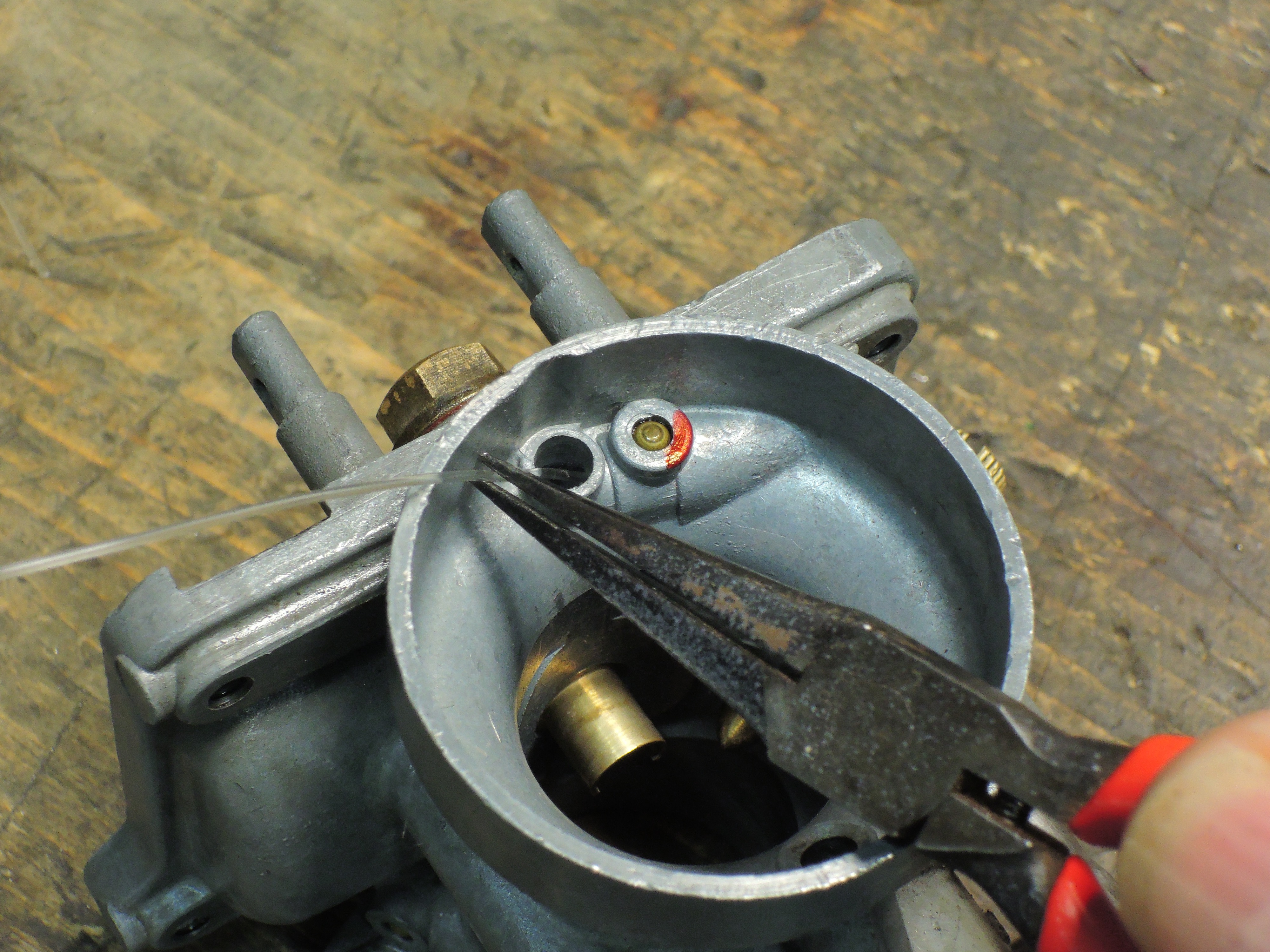

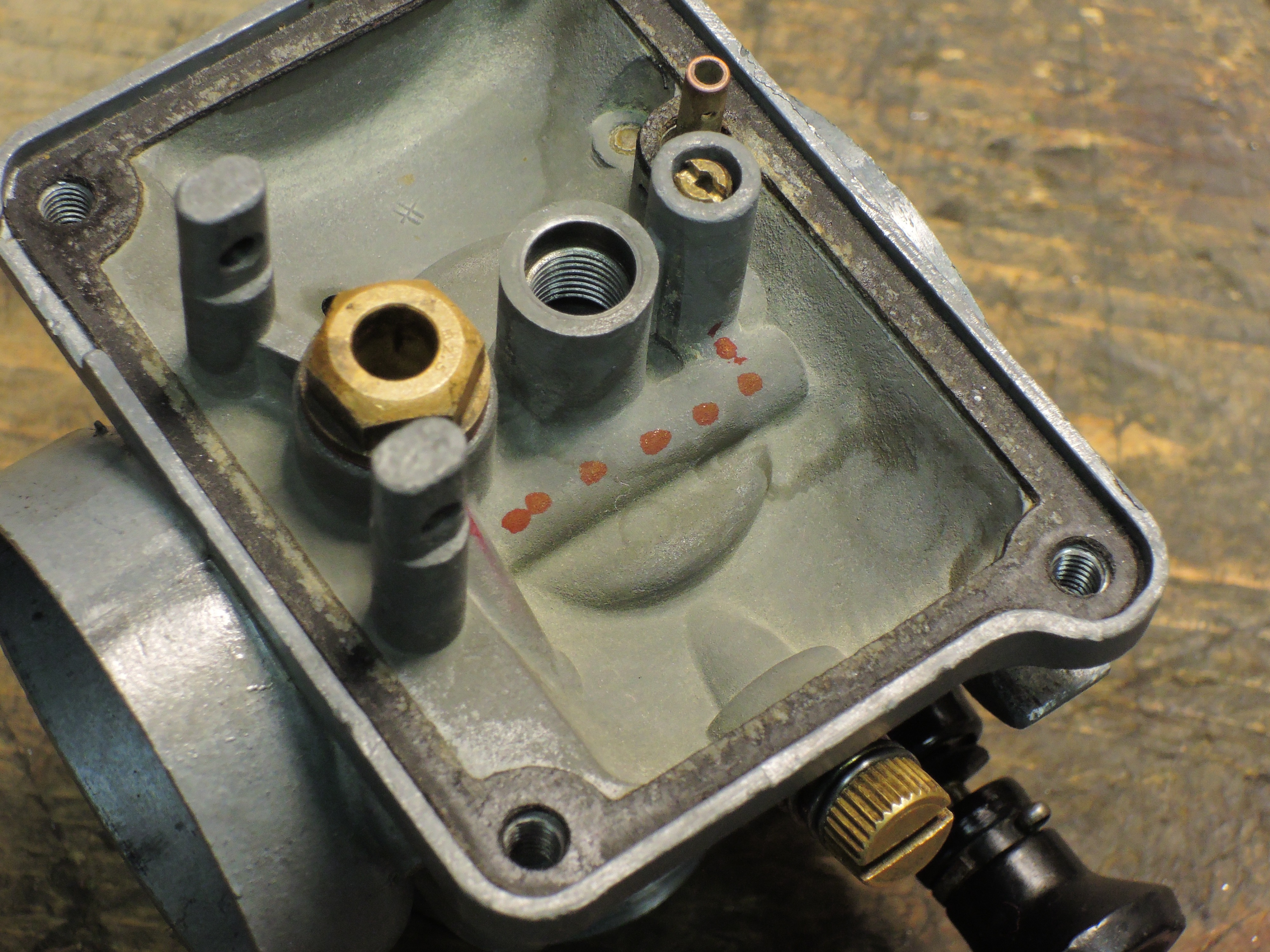

Another update. The passageway between the pilot jet and the air screw has two right turns. When I squirted carb cleaner in either end it came out several places making it look like it was clear but it wasn't. Several squirts of carb cleaner and air along with some difficult threading of monofilament finally cleared it. I then was finally able to get a response from the air screw. Unfortunately it still has poor response coming off of idle. I even removed my longer intake tract to see if that had any effect and it didn't. I now think I'll try the #2 slide as soon as I locate one. As always I'm open for ideas.
BTW this pilot jet is short.
