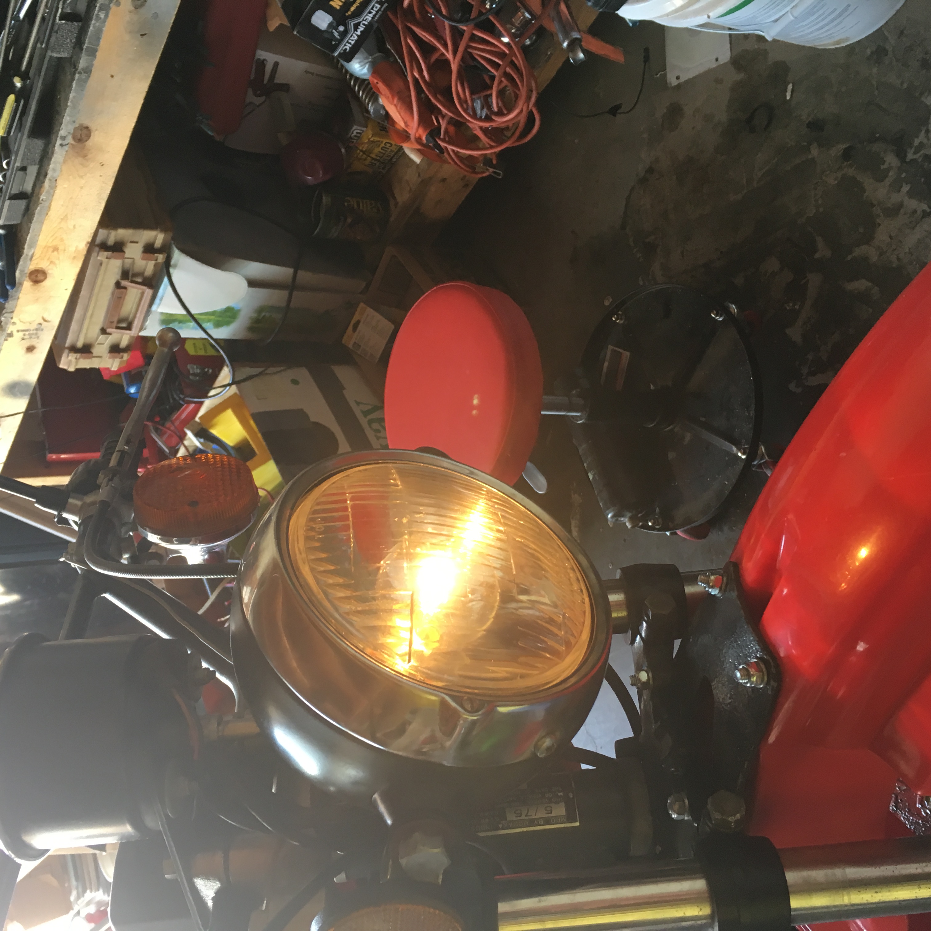

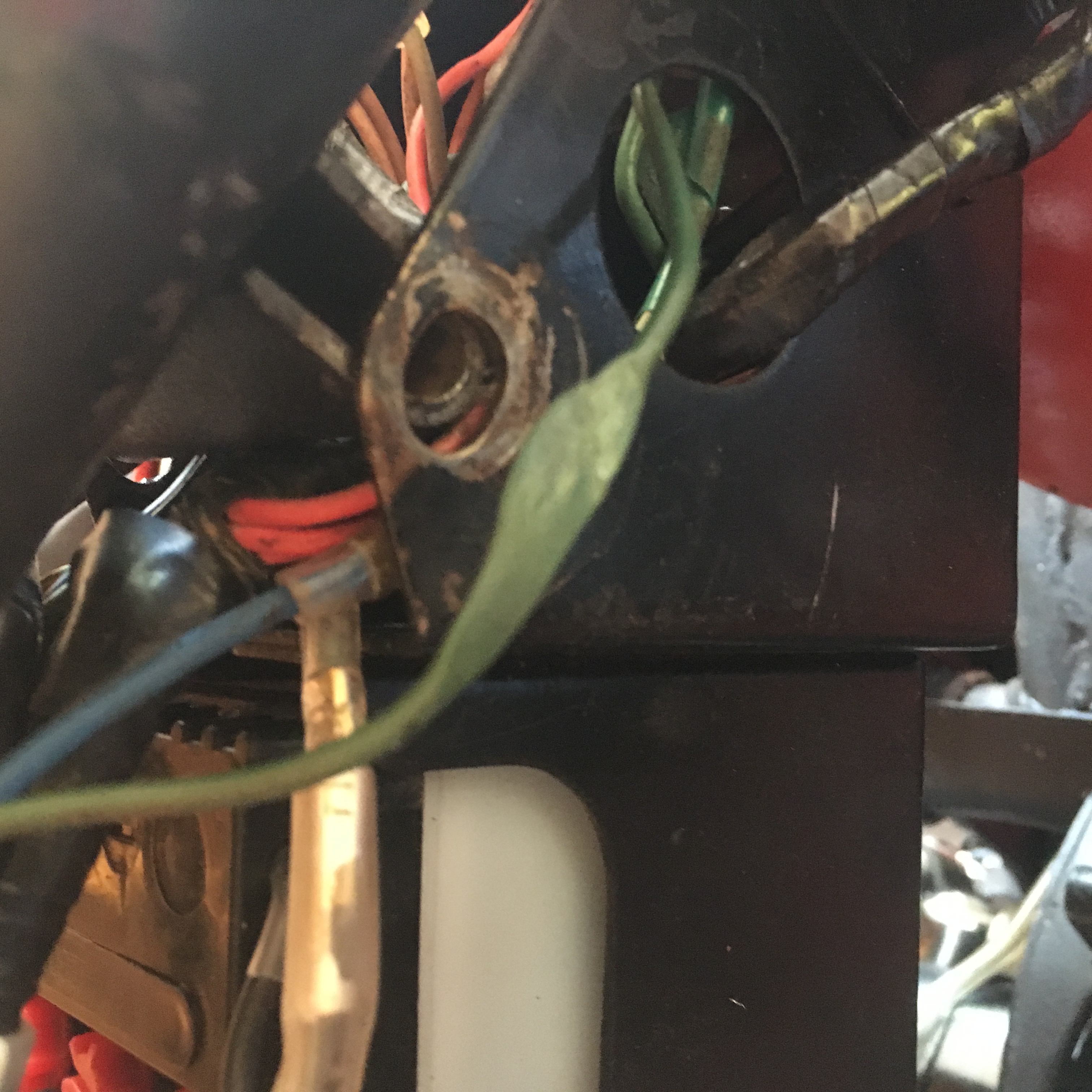

Well, I think I found the “new” cause! I guess I’ll have to cut & splice! :ugeek: Victor

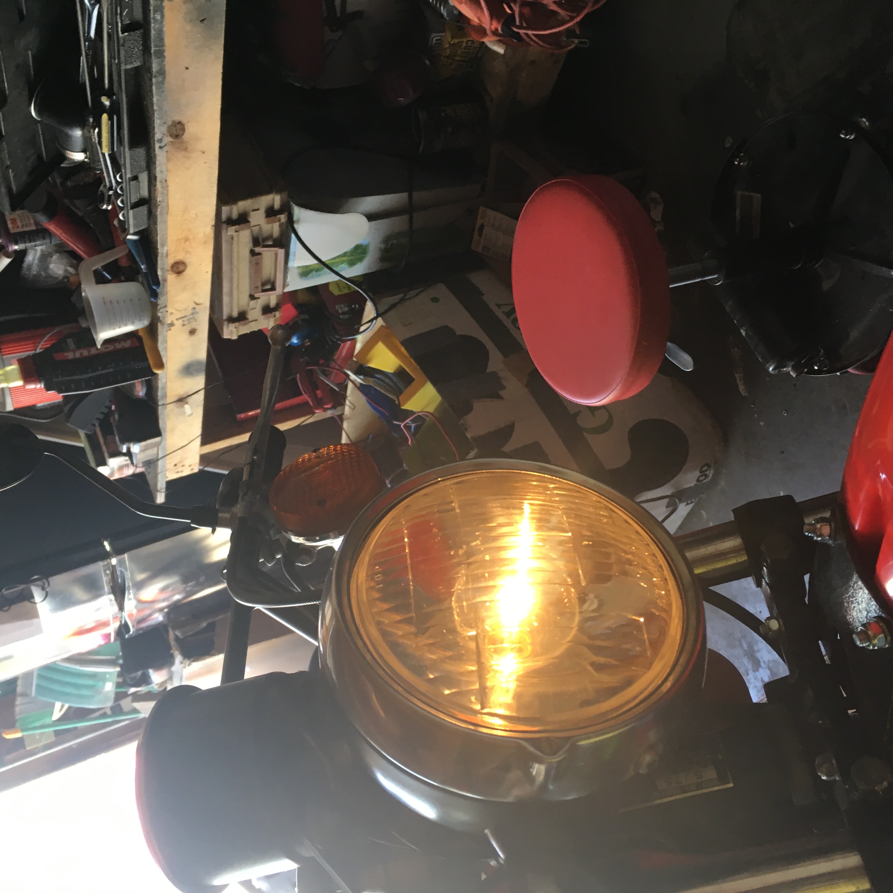

That was it! :ugeek: Victor
Low Beam
Low Beam
High Beam

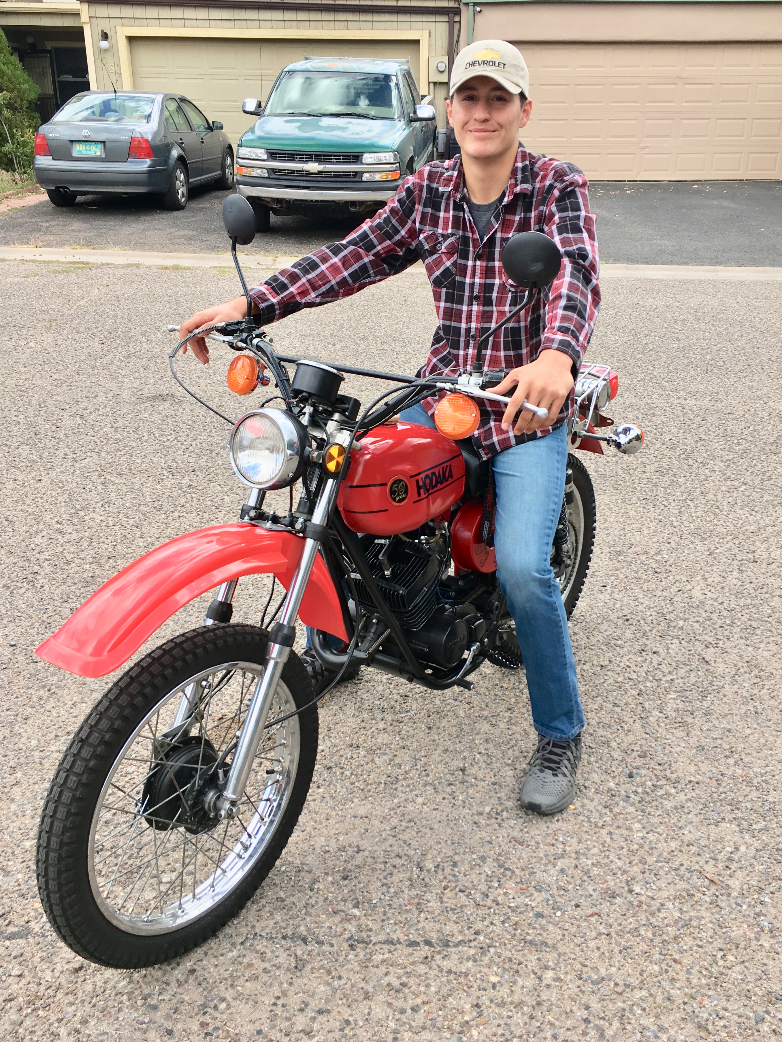

Well, Matt, I won’t be buzzing around town on it, my nephew, Jonah will be doing that. And he graduates high school this year & he’s looking forward to taking the bike with him to college & using it on campus! Being 6’4” he does make that Road Toad look small! :ugeek: Victor
Then he will, for sure, have the coolest scooter on campus (and the lowest fuel bills too). He looks good on it to boot. Very nice to hook him up like that!

Matt. He worked very hard on this bike with me! Constantly calling & messaging me “When can we work on the bike again?” Amazing to me since he’s a Senior & was on both the football & basketball teams at Santa Fe High School!
