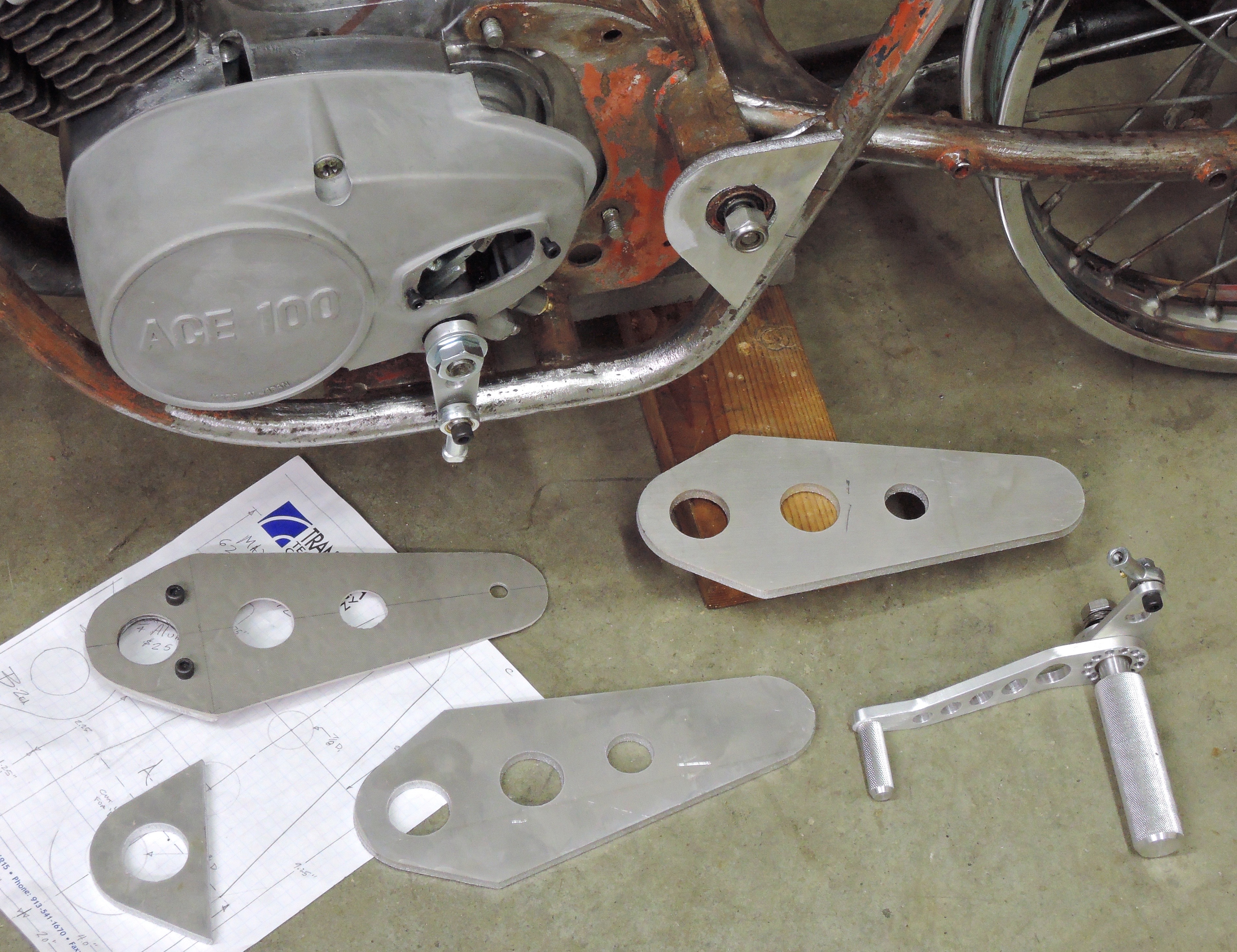

The project and I have fallen behind a bit due to a new unobtainum knee being installed on the builder three weeks ago. All is well and I'm on the move again. Today I could actually drive a car and go and retrieve the rearset plates from the metal fab shop. I could have cut the plates with hand tools but I thought it would be easier to have them cut out on a local robot plasma cutter. The holes are not as smooth as I had hoped but it all looks as though this will work. I had already built the spacers but had some new ones cut out on the run to better match the plates. They now can be clamped together and the edges smoothed in the same operation. Here's a shot of the progress and concept so far.
Rearset plates in progress!

Looks good !!
Remember, with any digital project, a circle is not a circle, but a many-sided polygon. The number of sides depends on the digital resolution of the CAD cutting table and the width of the plasma beam (the "kerf").

Having the rear-set brackets cut out by high tech means certainly eases the time spent with a file compared to mfging by hacksaw and vice! Looking pretty nifty?
