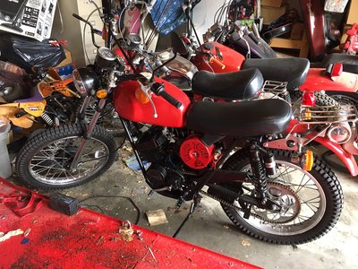

Before...
Before...
After!!!
After!!!

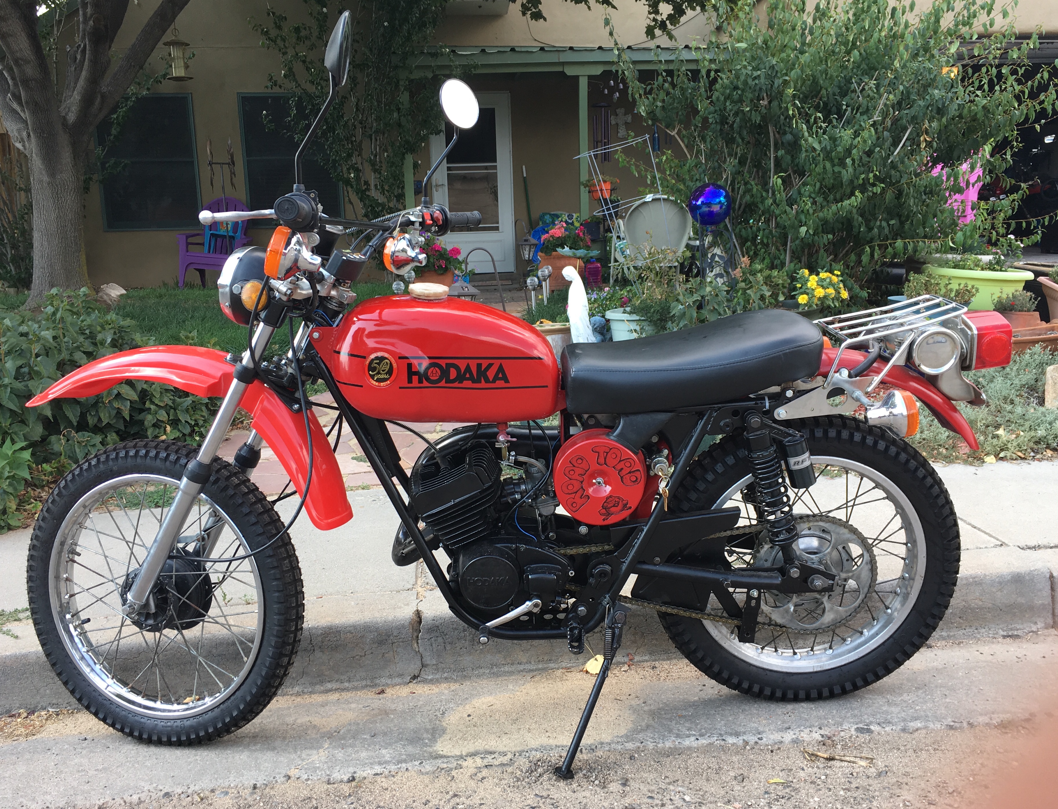

That looks amazing, Victor! I love the red.
My nephew saw the OEM Green and said “Does it have to be THAT GREEN?” I told him it could be any color he wanted, and he chose Red. In fact, it’s GM Victory Red! I think it matches the UFO Red really well! :ugeek: Victor

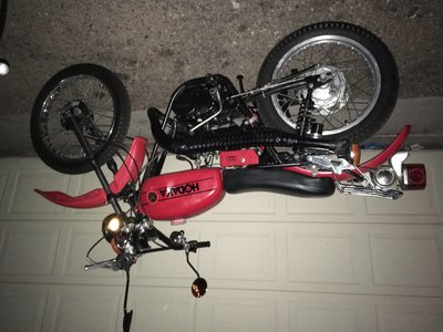

OK. I wish to officially announce, this “Red Toad” is DONE! Finished! Ready to to go MVD for titling & licensing! Finuto! Fine!
All electricals now work! Head light, tail light, brake light from both switches, horn & both turn signals, with a keyed switch which turns everything on & off! The only OEM piece I couldn’t make functional was the OEM kill switch but I mounted another right next to it!
A moment of silence to the Toad Newby Geek who struggled through, and with repeated help from numerous folks on this forum, managed to make a spare frame & some miscelanious parts into a complete, functional Red (Road) Toad!!! Amen.
On to finishing the Green Toad!!! :ugeek: Victor
OK! Just one pic in front of the garage door!!! :ugeek: Victor

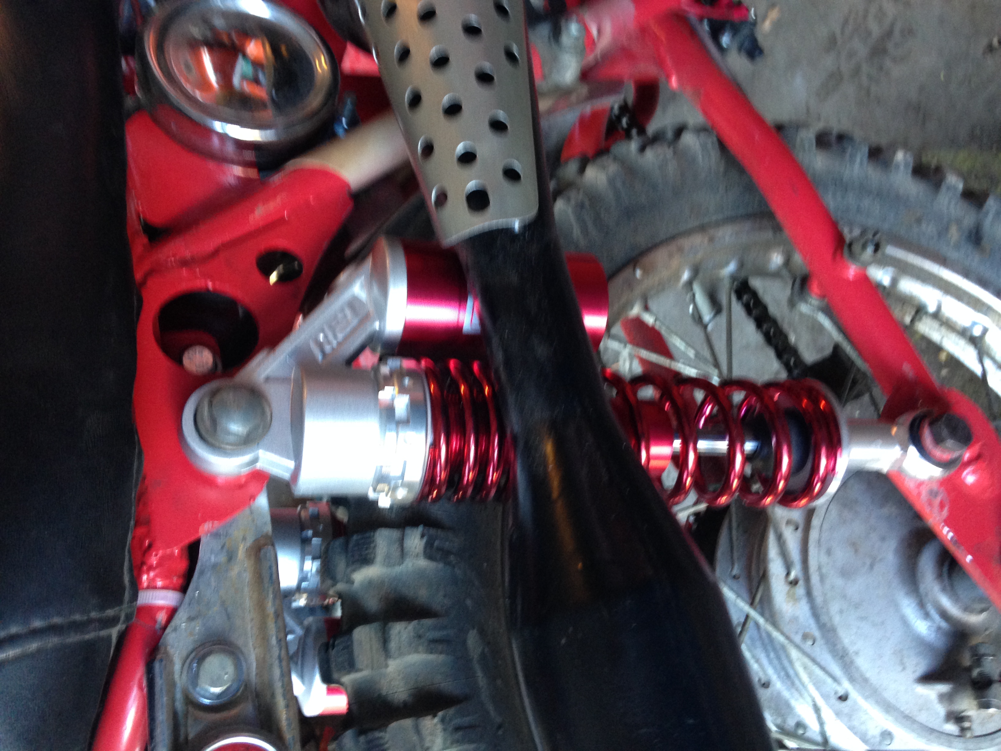

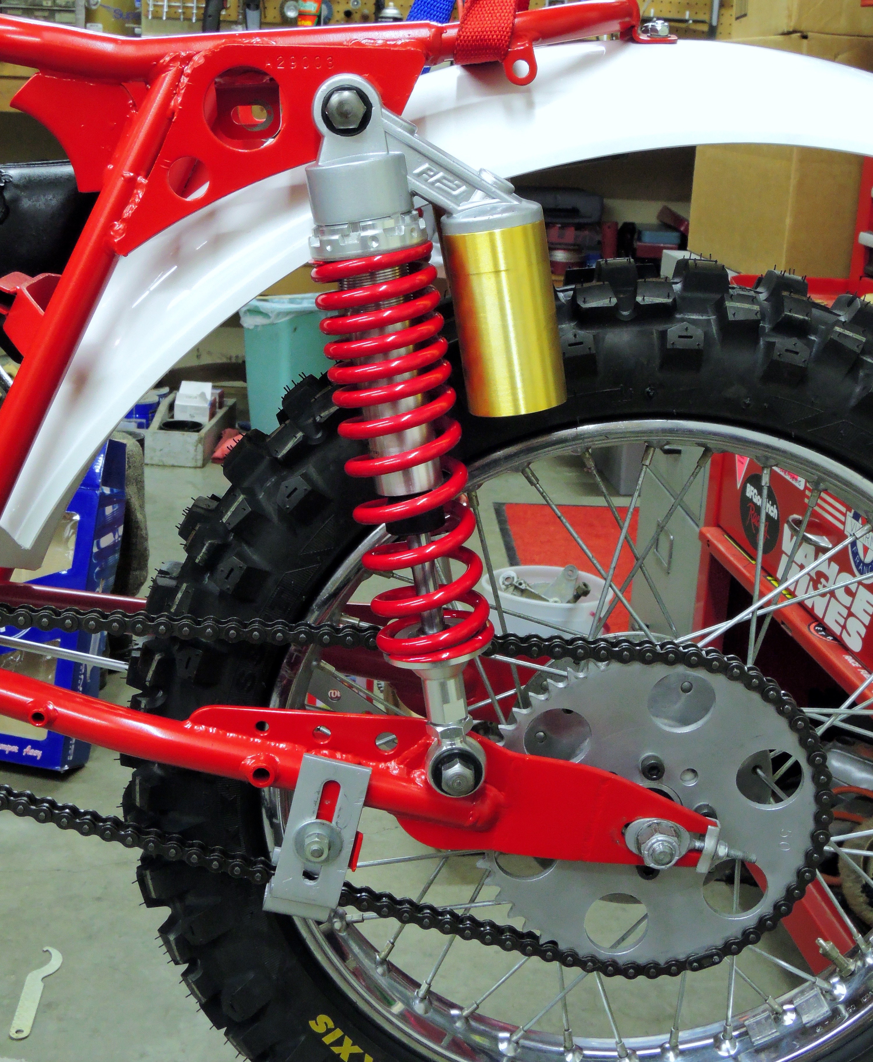

Victor Where did you get the rear shocks you used and do they work well? ----------- Clarence
They work Very well! I bought them on eBay from a supplier. I have them on both Toads & also on the Ace!
They cost me $68 a pair, shipped. I have the old invoice, but it doesn’t list the seller’s name. They were shipped directly from China. :ugeek: Victor
Hey Clarence, I put a pair on the Day One project. They seemed to work, looked cool, cheap. There's even a place that services them if I can find it. Not a big investment. I'm happy so far but I haven't really thrashed them either.
Kinda sassy
Kinda sassy
Max’s are very similar to mine! Here’s the Ace with a set! :ugeek: Victor

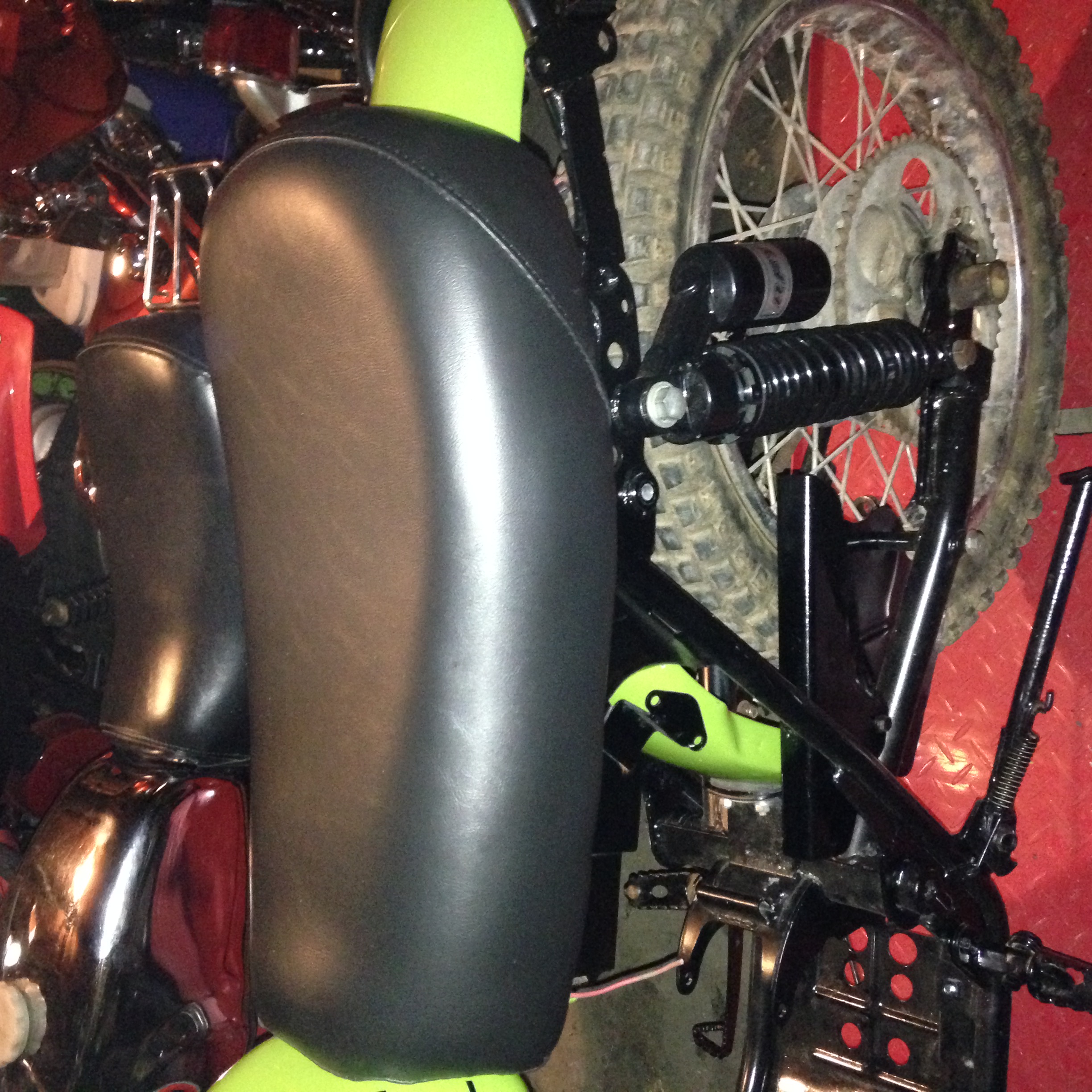

And I have black ones on the Toads! :ugeek: Victor
