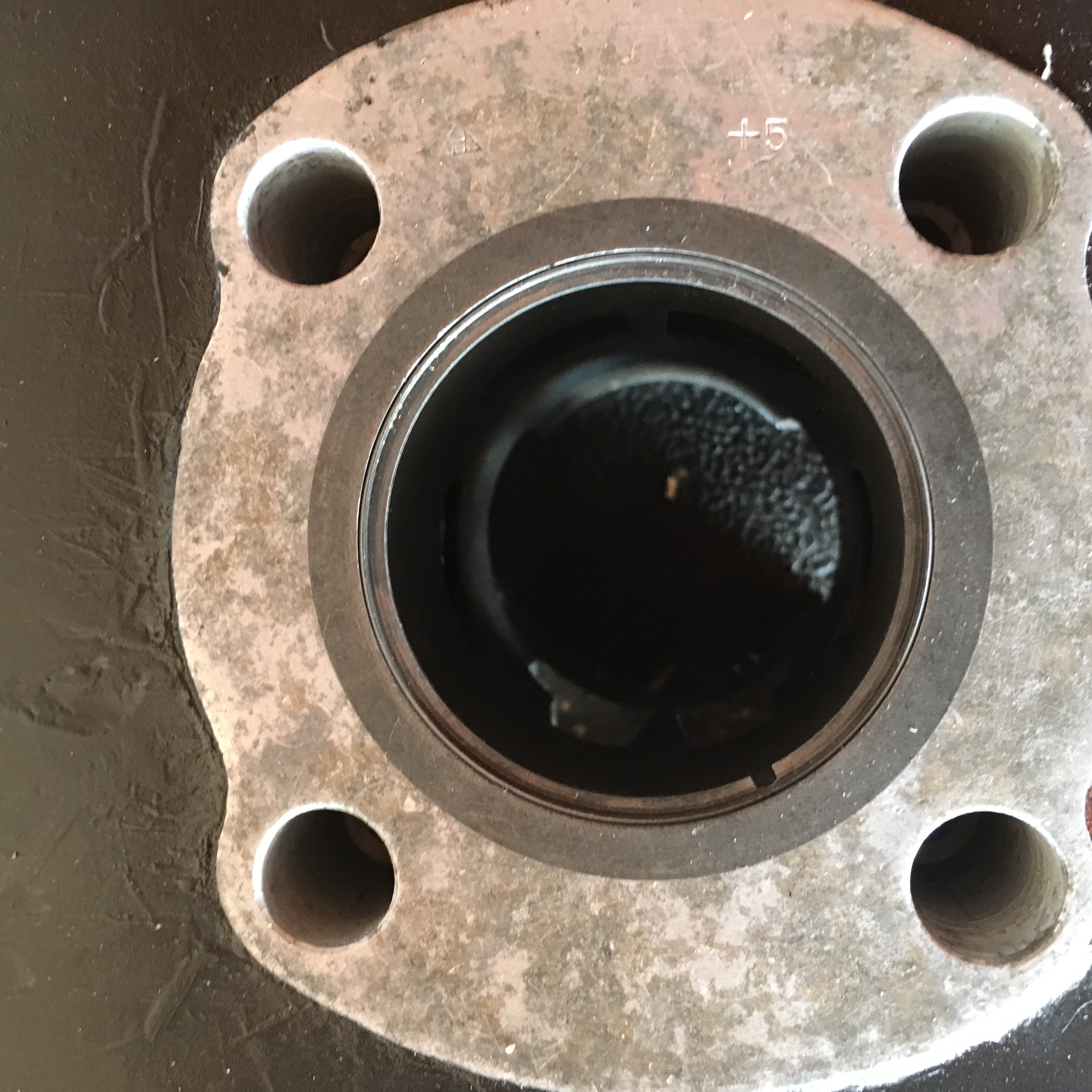

OK! First off I want to say Happy Thanksgiving to all the Hodaka forum members!
It's not too cold today & I had some time. So, first off I pulled the piston from the rod. I also set the top dykes ring, which was having trouble with clearance while on the piston, into the top of the cylinder. It seems to fit fine without the piston, & it appeared to have a gap roughly almost twice as wide as the pin on the piston, from the top side of the cylinder (see first photo).
When I insert the piston ring in the lower side of the jug the gap is a little bit larger, but not by much, visually (see second photo). If really needed, I could attempt to measure the pun gap with the ring as level as I can make it at both ends, but I guess my point is there doesn't seem to be a reason why this .020 piston won't go in the jug with this ring on it. There appears to be enough clearance for the ring, albeit slightly tighter at the top of the cylinder than the bottom.
Piston with the lower ring goes right in and fits snug but moves even without being oiled (only slid it a tiny bit).
OK. So now I put both rings on and it goes right into the cylinder without effort when I colapse the rings with my fingers!!!
So, why is it being so difficult when the piston is in the rod??? Thoughts? ; D Victor

Here's a side view of the piston, with both rings in place, sitting inside the cylinder! It's even oriented with the intake ports on the piston lined up with the intake ports on the cylinder.
Why the HECK would there be problems getting it into the cylinder with it connected to the rod??? It's not like this is my "first piston rodeo?!?!?!" ; D Victor
