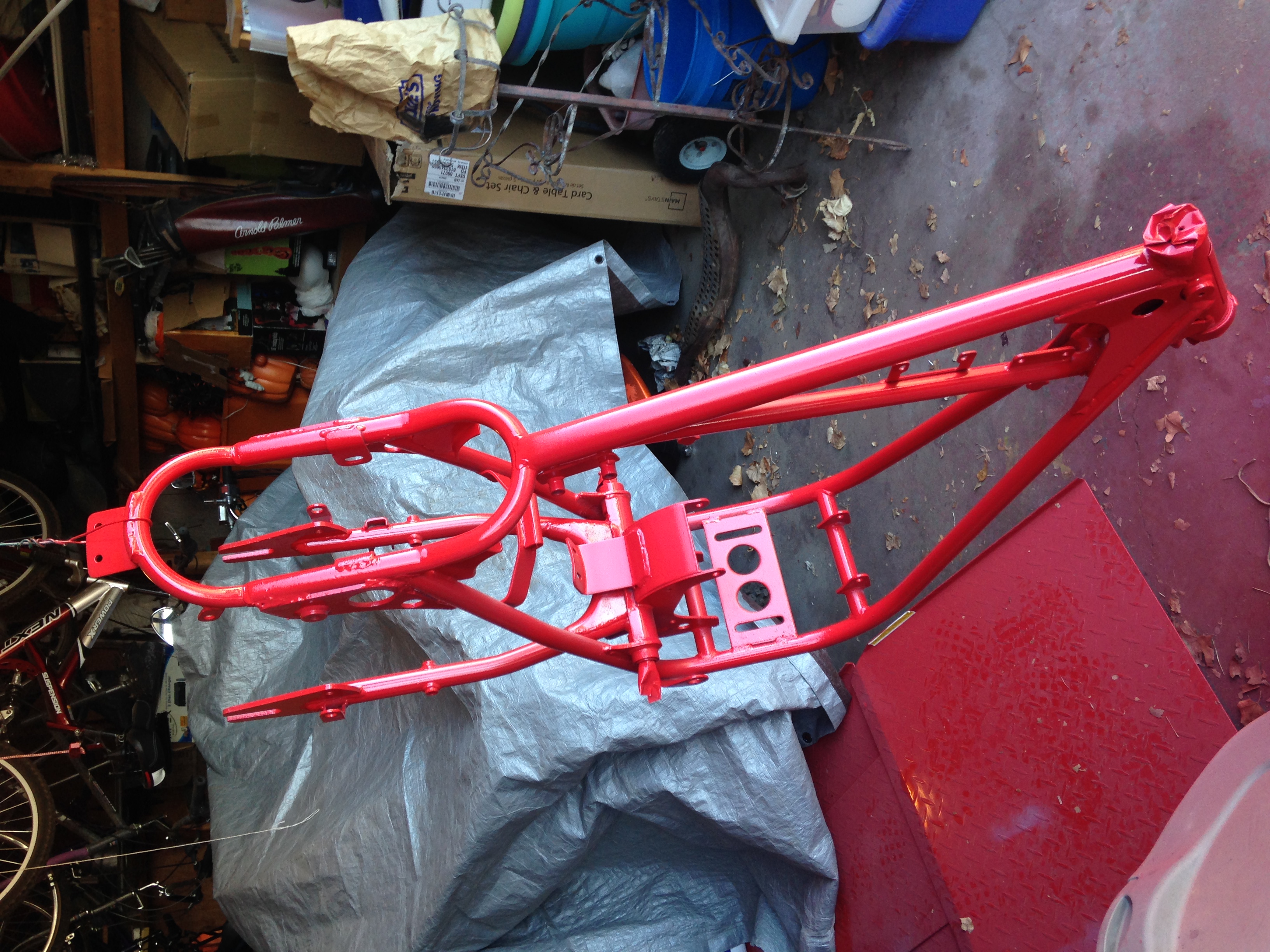

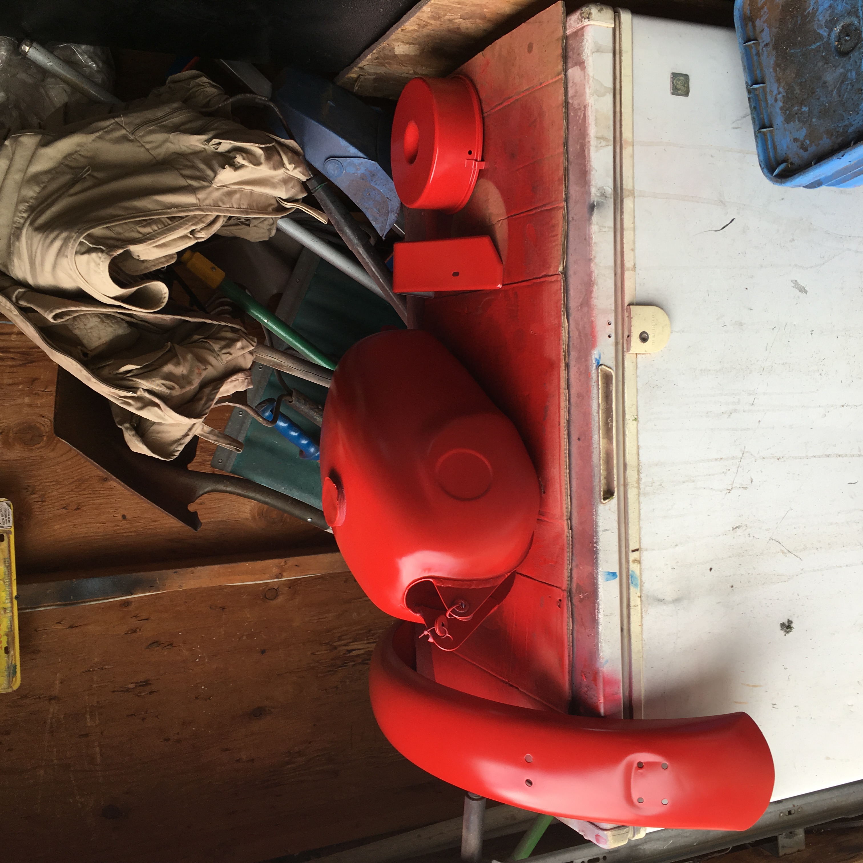

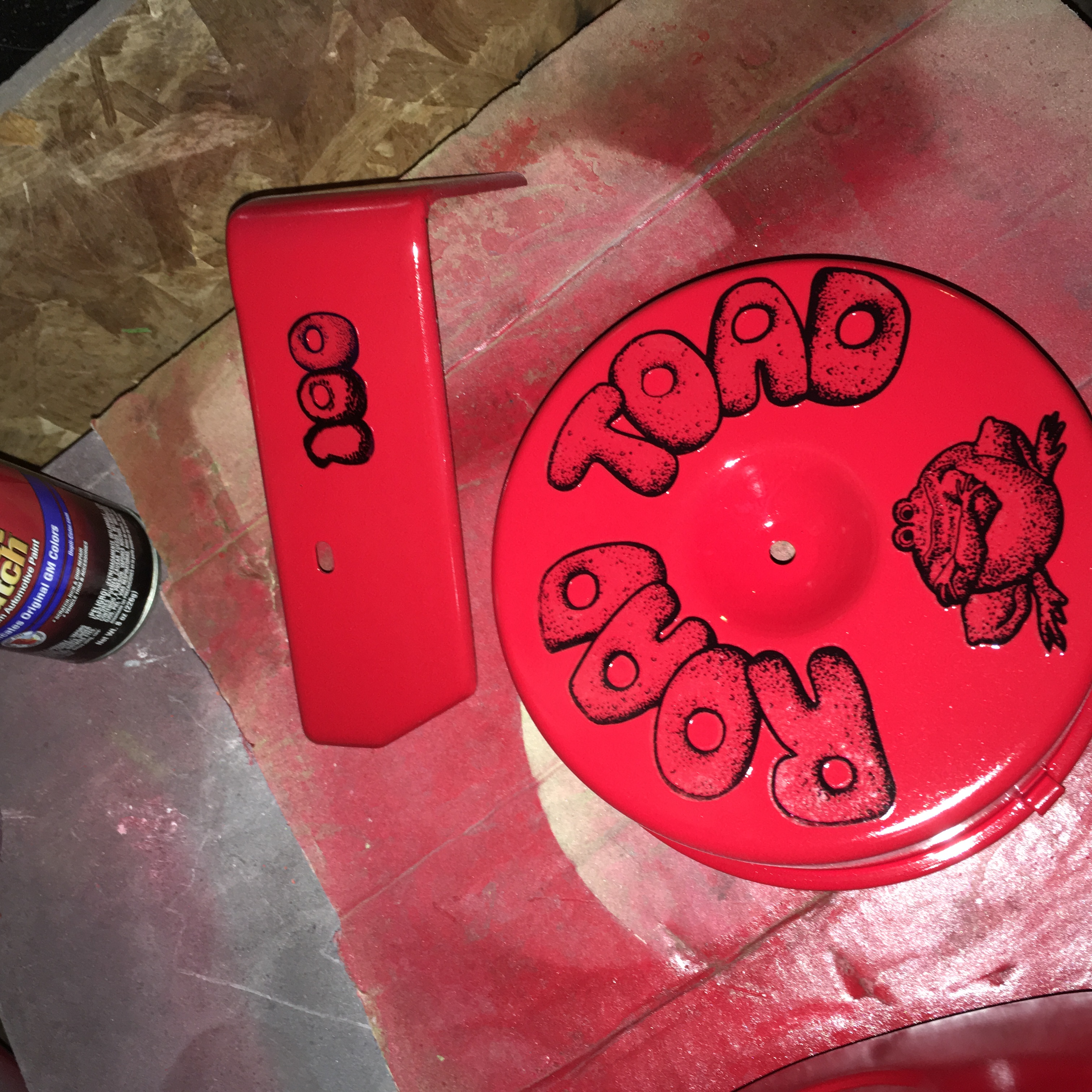

I used Rustoleum Red for my Ace Frame, and so did Maxie, I believe. Works well, especially with a gray primer underneath! At O'Riley's I found smaller cans of Chevrolet red (Victory Red), and it looks great too! I did my second Toad with this and the matching clear coat they sell to go with it!
Ace frame with Rustoleum Red

Air cleaner & battery cover with graphics & clear coat
The stock orange-red of the airfilter cover just doesn't work for me. My mental image has it being a red, and it looks too much like a pumpkin. I'll look into your and Max's red. And I have the choice of a couple of "Wombat" decal color combos. :)
Posts: 4845
I guess SH offers the original color. But for me, I just ran to the local Big Box store and got the Rustoleum because it was close enough and didn't have to wait for shipping.
I will tell you that the Chevy red is so close that I didn't paint the inside of the air cleaner cover. I just cleaned it and really can't tell the difference! ; D Victor
If I were doing a concours resto, the SH paint would be perfect, but for my purpose the Chevy Victory Red plus clearcoat over the decal is good. I still need to order decal, so I wont worry about finishing this up til after Barbers Vintage Fest. I've got a wee palm/orbital sander that will be perfect for prepping the old tin.

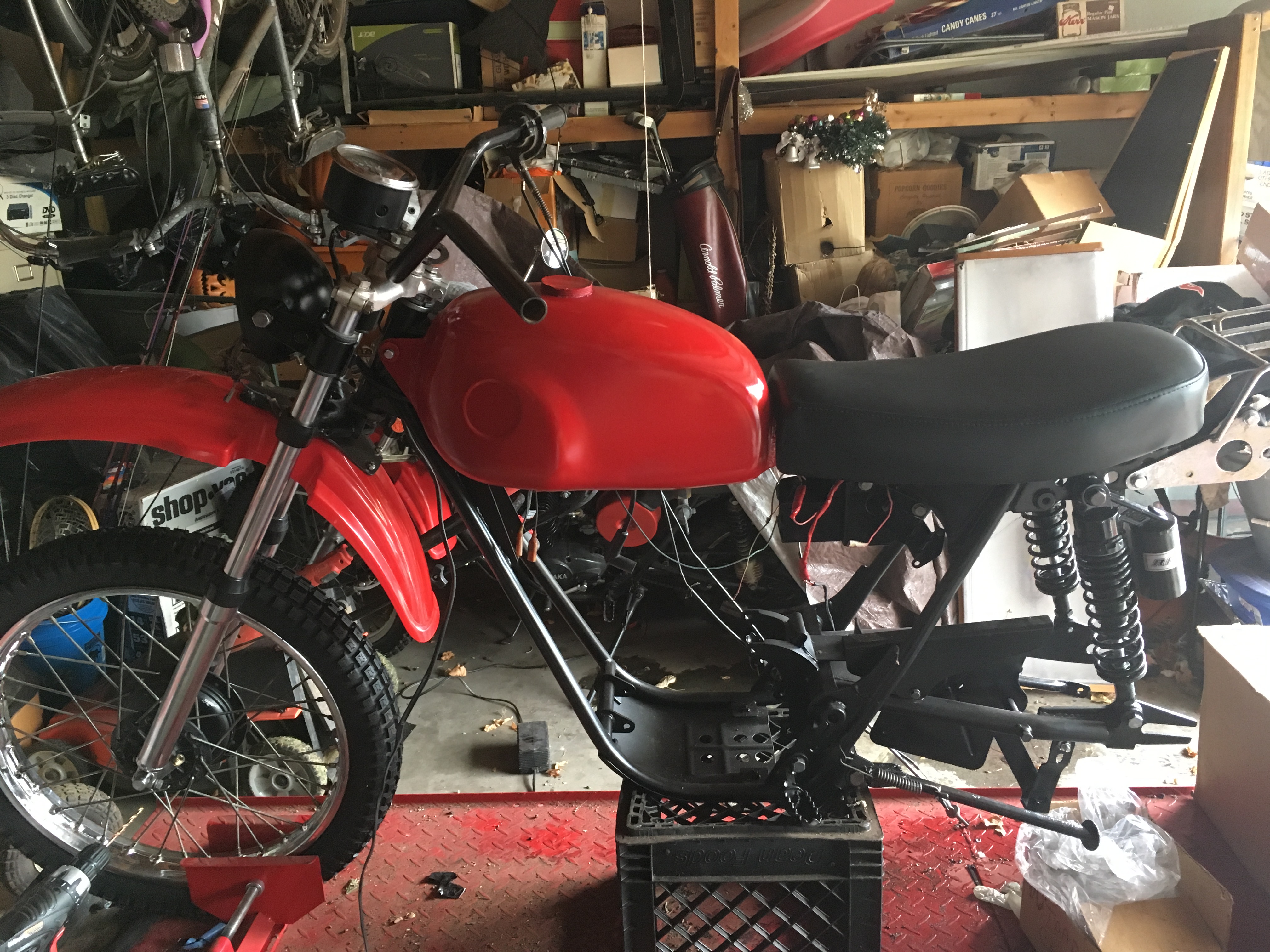

Took the seat pan I got from Bruce to my upholsterer yesterday at 3:00z. He called me this morning at 11:00 & said it is ready!!! Wow! ; D Victor
Seat and tank rough mounted

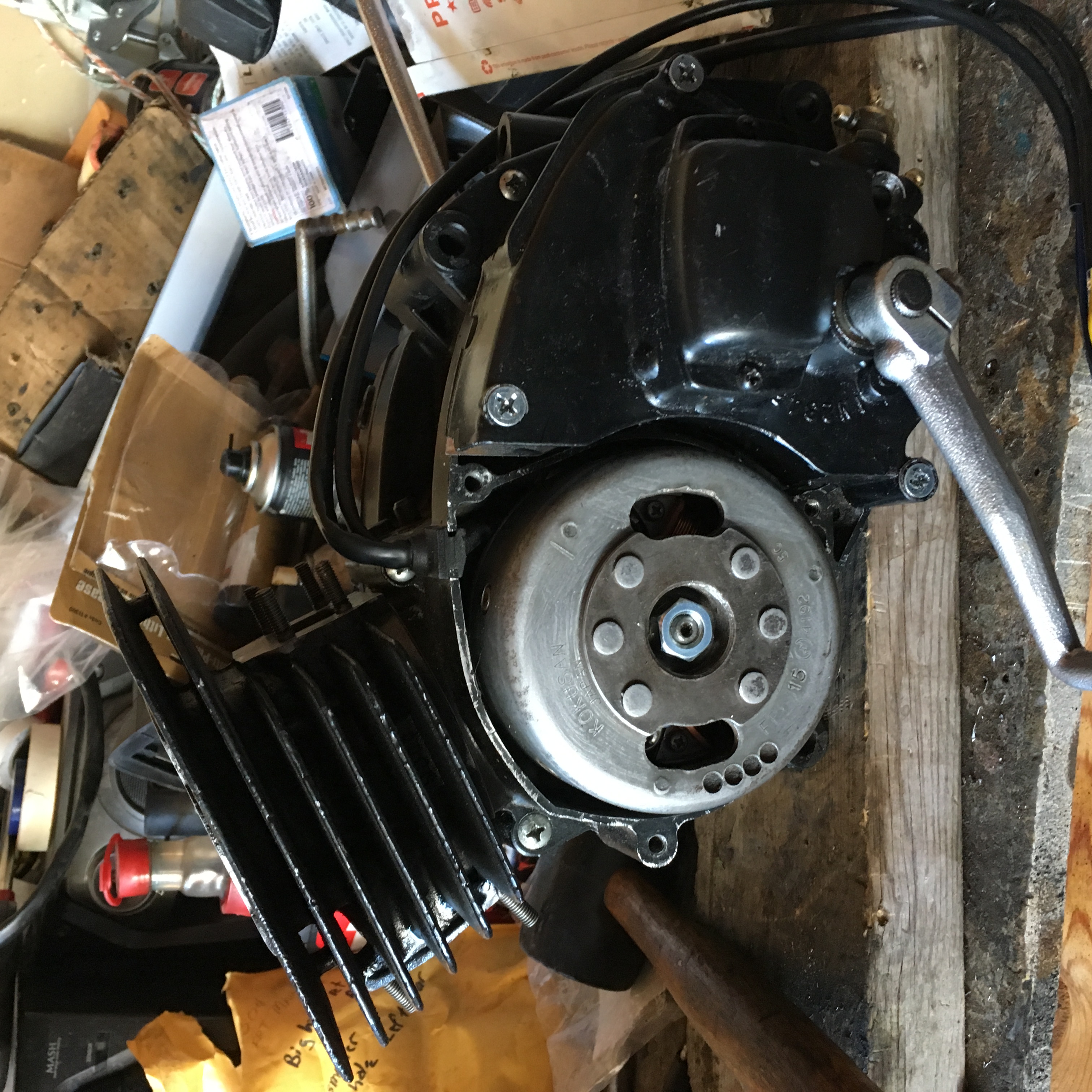

Putting the top end together, I didn't know there was a possibility that thecrings would need gapping. Every other bike I worked on in the past did not require gapping of one or more rings.
So now that we've discussed this need I will get back on it and slowly file the ring gap down until it fits with +/- .004-.008 spacing. Thanks again for saving my bacon! And Ed, I'll turn the dykes ring over so that it's mounted like your electronic picture. !_(piston)_! ; D Victor

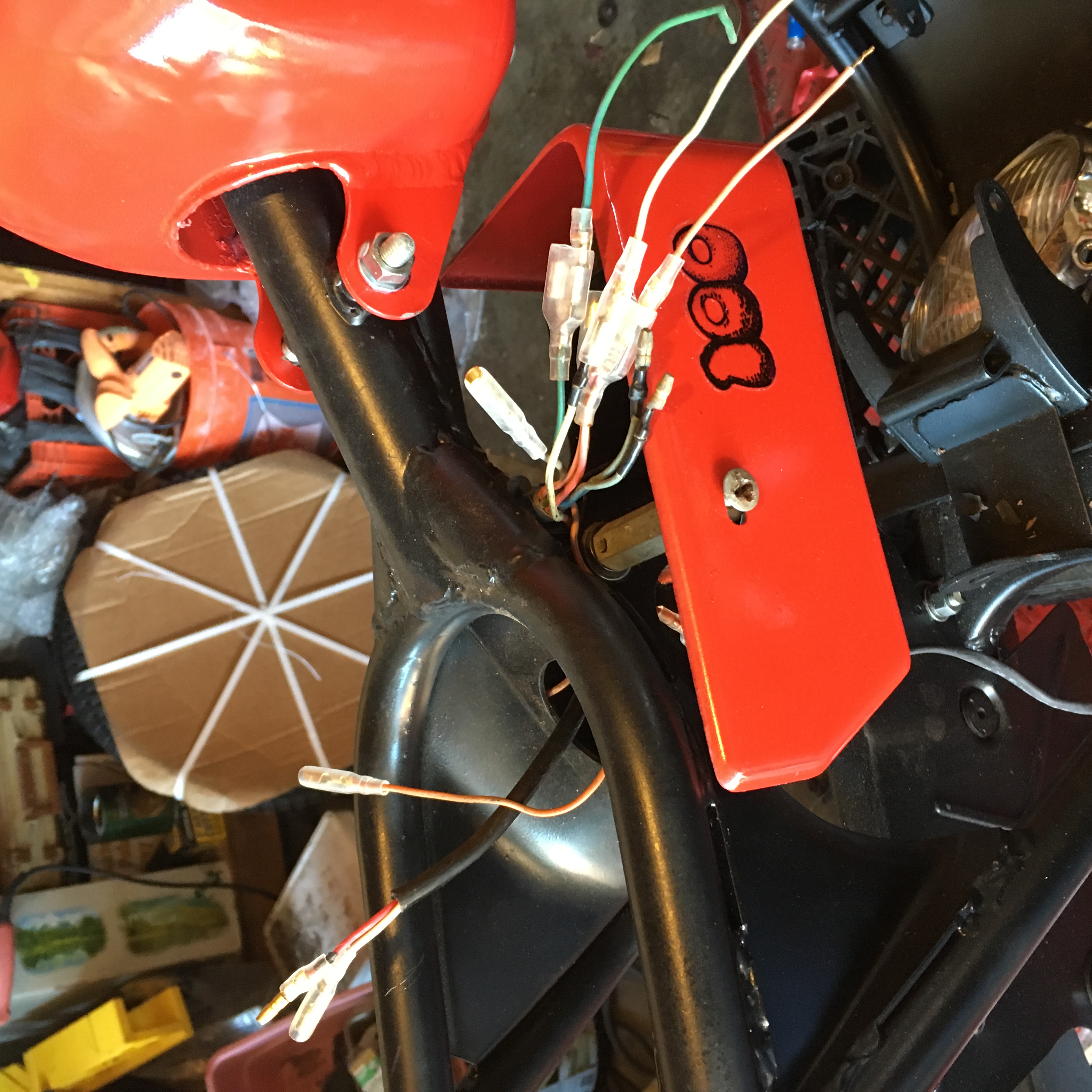

Spent some time today working on wire ends. New bullets & female connectors on almost all that needed them with new insulators! Worked in head light bucket too! ; D Victor

Circlips are in place. No I need some warmth to drop the cylinder on. Put the gaskets and I can close it up! ; D Victor

Yah Hoo! I got it on! Now I can move forward! It was cold and things went together snugly but it's on! Need to add a bit more 2 stroke oil to the rings/cylinder so things move more smoothly! The trick with the pencils as the Tuning Fork worked very well! ; D Victor

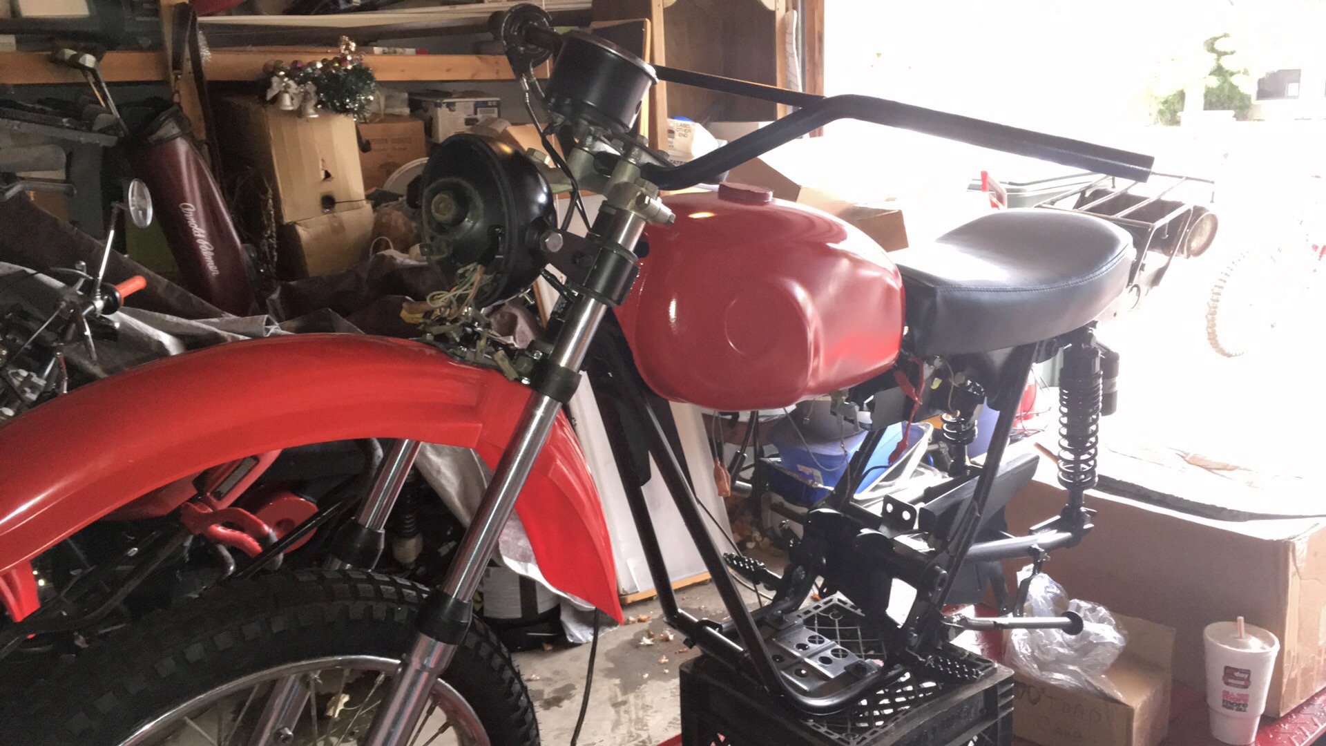

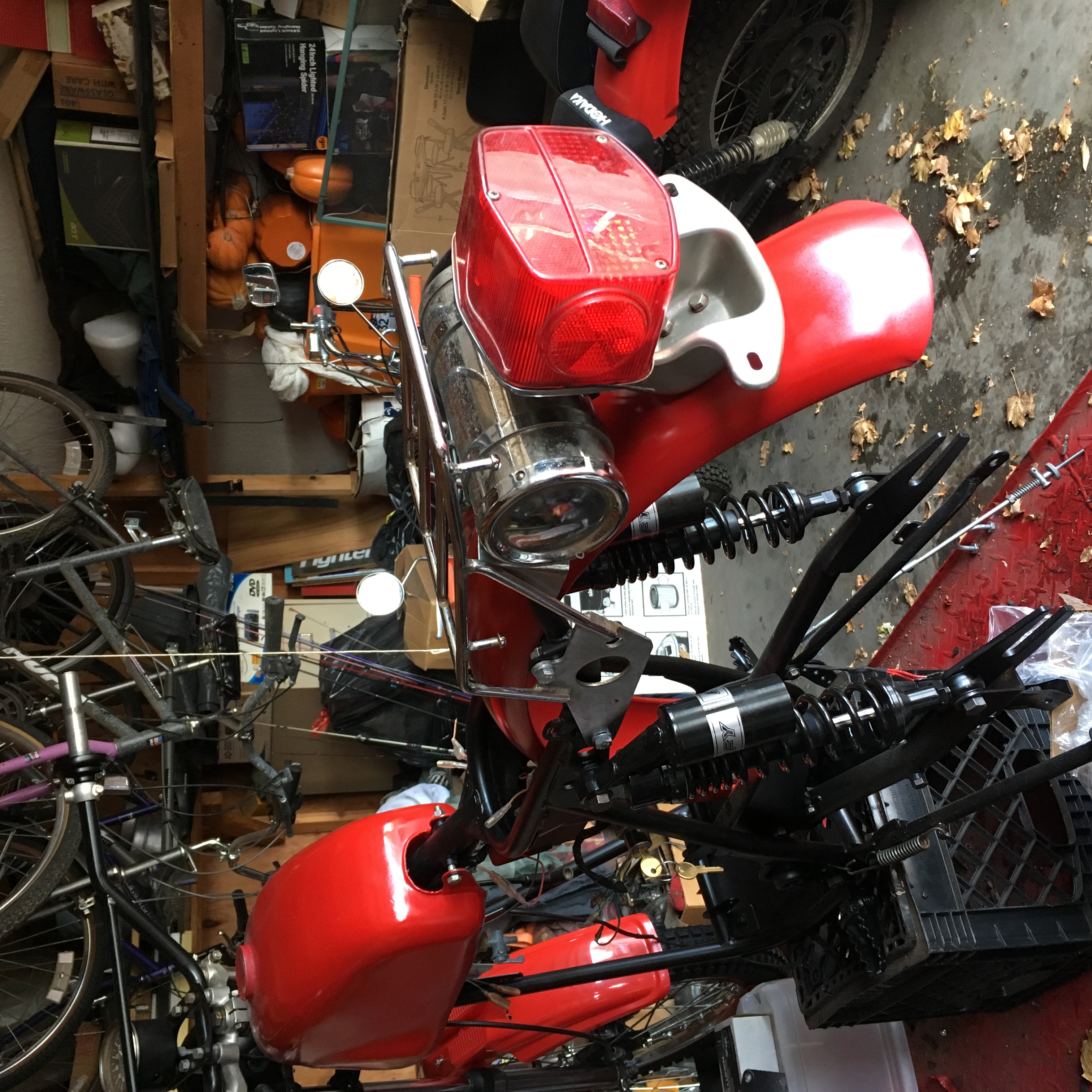

More work completed today. Fixed the rear fender paint & got it mounted. Damn rubber pads are a PAIN to push back through those holes! Took me nearly an hour of pushing and tugging, but the fender is mounted. Also mounted and wired up the rear tail light.

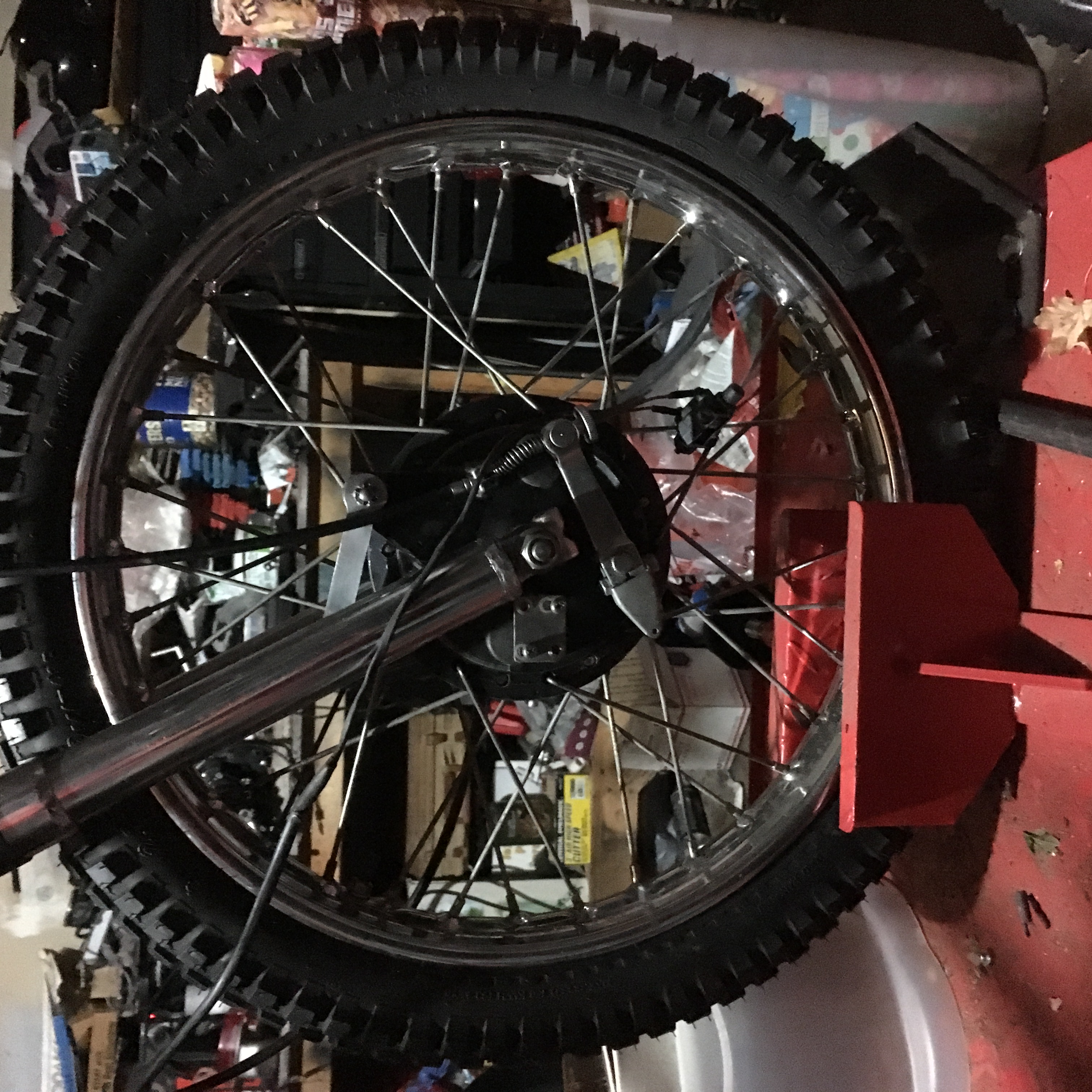

Then I had to pull the front axle to realign the brake hub. Got it adjusted and mounted and the axle reinstalled. Connected the hub retainer bar and connected the wires to the front brake switch. Couldn't mount the switch because I didn't have the correct screws to mount it, so off to the store tomorrow!
Installed the front brake cable, the brake arm and adjusted. Also mounted the kill switch on the front brake perch. The wires were cut off so I added some bullet connectors & need to get some black & blue wire to run down to the female plugs under the tank. Also added the rear brake switch wires and switch but again need the screws to mount to the plate. Here's a couple of new pics of today's progress! ; D Victor
Posts: 4845
I thought the brake switches were held together with screws to the backing plate. Turns out they are riveted together. In my searching through boxes of parts I found 2 more switches which weren't separated from their backing plates! Good news for me! I didn't have long enough rivets! All the turn signals are mounted now & I mounted the non-broken light/turn/horn switch for this unit and wired it in. Have to pull the throttle and perch to mount the right side front turn signal assembly. But I'm just about ready to drop the motor in and finish up connecting the wiring. Son in law said he'd have the rear tire mounted for me tonight so I can get the rear wheel on! And waiting patiently on a correct Model 99 kick start lever from Bruce! Getting closer. ; D Victor
