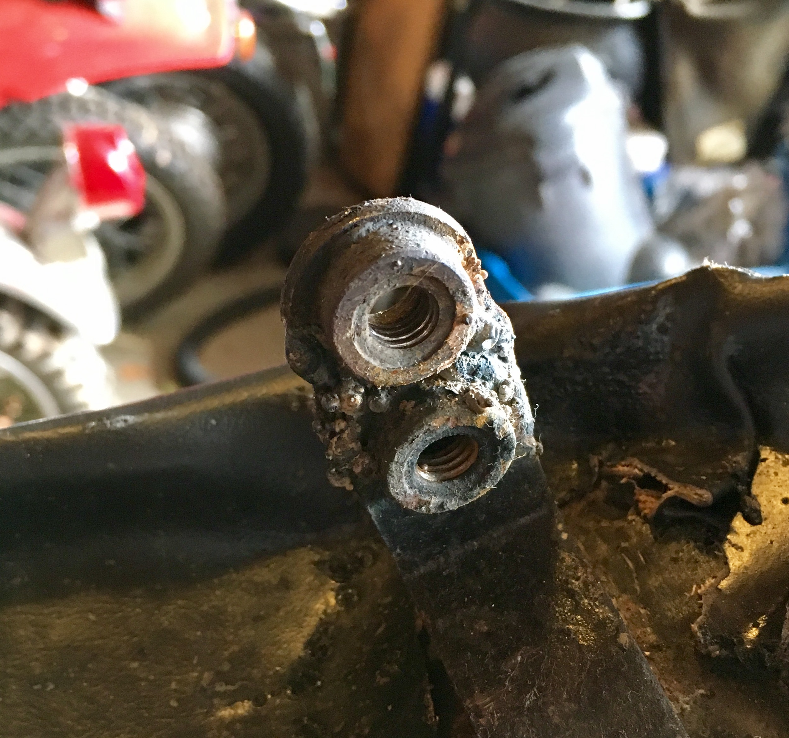

OK. I decided to take one picture of the amended seat bracket for which I did the better job of welding. The other is not nearly as clean looking. But here's what I did. Pretty easy to see! :mrgreen: Victor

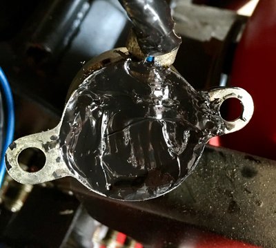

So there's no explanation for the keyed switch not working, unless it's a bad switch. I was concerned that the back of the ignition switch was not covered. I guess the locksmith took it off, and couldn't put it back on.
I asked myself what can I do about it? I cut a cardboard circle to put inside it, then brushed on some "liquid tape!" Soon as it dries I will remount the switch. On to the points check to see if the screw loosened up? :megreen: Victor
I believe that the back of the switch was not originally covered.
Ahh. Berry interesting! Well mine is now! No moisture will get in there & it won't allow any solder joints to contact the switch mount bracket either. Don't know if it was, but it's at least proventitive now! :mrgreen: Victor

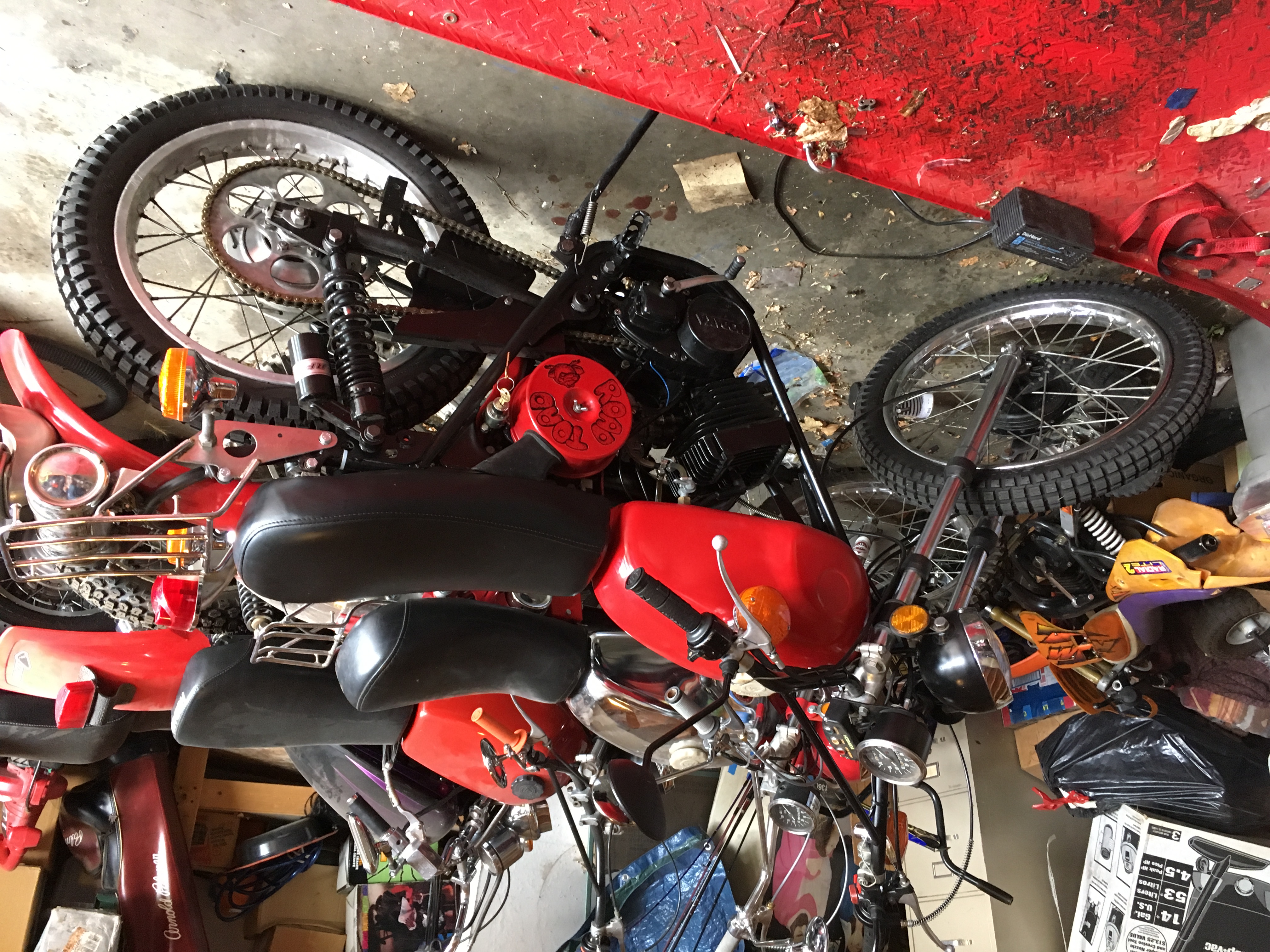

The nephew rode her today, up & down my street & around the neighborhood! Adjusted the clutch a little more, got the floats working right & also replaced the bowl gasket & one piece of fuel line. Turns out the clamp holding the fuel line to the intake tube on the carb had cut through the tube and it was dripping as well when I finished adjusting the carb.
She seems to like the 160 main jet! She starts in warm weather without the choke. Adjusted the idle down a bit so it wasn't so high, and she starts always with just one or 2 kicks and no throttle.
Also had to make a minor lossrning of the clutch cable. She was still slipping a bit on take off in first gear, but a couple of revolutions seemed to do the trick!
She's almost ready for the DMV! Still thinkin about changing the rear sprocket from a 62 to a 56 tooth. :mrgreen: :mrgreen: :mrgreen: Victor

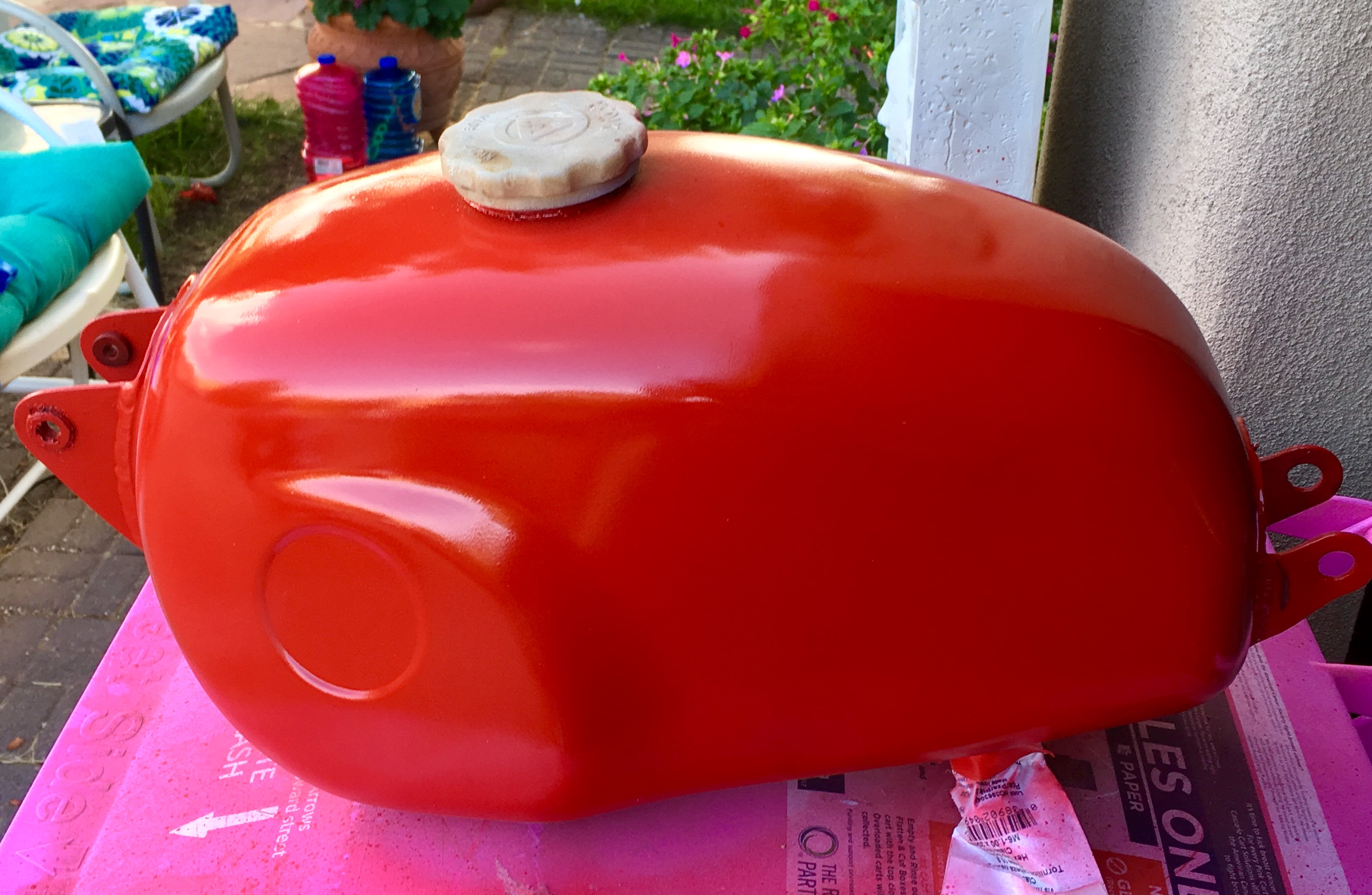

The tank got a few screatches in it, down to the primer. Don't know how, but I'll need to sand, blend spray and clear coat again. Then buff it and add the graphics. But she doesn't leak fuel any more so that's a new plus. About 98.5% there. Also still need to pull the Triple Tree and extract 2 broken screws I missed during initial mock up. They were broken off inside below the surface so I didn't see it. Need to do it so I can mount the front fender mount at 4 points and not 2. New photos to follow with her all buffed out and decals & badges on the tank!

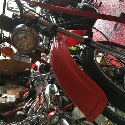

Spent 3 hours yesterday successfully dropping the Triple Trees & drilling, tapping & rethreading the lower tree for the fender mount bolts which were broken off inside the tree & put it all back together again. Also just about done with the repaint of the fuel tank! Just need to clear coat it now! :mrgreen: Victor
Mounted front fender & front wheel last night. Guess I'm getting older! I couldn't mount the front wheel solo! Had to get my grandson to lift the front end for me to be able to line everything up. Trying to finish the tank paint redo. It got scratched up and there was one section of filler which had some air holes. If I don't get it this time, I'm going to strip the tank & start again! Pics to follow! :mrgreen: Victor
I think the UFO front fender looks good!
Also got 2 good, heavy coats of clear on the fuel tank today! Almost done! :mrgreen: Victor
Got the second coat of clear coat on today. Tomorrow is wet sand with 2000 grit and buff it out. Then I can apply the graphics I've been saving! I'm sure glad I did the air cleaner graphics just black & no colored background! :mrgreen: Victor
