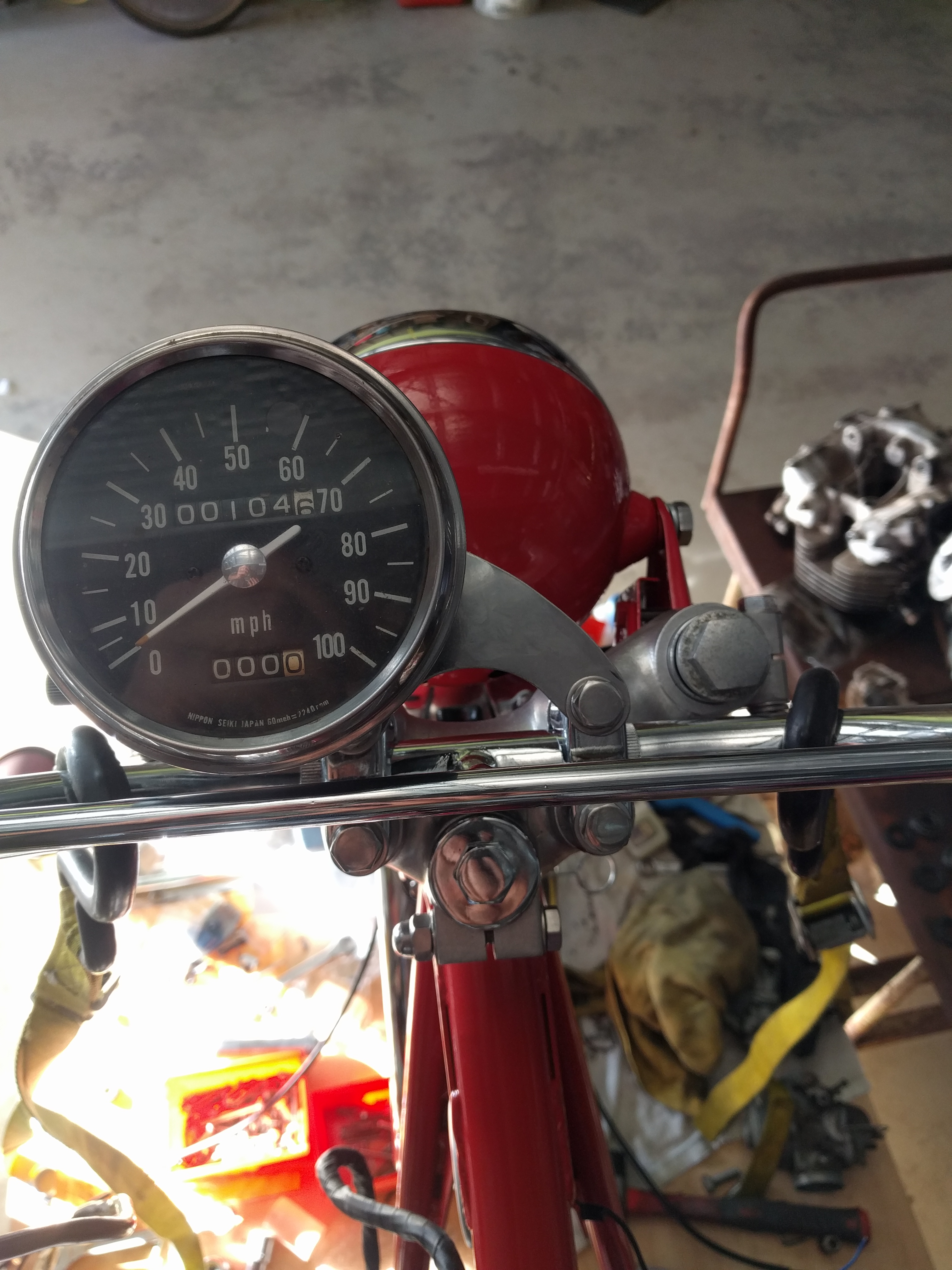

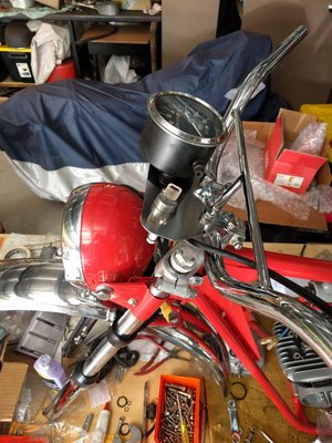

On the speedo mounting, I have the old kit lighting harness but it's in pretty bad condition. I also have what I think is a nice Ace harness. It has the 4 pin plug at one end, so guess it's for a headlight mounted ignition switch.
Think I'll make up a new handlebar bracket with the speedo to one side and the ignition switch beside it.

Had a play with the dash :D
Might get a small Squirt decal or somesuch to fill the blank spot on the dash, and see if I can find a rubber chair leg tip or similar to cover the switch base.

I see now that I'll need to reverse the dashboard so the speedo is on the same side as the speedo gearbox :(

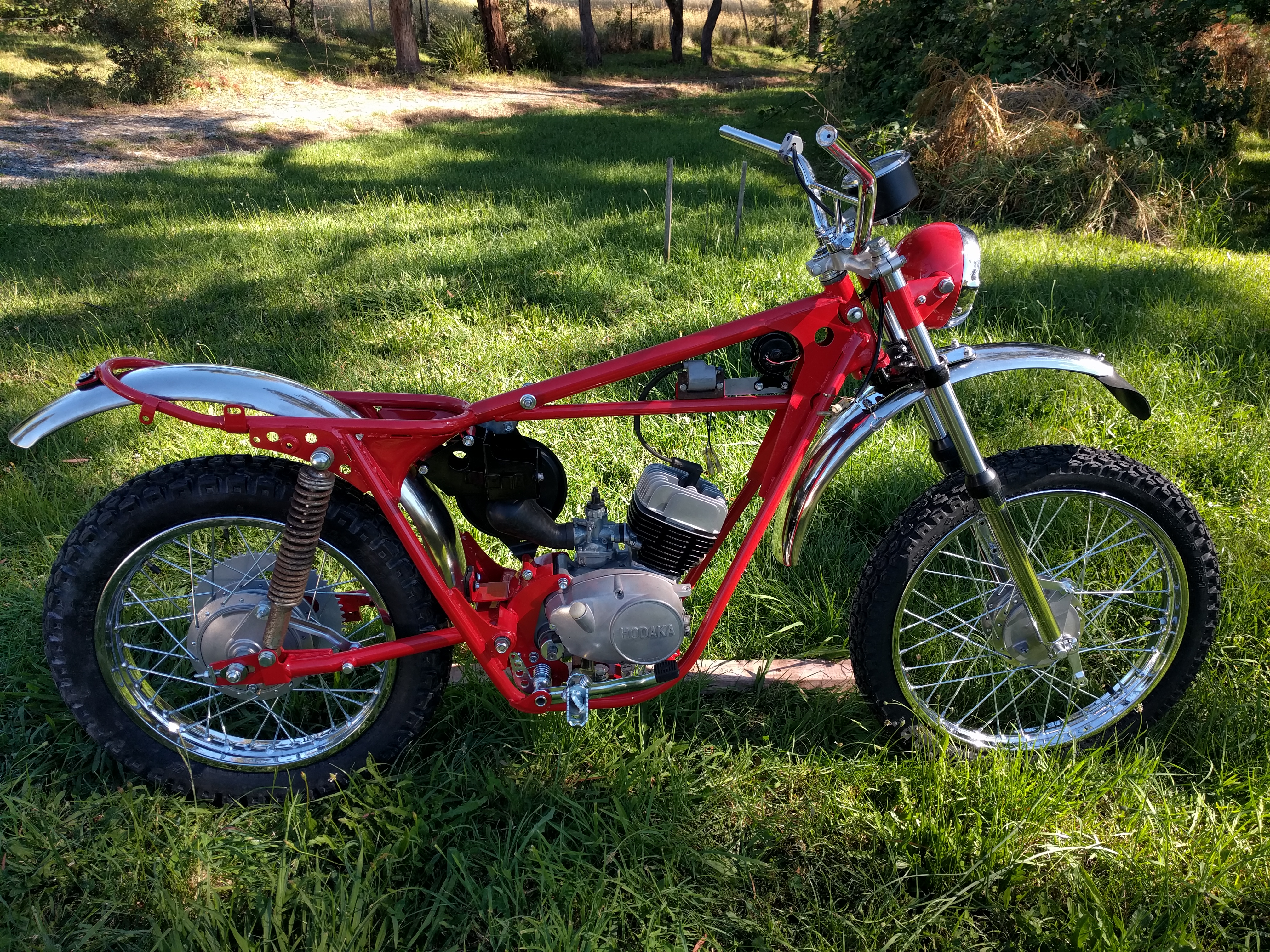

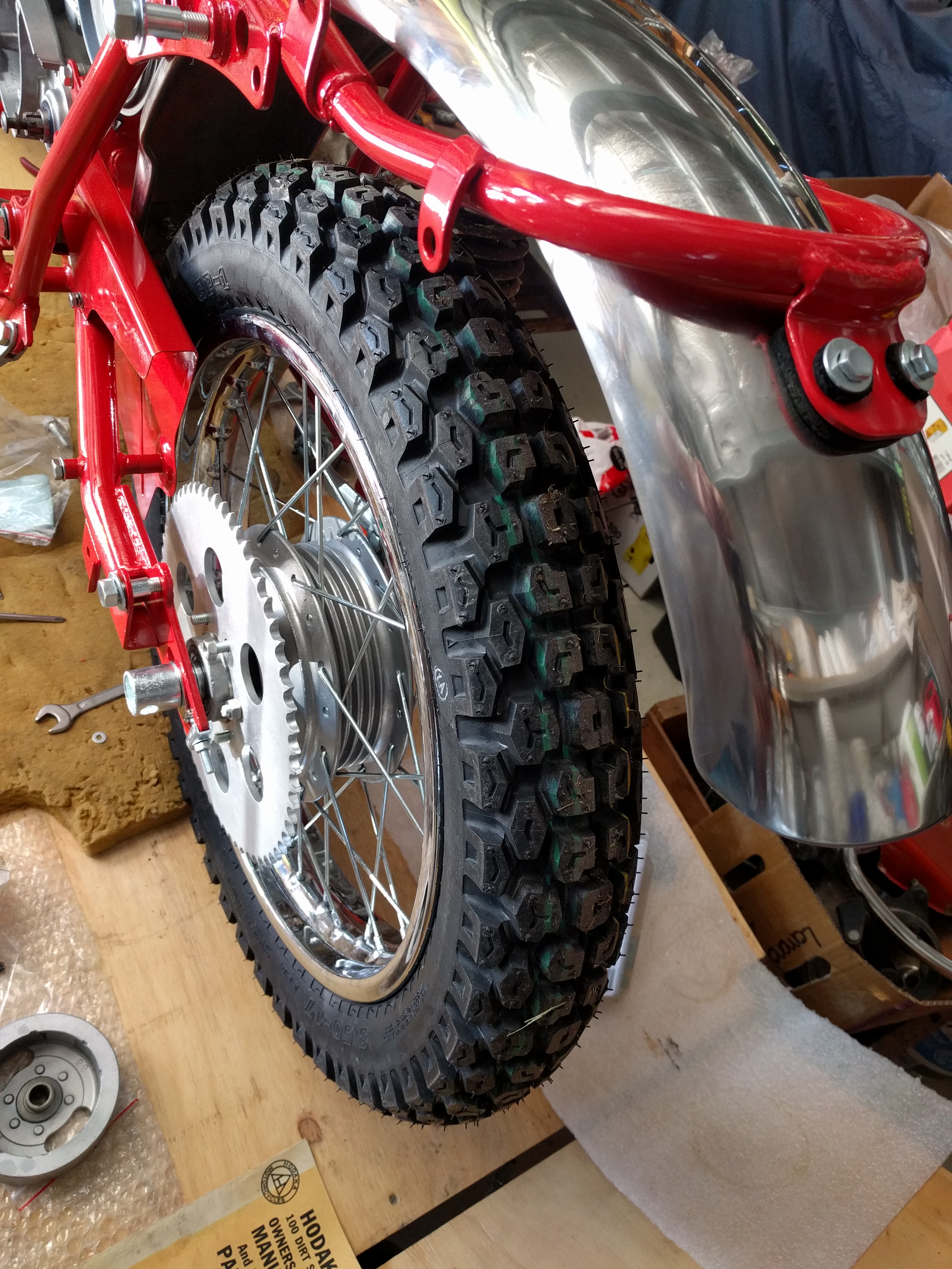

My tyres turned up yesterday so today was a tyre fitting day! Went with IRC Trials tyres in the end, and they look better than I thought.
Not a whole lot of clearance on the chainguard, but enough, maybe 1/4" to 3/8" ?
A great milestone event :lol:
Probably the first time it has stood on it's own two feet in 30 years.

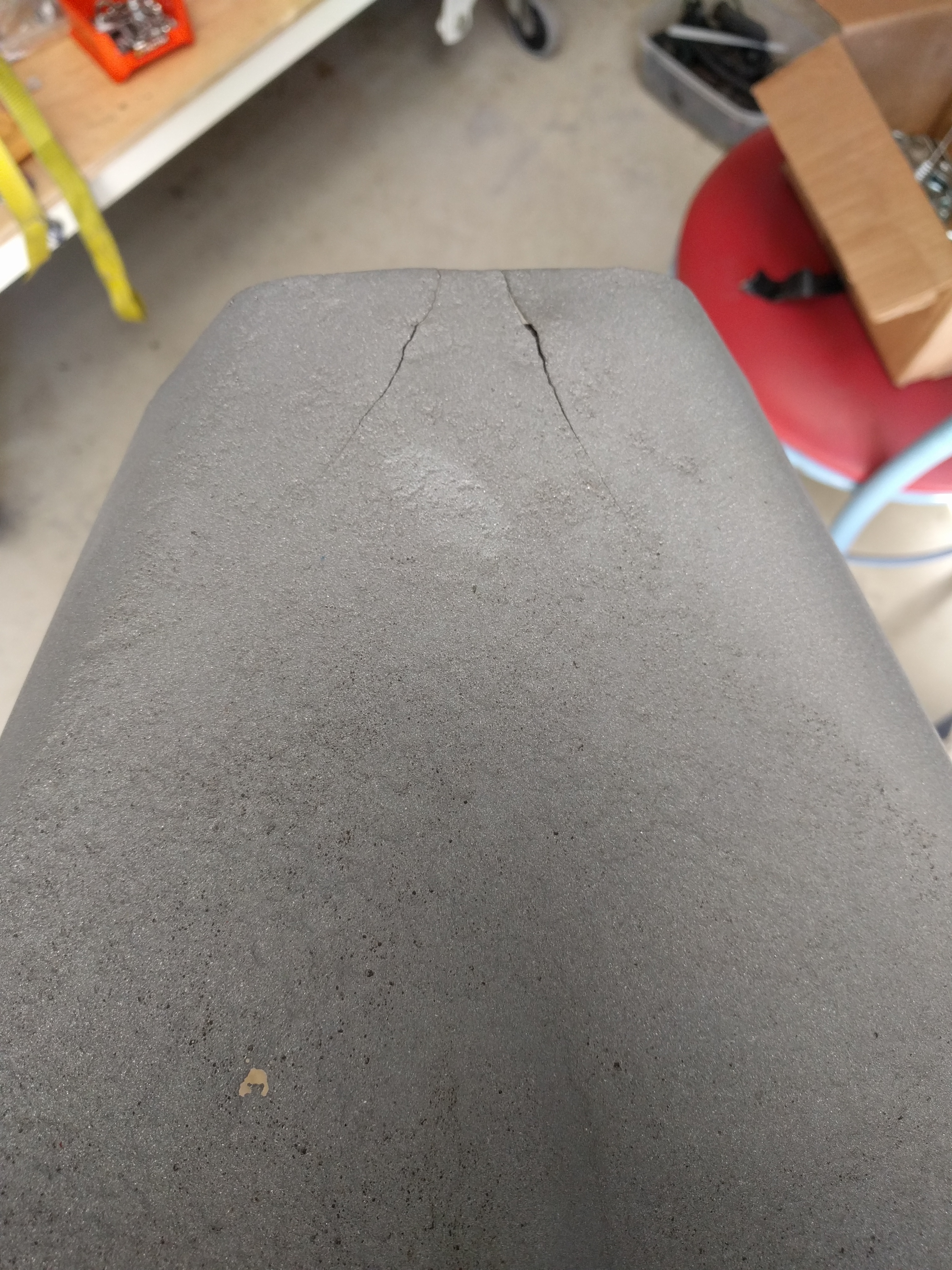

Local upholsterer reckons he can recover the seat far cheaper than I can buy a cover....remains to be seen how it turns out though. Here's hoping.
I need to repair the seat base first. Has a few cracks around the front mount point and a few cover clips need to be replaced
Just enough room with the 3.50 IRC

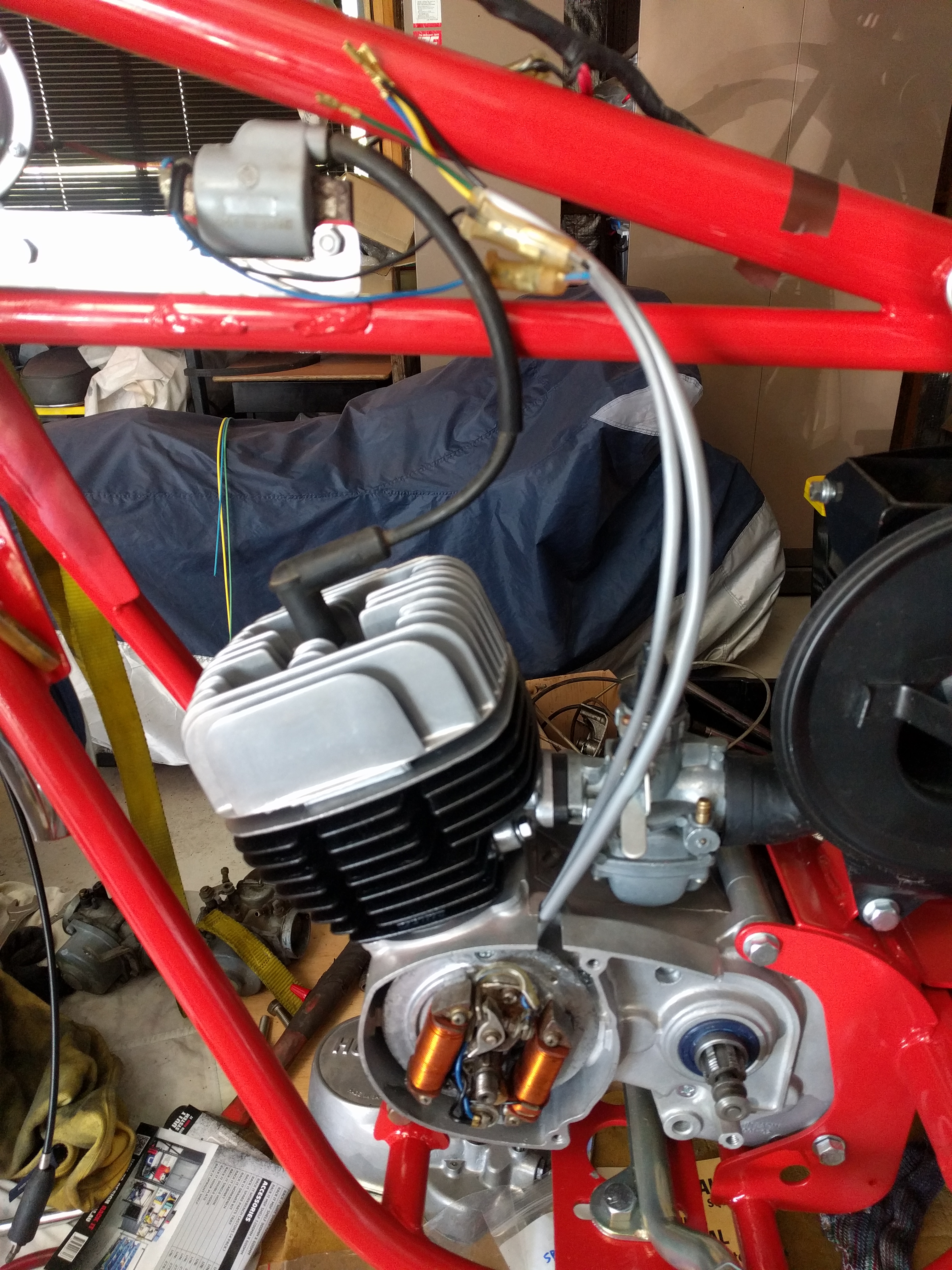

Some of the wiring done, but as usual I haven't spent enough money fast enough yet, so still waiting for the rear brake switch and the magneto grommet. :cry:
Also have a 3 position main switch on the way, so waiting for that to arrive before finishing the 4 pin plug.

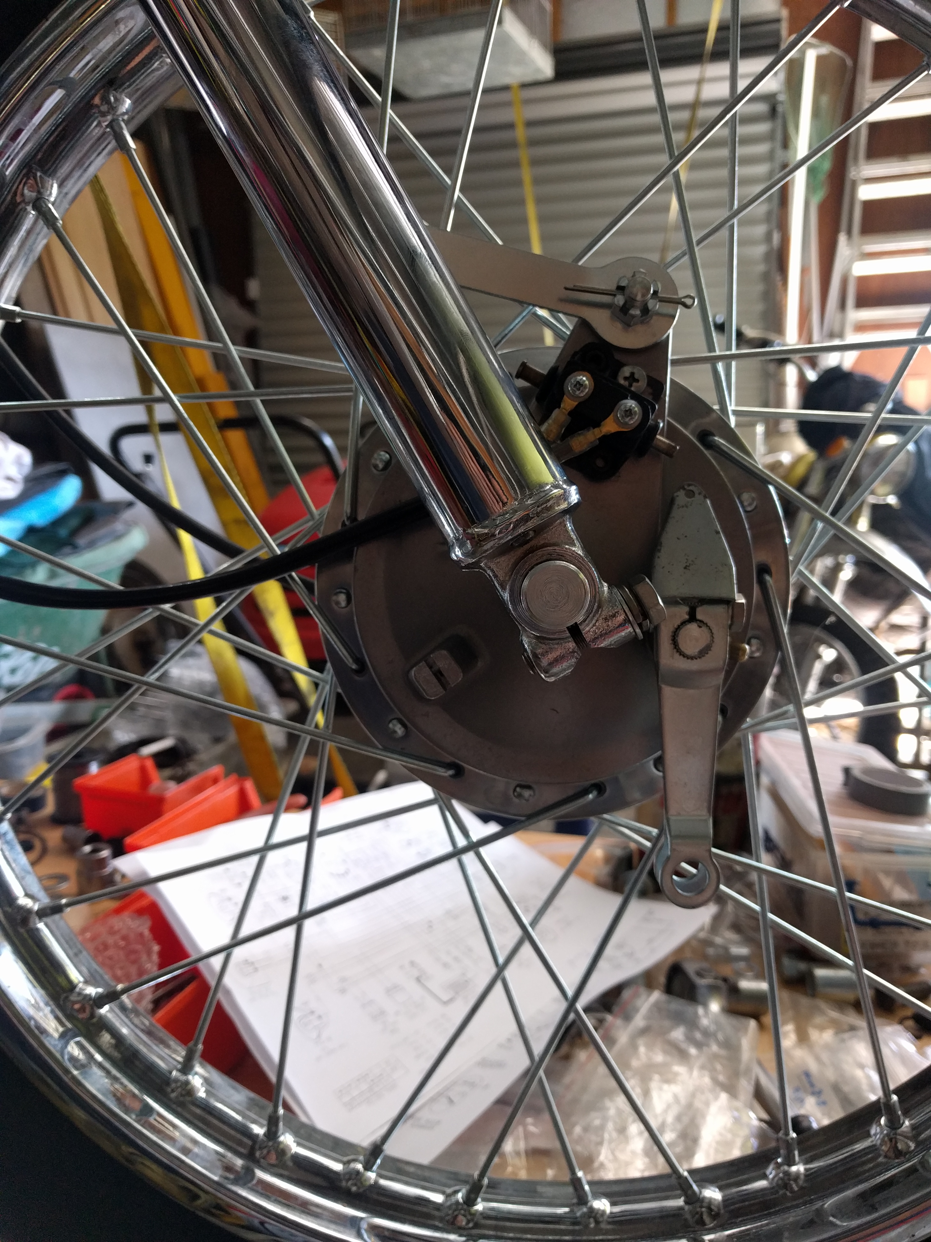

Front brake switch wired

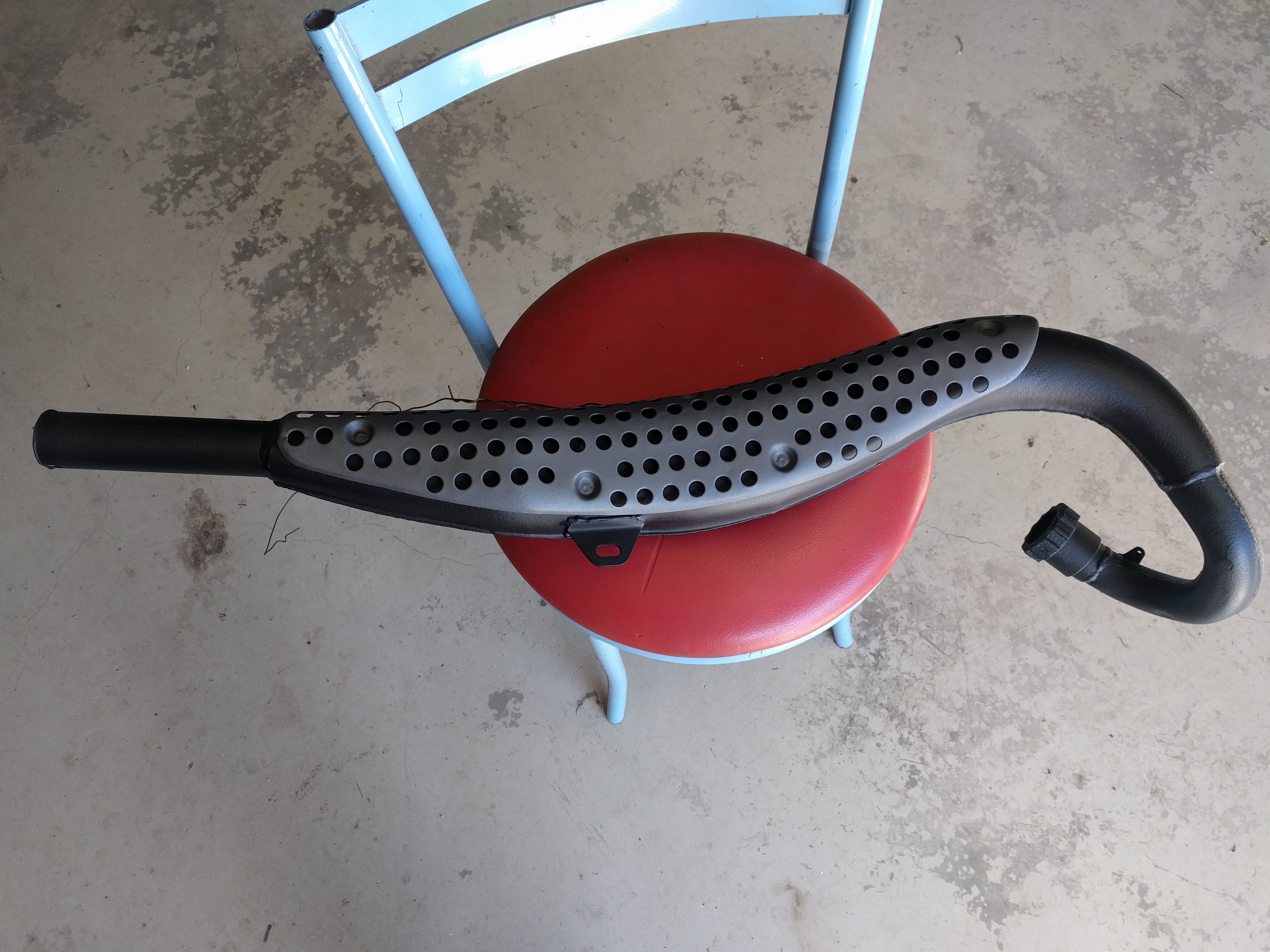

Allowed myself a little artistic licence with a two tone, high fashion, black/charcoal pipe :lol:

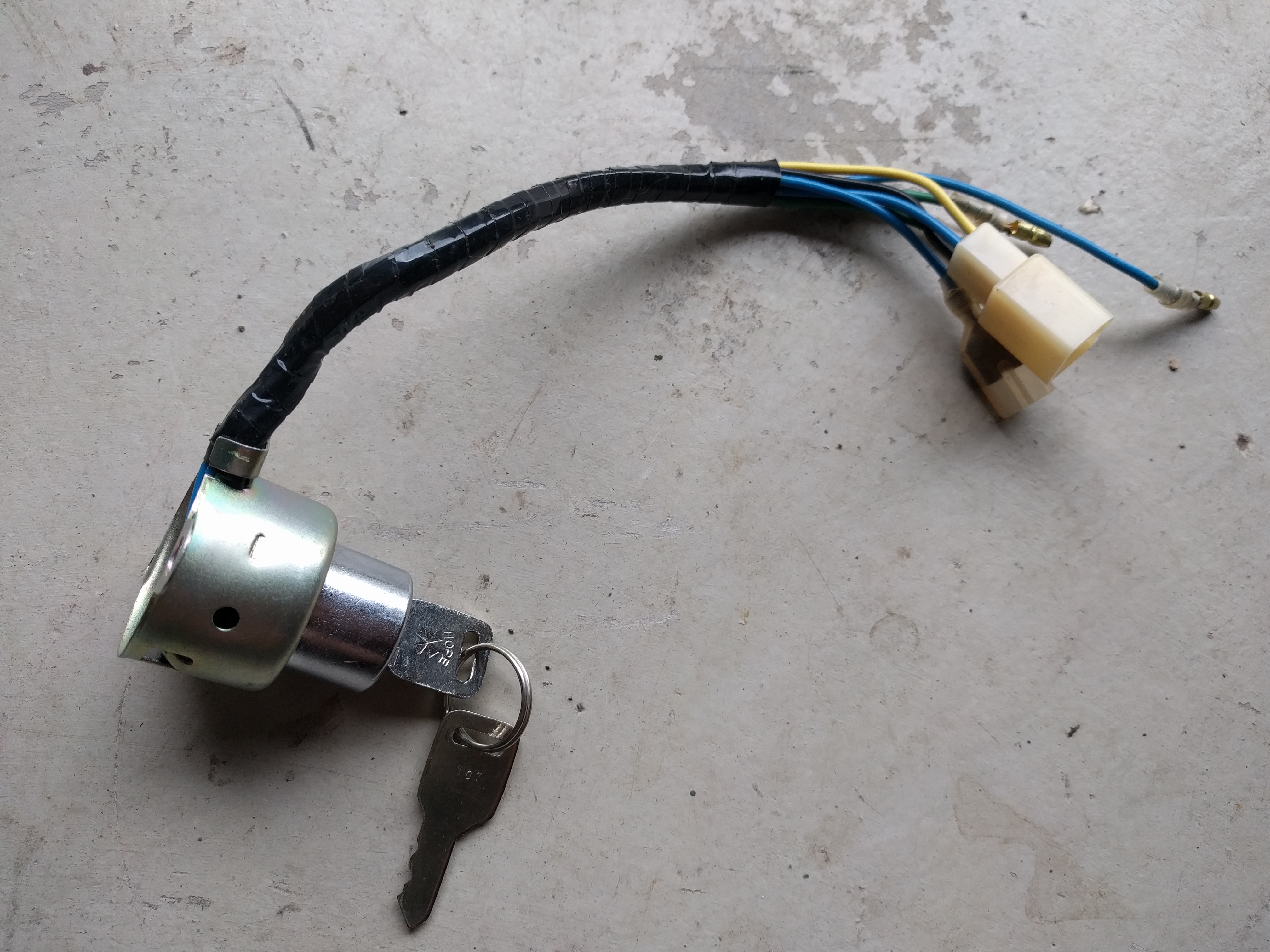

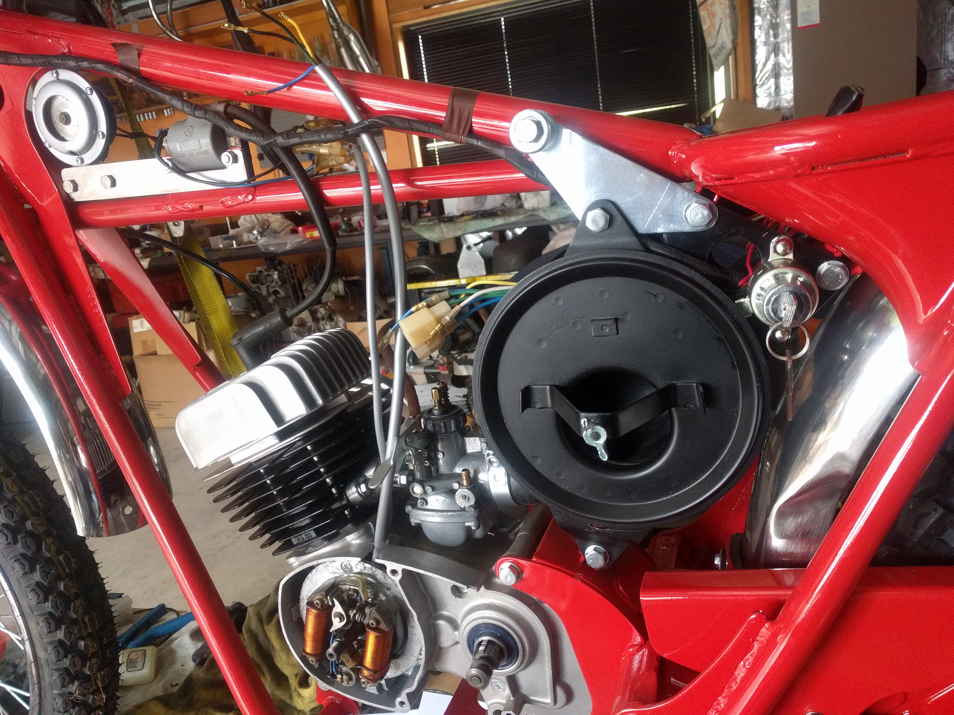

Decided against the dash mounted main switch....looks a bit tacky and seems very vulnerable to water etc, and I can't find a suitable rubber thingy to cover and protect the it. So I reshaped the bracket :D
You'll have to exuse my dirty old fork caps...waiting on another set to be vapour blasted :oops:

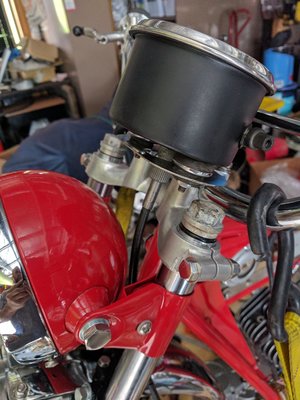

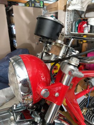

Managed to get the speedo cable clear of the light shell finally. The headlight brackets I have are a bit shorter than the other type, but they came with it and I was determined to keep 'em :lol:
So key is back on the battery box. I think I have the cable routing about right?
I've run the main harness behind the air cleaner back and in through the hole in the battery box, with the key harness running back behind the cleaner again to connect the plug under the tank.
These switches are on ePay at present for less than $50.00...bargain :D

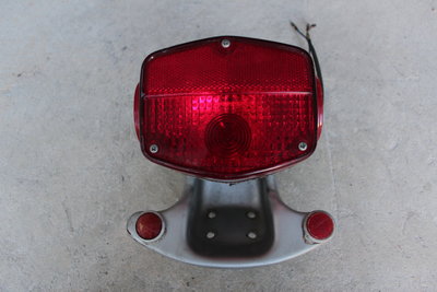

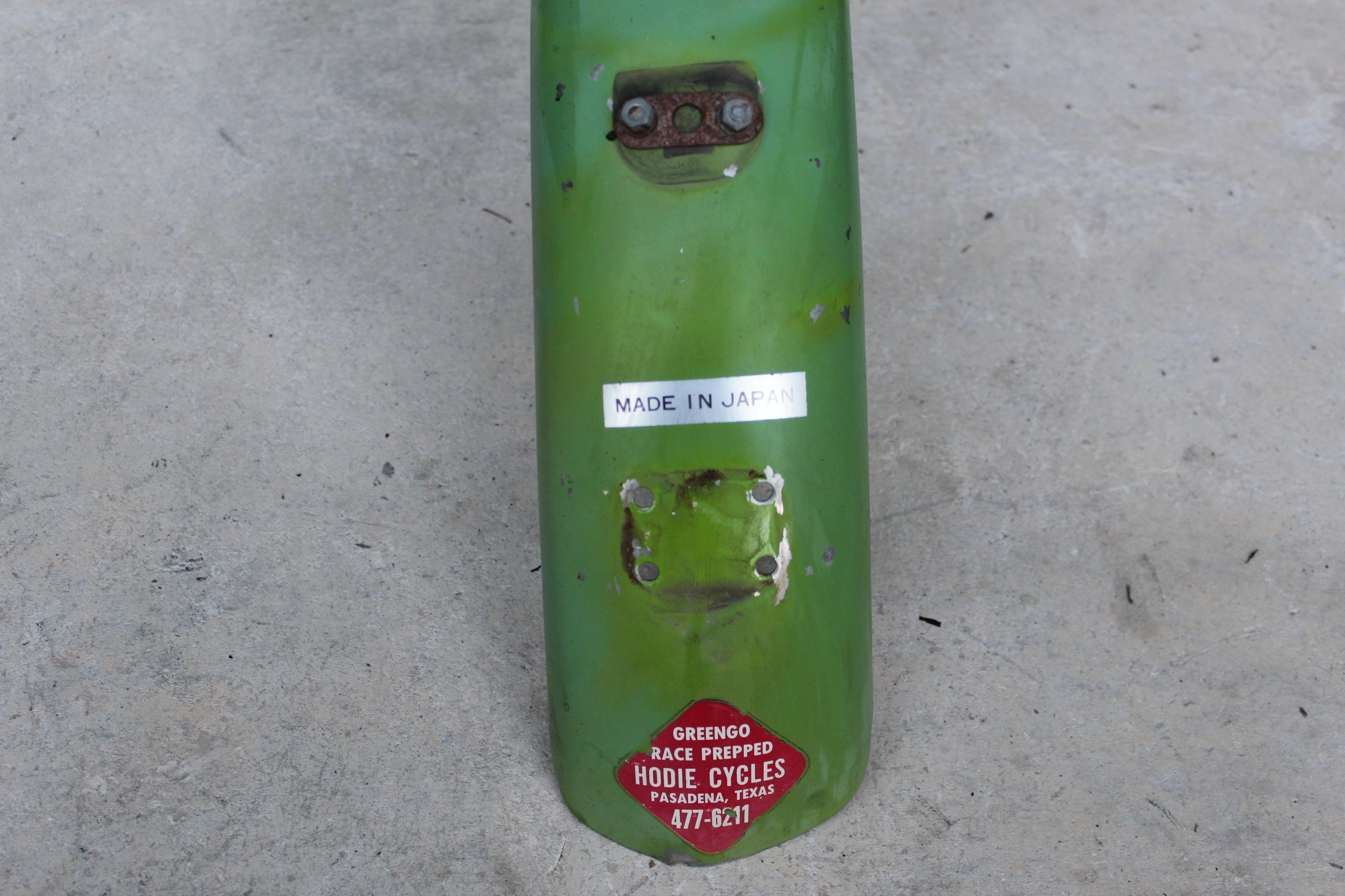

Nice build! I have some parts from a Road Toad that might fit your bike. Specifically a rear tail light that's near mint. Since the one you have may not fit the angle..

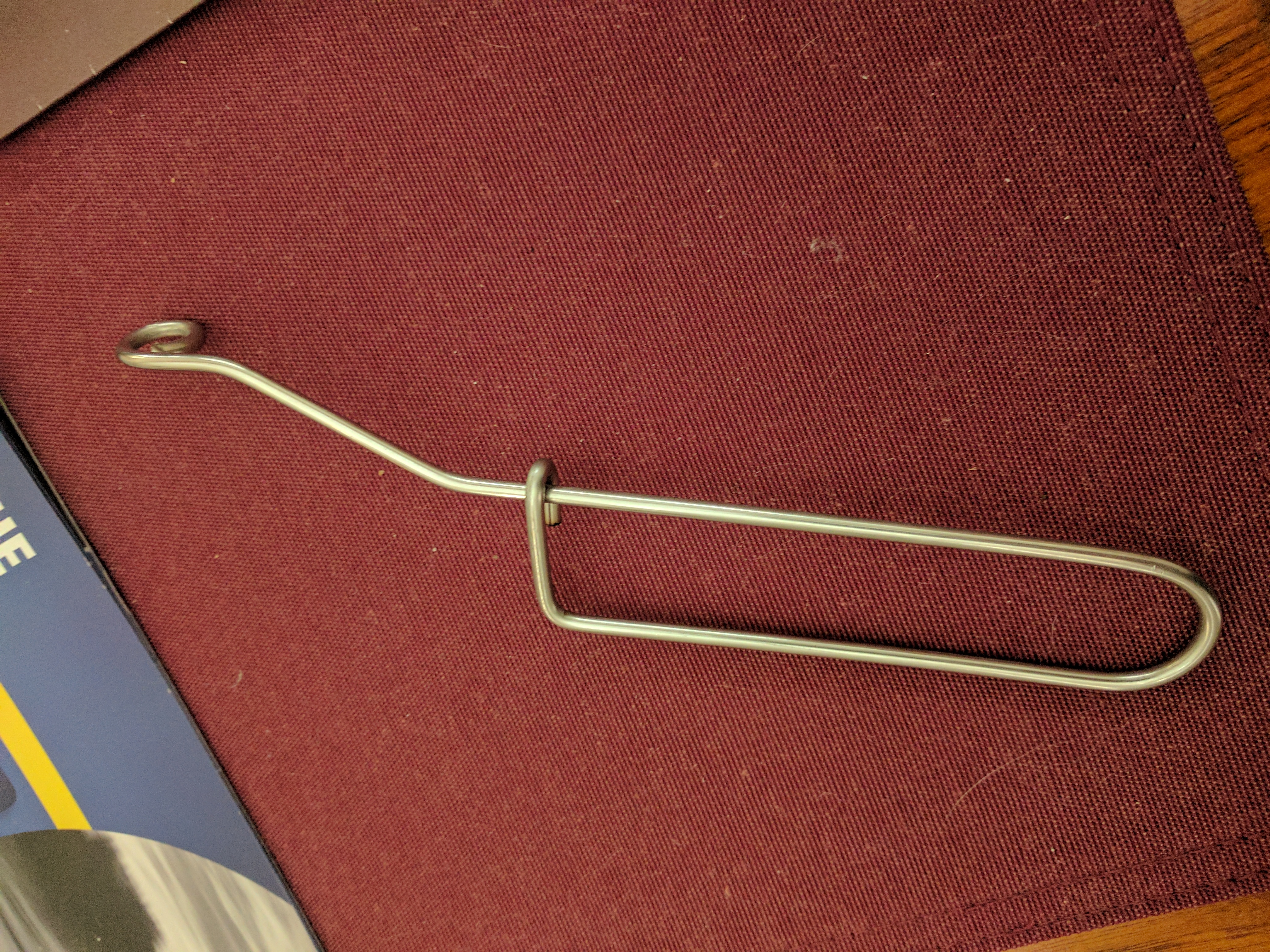

Well I need a front brake cable/ switch guide, along with a couple of custom guides, so basically being a miserable sod I thought I'd take the cheap way out.
Bought a 4m length of 3.2mm polished stainless rod ($5.00) and had a go.
15min. later I have this.
Pretty happy with the result, better than a new one :D

DirtRhodes wrote:IMG_4728.JPGNice build! I have some parts from a Road Toad that might fit your bike. Specifically a rear tail light that's near mint. Since the one you have may not fit the angle..
Looks interesting.

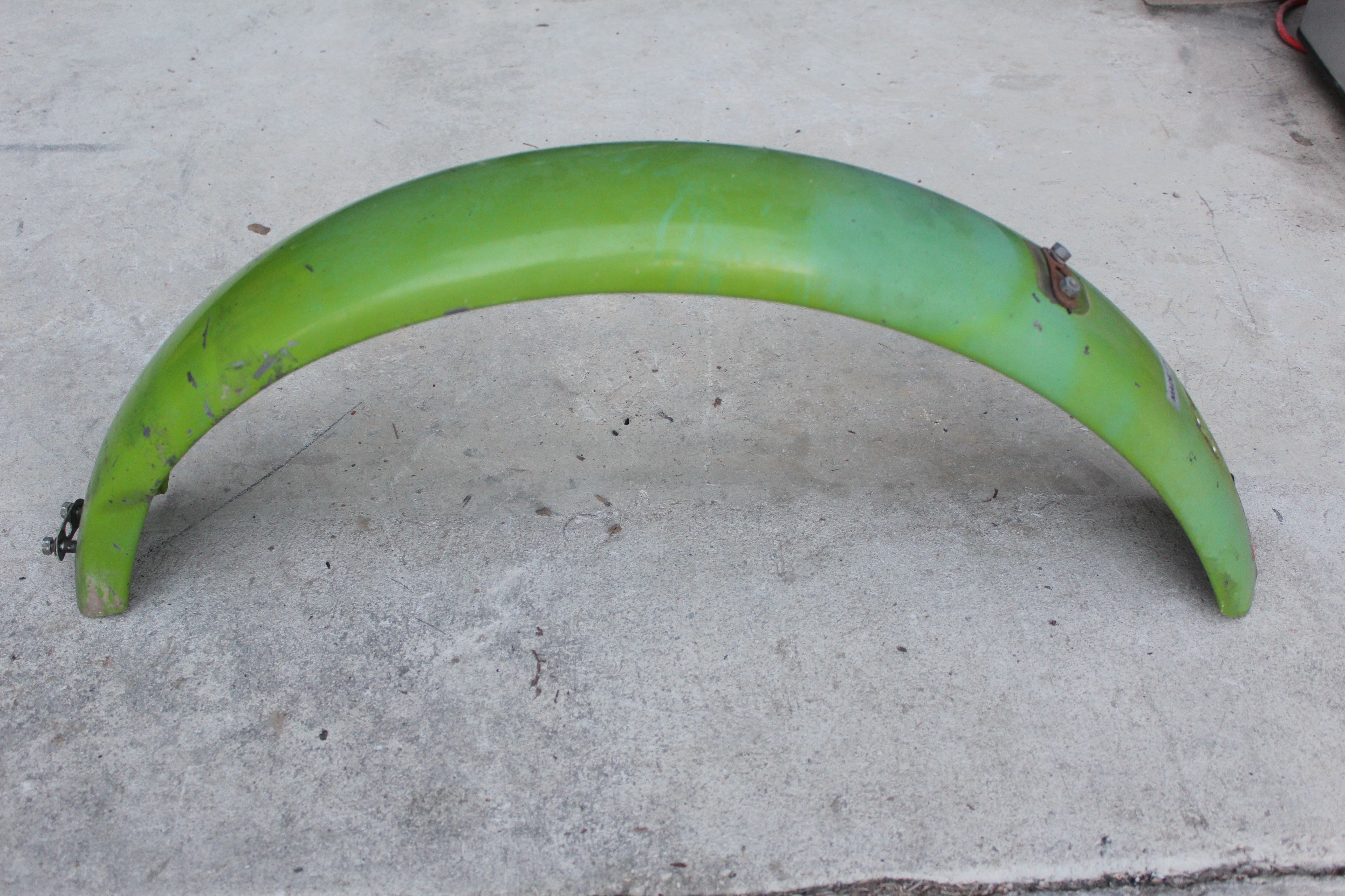

Is the Toad fender anything like a Squirt?
I have just bought a Wombat guard which I'm hoping will allow the use of the one I have.

I have those cable guides also.. Two of them! For a Toad, but they might fit. Here's what the fender looks like:

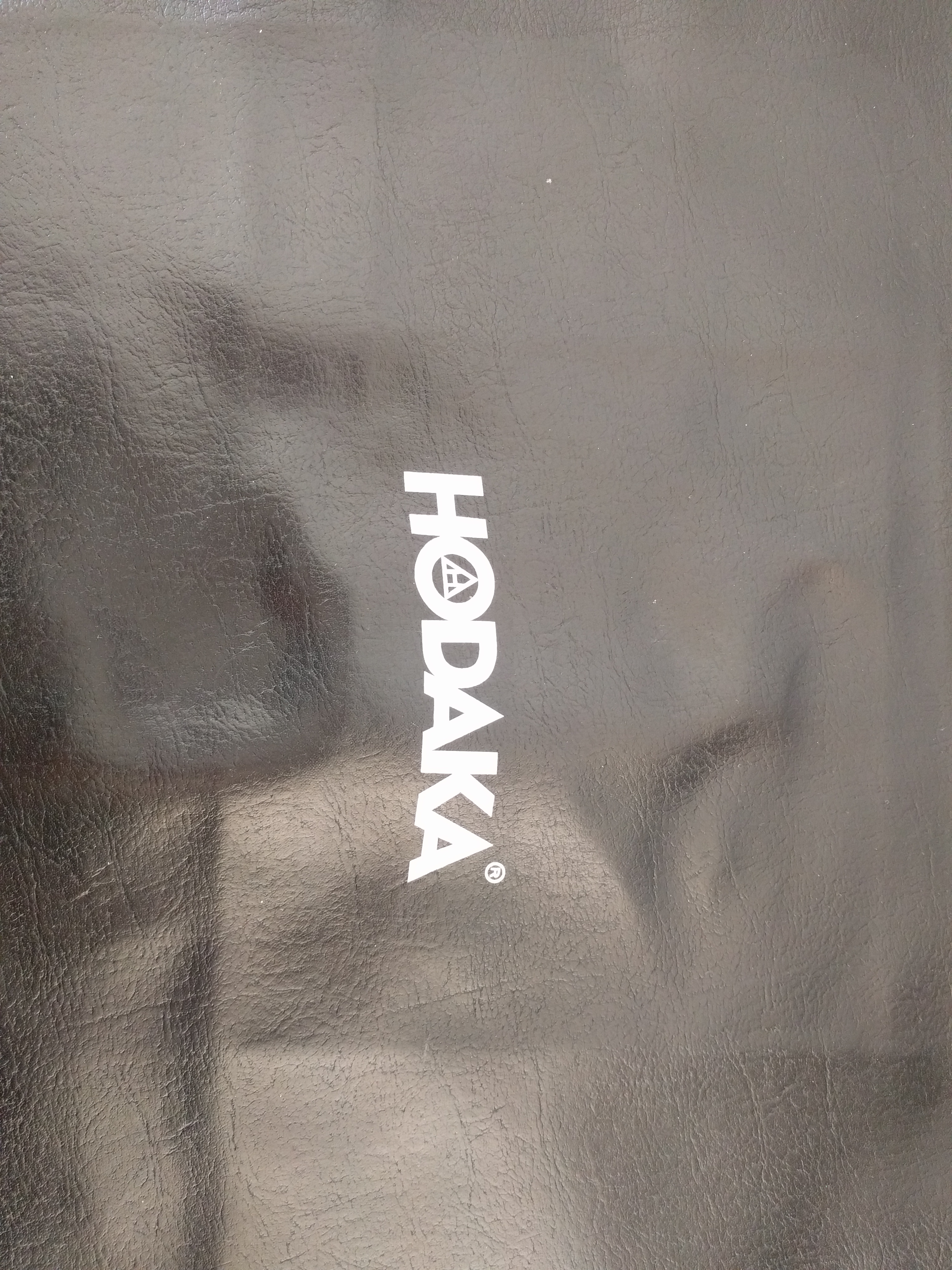

With luck this will end up as part of a decent seat :D
