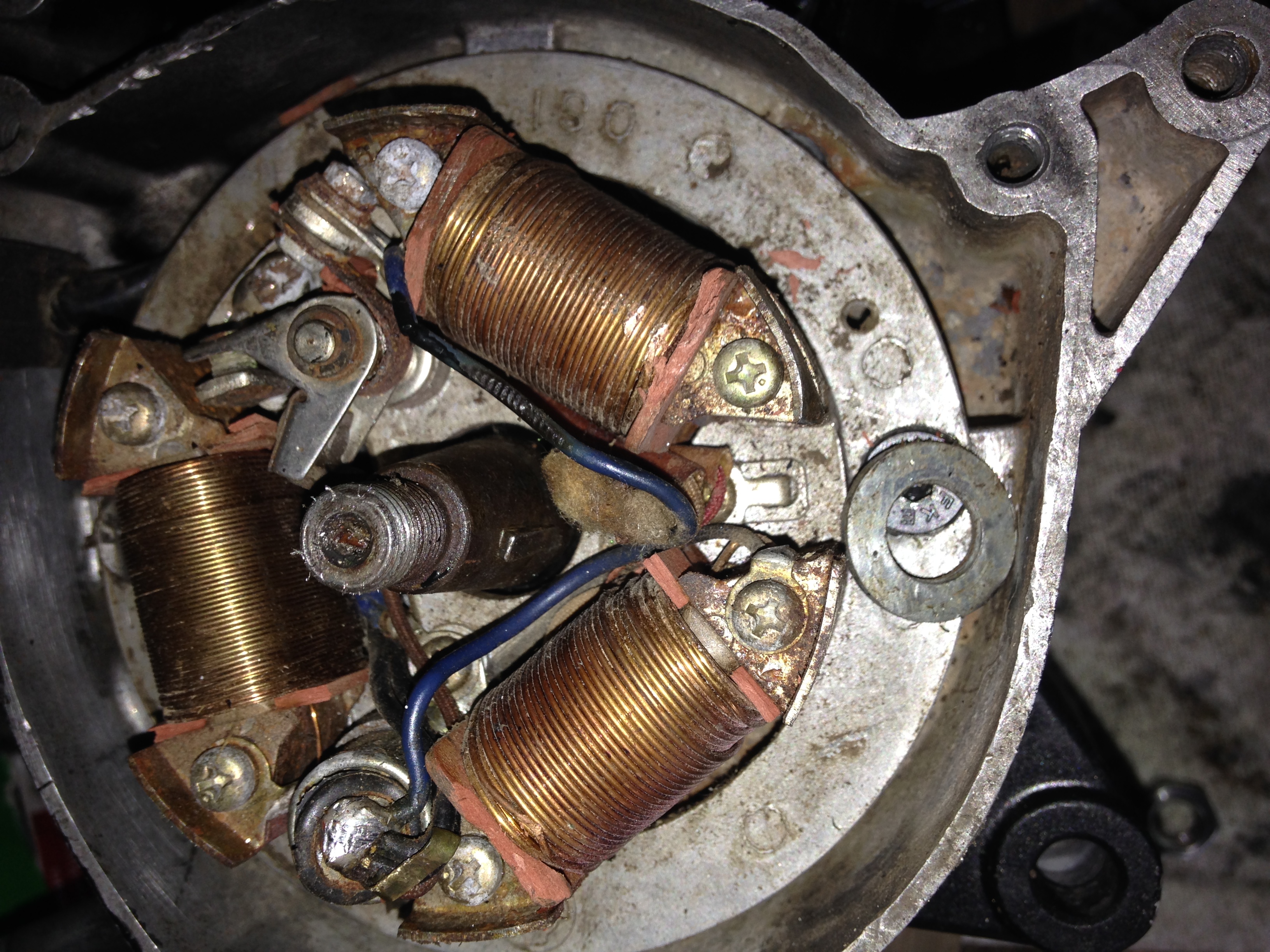

OK! I got back from my 2 week Motorcycle trip to Northern California. I started pulling things apart and when I pulled the flywheel off I found what was making the crank hang. Turns out it wasn't the Yamabond but a simple flat washer which the magnetized flywheel must have picked up when I set it down on the work bench. I must have put it together without checking to make sure that there was nothing clinging to it. (Note to self; always check inside of flywheel before installing from now on!). Glad it wasn't something more difficult to figure out! ; D Victor
Re: The Road Toad Starts Today!
OK, NUTS!!!
It appears that the washer wasn't my only problem. I could move the crank easily before putting the flywheel back on. I tightened the flywheel down and the crank wouldn't turn again. I loosened the nut, and voila, the crank rotates.
So, am I over tightening the crank nut which holds the flywheel on? Is there a torque spec for it which I need and don't have? I would assume it's not something light weight like 16.5 ft/lbs?
I know a lot of folks are out to Athena this weekend. So any reply would be appreciated. ; D Victor

Hi Victor, according to my official Road Toad owner manual, the flywheel nut should be torqued to 170 inch pounds which translates to 14.2 foot pounds. I guess its the taper of the shaft in combination with the Woodruff key that does the heavy lifting for this system. Make sure you have the star washer under the nut (Part # 65-10009 or something similar).

Tomorrow I am also going to make sure I don't gave anything causing it to bind up. 14.2 ft/lbs isn't a lot of torque. I was probably just putting the nut on too tightly.
Hi Victor, I had a similar experience as you described where I left the star washer hidden inside the fly wheel. I replaced the flywheel and forgot to replace a lock washer on the crank shaft. The combination of rattling, grinding and shrieking sounds from the motor was very exciting. I'm not really sure why I need to learn these basics the hard way
. Anyway, I checked out the schematic and there is only the star washer between the nut and the flywheel. I cant imagine why the additional flat washer could cause the binding effect but it might be worth a try omitting it.

Something is causing the flywheel to drag against something as the flywheel nut does not tighten the flywheel to the bearing. It only tightens it to the taper on the crankshaft. Might be worthwhile to check that one of the 3 coils is not dragging the inside of the flywheel. Just a thought.

Vic,
While the mechanical interference problem must be found and corrected, I'm afraid you may have continuing issues with the stator in the photo - and with the reliability of the of the fit of the flywheel taper to the crank taper. When you install the flywheel (perfectly aligned with the woodruff key) and then "hammered home" with the "heel of the hand" (no nut yet) does the flywheel turn true and free if you slowly stroke the kick starter by hand? In this situation, the flywheel should be comfortably snug on the taper and should clear every thing behind. Installing and tightening the nut shouldn't "move" the flywheel more than a few thousandths - so tightening the nut should not cause flywheel contact with other components regardless of the torque applied.
Is the crank taper as rusty and rough as it appears in the photo? If so, considerable clean up is needed there. What is the condition of the taper inside the flywheel?
The photo doesn't have arrows to the broken insulator plates at the end of the coils. Those items being broken is a sign of the age of the material. My own stator has some problems like that . . . and it gave up the ghost today. There are other age/corrosion and damage issues which will likely need attention once the mechanical interference problem is found and remedied.

Wayne. The aluminum foil & water is a way of cleaning rust off chrome parts without further damaging the chrome. Simply wad up a fresh piece of aluminum foil & open it back up and fold it over a few times. Rub the rusted areas with the aluminum foil & some water. This will remove the rust. If the part isn't pitted all of the way through, the chrome will clean up nicely. If it's pitted all the way through then it will remove the rust but leave the pitting behind.
Ed. All the things you pointed out are being addressed. I noticed everything you did and when I went back to it today I found a SECOND, that's right, second washer sticking to the inside of the flywheel. The flywheel must have been in close proximity either to a box of washers or to my magnetic parts bowl, and retrieved them with its attraction properties.
So it's getting a new condensor, new points and I am going to coat the coils with some clear nail polish which I have found works well in the past. Those washers also broke away some of the edges of the insulators on the ends of the coils. Not badly, just enough to be noticeable to me. I will brush on some liquid wire insulator and address the exposed wire. It appears to be heat damage left behind by a DPO.
I also have a second coil set from the second motor, but I need two any way. I'll see what happens & what I can do. And yes, the Allen head screws used fit flush on the coil mount. I was careful about that. The old ones were stripped out on the heads.
I keep remembering your telling me to "slow down, you'll go faster!" That certainly would have helped me here! I was just so excited that I finally got a case together I rushed through things and did myself more bad than good. I shall recover. ; D Victor

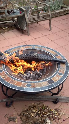

Ahhhh! You just gotta love the first fire of the season in your back yard! And the sweet added scent of castor oil with it just can't be beat! ; D Victor

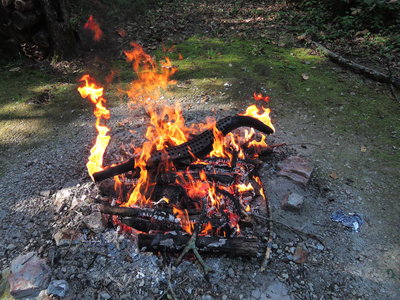

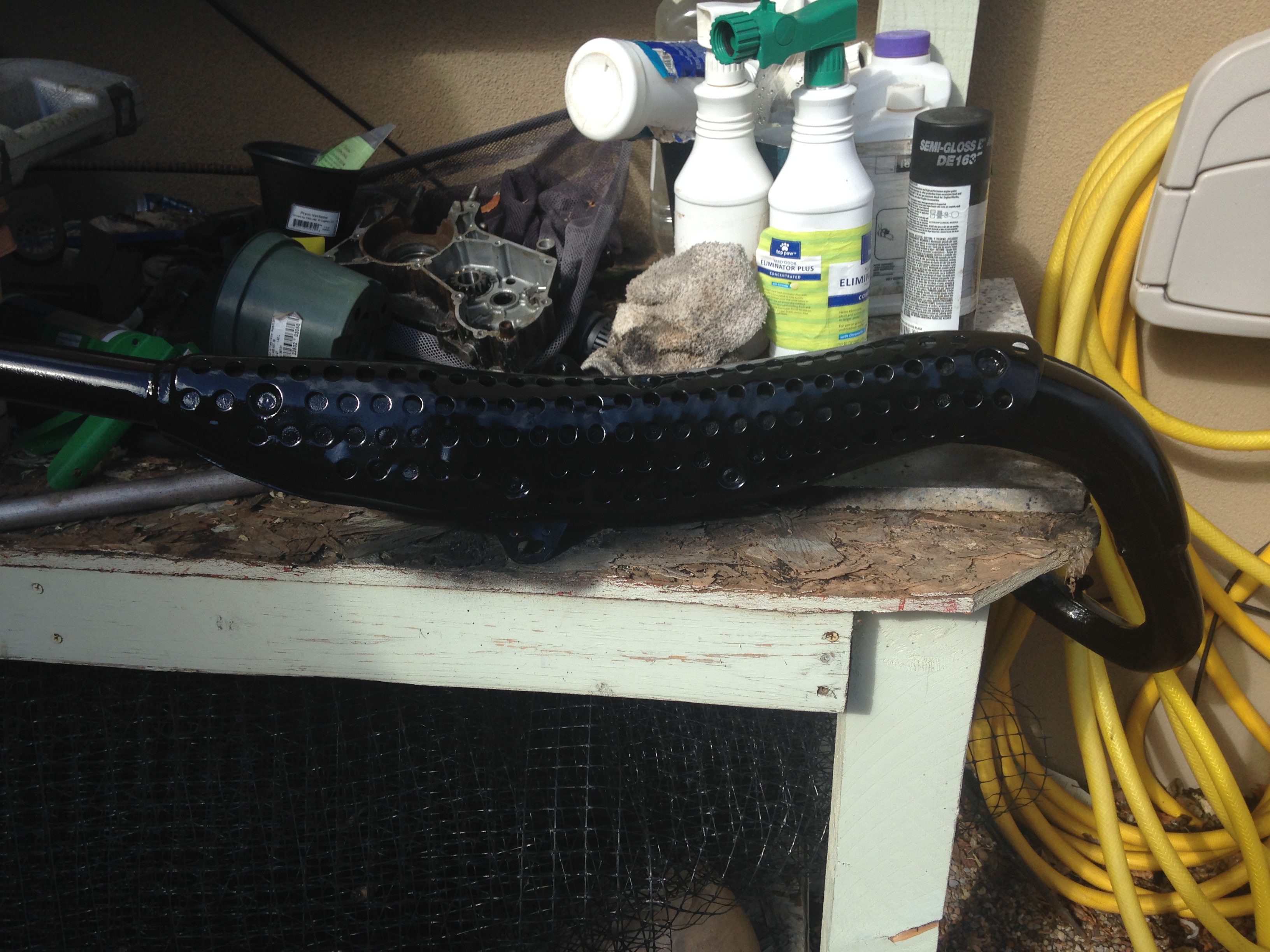

Funny Max, but just so true! This pipe burned out of both ends like a flame thrower too! It was dirty inside and after heating it up it started blowing an oily fluid out of both ends which would ignite and flash like a flame thrower!
This is the pipe for the second Road Toad! The other pipe is already done! ; D Victor

We discussed this a while back and all agreed it was big fun!

And the carbon from the fire sure gives a nice black finish too! ; D Victor

Well, I had 2 or 3 condensers lying around & somewhere I have another set of points (still to be located). I already brushed on some liquid wire insulator on the blue points wire and cleaned the shaft with 800 grit sand paper and it's threads as well.
I am convinced the binding problem was the washers stuck under the flywheel. They are responsible for ripping the top off the condenser as well as chipping away at the insulator boards. I applied some blue Loctite over the windings on the coils & let it dry. I think this will seal it well and is safe enough & heat resistant enough! I just need to get my soldering iron back from my son in law who borrowed it, to solder the wires to the condensor. I also sanded the curved edges of the coil bars to remove surface rust and make them shine again. Hopefully this will cure the issues and I can determine if there is any other place where contact us being made.
I did test it without the coil plate in place & there was no contact or binding issues. I think it was just the washers and the damage they did to the condenser which was causing the binding. But we will know soon enough! ; D Victor
