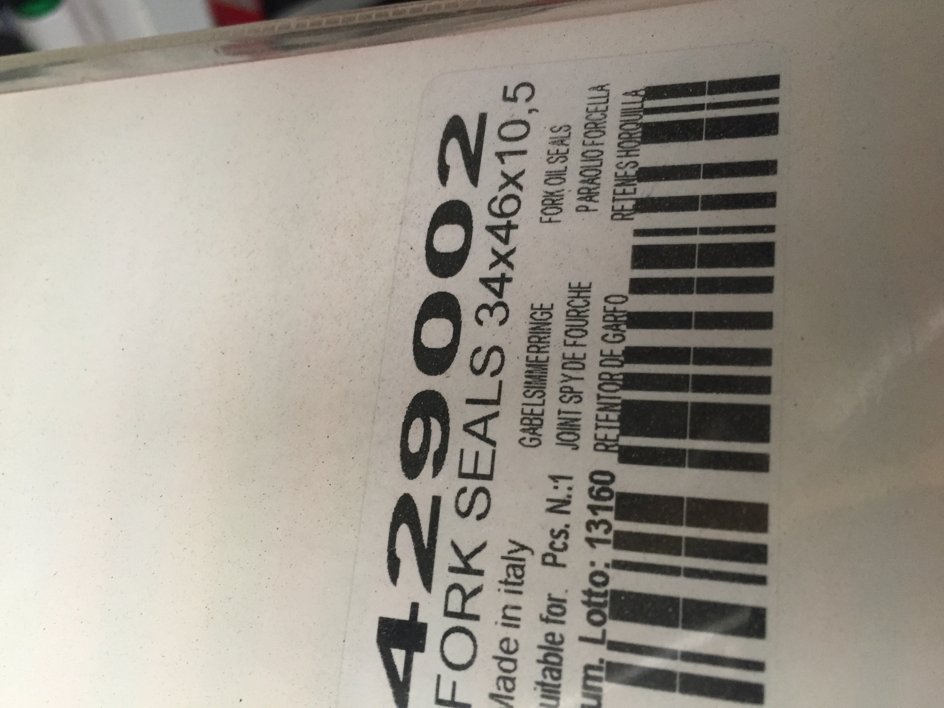

Welcome to the group. You should not have trouble ordering the correct fork seals if you shop by model number here at the Strictly Hodaka site. Your 03 Wombat forks should measure 34mm if they are original.

Hi John, check out my video https://www.youtube.com/watch?v=tQUoWsGekH0
I show putting my 03 Wombat fork together. Here is the seal size. Look at this link http://www.strictlyhodaka.com/Articles.asp?ID=252and go to the bottom of the page for a link to very well written instructions on doing the job. Post up some photos of your bike, it will give us a good idea of what you working with.
