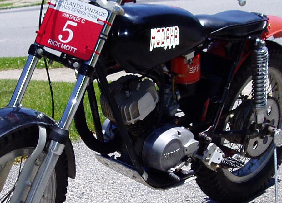

Here is the Webco on my Ace 100B+. Does his look like yours?

Richard S,
The Webco head is a bit larger than the stock Ace/Rat head. You can see by the photo, the head is larger than the cylinder top. A Webco head is about 1 inch in diameter larger. You need to use a B8ES longer threaded spark plug rather than the standard B8HS.
