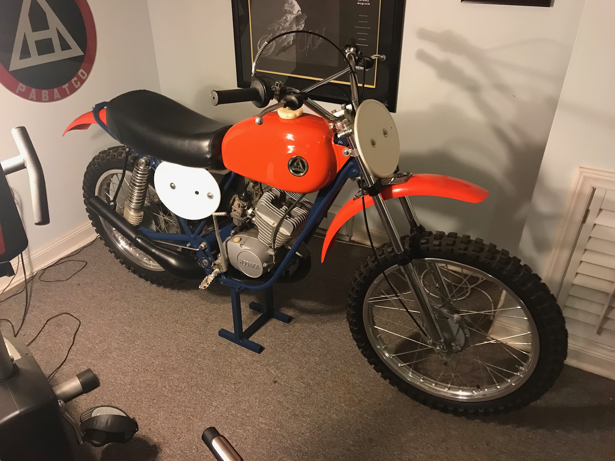

I’ll try to make a long story short. I have a Super Combat that I restored about 20 years ago. It’s been sitting in my basement game room since that time. I’ve decided to take it down to the bare frame and restore it correctly this time.It was basically the first bike I ever restored, and although it’s nice, I want to make it nicer. I’ve restored quite a few bikes since then, mostly Honda’s, and a couple of Yamaha’s. My restorations are pretty accurate and what I consider to be “high end” restorations. I don’t restomod my bikes, and I don’t modify them much unless it’s to add stainless brake lines or something for safety’s sake. I do occasionally ride my restorations, but I probably won’t ride the Super Combat. I’ve had a couple of back surgeries over the years and my dirt days are pretty much behind me. My Honda’s always use genuine Honda hardware and I put factory type finishes on every part. I don’t polish aluminum to a chrome like shine when it came with a brushed look. I do tend to make my paint jobs a little shinier than the factory did, and I clear over decals. Other than that, I like to be as factory correct as possible.
That brings me to the problem with the Super Combat. When I restored it, I painted the hubs, (Paul told me to) I painted a lot of the hardware silver, and I replaced a bunch of the smaller hardware with hardware store stuff. I truly had no idea what I was doing! I also painted the cylinder and head because someone had bead blasted it and left a rather course finish on it. So… what I need from you Hodaka experts is guidance on what finishes these parts had. I’m planning on redoing the hubs and putting a brushed or slightly polished finish on them. I’m going to take the paint off of the sprocket and do it in a raw steel type of finish. Right off the top of my head, I need to know what kind of finish the foot pegs had, what type of finish did the foot peg brackets have? Did Hodaka use hardware with any kind of markings on them, such as the markings on Honda hardware? How about things such as the brake rod for the rear brakes? Brushed finish? I do have a Caswell zinc coating system, so anything that should be raw zinc can be done that way and not painted silver like I did 20 years ago.

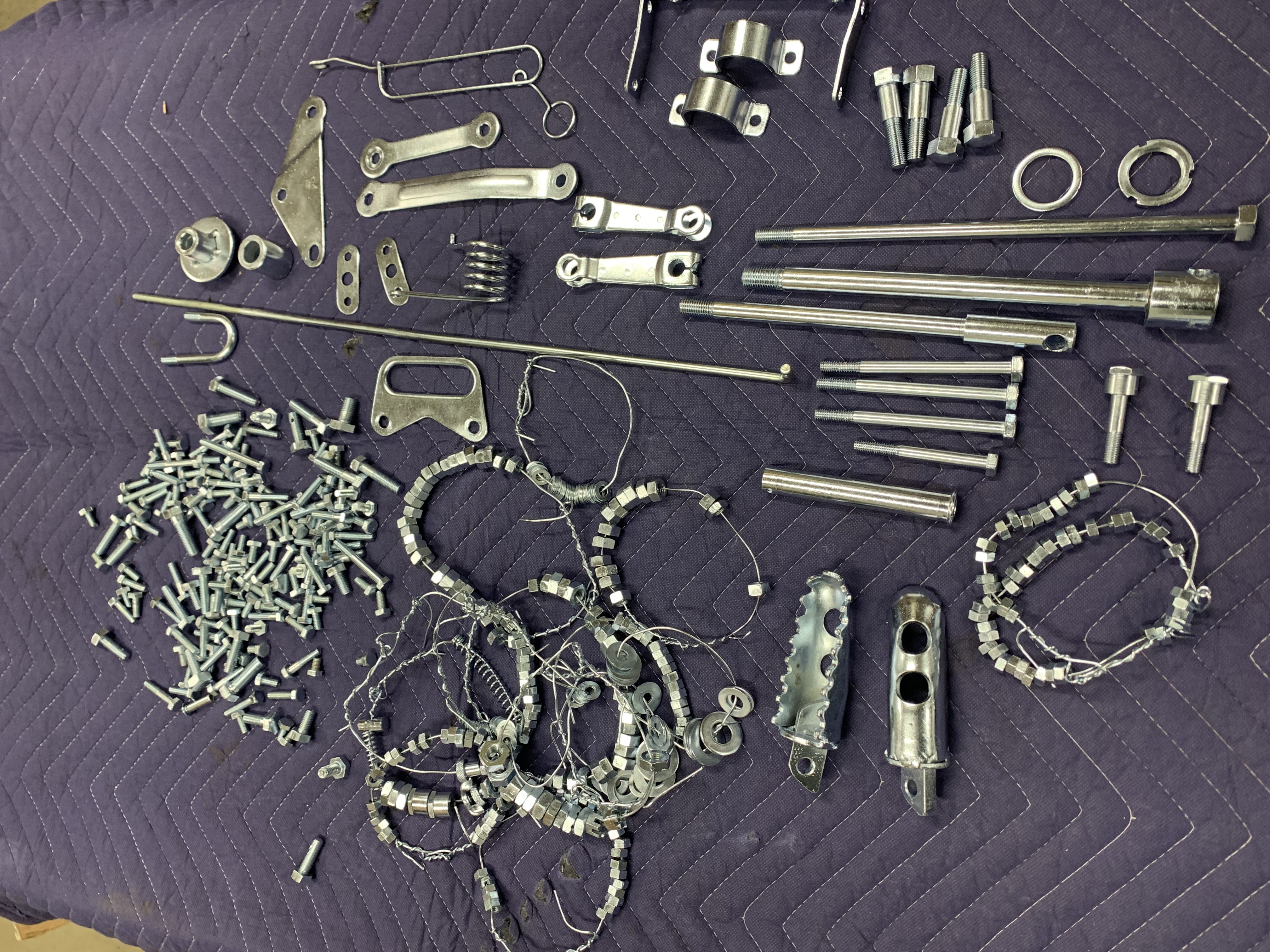

I had been saving up a bunch of HodKa hardware over the years and recently sent about 10 pounds of stuff in for re-plating.
The resolution if this photo is not great but most of this stuff is original Hodaka.

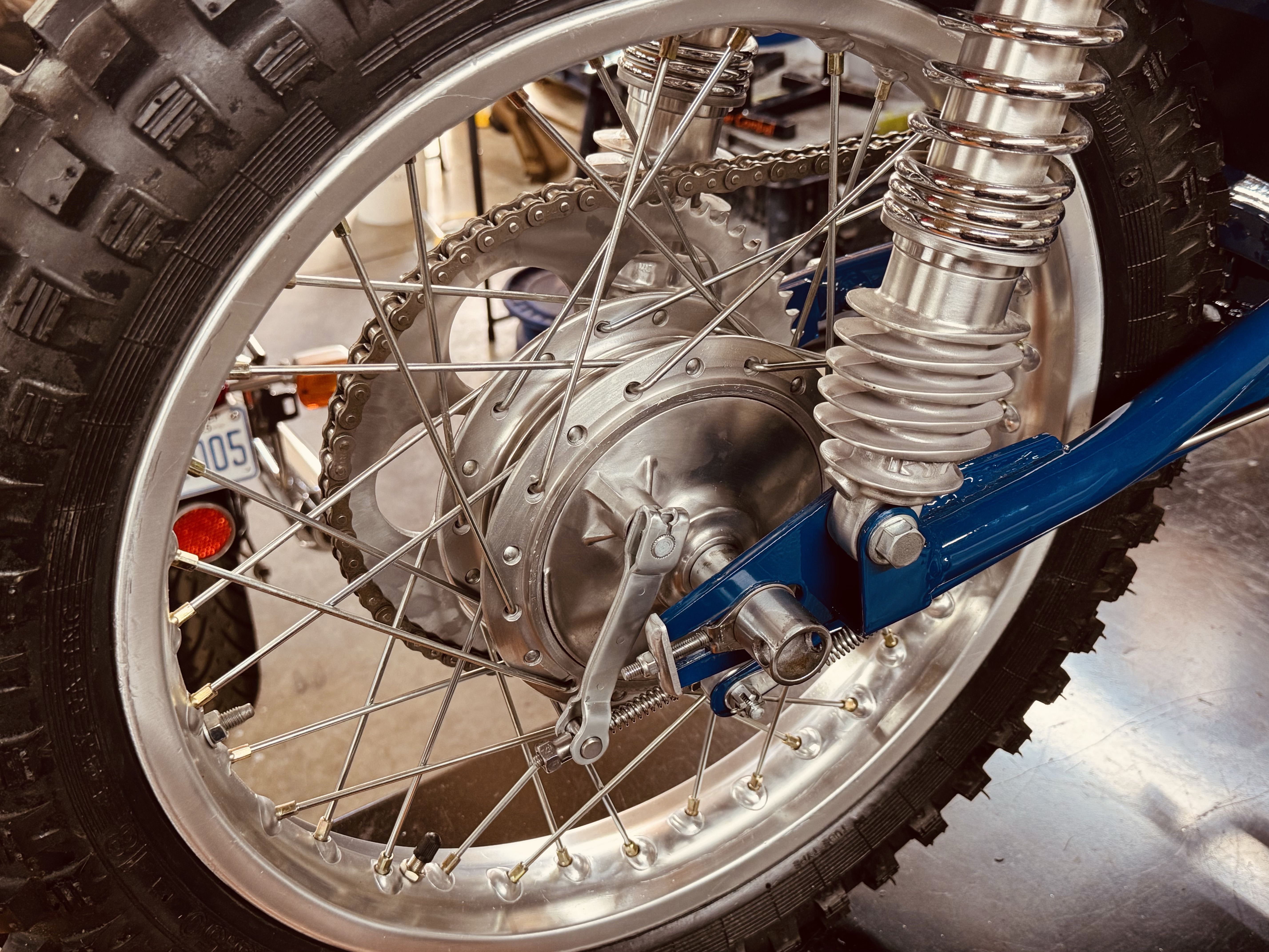

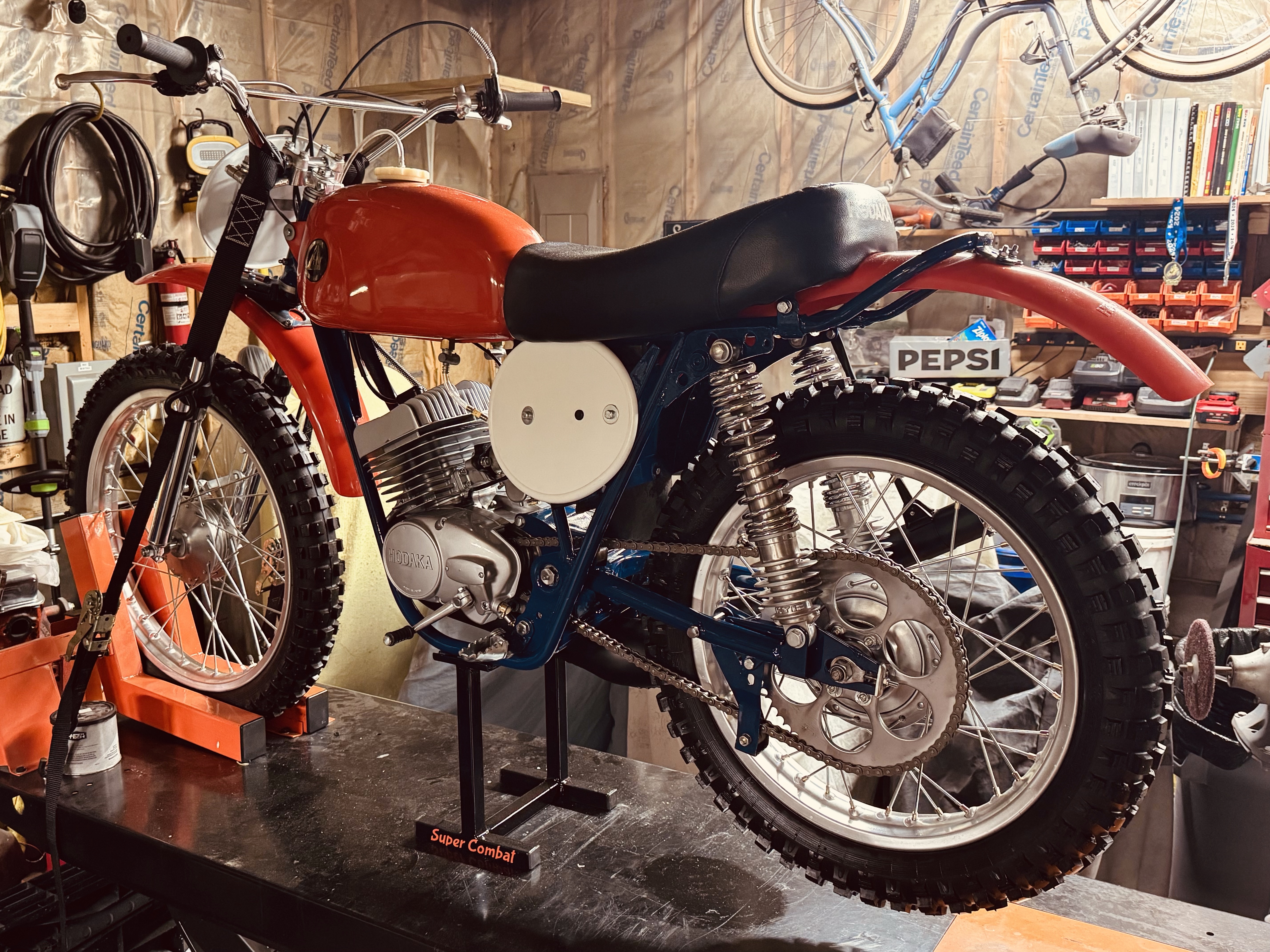

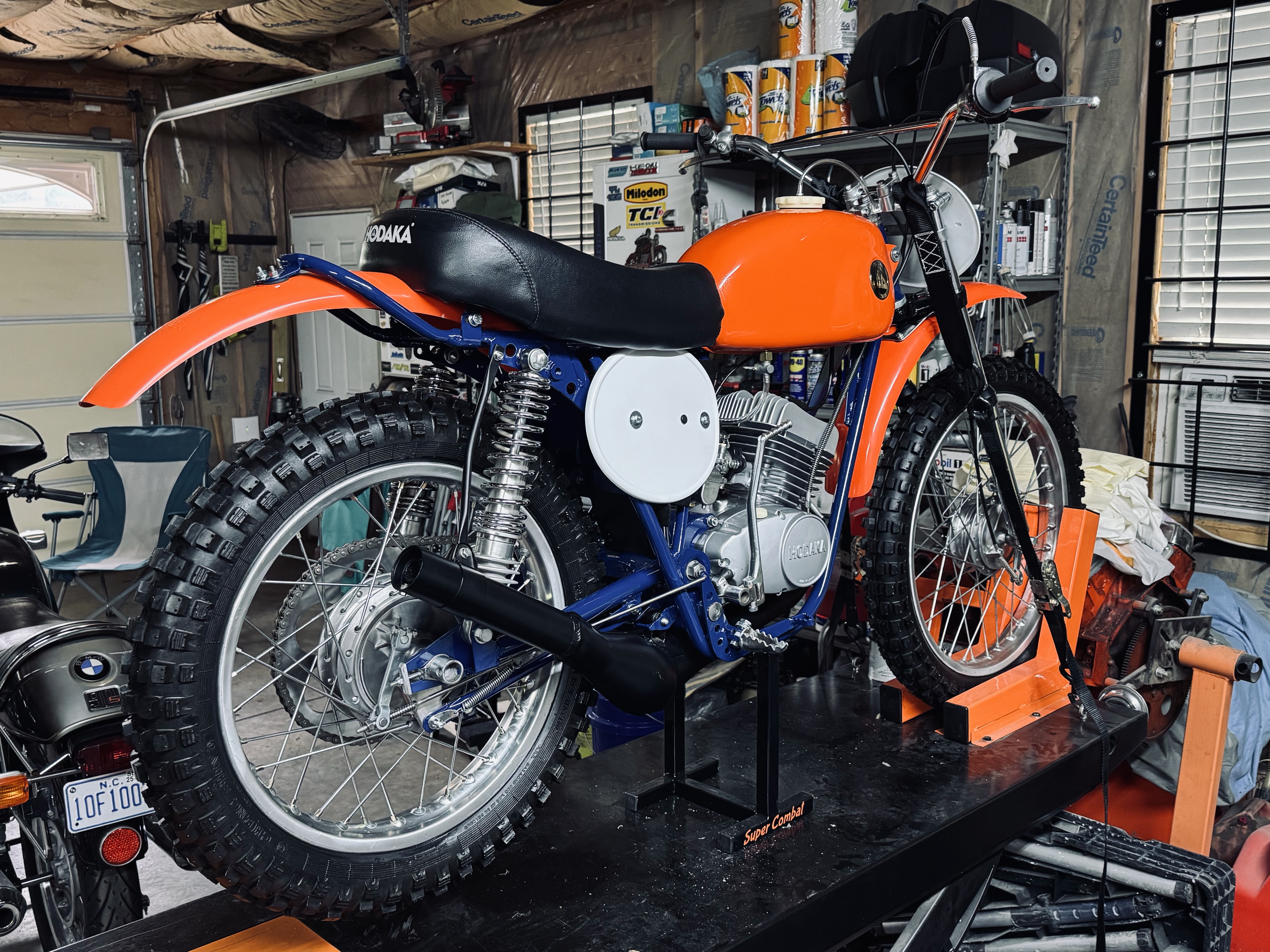

I tore it down again, to the bare frame, and repainted the frame with a blue color that I came up with just by guessing. I think it turned okay. Without an original bike to compare it to, I just picked out a blue that I liked and used it. I took the rims apart and redid the hub finish. They were painted silver, and now they have a brushed finish. I also put a brushed finish on the rims. When I restored this bike 20 years ago I polished the rims, and I’m pretty sure they weren’t polished from the factory. I rezinked all of the hardware and put a lightly brushed finish on most of that. Some screws were polished. Engine side cases were bead blasted and painted with a better shade of silver and then clear coated. The jug and the head were bead blasted and painted with the better silver but no clear coating. The engine cases and the carburetor were cleaned up and left with a brushed finish. I had the rear springs rechromed. The lower fork legs were rechromed last time. Otherwise, just cleaned everything up and got the silver paint off of everything. I found a kit for polishing plastic and made the fenders shine like new. I actually bleached the number plates to make them nice and white again.
I think it looks pretty good at this point.
