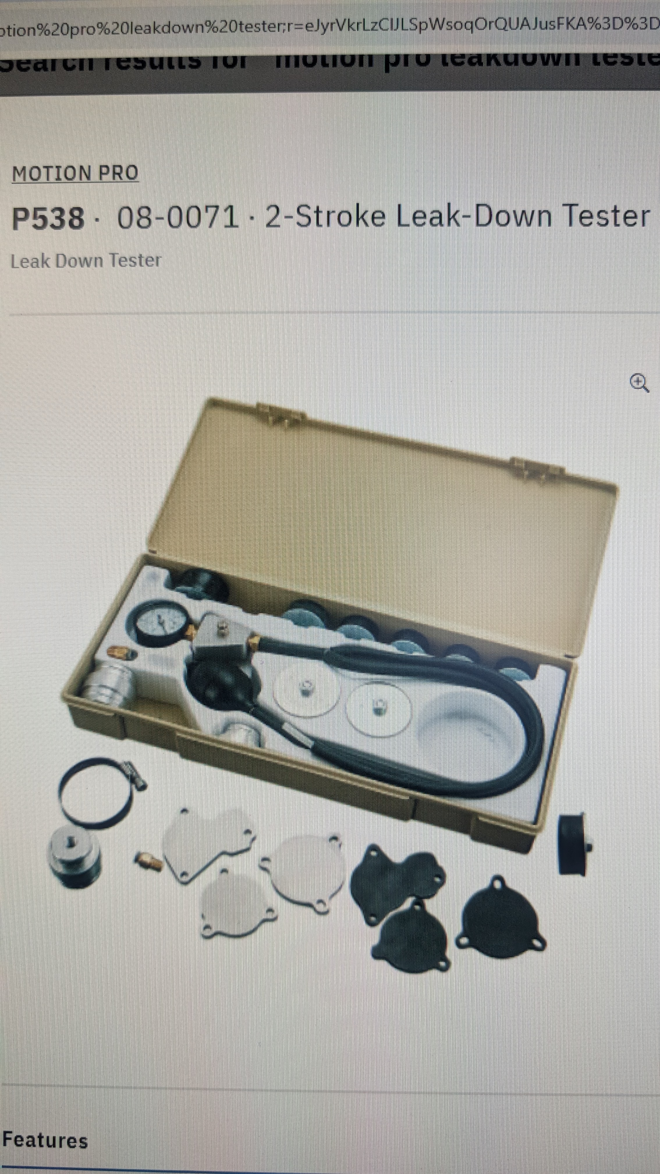

Re: Dirt Squirt
By plugging the exhaust port and the carb mount you can carefully pressurize the engine to no more than 6 psi. Ideally it should hold that pressure for 3 minutes, but if it leaks more than 1 psi per minute it has a leak that needs to be addressed. There are leak down pressure test kits that are available commercially, but they are pricey. They can be made yourself if you are somewhat clever.
Re: Dirt Squirt
This kit by Motion Pro comes with all the plugs to do just about any two stroke engine, including Hodakas.
Re: Dirt Squirt
