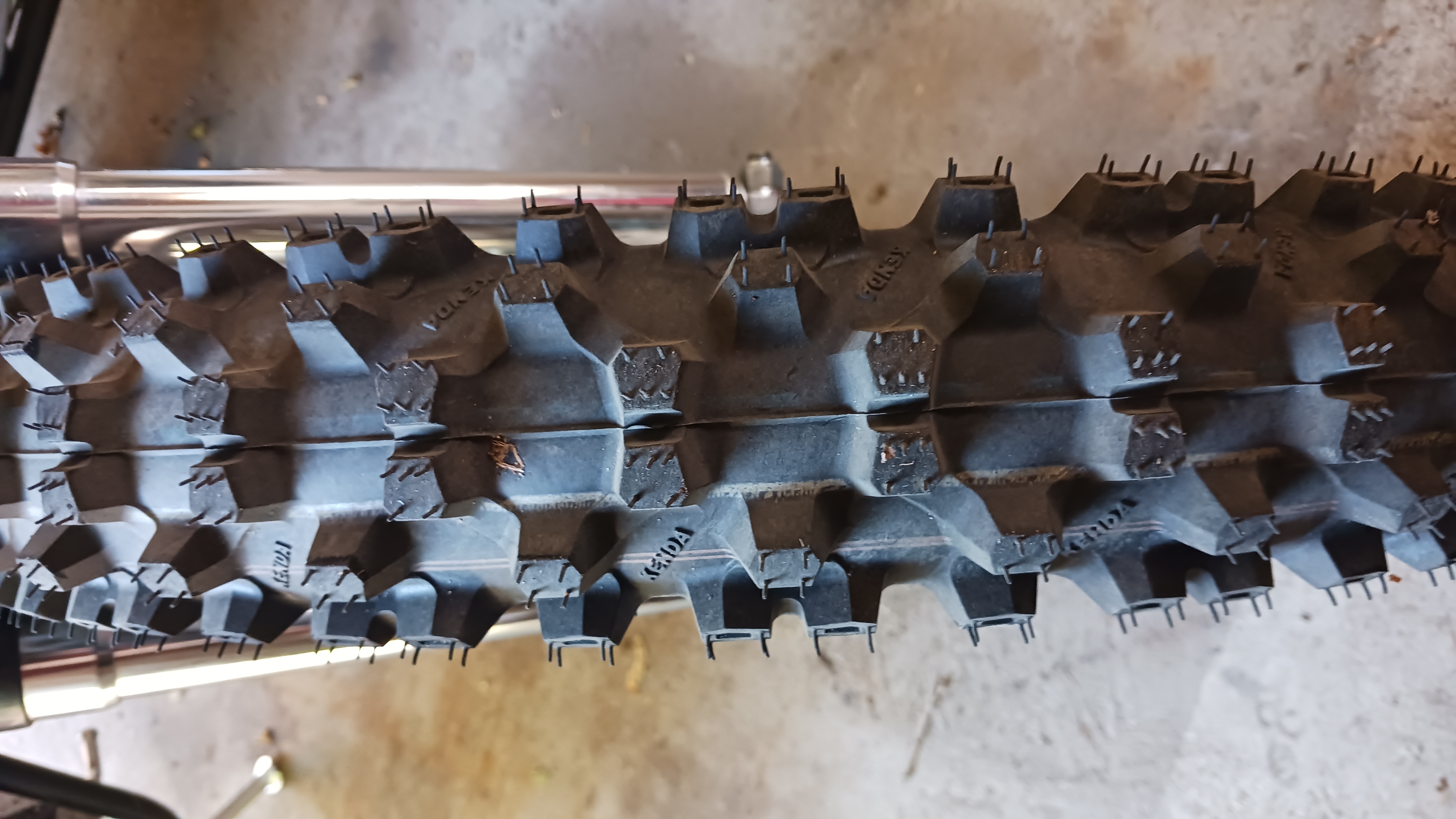

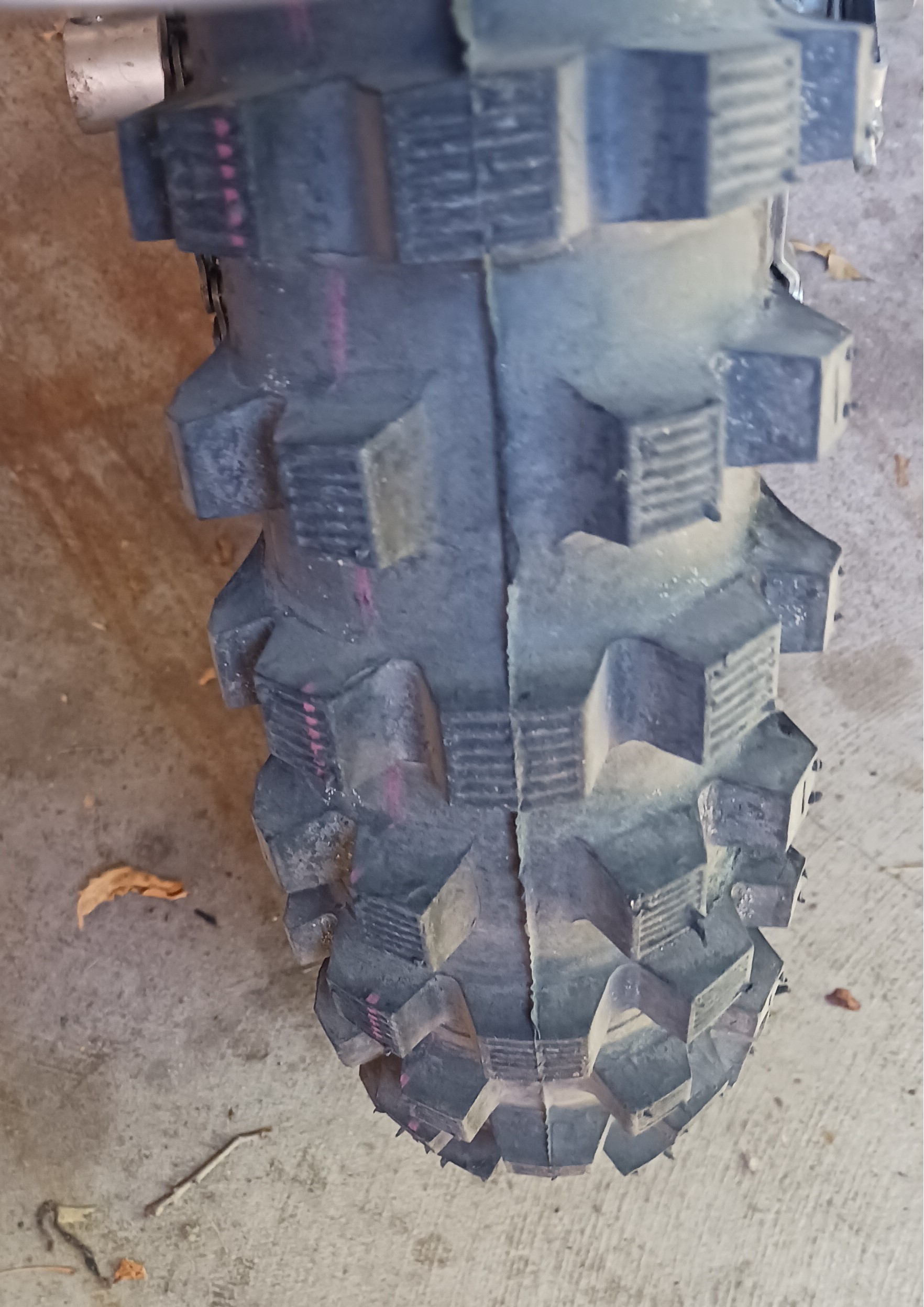

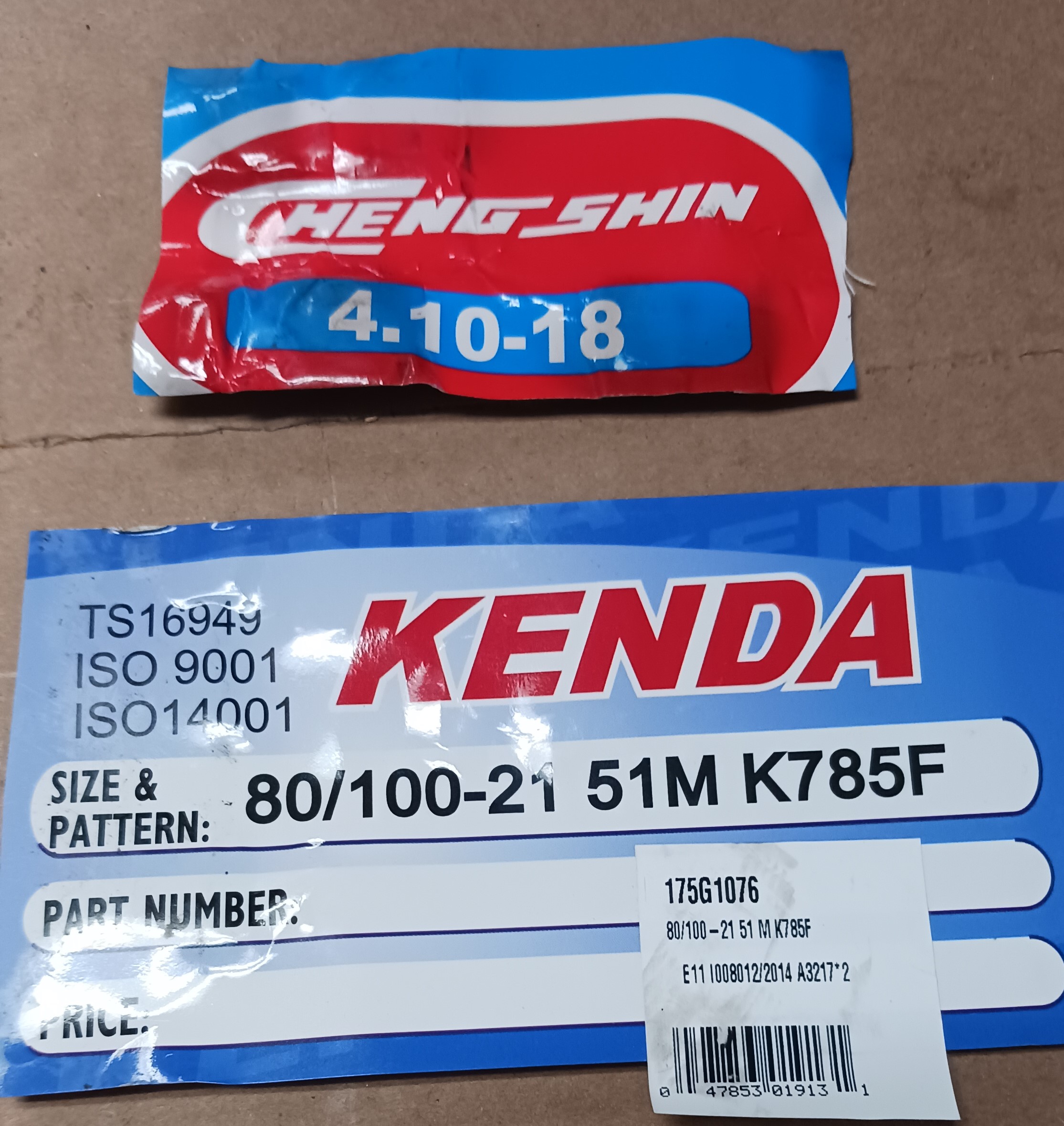

here's what i put on mine and very happy with them .

Great, thanks for the input! No rubbing on chainguard?

I like the Kendas also! I usually get the Kenda Classic or Trakmaster, 80/100-18. :ugeek: Victor

I'm running the Cheng Shin 4.10-18 on my CW. It says 4.10 but it's really a 3.50. No clearance problems.
Larry S
Re: Looking for tire recommendations for newly acquired CW
I agree with Larry. I have gone around the pits at vintage races with my digital calipers measuring rear tires. The Cheng Shin 4.10-18 is the narrowest that I have measured outside knob to outside knob.
All of my racers have the 4.10 Cheng Shin on the rear.
I just checked my sources and indeed have found that the Dunlop K990 90/100-18 has been discontinued and is out of stock. The Cheng Shin 755 4.10-18 is still available , and is still much more affordable than the Dunlop ever was. It performs very well on the Hodakas.
