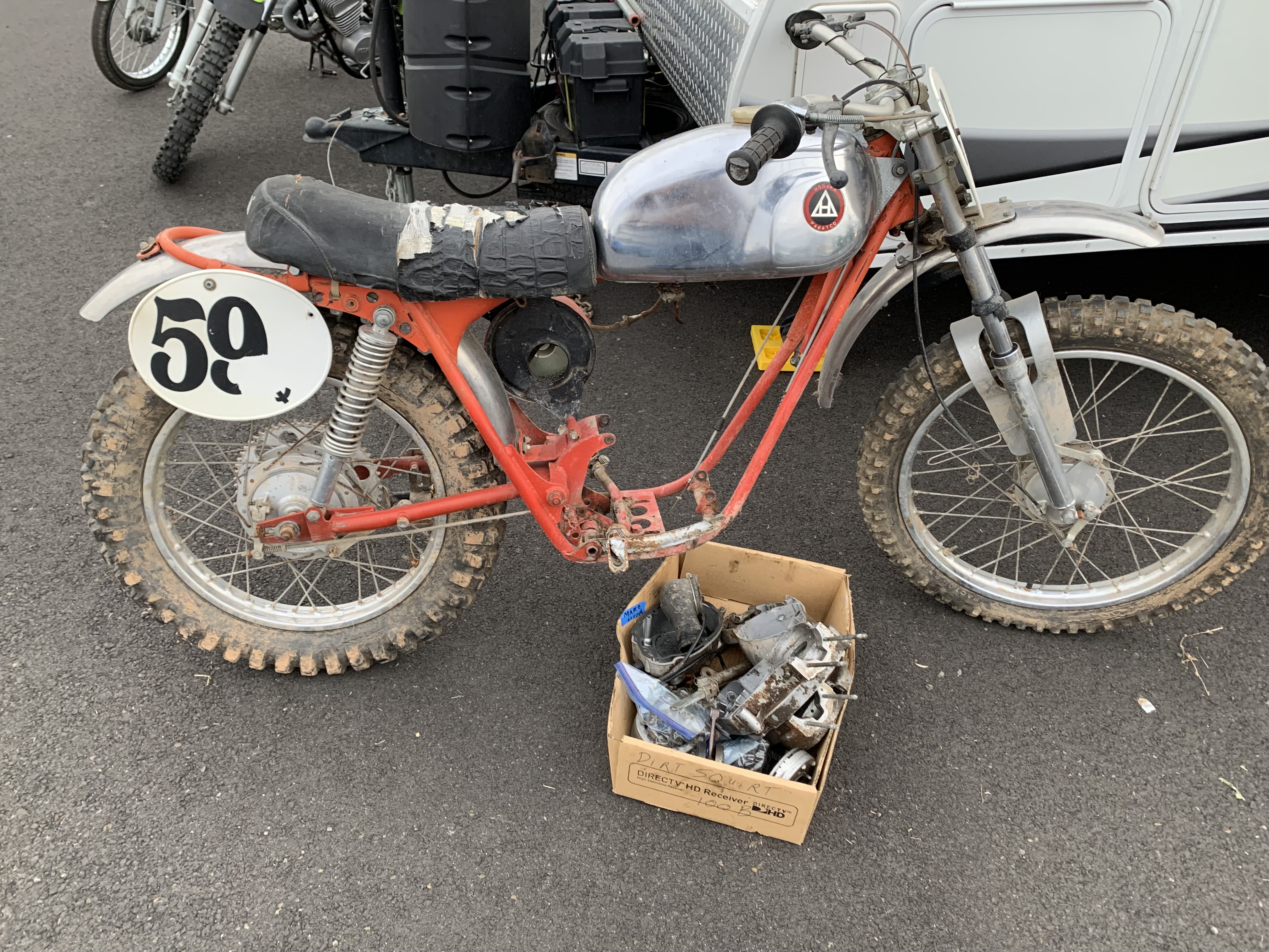

I picked up this 96 Dirt Squirt at Hodaka Days. It was missing cylinder and head and pipe which I was able to find at Hodaka days. The wheels are 18” rear and 21” front. The rims are not in great shape, fair amount of rust and pitting. I would like to replace the the wheels back to the stock 17” 19”. Size.
Does anyone know of a good source to find proper rims? I see Hodaka Parts, Inc has spoke sets but not rims.

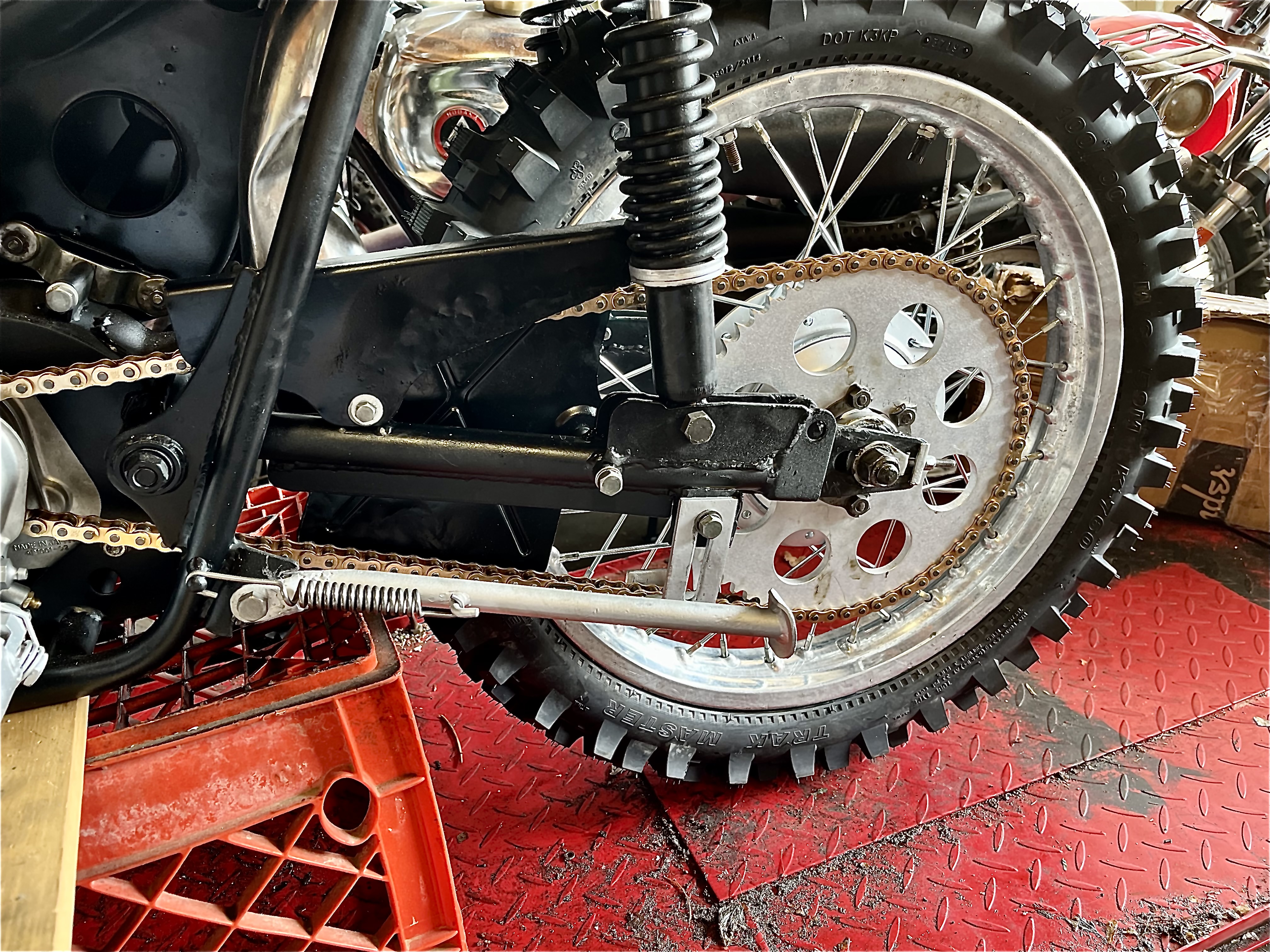

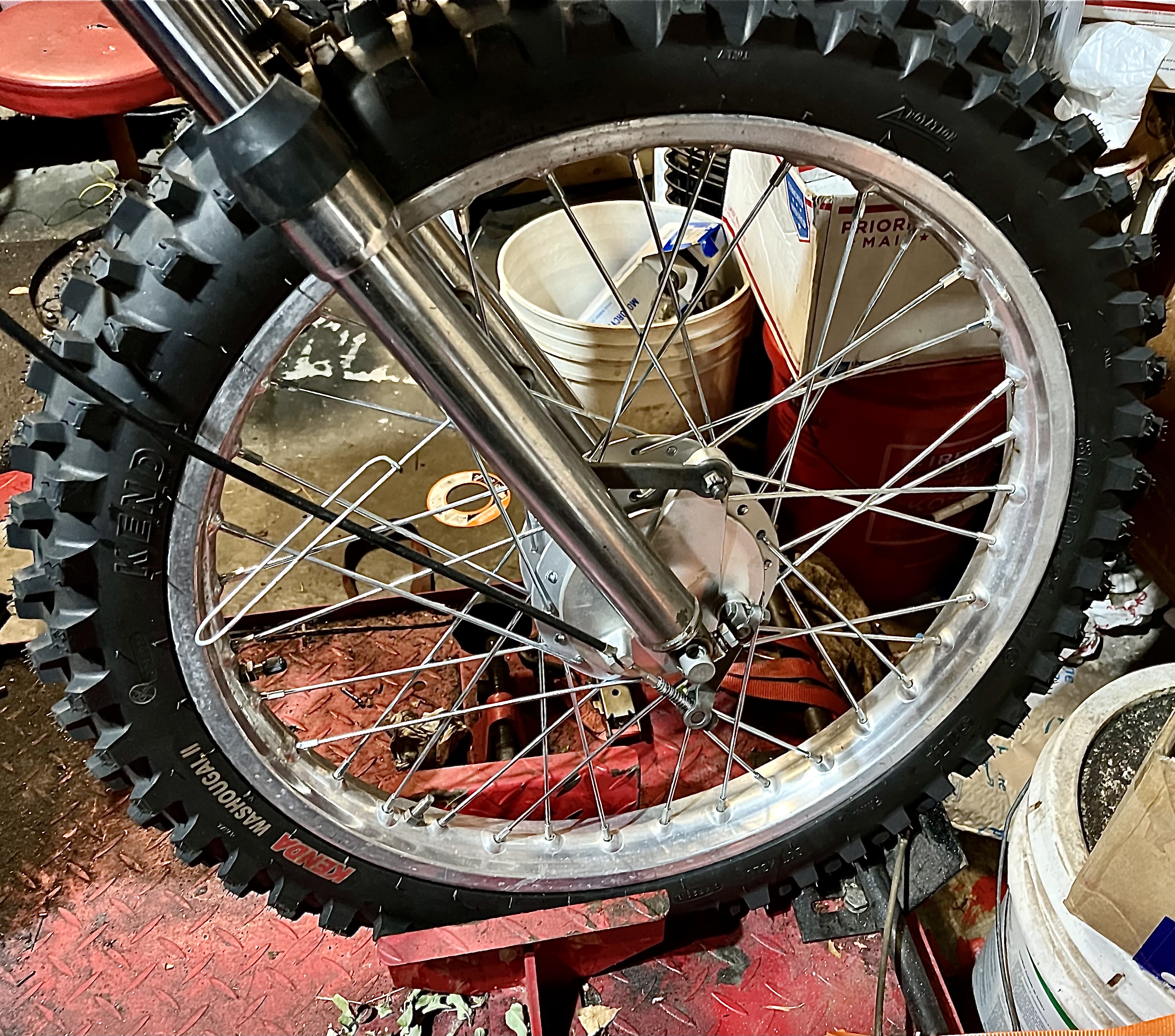

Here’s a couple of wheels I have restored & re-spoked for a Combat Wombat with spokes from Kim.
Now a front or rear wheel can cost you $100-125 easily, plus shipping.
If you are willing (and know how) to respoke a wheel, you can buy 17/19” rims for about $60-75 a rim and about $130 per wheel for a set of spokes. But there is a guy, named Kim, out of Thailand, who sells spoke sets for $75 for a front & rear set plus $33 shipping. I’ve had fairly good luck with him, and if he makes a mistake he makes good on it.
