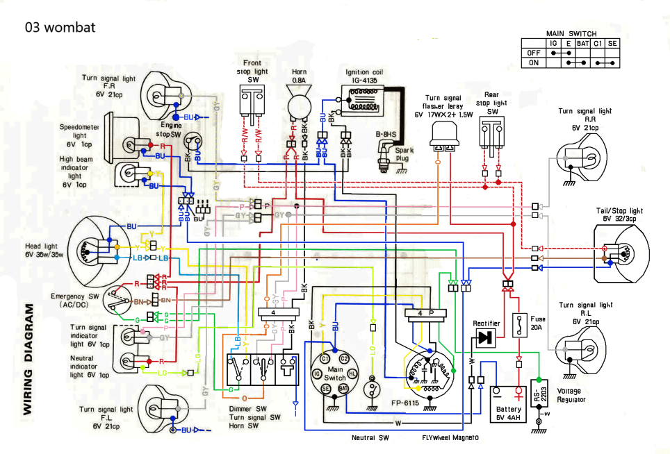

03 wiring
Posts: 2799
Re: Kokusan
That is a very nice wiring diagram! But I think it contains an error. The green wire is shown as connecting to the "ground" circle surrounding all of the magneto components - which would mean that both ends of the "green" circuit are connected to ground - which would be useless. I think the green wire actually branches off between the two lighting coils. I don't have a Model 03 magneto to inspect (hmmmm, maaaaaybeeee I do . . . but where the heck is it???) - so I can't confirm my thoughts on the issue. NOTE: The green wire is shown connecting to the solid state voltage limiter, which shunts voltage to ground when the pre-set voltage limit is surpassed. Nominal 6 volts in this case.

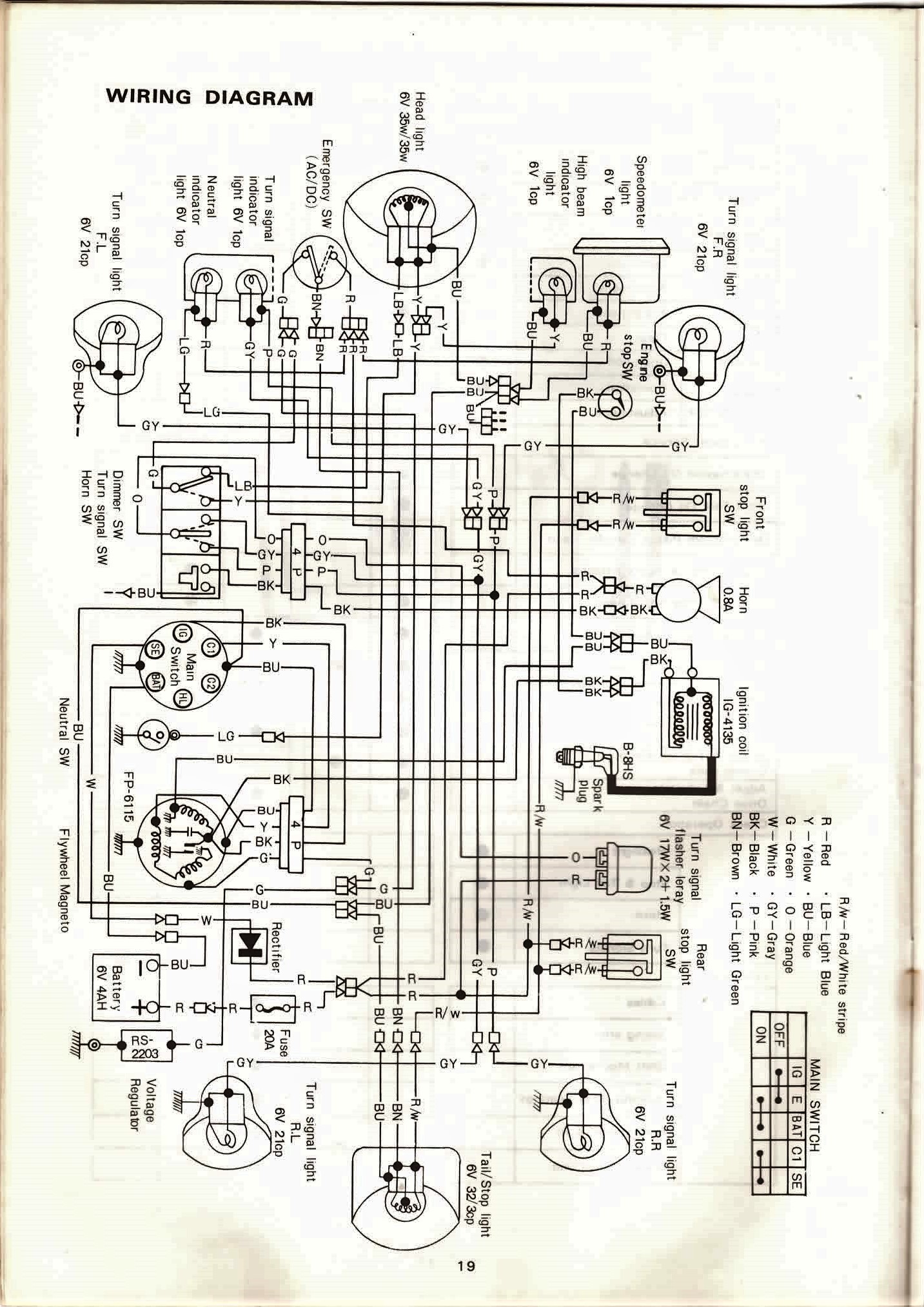

out of the manual
Posts: 2799
Re: Kokusan
Nothing quite like posting a scan of the original . . . but I fear the error is still there. (Which is a real bummer because I MAY have proofed the original before it went in the manual.) So I'll start a spare time search for my 03 engine-in-a-box for a direct look at the actual magneto wiring.
Re: Kokusan
that is a bummer . id look at mine but now i dont know. maybe back in the day you were distracted doing all those adds for the magazines . haaahaaa

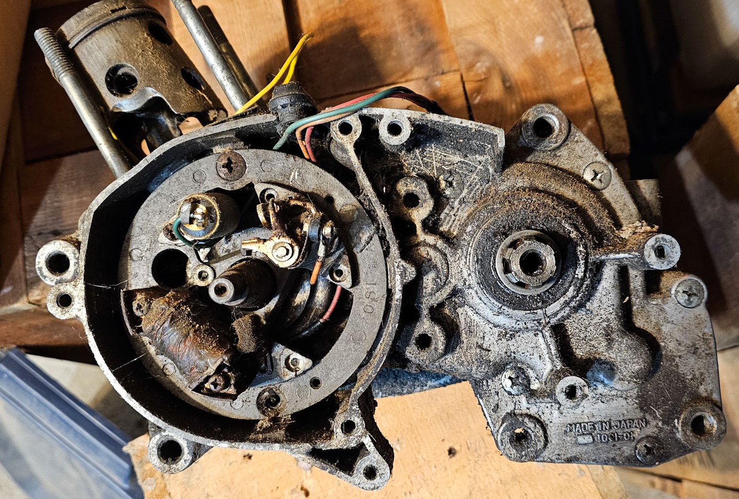

Virtue is its own punishment?? So a little while back I said I'd dig out a "basket case" Model 03 engine to take a peek at the lighting system wiring at the coils to help out a Hodaka friend in need in this group. And here's what happened - after an hour of shifting things around to get to the engine, I discovered that I can't help after all (see photo).
The dang stator has been, er, um, modified - so I can't trace out the color coded factory wiring harness back to where the individual wires come off the coils. Sorry about that. AND THEN, I couldn't find the original post which prompted the digging out of the engine either! (Because I was wandering around in the Hodaka Fan Club Facebook group searching for this post in the Hodaka Club Form. A friend in the Facebook group got me turned around and headed back over here to the proper venue.) HOWEVER, all is not lost . . . at least the shed is just a teensy bit more organized now than it was. 8-)

givergas wrote: Fri Oct 27, 2023 5:07 am03 wiring
Acording to this wiring diagram how can i connect an indicator light when the ignition is on?

Honestly i can not understand this diagram 🥴🥴
From the battery we have the positive always connected to speedmeter lights,tail light,Turn signal circuit,horn,neutral indicator light....all of this have the (-) and the question is : how to turn off this lights??
