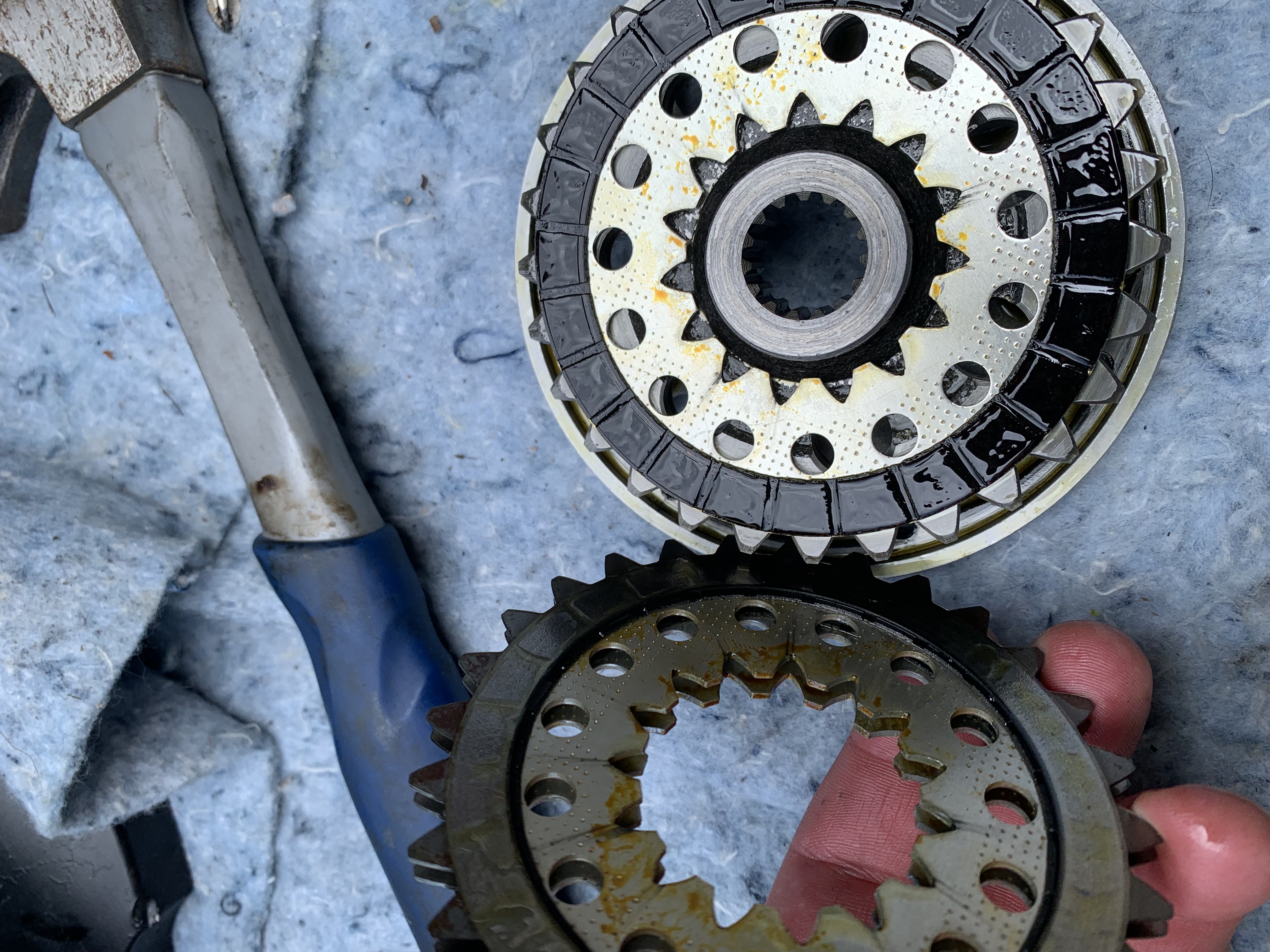

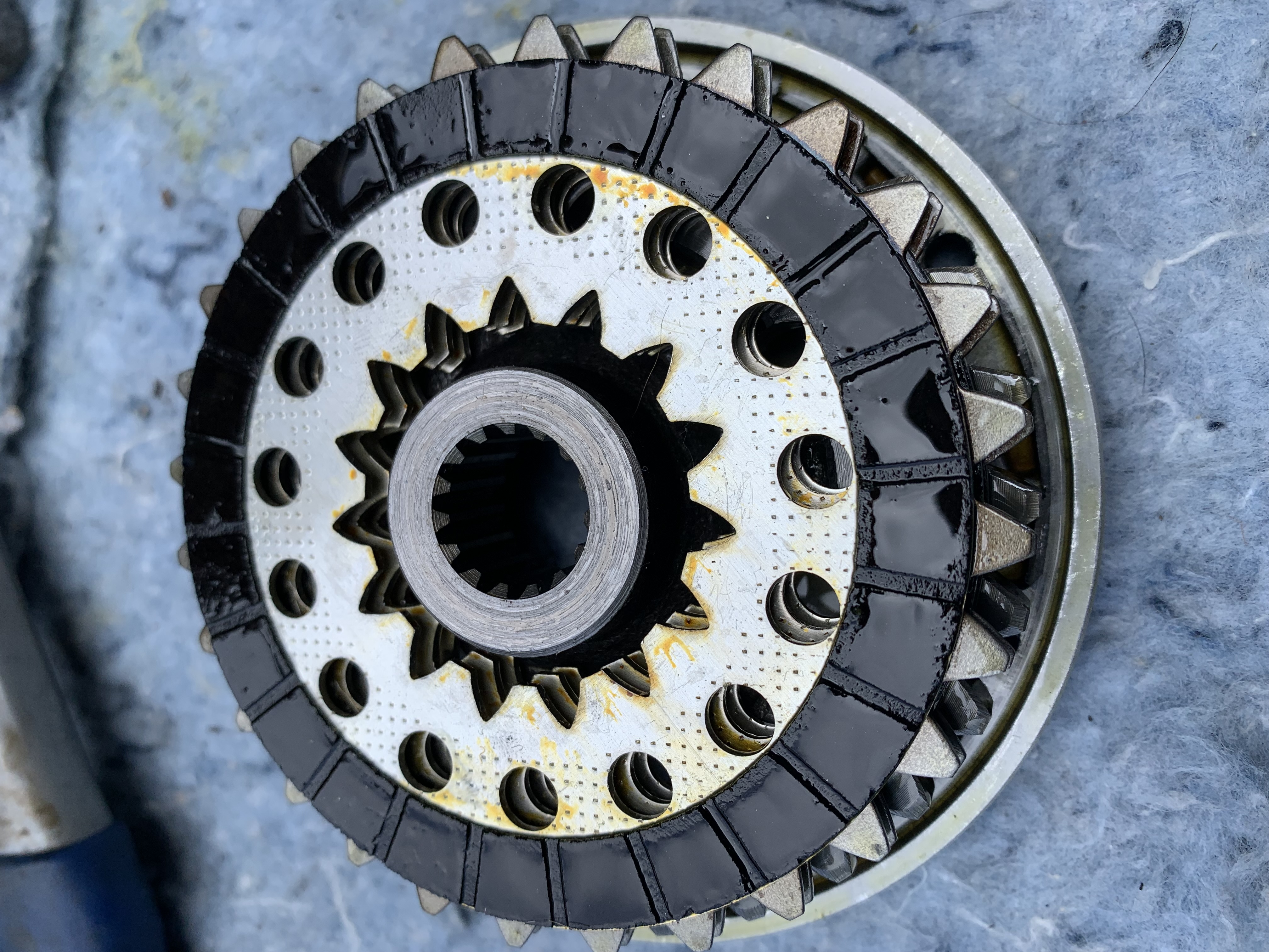

I did take the case off and pulled the clutch patch to look at the individual plates. They appear fine. I put it all together again and still the same issue.

I opened up the clutch again.
The needle rollers are all good. The only thing I found https://hodaka-parts.com/2_B.asp "wrong" was the small shim (#47) was actually installed with the outer washer (#41), so I put that in its proper place. I doubt that would cause any fuss though.
I ended up getting some synthetic ATF after draining the old stuff. I'm almost thinking that old stuff may have been the culprit. It was dirty! I had checked the oil level before opening up the case. The level was fine AND the stuff looked clean. I think it had sat so long that all the heavy stuff went to the bottom and made the top layer look clean.
