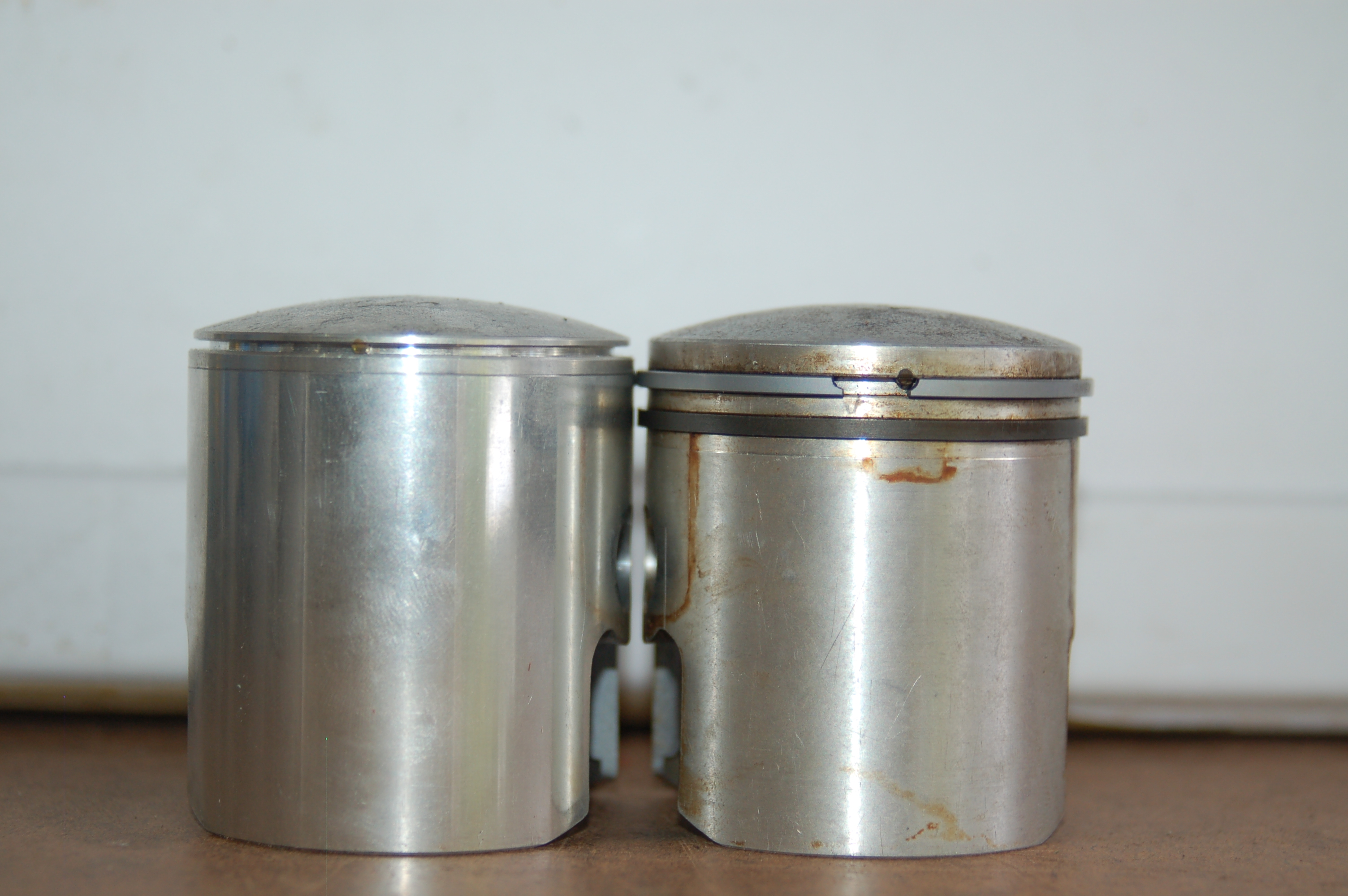

Here is a photo of the two side by side. You can see in the photo that the Ace piston (2 ring) has a slightly higher dome than the Super Rat piston.
I remember reading the article about the differences, just don't remember where it was. I will continue looking for the article and send it to you if I find it.
