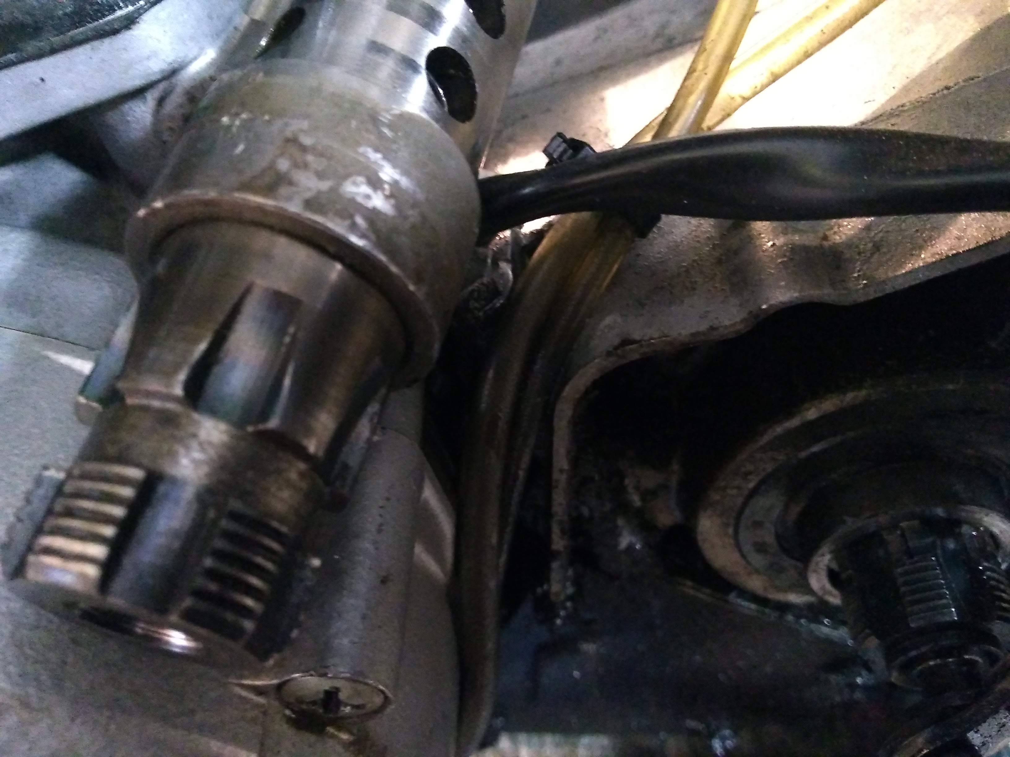

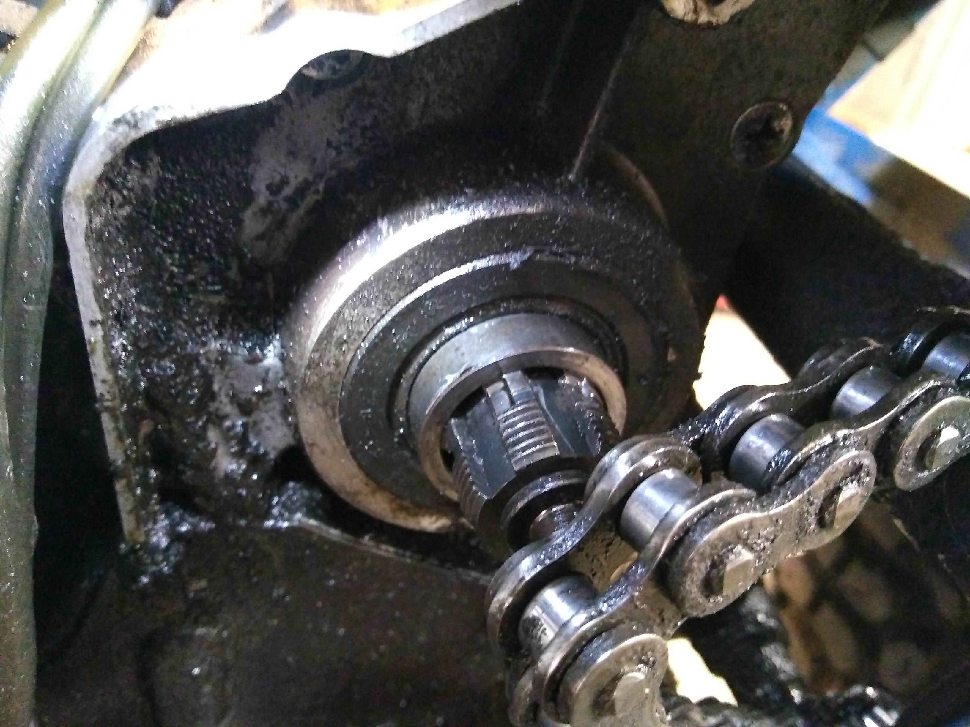

Another issue for the Hodaka Think Tank:
Some years ago I totally rebuilt the bottom end of a waterlogged 250SL with only 830 miles. That involved bearings and seal, so essentially I considered the engine as having basically zero miles.
Later, at around 4500 miles the countershaft completely sheared at the sprocket. I split the cases again and installed a new CS.
At about 6900 miles I replaced the stock 14T sprocket with a 15T, at which time the CS splines looked fine.
Lately the bike has been exhibiting the typical Hodaka loose CS nut leak seepage. On inspection the nut was slightly loose but the lockwasher tab would've kept it from turning after it was last torqued. However, as I was dreading to discover, the splines on the most recent countershaft are shearing -- at least halfway at this point.
Am I suffering alone with this problem? I haven't heard of any other 250 riders in the same boat.
There are no apparent conditions that would cause any unusual side loading to the sprocket. Could I be overtightening, or undertightening, the countershaft nut?
Anyway, this will be the fourth time I've had to split the cases: 1. Initial rebuild; 2. Melted and holed piston; 3 and 4: Countershaft replacement.
Thinking now about preventative maintenance while the engine is going to be completely in pieces: at 9,000 plus miles should I also replace crank seals (and anything else) pre-emptively?
Thanks Guys -- here's couple pics too.

Incredible !!! What is happening here is a hardness problem. Can you get a new counter shaft and get it hardened so this wont happen? That depends on the metal it`s made of. This may be a problem that just can`t be fixed. Joe
Re: Why oh why...
At 6500 miles the splines looked fine, At 9000 miles the nut is loose and the shaft is damaged. I have had the problem when assembling, the nut was tight but the sprocket was loose . The nut got hung up on the locking washer. The nut must be tight and stay tight. Once the splines are distorted there is no way to keep the nut tight, that is the same thing with the splines under the clutch. The manual's maintenance chart states, check all nuts and bolts every 500 miles --------- Clarence

What I would do at this point is to find a used shaft that shows no signs of wear. I had this happen back in the day to my Super Rat clutch BUT the Crank shaft splines were Perfect. Sometimes a used part that has proven to be trouble free is the best option. Just my opinion. Joe.

In my "quest for truth" as to why the splines are shearing I can clarify that the sprocket nut was just loose enough to weep some oil and the sprocket did not have any significant sideways play.
However, it comes to mind that Honda's countershaft sprocket design (sprocket loosely retained to the CS by two 10mm bolts holding a retainer plate) allows for significant designed-in looseness and play on the CS without consequence, so I'm not getting my head around how any slight play would cause shearing to the Hodaka splines.
Is it possible that metal fatigue sets in? Coincidentally, both shafts failed with around 4,500 miles.
As for hardening/tempering, both sheared shafts have blued ends, but perhaps they weren't properly quenched after heat treating. In this light I can see how a used/proven/veteran/experienced part would stand out amongst a batch of defective countershafts. Are there any metallurgists in the group that could offer an opinion?

Okay, I referred back to a topic in Hodaka Chat that I started the last time this happened in September 2016: "Shear Agony..."
Consensus then, as now, is that the failure stems from a loosening countershaft nut and the vibrations that result.

It looks, at first glance, at your photo, that the threads almost appear to be brass? Say it’s just discoloration in the photo, I really don’t know.
With my 125’s I just tighten with a 26mm socket until it’s snug against the bushing. Then I tap up the lock washer. I haven’t seen one work lose on the 125/100 bikes I work on.

Not brass -- but it seems as soft. Did I mention that the sprocket splines show no wear or damage?viclioce wrote: ↑Tue Nov 23, 2021 5:49 pm Well Darrell, I personally haven’t worked with a 250 yet. The lock washer was my first thought. I don’t see any torque listings for the CS nut.

Are you sure that the countershaft sprocket is the right one? There are 4 different c/s sprockets that will fit on the countershaft, but only one is the correct size. The sizes of the 4 are as follows:
diameter of the inside of the splines: 16mm, 17mm, 17.5mm and 18mm.
diameter of the widest opening of the splines: 20mm
spline thickness: 4 mm
All 4 would fit on a countershaft made for a 16x20x4 sprocket, but the ones with an inner diameter of 17mm, 17.5mm and 18mm would not have as much contact with the shaft as the 16mm one. If this was the case, it could easily result in excessive wear on the countershaft splines.
To see an example of these go to jtsprockets.com and look up JTF413.15, JTF266.15and JTF 259.15
