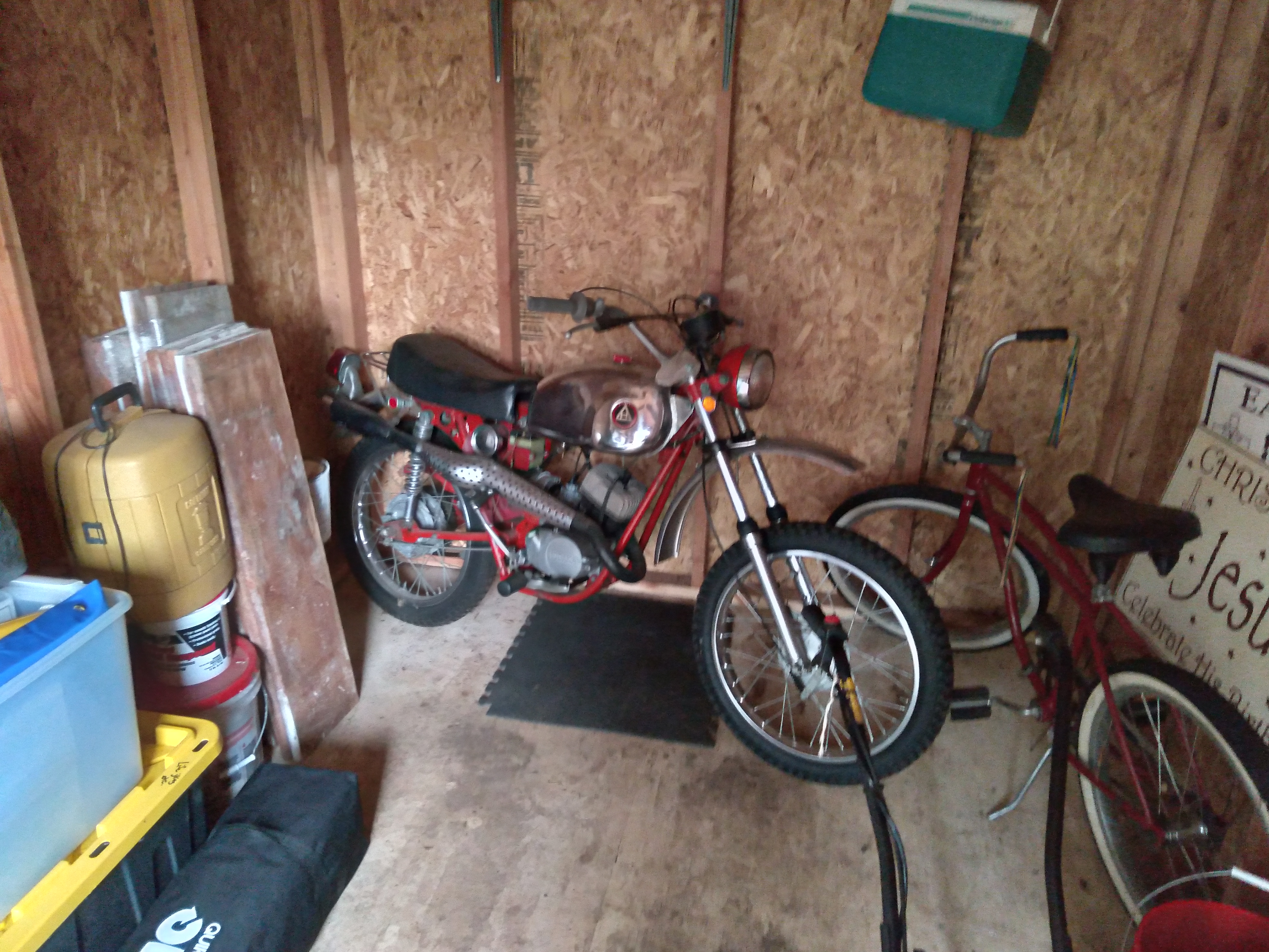

First Post Here Ever! For my '71 100 B+, …….is there an LED 6v option?

RevvinKevin wrote: Sat Oct 09, 2021 5:15 am First Post Here Ever! For my '71 100 B+, …….is there an LED 6v option?
The 15 watt standard headlight works fine and lasts forever as it never gets hot. It's great in the daytime. It's only at night there's a problem. Even then it's pretty good up to maybe twenty miles an hour if you aim it a bit low. ;)
The headlight is unrectified AC. There is an AC/DC switch on the underside of the headlight bucket to connect it to the DC taillight side for roadside illumination in case the motor quits. The whole system is based upon balancing the load and the [meager] generation capacity to achieve voltage regulation. Unexpected things could occur if you start subbing in differing wattage draws such as overcharging the battery or frying other bulbs. IOW, it is necessary to fully understand the system before modifying anything.
The problem is to find a sealed beam with an led. Non existent. Gutting the bulb from a stock one and mounting an led inside is the project.

Thanks for the info....I'm in the early stages of dragging my B+ out of the shed for service. It's 30 year service, that is!
