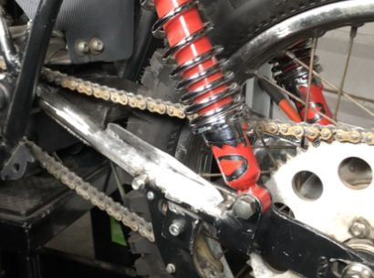

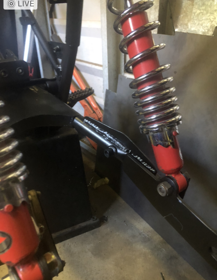

This has gotten a bit out of control. Stiffening up the swingarm is complete. Front section boxed in and arm rails added. It weighs 700g more than a stock wombat arm but the frame will break before the swingarm will. Paint to come.

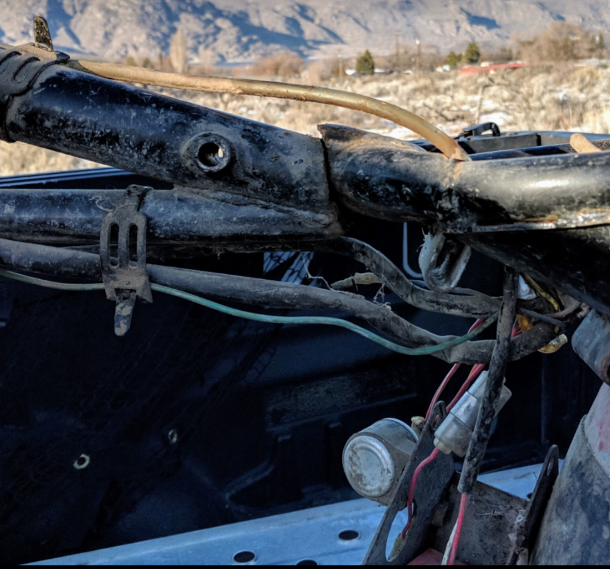

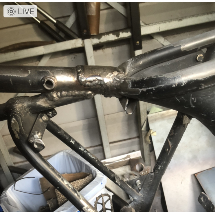

Uh yeah, about frame breaking. Here is another good place to gusset.

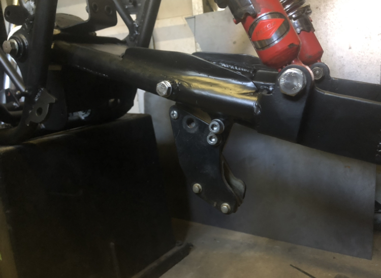

Part of the case Reed installation required removing some engine mount bracing to allow the carby to fit. It’s actually more like a road toad set up. I reinforced the rear engine mount with a doubler with 2 mm sheet metal to make up for it.

gearyoliver wrote: Sat Jan 02, 2021 8:18 am Uh yeah, about frame breaking. Here is another good place to gusset.
Some nasty porosity in the factory welds in that area on my frame

Ok I’ve done a bit of bracing in the frame area
Not pretty but functional. It’s a bit restricted in what can be done due to the seat mounting lugs.
Also attached is a picture of a Road Tiad frame. I can see what looks like extra bracing from the factory. I which I had seen that earlier .

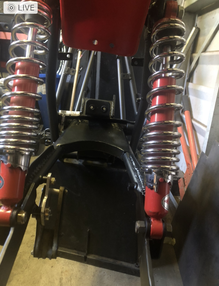

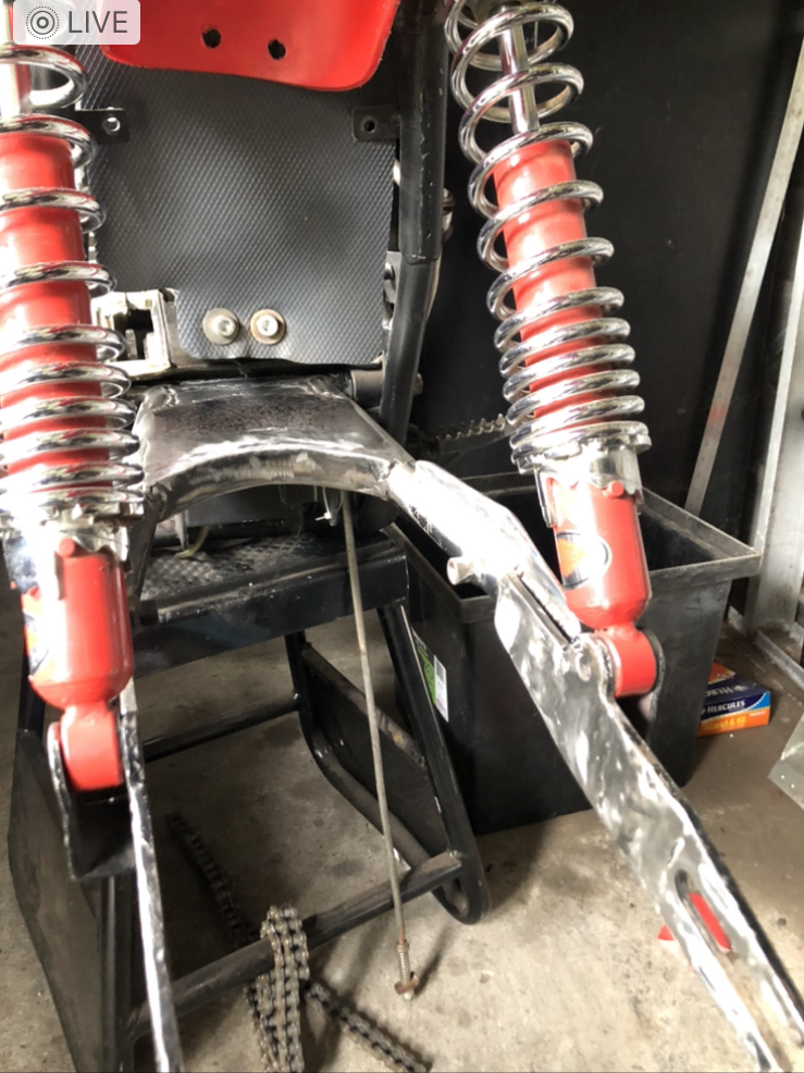

Completed swingarm pictures

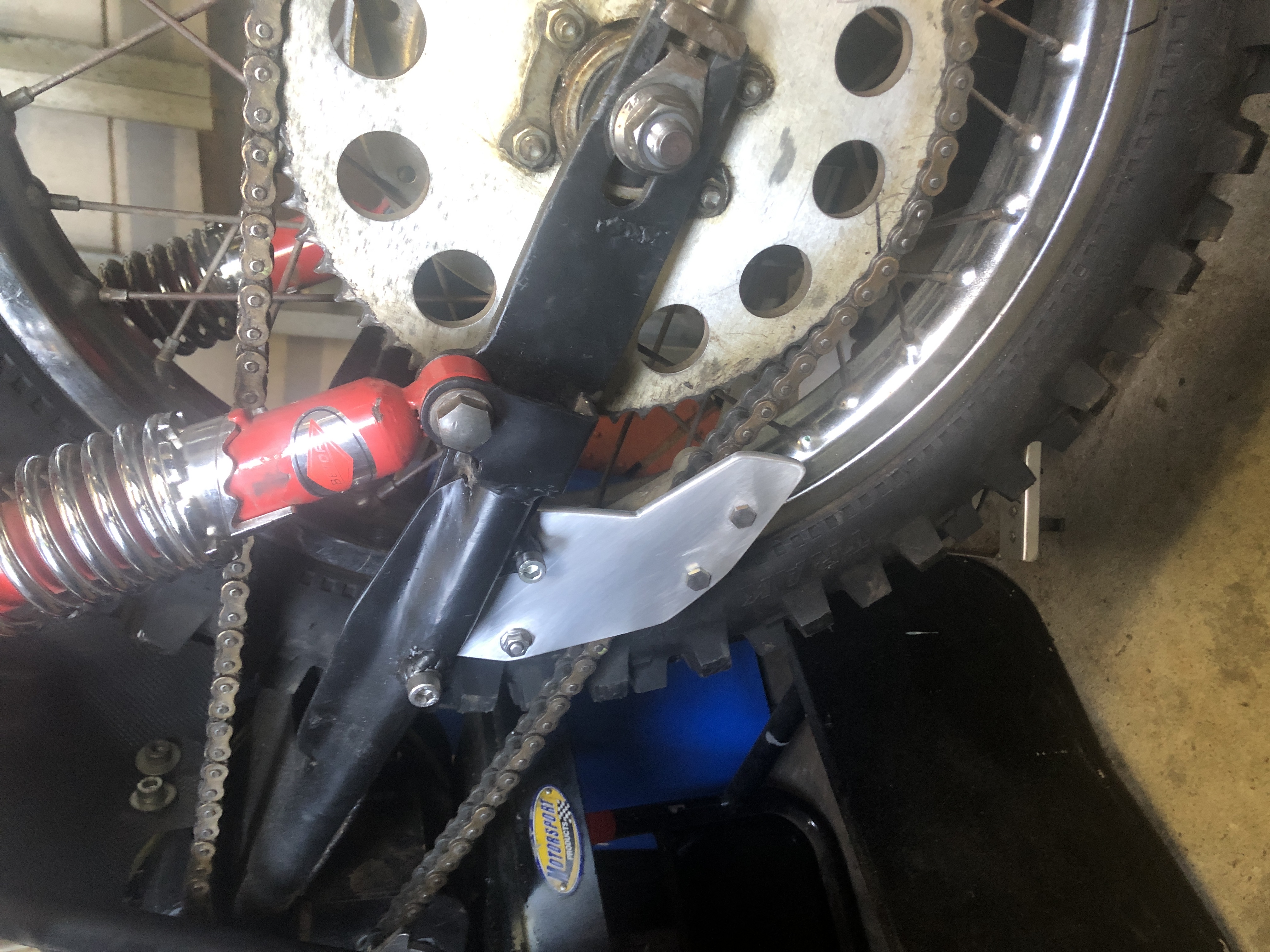

Well after some constructive criticisms sticking in my head I dumped the airbox and made up a new design. This one allows a larger filter and reduces weight . I made a version with an aluminium mikuni “trumpet mouth “ and then a short while after I came across a 35deg reducing rubber elbow that allows a smooth taper from the filter to the carby inlet. I went with that one . Not sure if the two would be different to be honest.
