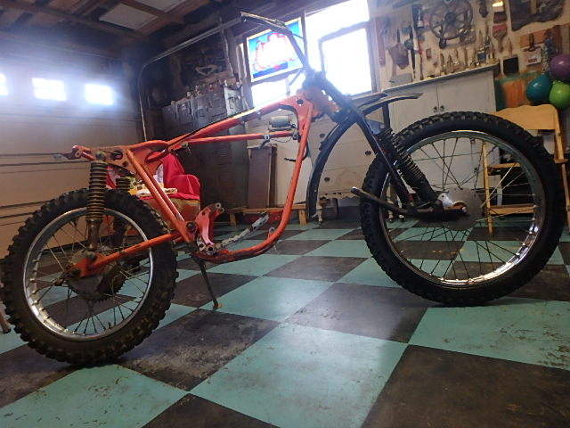

I'm in no hurry to build this engine, mainly because there is soooo much to do on two frames, brakes, levers, cables, swing arms,etc..sheesh...it never ends. I've set aside any frame work for now and concentrating on engine parts alone.

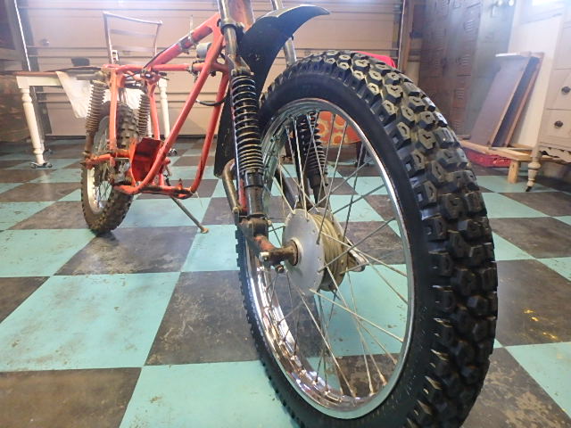

Mounted the original 21" Front Tire
Stretch Neck
Stretch Neck
