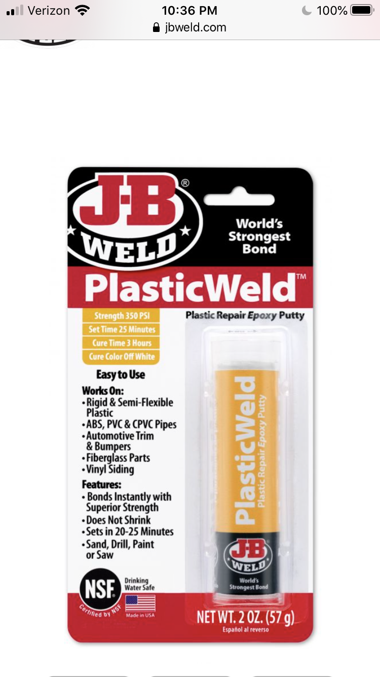

There IS still a JB Wrld plastic repair product available which isn’t a 2 tube, mix and use product! It’s Plastic Weld!
