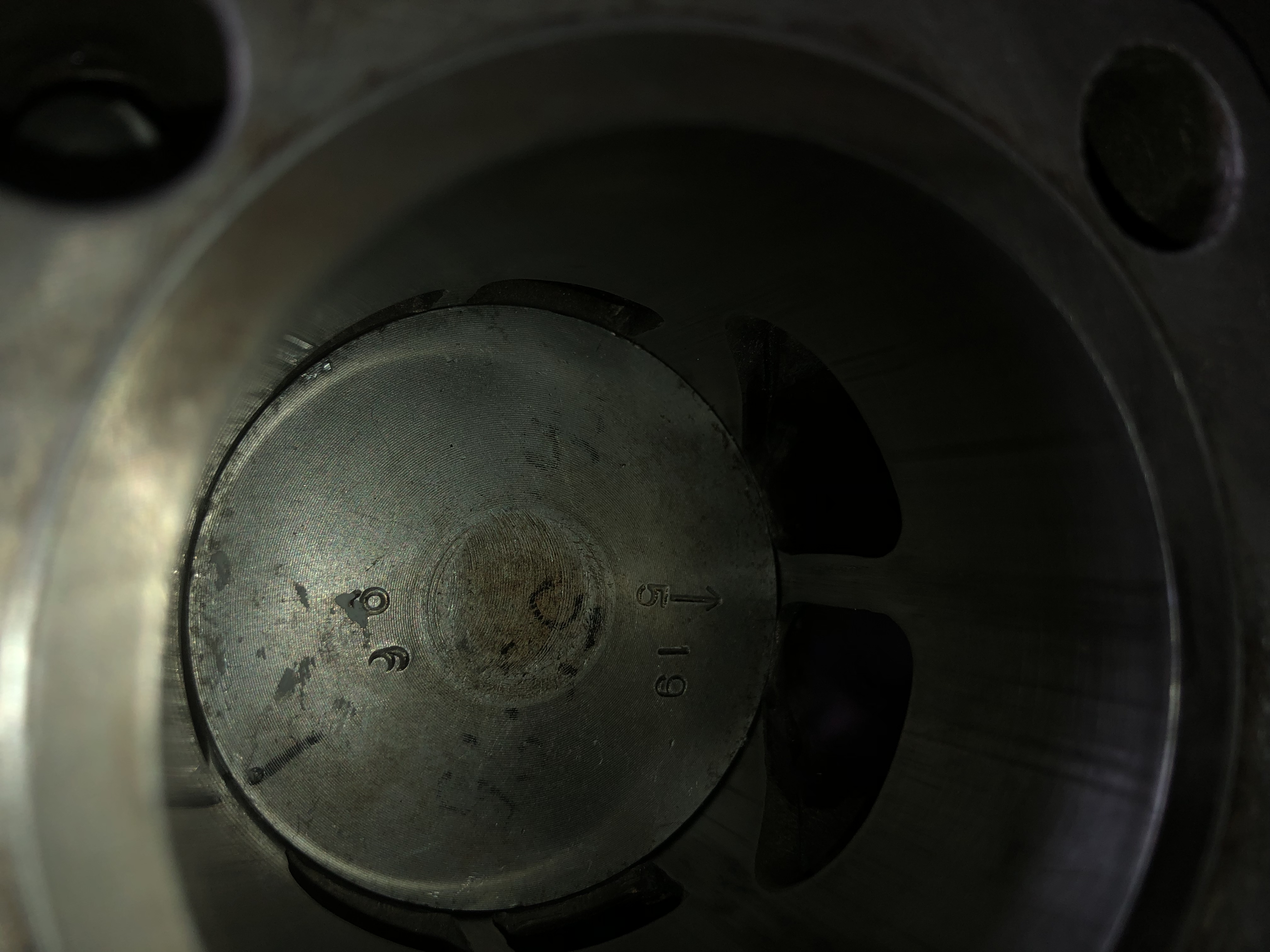

Back to more development. The first outing was promising but hampered by a surprisingly very lean main jet ,400 . Might be other things going on with the angle of the carby so I decided to bury the main jet deeper in fuel using the deep nut and main jet extender that Mikuni sell. At least next time I won’t be wondering.
I ended the day with a 4 point piston seize so not good. Another thing was the ART piston ring locator pin tried to come out . Admittedly it was repositioned . Back to the YZ or MX piston as it’s pin is in a good position. It’s not always going to go to plan .

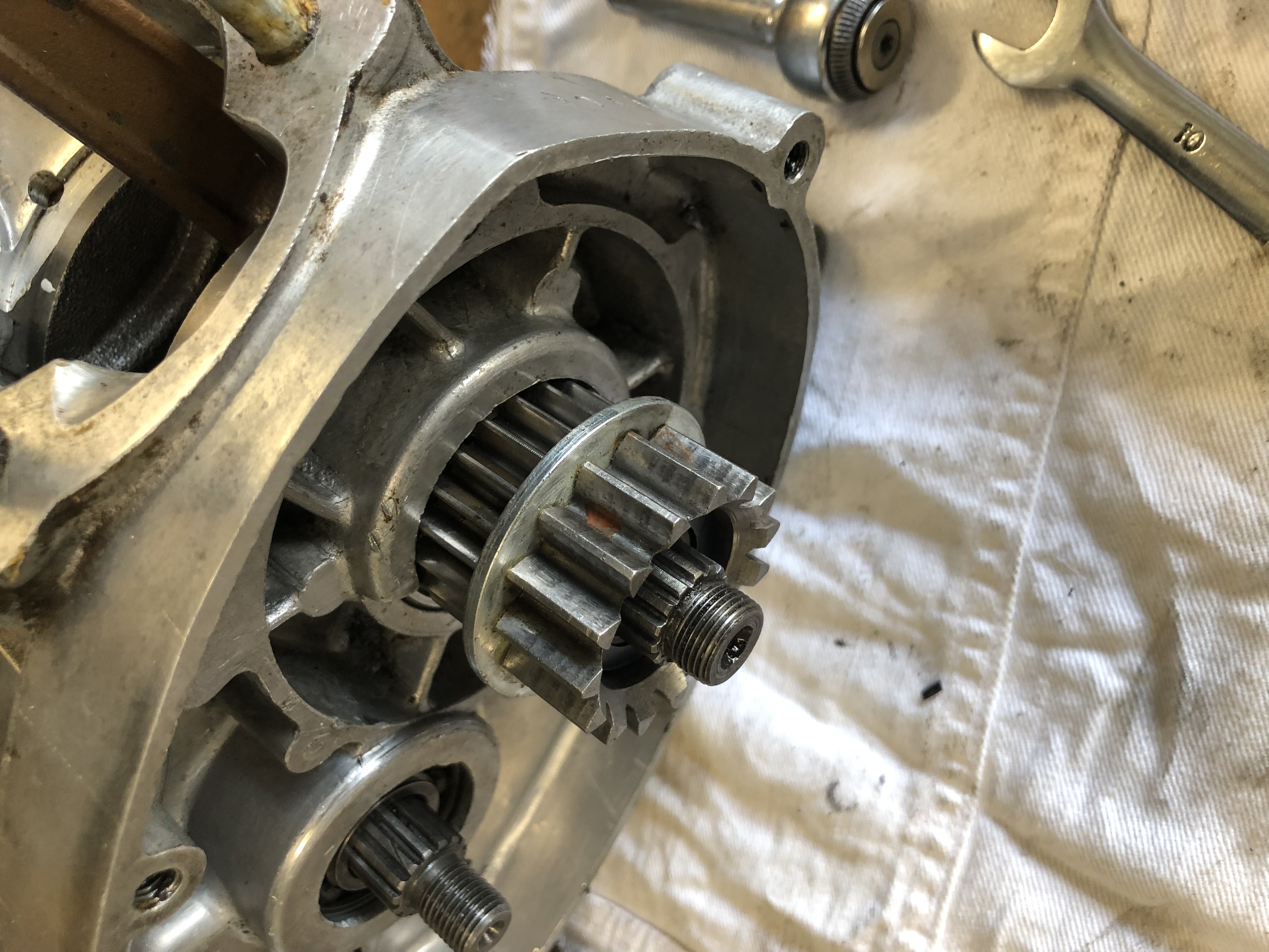

I can report that the clutch gear mod worked , as in the clutch works . Weather it’s going to stop gear breakage only time will tell. To note the first gear strengthening didn’t get a run as I worked out there was no room for the clutch to travel when the lever was pulled in. I worked that out prior to fitting. This is just a steel washer press fit over a turned down gear, also using bearing retainer locktite. There are 4 weld spots to take up the space between the gears so that the washer can’t come off the press fit.

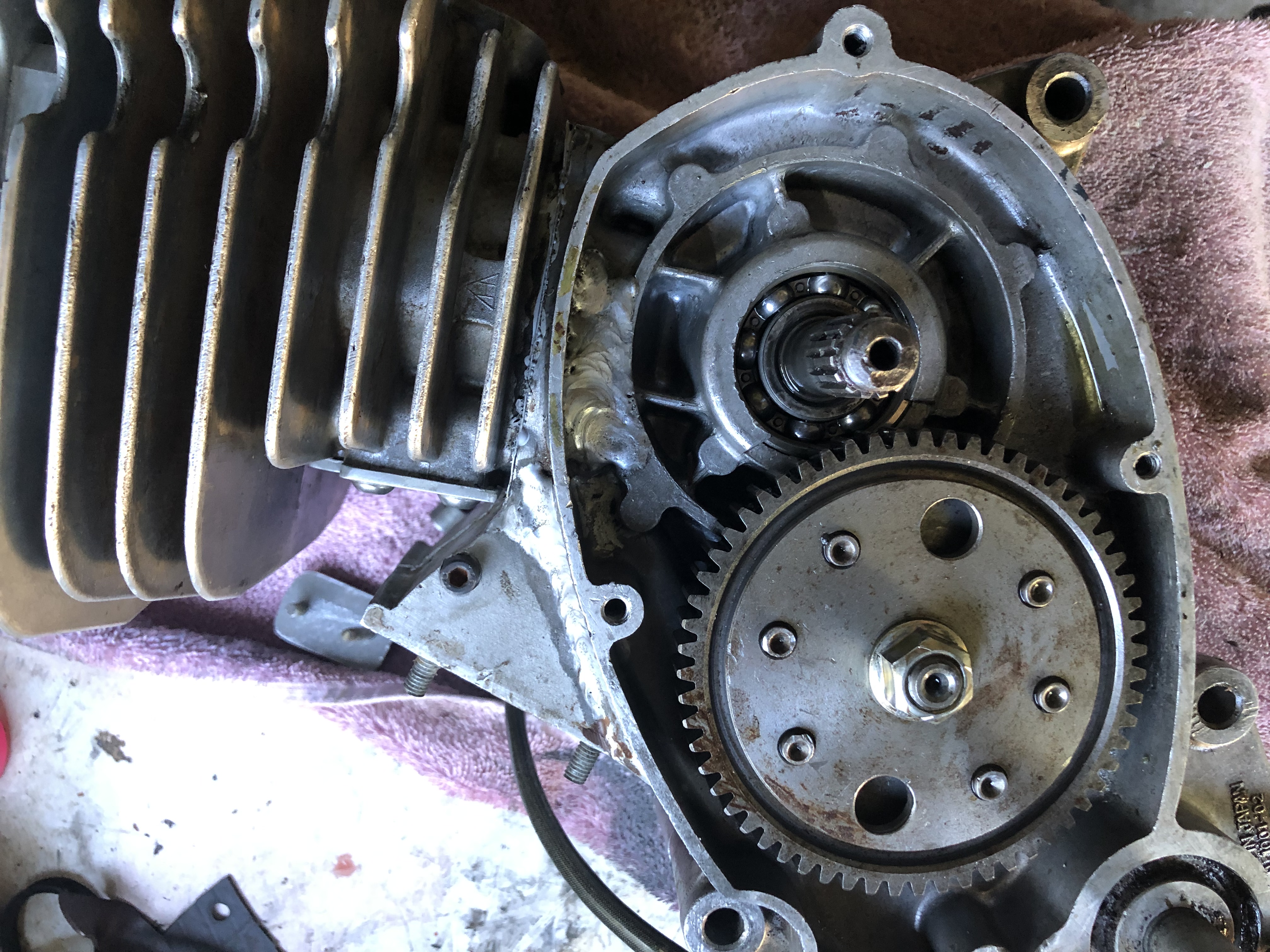

Here is a picture showing the welded cases allowing larger transfer tunnels with out breaking through. Never a good thing .

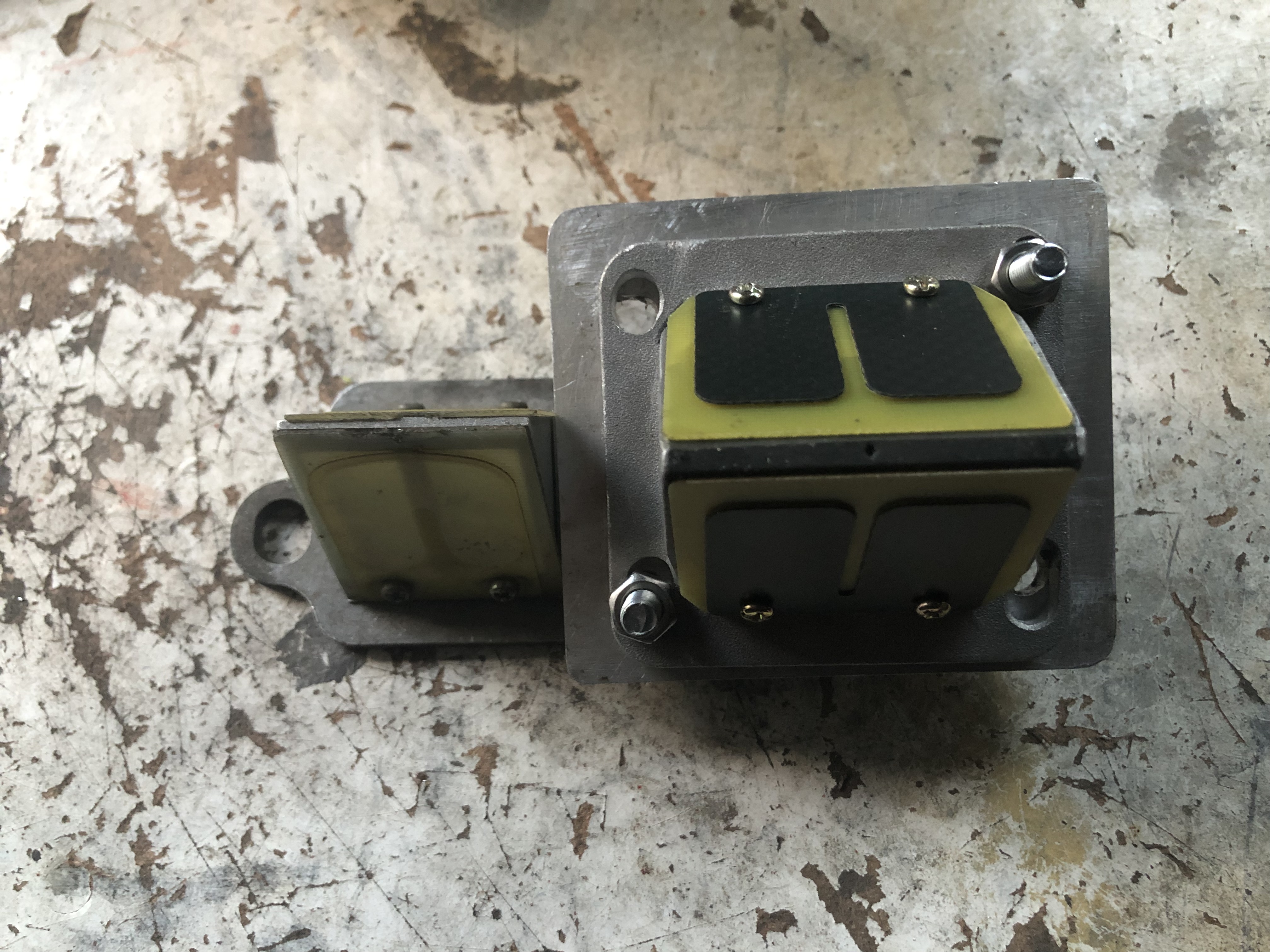

I’ve had a rethink in the reed valve. I’ve gone for a Yamaha RD 250 reed block . Essentially a 125 cylinder as the RD 250 is a twin.
Let’s see how this goes !

Check out the Design of the FMF Ram Valve. Time to play with Reeds! Impressive project! Joe.
- Posts: 275
- Location: Australia
Re: Case Reed 125 Hodaka Project
Thanks Joe, I had a look at the FMF reed valve. From What I can make out its not much different to the Boyesen reeds.. I made a big effort to keep the internal volume down with stuffing but apart from that its pretty standard gear. I thought of adding a vane to separate the bottom and top reeds but in the end I didn't go down that path.

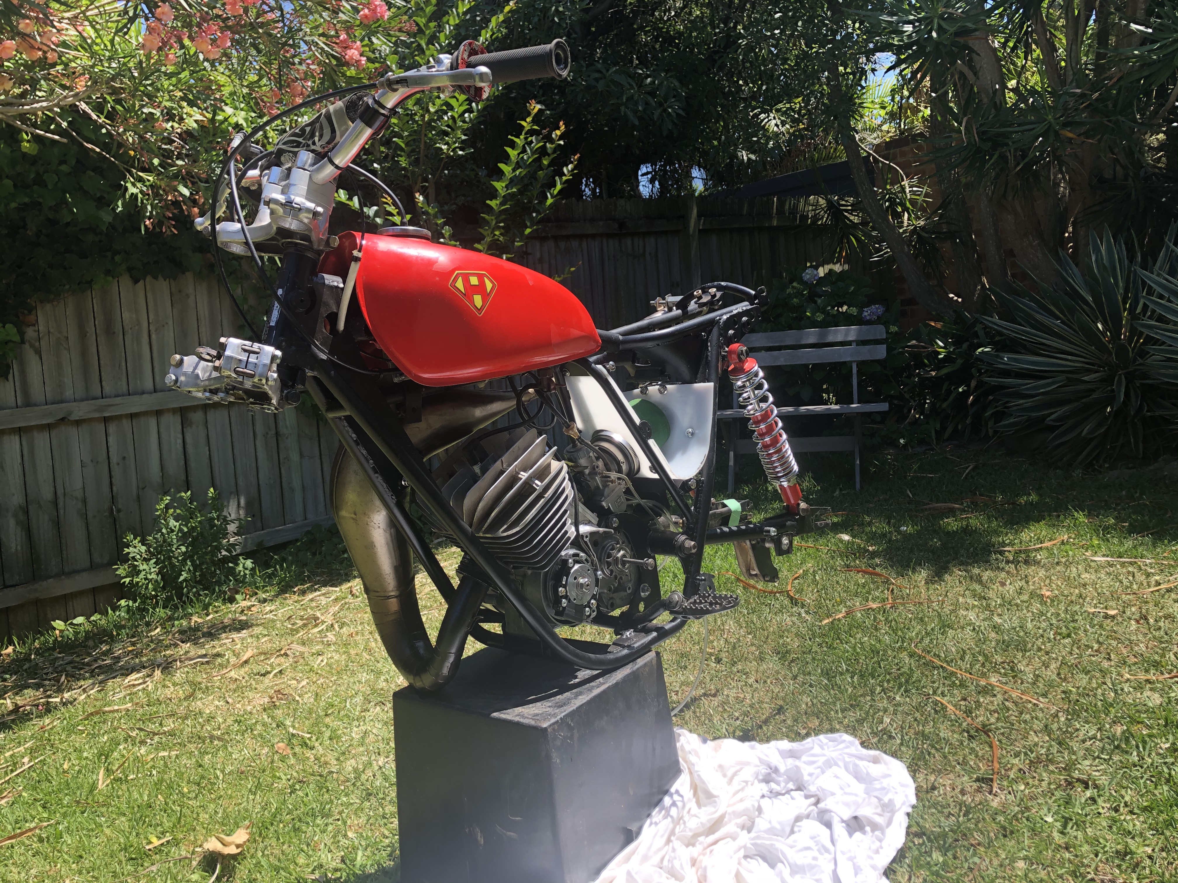

Big step achieved today . Up and running !
I still have the fuel tank to re spray but apart from that it’s fit the forks and wheels .

I am sooooo waiting in anticipation for reports on how the clutch spur gear modification works. I had done some brainstorming on ways to aid reliability of that part in those stratospheric horsepower engines you guys are building . . . and the light bulb
didn't come on for me with your concept. Looks like a worthy modification to test! I am sooooo . . . waiting . . .
- Posts: 275
Hi Ed that is easy to report on , it works . I have it in my other race engine. When I say it works I mean the clutch still works , I can’t say it stops cracking rotor gear until it cracks and then I can say I doesn’t, if that makes sense.
The only thing to watch out for is making it too wide as the clutch moves towards it when you pull the lever .
