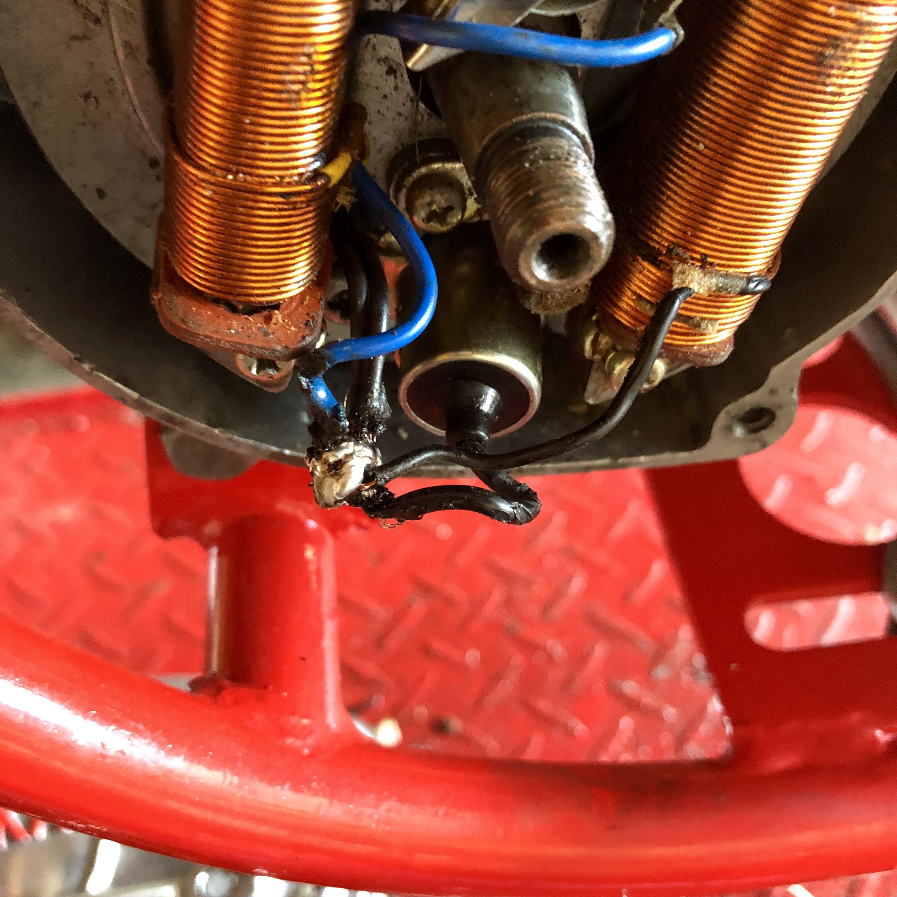

Joe. I had some trouble with this wire. It was well stripped back. But I had issues with the solder sticking to it to tin it. I ended up twisting all the wires together and soldering them all together with a rather large ball of solder and then wrapped it with electrical tape. Should I consider heating the solder and separating the wires to reinspect the coil wire? :ugeek: Victor

I would. I would start with a bare condenser and go from there. I use a Dremel with a sanding drum on the Primary Coil wire. If it won`t Tin it`s still not clean. Joe.

Definitely worth checking out. Getting that layer off is crucial to a good solder joint. The other wires could be making the bond. When I helped a friend wire guitars. I got in the habit of doing this to the pick ups because they had a layer of lacquer on them.

Sorry victor that is one glob of solder. Type in (how to solder wires), on the internet there will be several examples that will give good advice. ----------------- Clarence
Re: No spark!!!
I know how to solder. It’s a tight space & even with tinned wires I had a difficult time with it. A 3rd hand would have helped. Gee. Want to come over & do it for me? :?: Victor

The problem I experienced was not having any way to hold the 4 wires together, because they are all so short and very little room there to work. :ugeek: Victor

Took it all apart, removing all :geek: solder except the remaining tinning. Redid the connections using a small alligator clip to hold wires together as I went. Still nada!

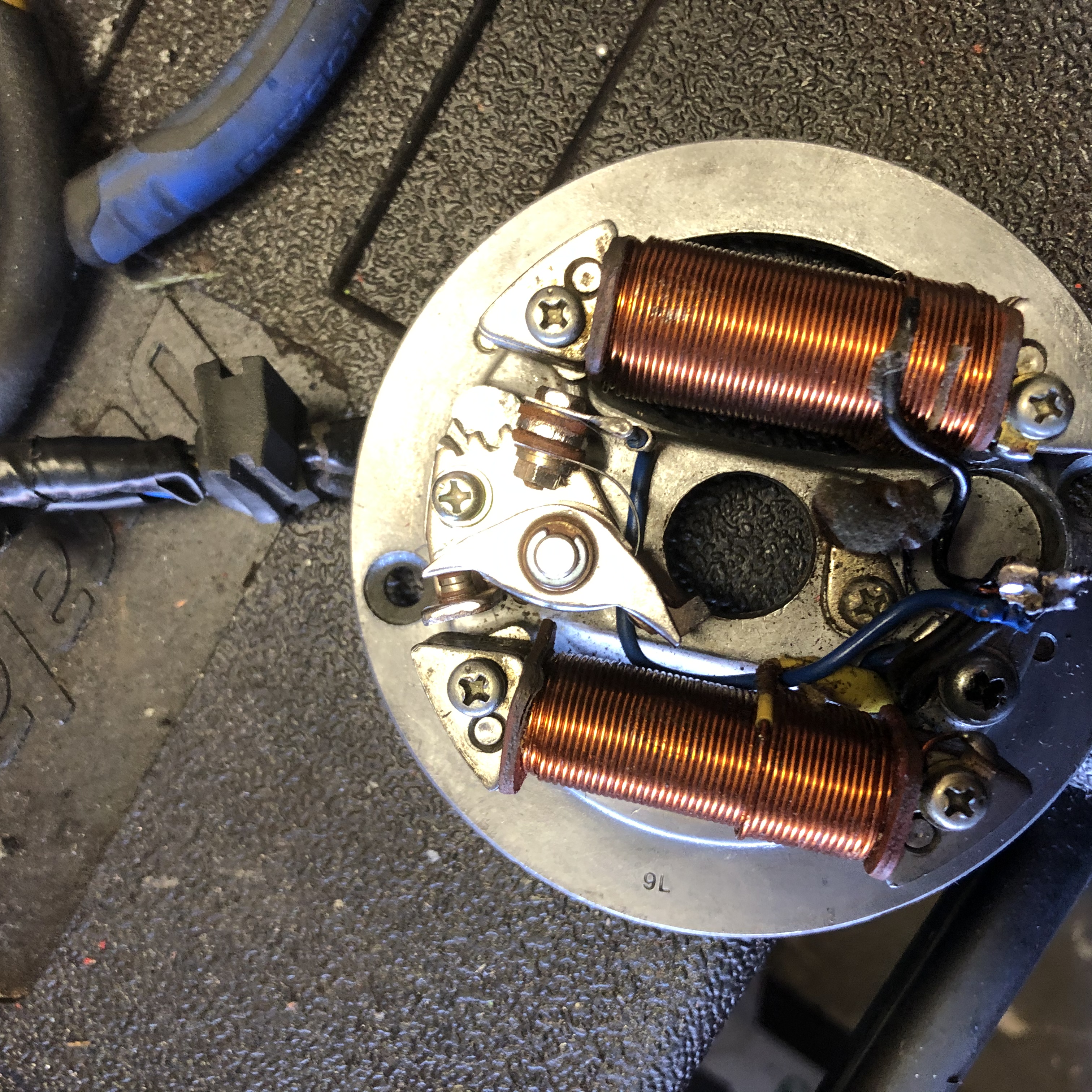

Called Dan Cooke. Found out I had the points wire on the wrong side of the insulator. Changed it. Still nothing.
Tried using a second condenser, hoping it was just a bad new condenser. Same result, NADA!!!!
Ordered a new multi-meter. One with a tone for continuity. Wondering if it would be a break in either the black or blue wires from stator to spark plug coil? My meter is one of those Harbor Freight red ones. It gives a .1 display for continuity, I guess, because when I set it for continuity and just touch the probes together, that’s what I get, a .1.
I may try using a completely different stator. I think I have one spare. God only knows if that will solve the problem. I’ve NEVER had electrical issues this mysterious!!!
And yes, the ignition switch is still disconnected.... :ugeek: Victor

I’m going to pull the entire stator assembly from this bike and try a different one. Maybe that will eliminate whatever problem I’m experiencing. I believe I have a spare, and at this point, it certainly can’t hurt! Lord only knows what’s wrong. Maybe a break in the exciter coil which I can’t see??? :ugeek: Victor

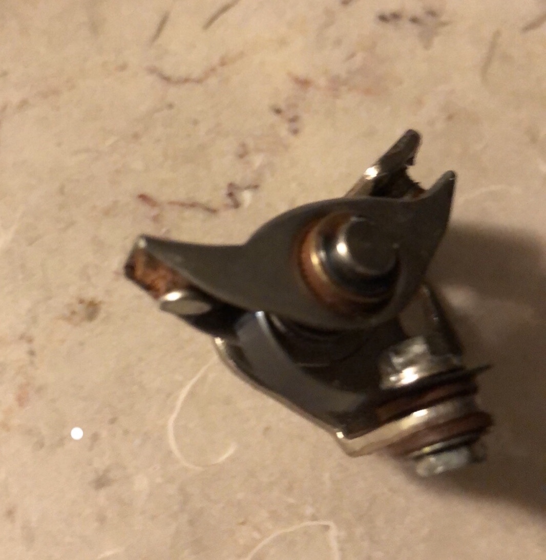

Well, I think I found my spark problem! And these were brand new! Now to order more.... :ugeek: Victor

Lovely! Just Super Glue the Rubbing Block back on and FIRE IT UP! Joe.

Joe I dont even know where the rubbing block went. I don’t even think epoxy will work for this one! :ugeek: Victor

Before you put the Flywheel on, rotate the Crank so that the key is facing down. That way the lobe on the Flywheel is at the lowest point. The only way that rubbing block broke off is that the Points were defective or the lobe was on the high side and broke it when you put the Flywheel on. The edge of the lobe should be rounded off to let the flywheel slide on without catching the rubbing block. Check your flywheel . It may not be rounded off. Joe.

I dont know exactly when the rubbing block broke, but it was AFTER the gapping of the points. :ugeek: Victor
