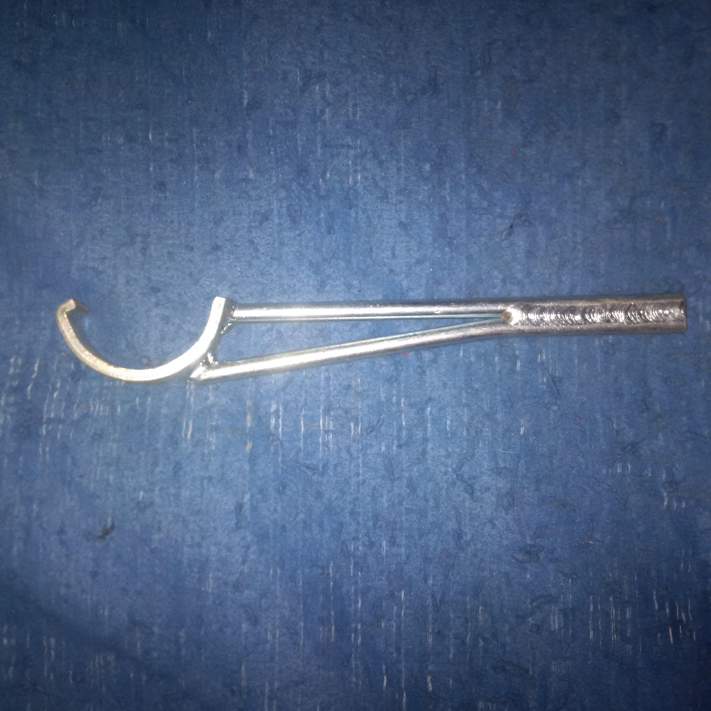

I think that this may fall into the"You may be a Red neck" category, but it works...

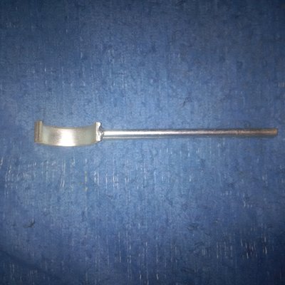

Case Splitters
I made a Marv Foster? inspired tool for splitting the cases. It worked very well on the north end of the cases. Not so much on the south end. (A lot of prying and pounding was involved).
Dale Dvorac posted his tool for splitting the south end of the cases. Genius!
Between the two tools, It's just a matter of walking the cases apart.
Marv's? tool - 2 pieces each 1/2 inch of 1/2 x 1/2 angle. 1 1/4 inch of 1/4 black iron pipe - 1 1/4 inch allthread. 1 nut.
Dale's tool - 3 inches of allthread 2 nuts.
Larry S

Re: Show us your tools
I made Marv's splitter for a 95.If you are working on a 90-92-93 it's 1/4" to long.I found that out today when I split the cases on a Ace 100.
