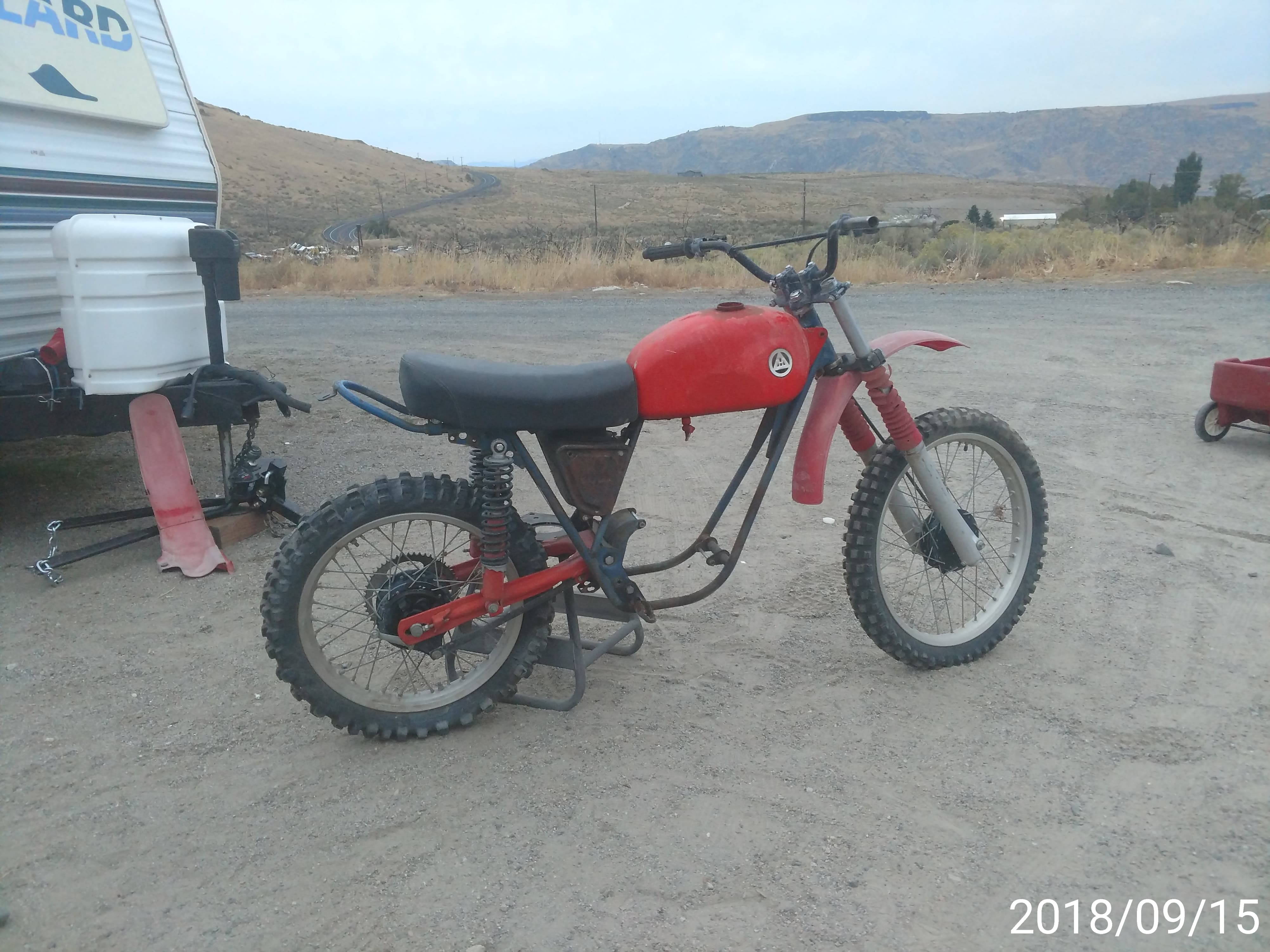

Re: Case Reed 125 Hodaka Project
This what the forks look like on the bike.

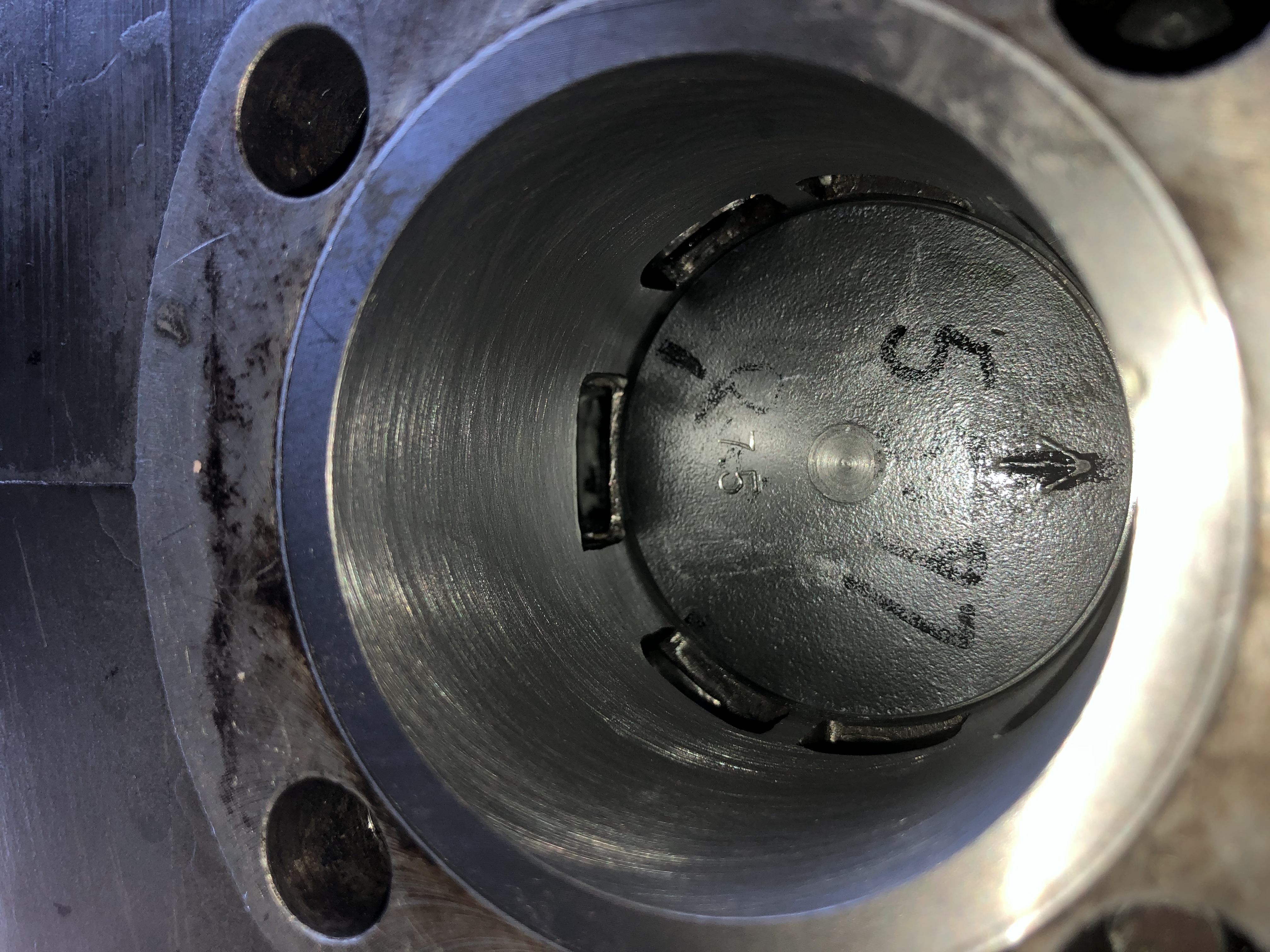

Yamaha YZ piston, just a 0.5mm low and flatter on top of the dome than a Hodaka ART piston

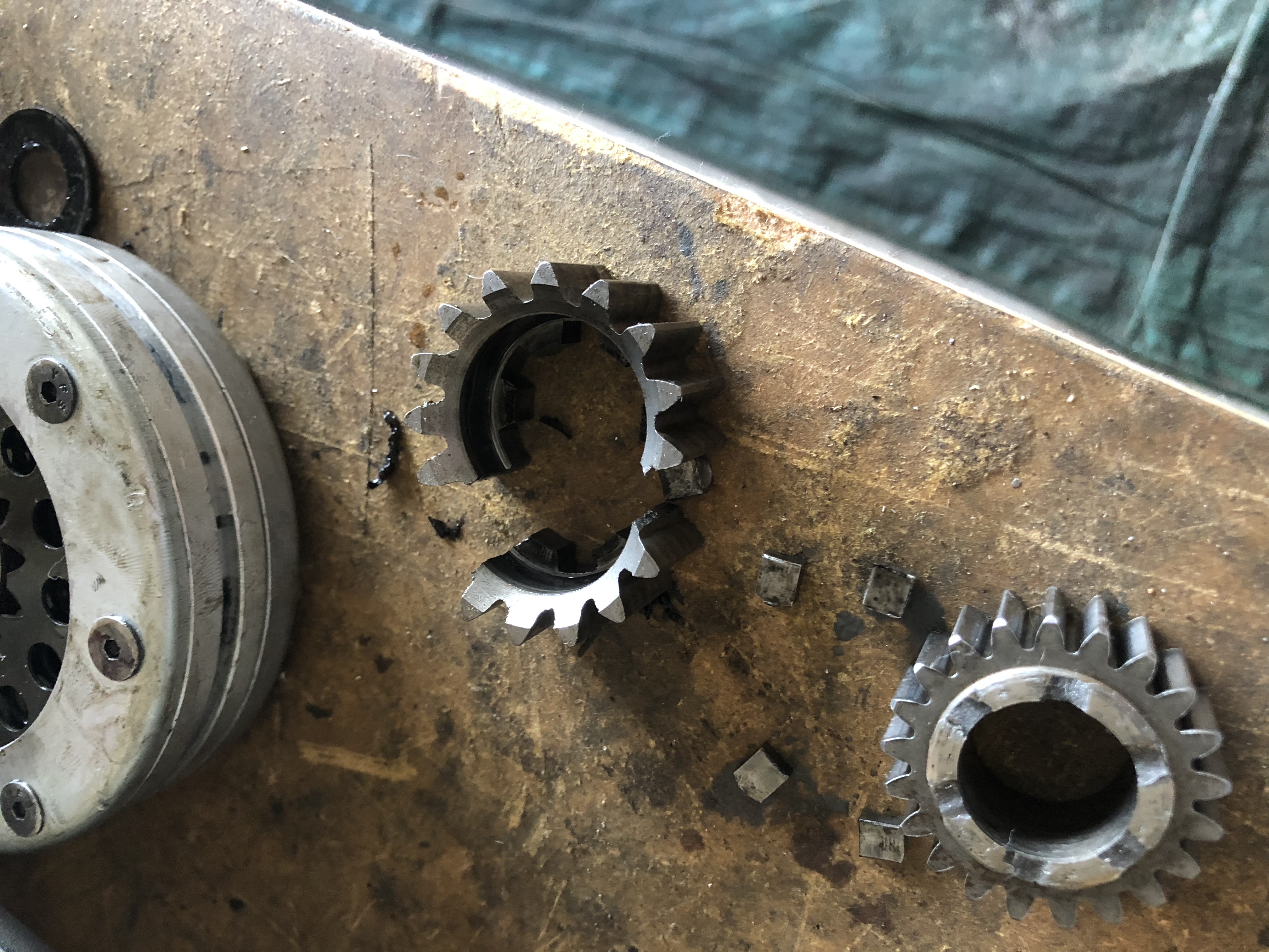

Things are about to crack on now I have my cylinder bored. One other side project is based on a Jay Lael mod , all credit to him for this.
When you ride a hotted up Hodaka hard the clutch gear can break. I’ve only had it happen once in 7 years of light racing so it’s not like a common failure, not for me anyway .

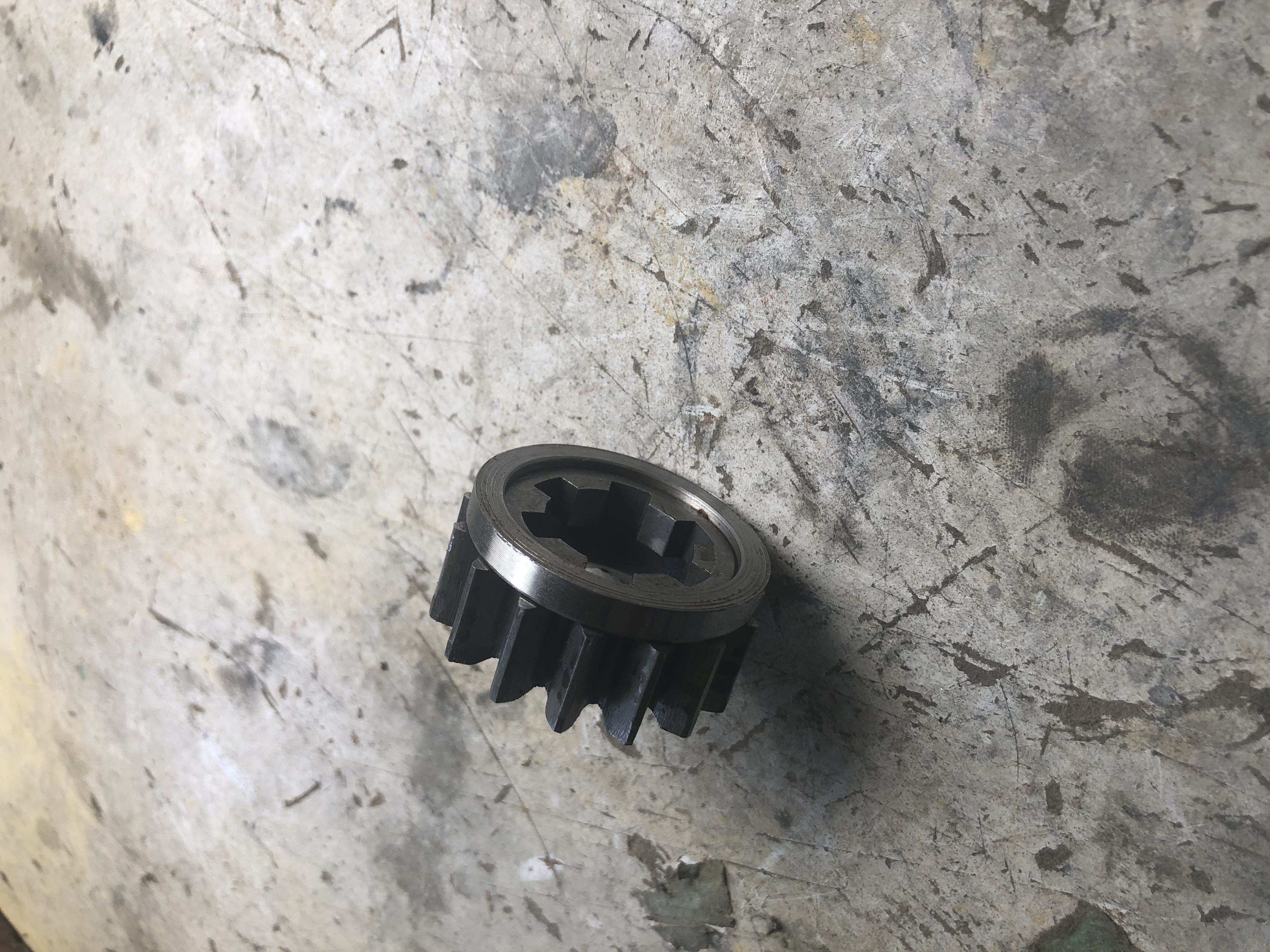

Jay had the smarts to put a circlip around the gear located in a groove he cut.
Taking that thought I had an aluminium ring made and had it press fitted over a ground down section of the gear. Same same but different.

There is still full gear engagement all around , it should help I think.

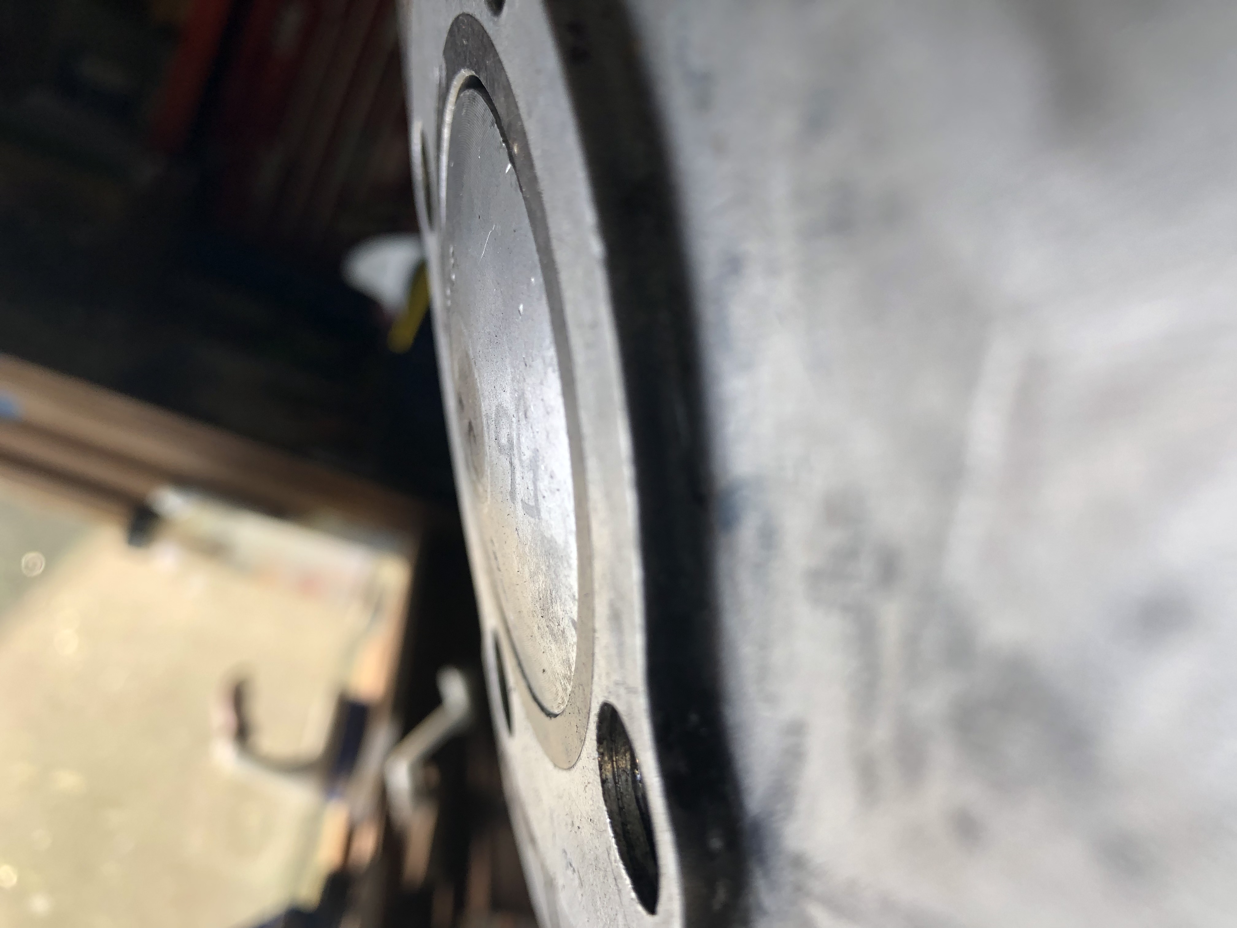

View of the exhaust port. It looks a bit weird but the space where the sleeve and cylinder meet is not that bad , the photo is deceptive.
Note the the bridge has been relieved and a very small hole has been drilled in the piston to allow cooling gas and oil into the bridge.

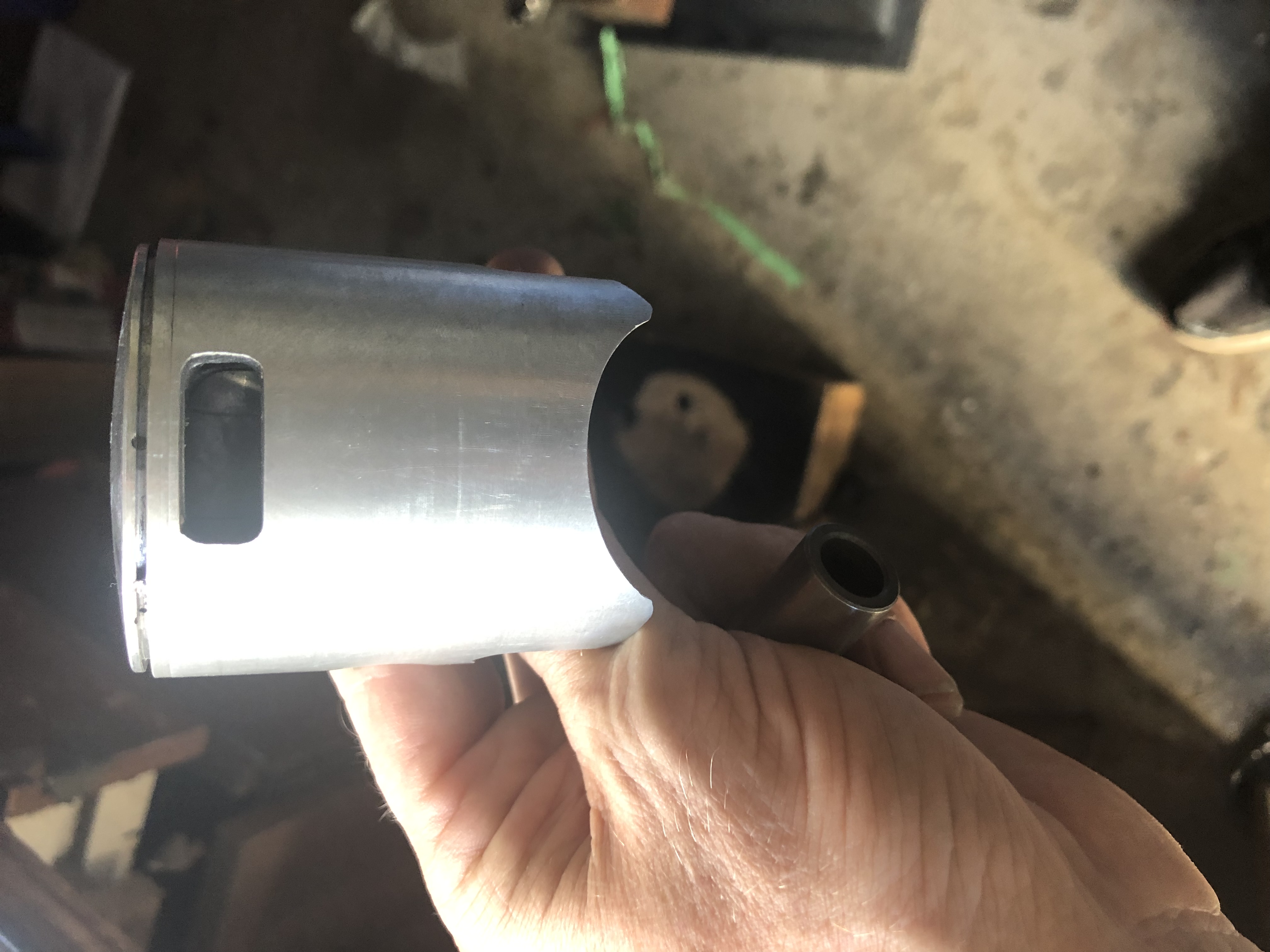

More work in the piston.
Arch cut and the ring locator pin had to be moved due to the port windows being moved.you can see the new location marked on top of the piston.
