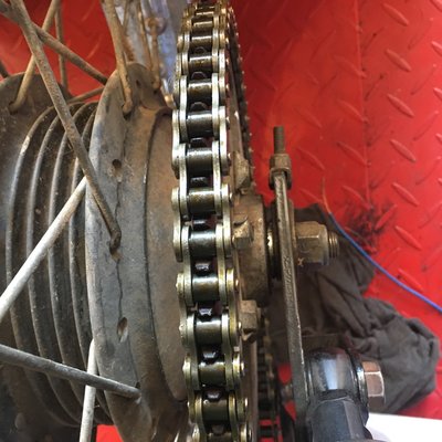

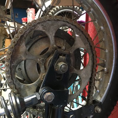

OK. So I need to know. Does this mean my rear sprocket is a .420 sprocket, based on how this chain fits it in the rear (see photo below)? Does this mean I should stay with the .420 chain and get a .420 countershaft sprocket? I want to do this the most cost effective way possible!
I just ordered a .428 chain from Terry. Is the .428 chain going to work with this rear sprocket? :ugeek: Victor
Re: Chain - .420 vs .428?
OK. I was able to get a hold of Terry BEFORE he shipped my order! He is going to substitute a .420 countershaft sprocket instead of sending me a .428 chain! This will be the most cost effective way to remedy the mismatch! Thanks everyone for the input!
And Matt, I saved your chain chart too! :ugeek: Victor
