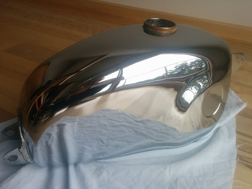

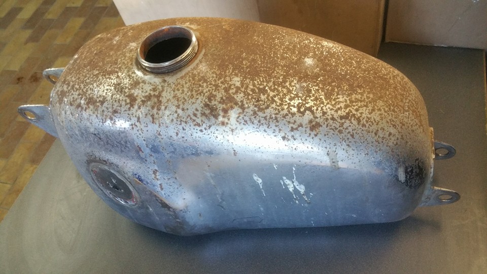

However, I did get the tank back the other day
It'd had a small transformation done.

Hi Zeek
Nice job on the tank ! Was there any dent removal needed? Who did the chrome? If you dont mind me asking what did it cost?
Sorry so many questions - I have a super rat tank I want to restore (eventually)
Jack
Jack
Re: Project Dirt Squirt
Tank done here in Tasmania (land of Oz)
Yes, dechromed, then 3 dents pulled out and rechromed. Probably could buy another bike for what it's cost.

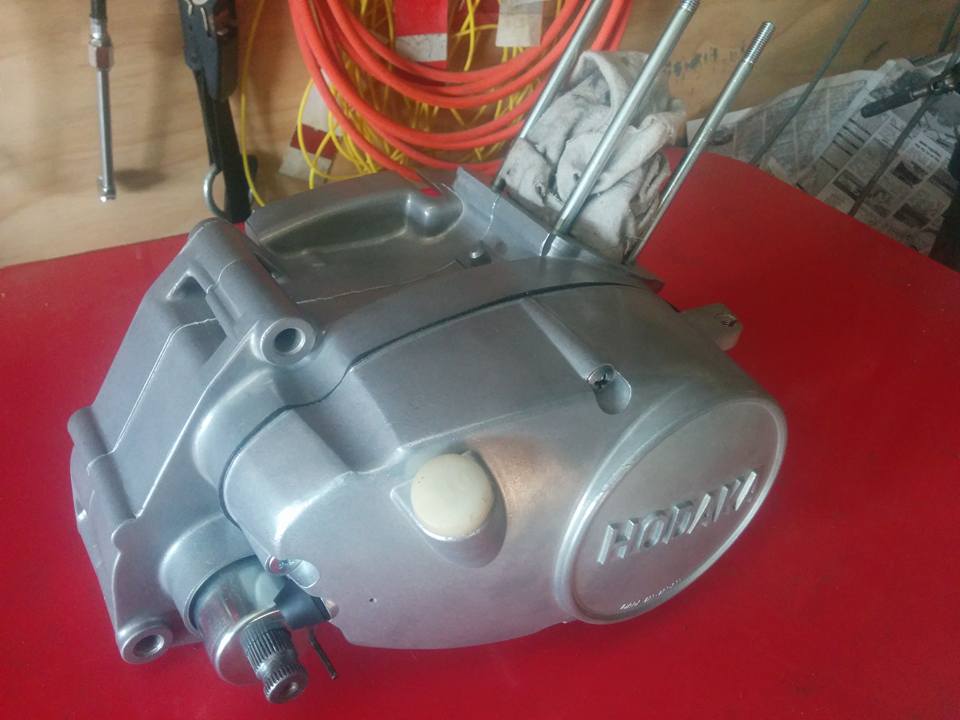

On track again
Cases back together and awaiting arrival of the rebored cylinder.

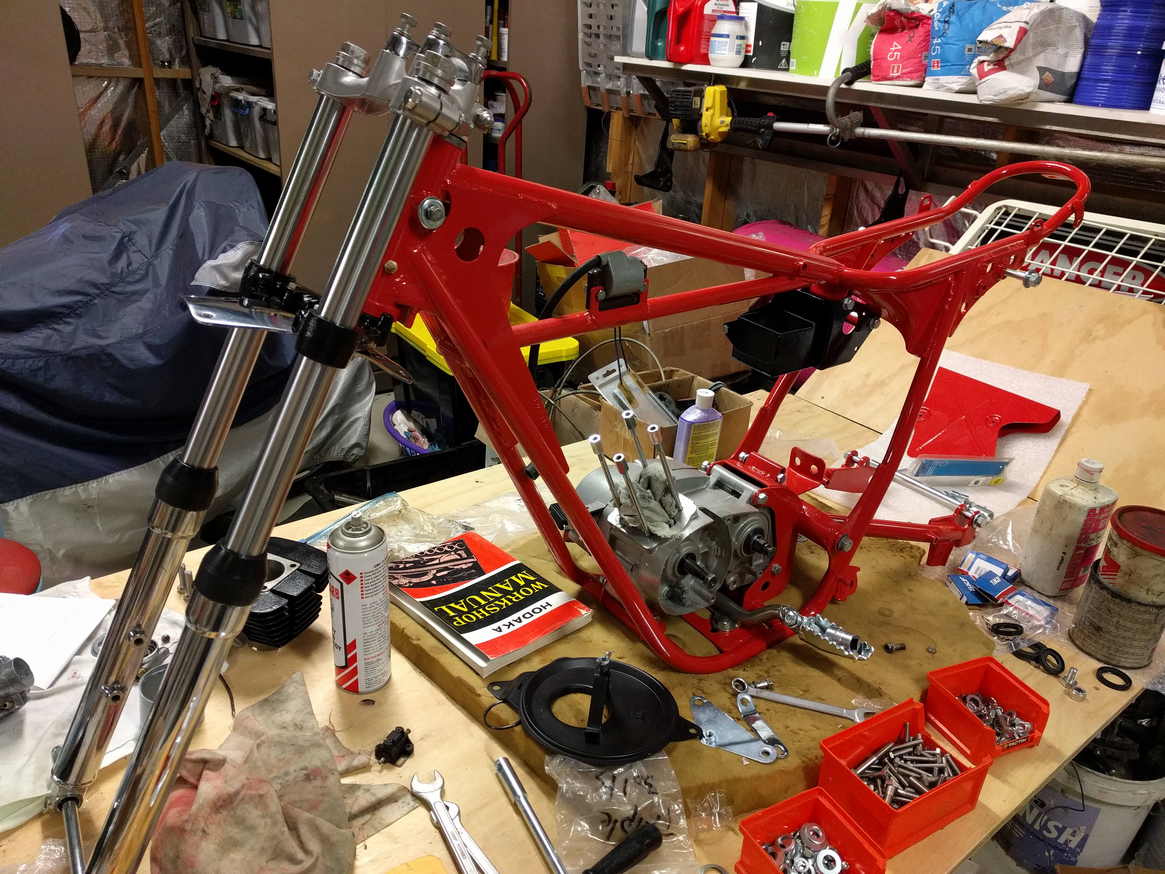

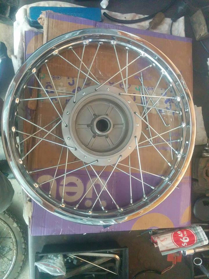

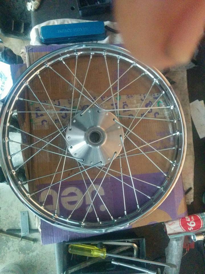

Been a bit slow on the progress front again...
So wheels now built..
All replated original parts And most of the painted parts finished now. Probably a few small bits like the taillight bracket etc to go.
I've added an extra bracket to the frame for the battery box and one for a rear brake switch.
For any Aussies here, I took the good airbox cover in to have the paint matched to the clean inside colour. It''s Holden Red Perfect match! Really didn't like repainting the airbox cover I have two, one isn't too bad, but would look out of place when everything else is done? and this one which was not particularly good so repaint it is. I'm tempted to have a go at hand painting the Clam rather than a sticker, but don't think I'm that good

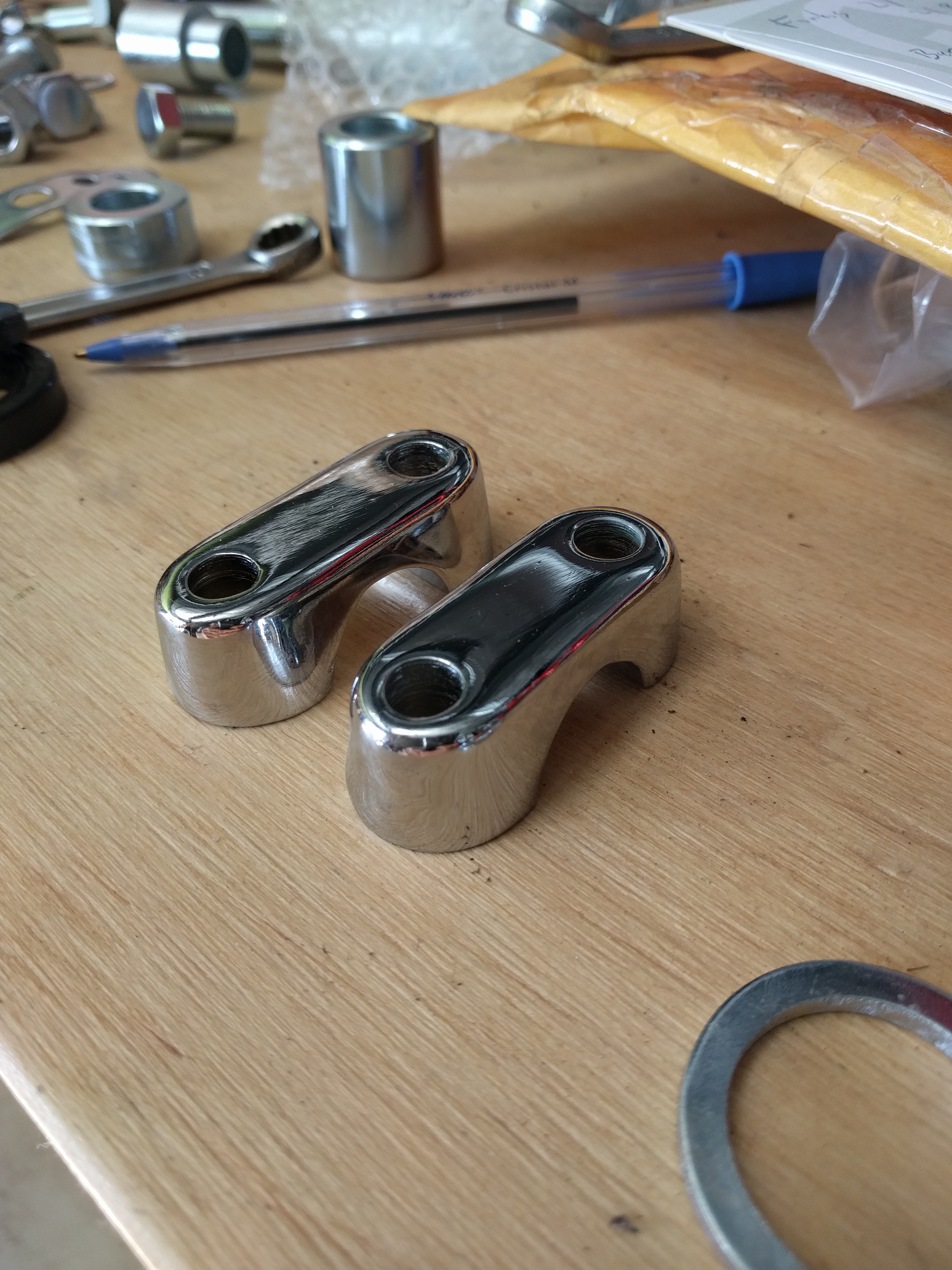

Chrome guy while having done a great job, has overdone the bar holders
Would have preferred they still had the cast look........Like he was meant to do! Top spacer is loose fit?
I guess it's made to clear the threads if need be?

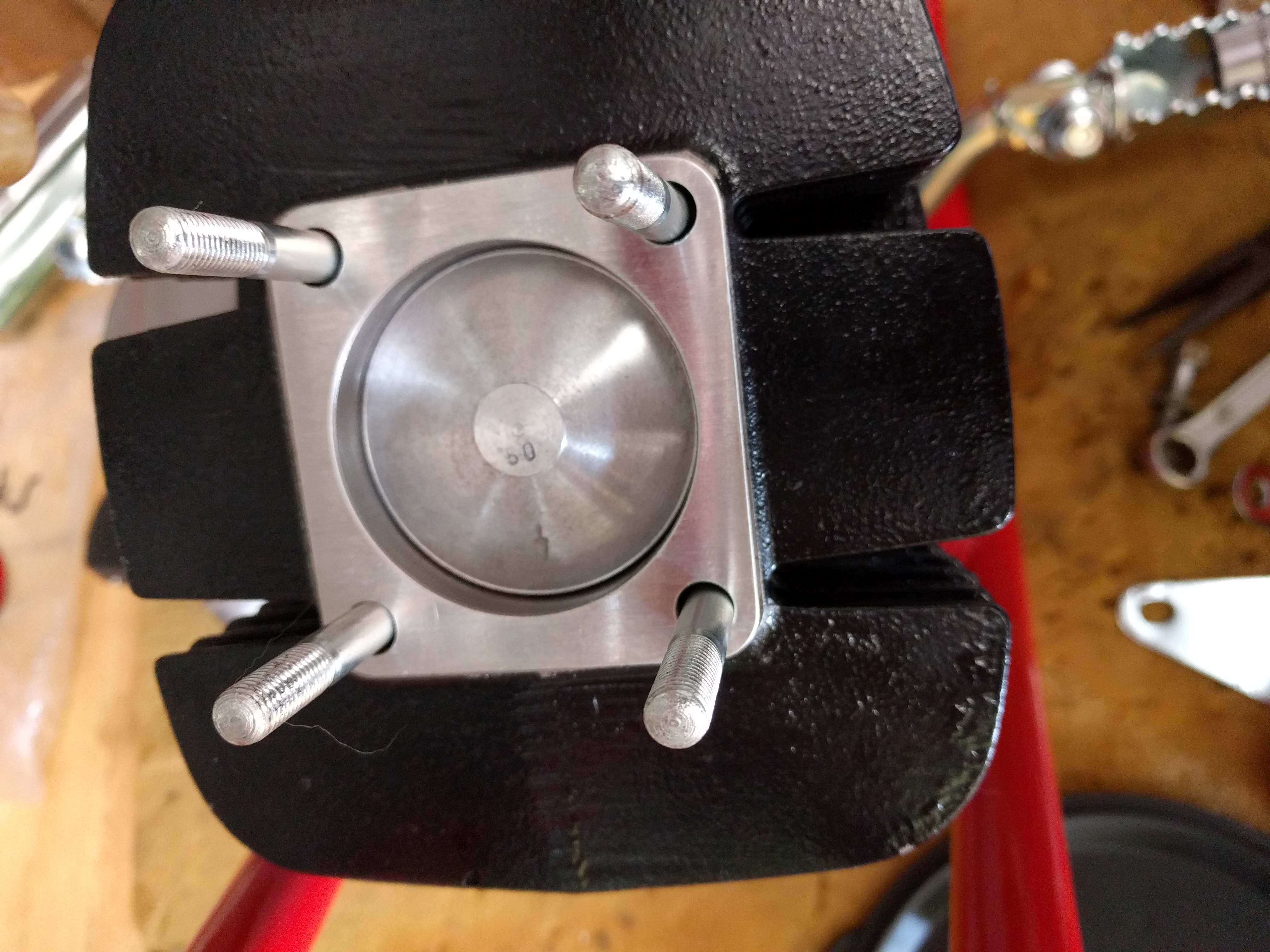

Few small steps for mankind today.
Filled up one of the spare holes: Thought it was all going well until fitting the head. Of course one nut got a bit stiff half way down, so I put a spanner on it and sure enough it got tighter....tried to back it off and whole stud came out instead
So it seems there is some defect to the stud thread, maybe from the replating? So now I'll have ta find (buy ) a 7mm die to clean up the thread.
But it looks the part for now.
I need to get gaskets for the carb and inlet anyway, and I have no 7mm washers for the head. Always pays to keep a box of rubbers on hand....so to speak
Tank rubbers were shot, so had a rummage about and found these little beauties. As luck would have it, I had 4 of 'em. Made up a few collars, and hey presto! Should do the job.

As I remember the longer threaded end of the head bolts go into the block or base. You probably have it correct but it cost me before. Your quality is unmatched and equal to the very best. -----------Clarence
Speedometer bracket does go on top of the handlebar clamps. If you put them under the clamps they would not tighten up the handlebars. The head bolt is an 8 mm x 1.25 thread not a 7 millimeter. Looking good!
Just looked on schematic and I belive 7 mm is correct. I was thinking of the 125 engines. My bad.

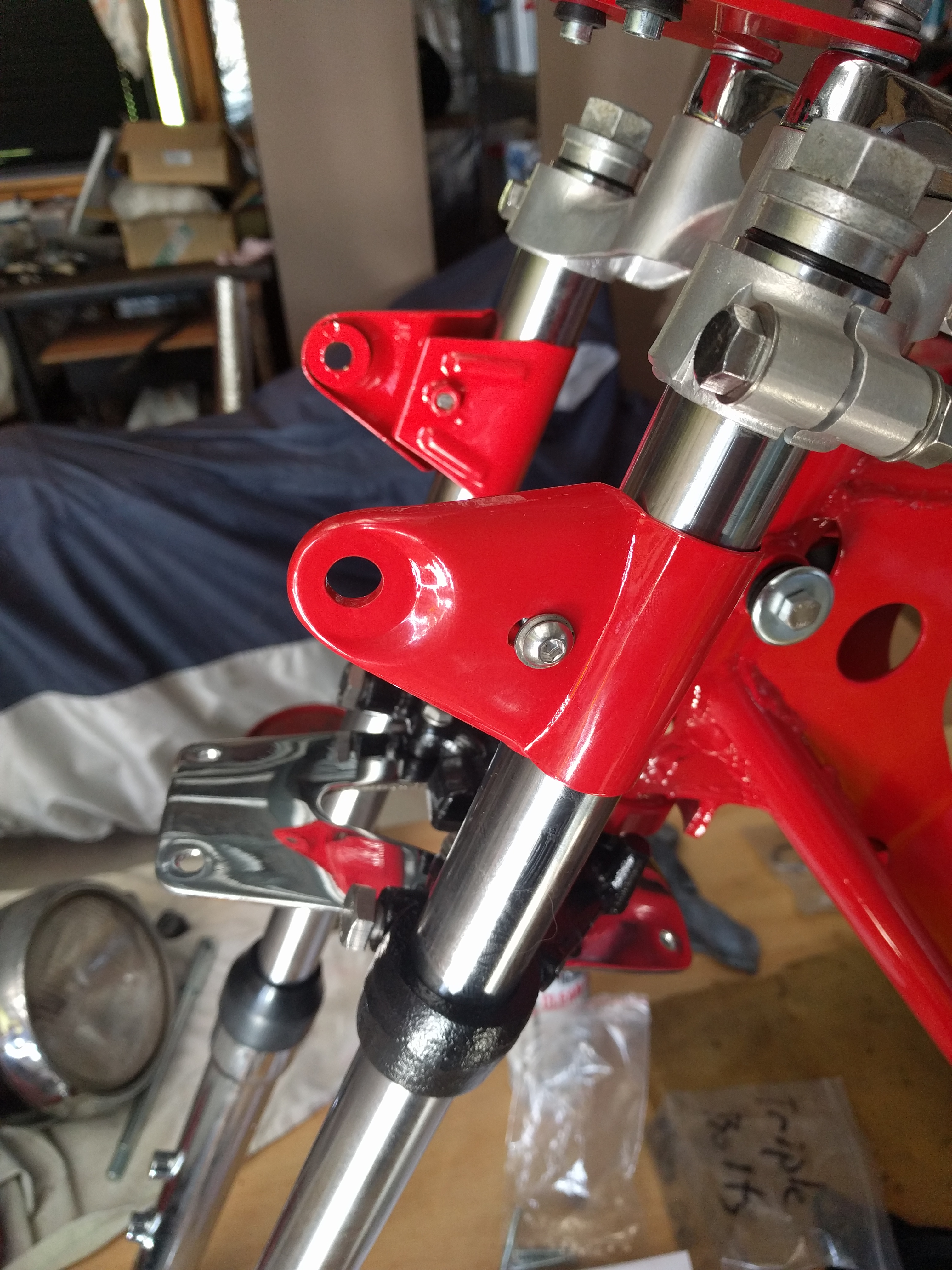

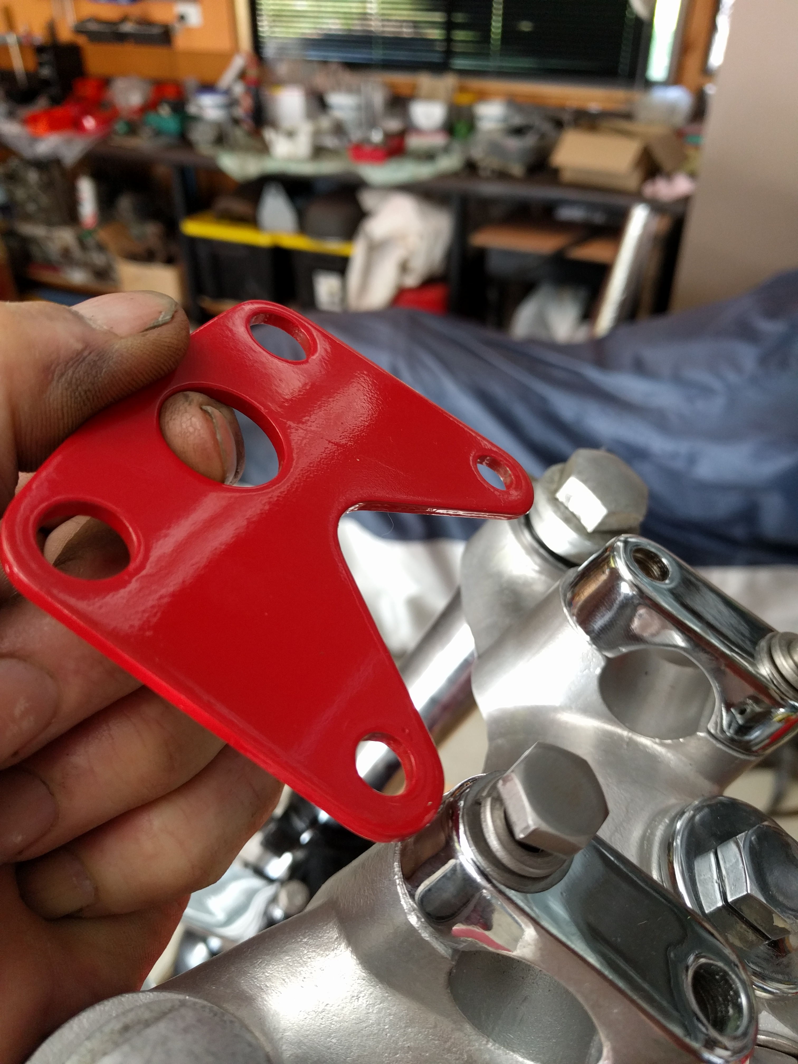

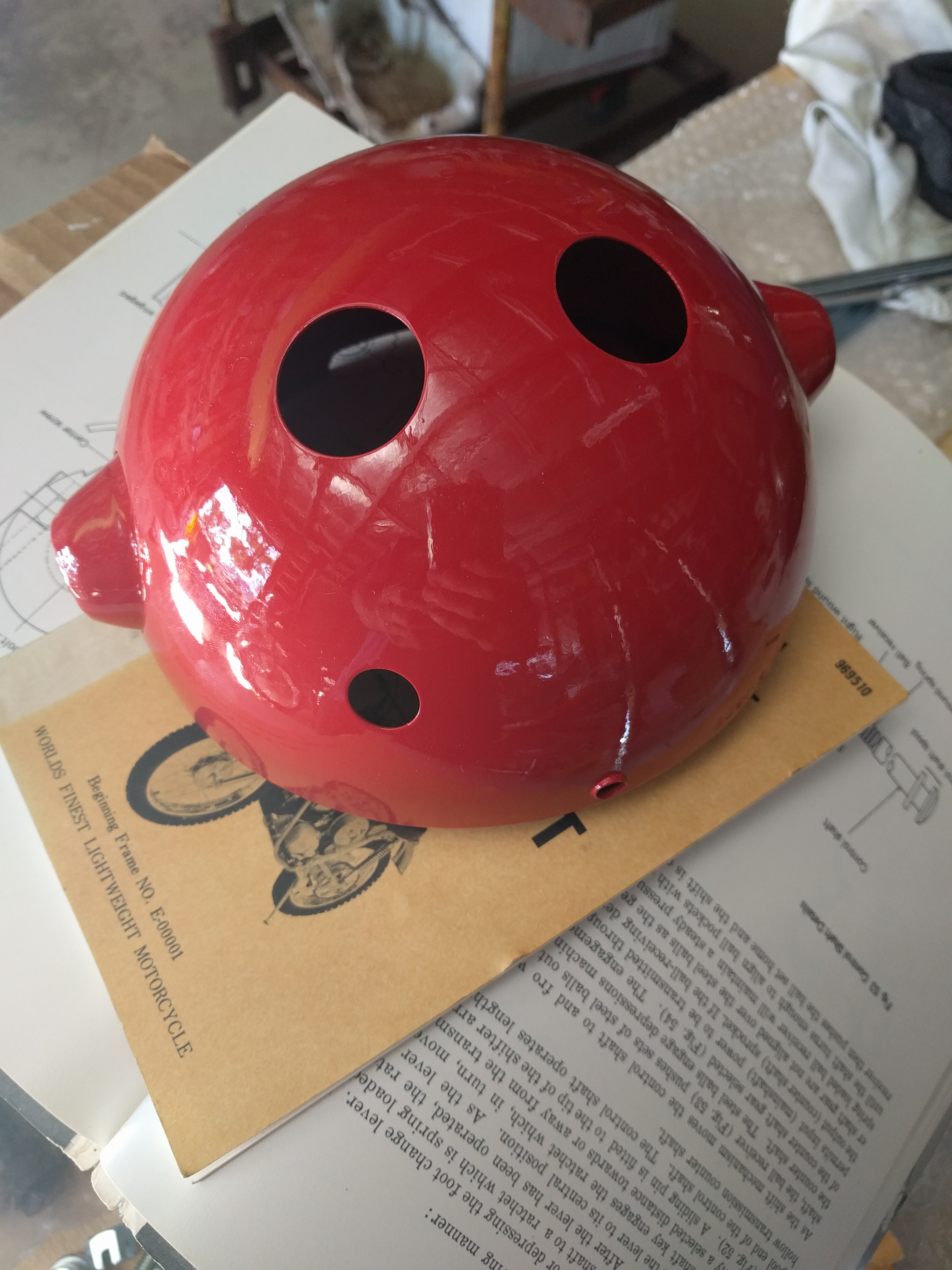

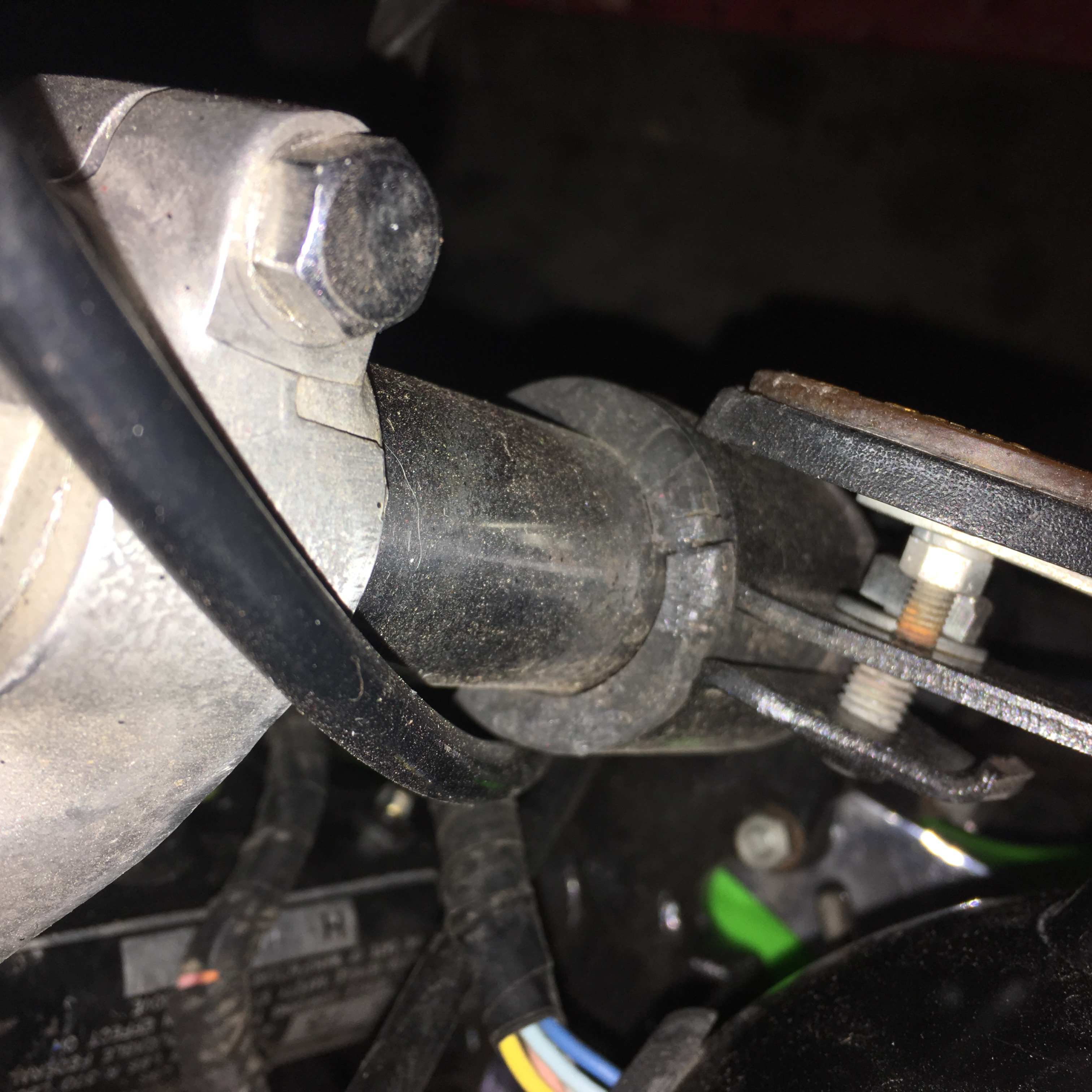

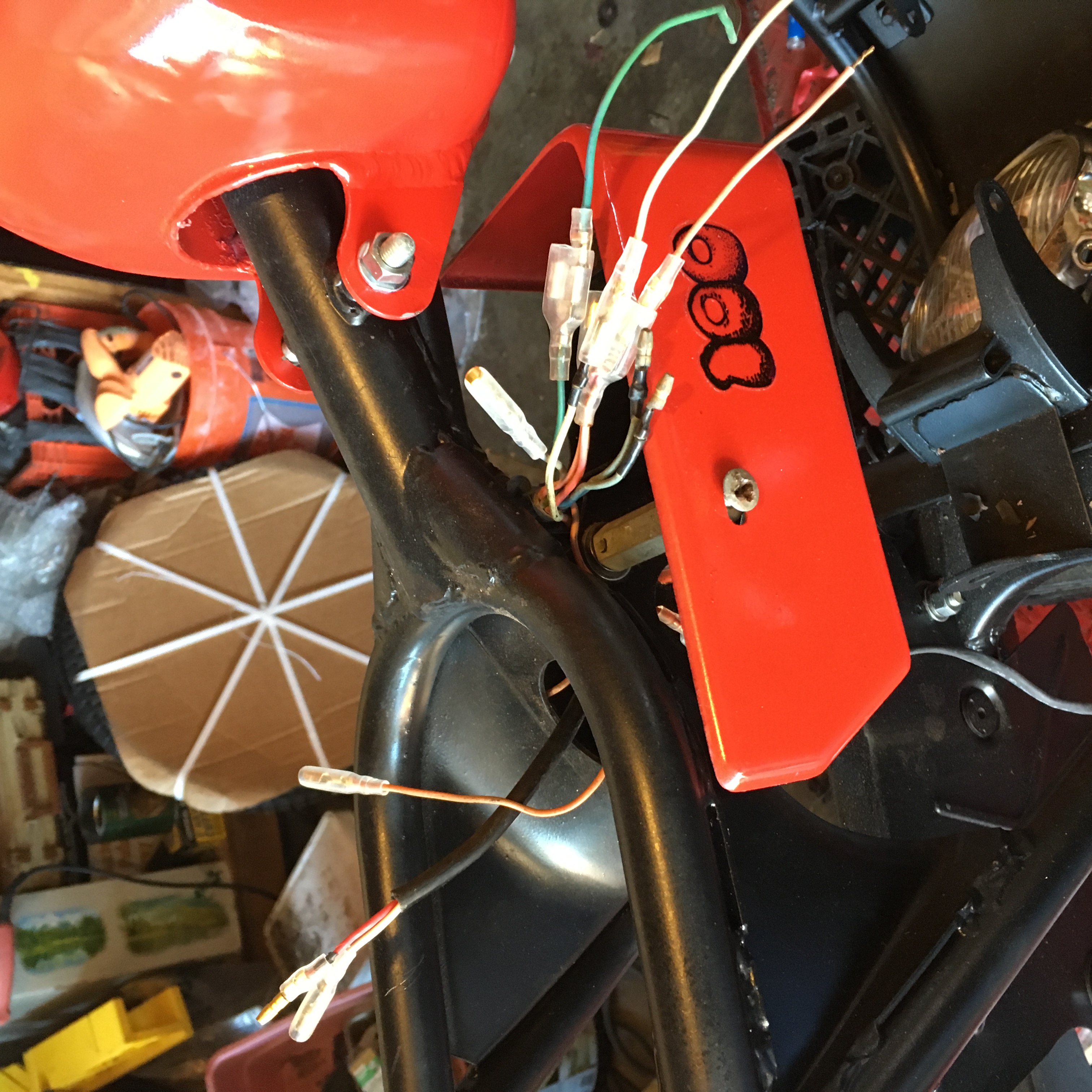

Loose fitting a few things to see what I'm missing.
Parts list says there is a headlight bushing?
They must be very thin, fitting the bowl between these brackets, there isn't mush scope for rubbers without them angling the brackets outwards?
Anyone know?
Anyone know?
"Experience is something you never get until just after you need it"
Little Squirt owner
Little Squirt owner
The bushings aren't very thick but make the ears fit very snugly to the Fork tubes. I may have a used set I can send you if you want them from my Toads. Let me know. ; D Victor
Do you have a picture of them Victor?viclioce wrote:The bushings aren't very thick but make the ears fit very snugly to the Fork tubes. I may have a used set I can send you if you want them from my Toads. Let me know. ; D Victor
I thought they went between the ear and the light bowl?
Little Squirt owner
Little Squirt owner
No. They go between the ear halves around the fork tubes. ; D Victor
Zeek
I believe the bushing you're referring to is a wire grommet for the holes in the back of the headlight bucket. Nothing goes between the headlight bucket and mounting ear.
Mike
Mike
I see!
Thanks guys.
Yes, I've got it all wrong then
In this case if you have a spare pair Victor, I'd like to buy them then.
I notice you have a reflector as the fastener as well..... I didn't realise that either..... That would be better idea!
Does the reflector have a long thread, or is it a two piece affair?
Thanks guys.

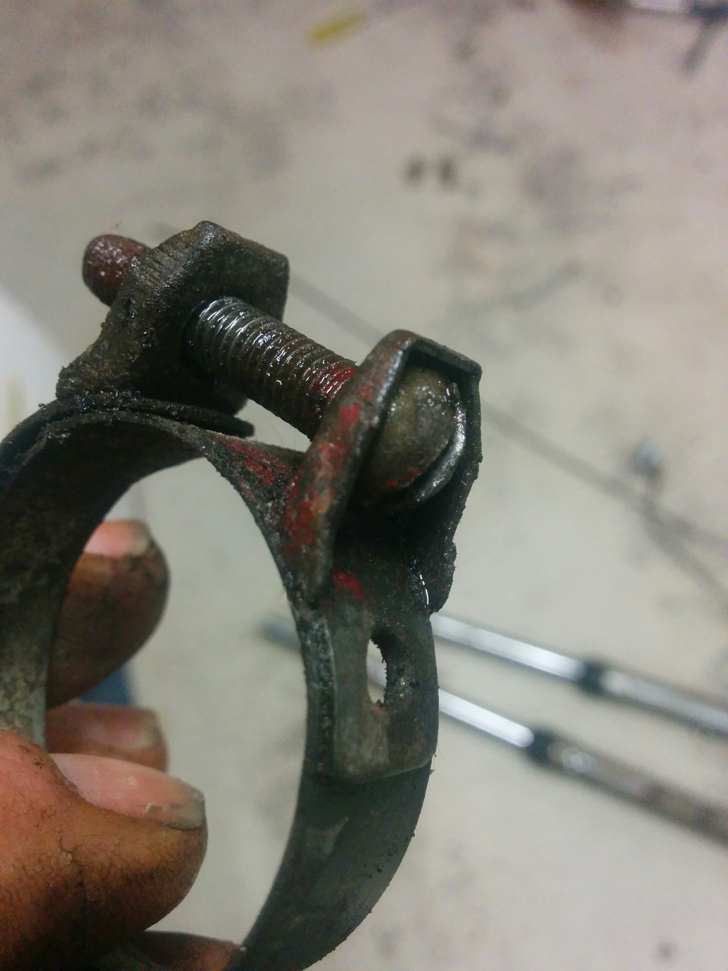

Out of interest, this is the old carb inlet clamp.
Now this frame etc. had been repainted Blue in it's past life but there are traces of Red on the clamp?
Was this clamp painted Red from factory? I'm also now the proud new owner of a reproduction ignition switch
Late at night and I fell for the phony NOS listing heading, and didn't read "Aftermarket" till too late.
