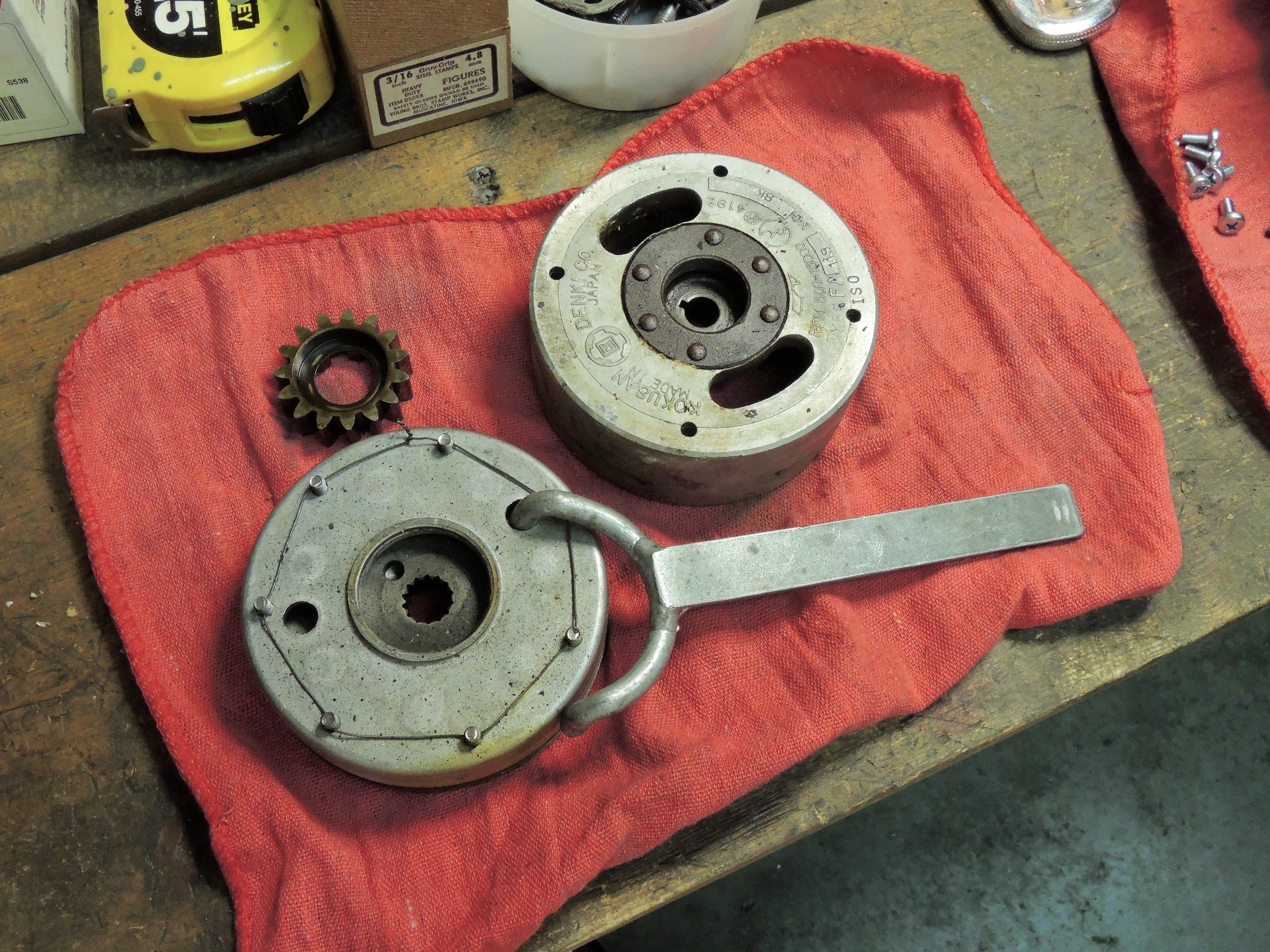

I was removing the clutch nut from the crank shaft and proceeded to ruin the threads in the nut...should have read that again about it being left hand thread! Luckily I didn't ruin the shaft threads. (New nut to be ordered tomorrow) After managing to get it worked off the shaft, I go to remove the primary gear. Following the instructions on the "how to" page it shows the gear being held with the same tool. I now see the holes in the gear are spaced closer than the clutch. The tool I'm using is the one Paul sells, so I guess could make a new one similar to it. Short of that, what do you guys use to hold the primary gear?

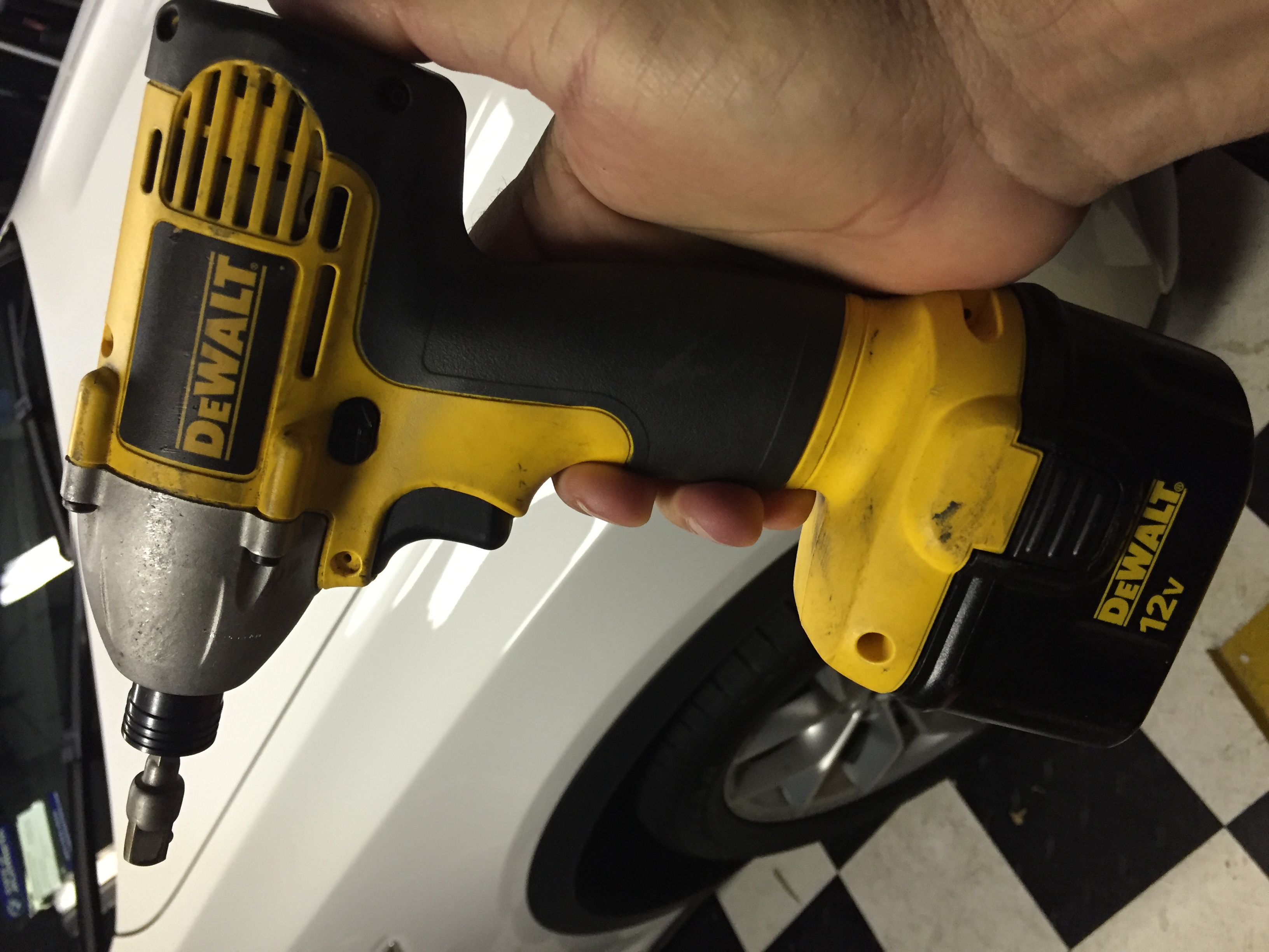

I use this and don't use a holder on the gear.

I didn't think to try an impact driver. Do you use it to tighten the nut too? I figured I'd need to use a torque wrench on it, but I haven't found a torque value. So snug tight would work here? Thanks for the idea.

Re: Super Combat Shift Kit Installation
Dave, you will need to torque all of the nuts. Assemble everything lightly snug by hand then you can use the holding tool wherever, it's all meshing. I don't have the torque specs for the Super but someone does. Have fun!
PS--the impact driver works like magic for disassembly but I'd reassemble it by hand.

. . . and you can use the holding tool on the primary gear in the same way as shown in the photo.
Use torque wrench for tightening (not impact driver).

Yes impact for desimble

When Max said "all meshing" it dawned on me to use the tool on the clutch and it would hold the primary. Worked fine and I took the clutch nut off my spare Wombat motor to use for the one I ruined. So far all's well. I just can't seem to grasp the idea of left hand threads!
Oh and the impact wrench does work great for removal.
