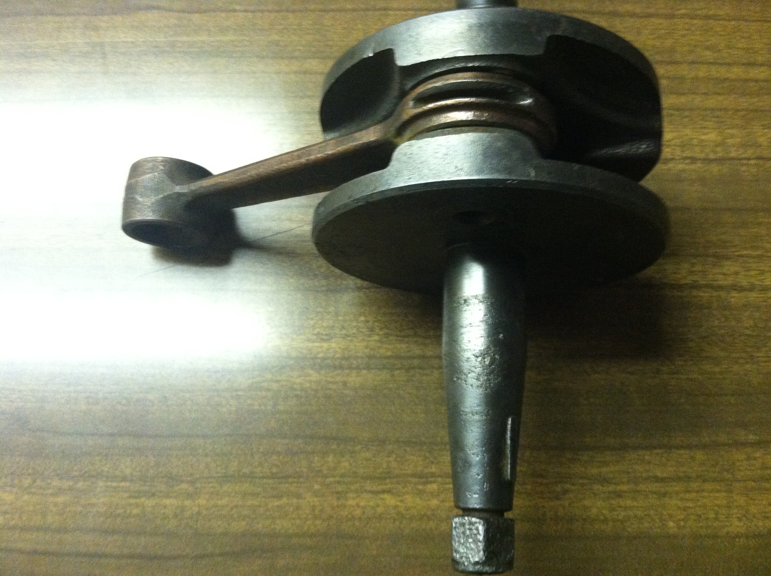

I need a CW crank rebuilt but when I took it to have the work done locally the machinist said the bearing surfaces were too beat down to re use the crank. It also has divots on the seal surface on the ign. side from rust. Can it be repaired or should I toss it? Seems to me all the Hodaka,s I've ever worked on had a loose crank/ main bearing fit but if the seal surface can,t be repaired that would settle the issue

willoughby
Posts: 39
Joined: Tue Nov 26, 2013 3:22 pm
Re: Who does crank rebuilds?
Post by willoughby »
I'll call Roger L. tomorrow and see what he has to say.
I'll also take a picture but I may have trouble trying to figure out how to load it because it will be on a computer I'm not familiar with. I don't think the crank was spinning inside the bore of the bearing but the machinist said a lot of the Japanese cranks he works on has a reduced bearing O.D. on the shaft from the hammering of the combustion cycle after a many hours of use so when he measured it with a micrometer he said it would be too loose inside the bearing
Here are some photos

Post by olddogs »
Yikes. That looks like it was left in the elements without the crank seal in place. The seal will usually limit the rust and pitting on an old engine to the area outside of the seal. In those cases a narrower seal can be used to get to clean undamaged area behind the original seal. I would still send it out. Some parts may be able to be salvaged if a core crank can be found.

Post by dcooke007 »
I rebuild Hodaka cranks and would not use the left side of that crank. The right side may be usable if it is not pitted or damaged. It would be more cost effective to find another crank half or crank for rebuilding.
If you need my assistance rebuilding a crank let me know.

Roger L. says its junk too so I'll try to find another crank or a good usable left half
