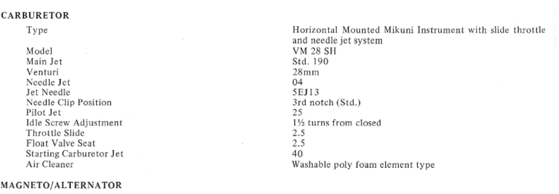

I suspect you may have too small a pilot jet, or possibly main jet, in your 28mm carb. Here is the stock jetting info for a Combat Wombat with a 38mm carb. Double check everything! Hope this helps! Victor

Well, I went back to my notes on my current carburetor settings. I have 2 Combat Wombats with OEM carbs and they both run the 2.5 slide. However, my track Combat Wombat, with the replacement carb setup, runs a richer 1.5 slide! In my notes, I was chasing an off idle lean condition as well. Hummm, I think this is your issue!!!

My notes showed that I had also tested 2.0 and 1.0 slides. The 1.5 was the ticket.

I could only find a 2.0 so far so I ordered that. It should at least make some difference.
