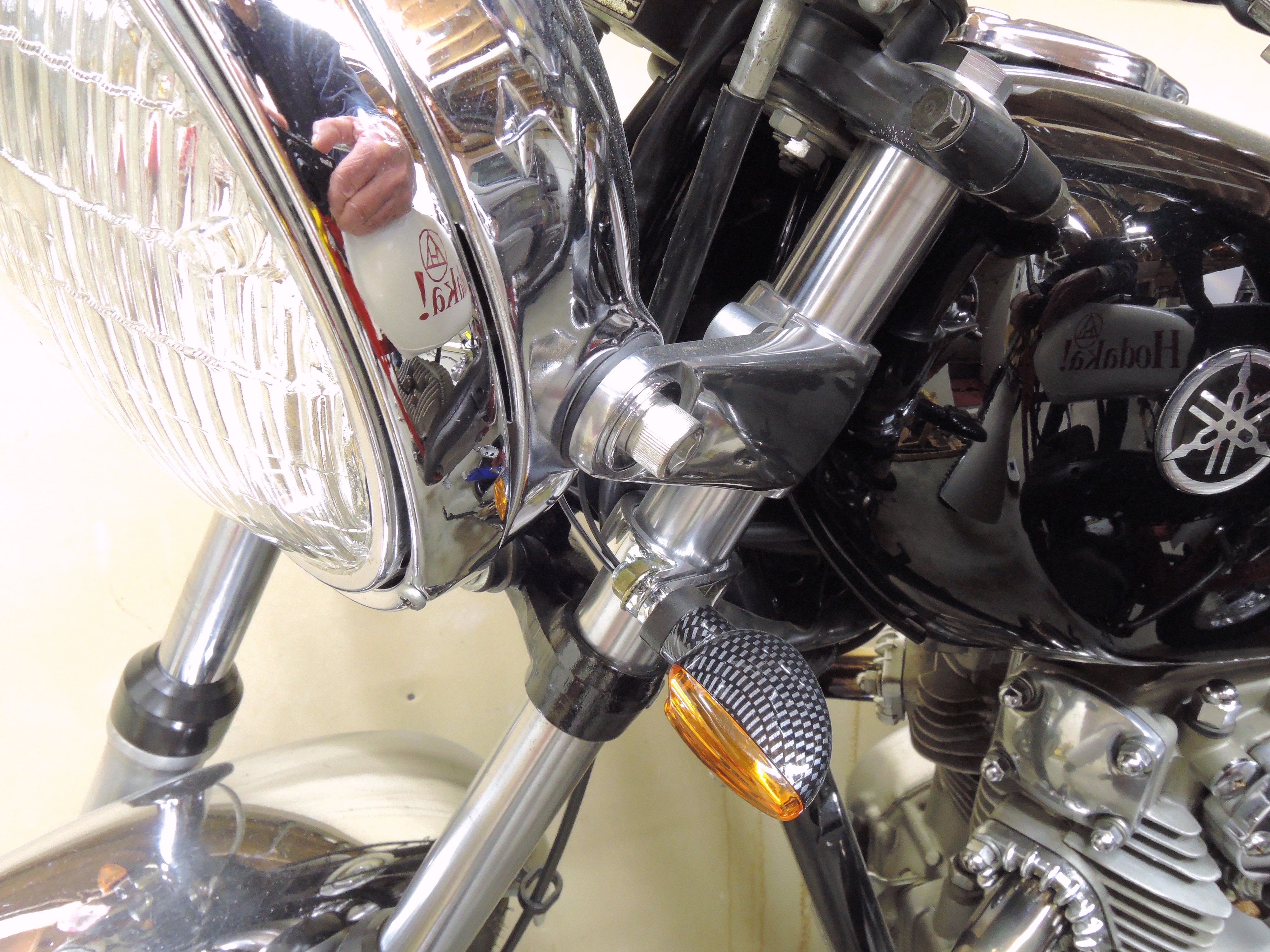

One more ACE story. My favorite one actually. I restored a Yamaha XS-650 a few years ago and it needed multiple bolts and two grommets to re-fit the headlight shell. I drove 60 miles to see what the Yamaha shop had. They could order the two grommets for something like $56. Back to ACE for even better grommets along with all new stainless steel allen head bolts (Lookin' cool!) with all washers and also cool lock nuts all for $10.60. Whatta deal! Not only that, I was greeted by the nice desk ladies by name! Check it out! Also check out the reflections in the photo as it was shot in my favorite bike row. 8-)
I also should mention that I try to buy all my original parts from Paul, but for custom work and getting parts and advice to get the sink drain operational, again ACE is the place.
