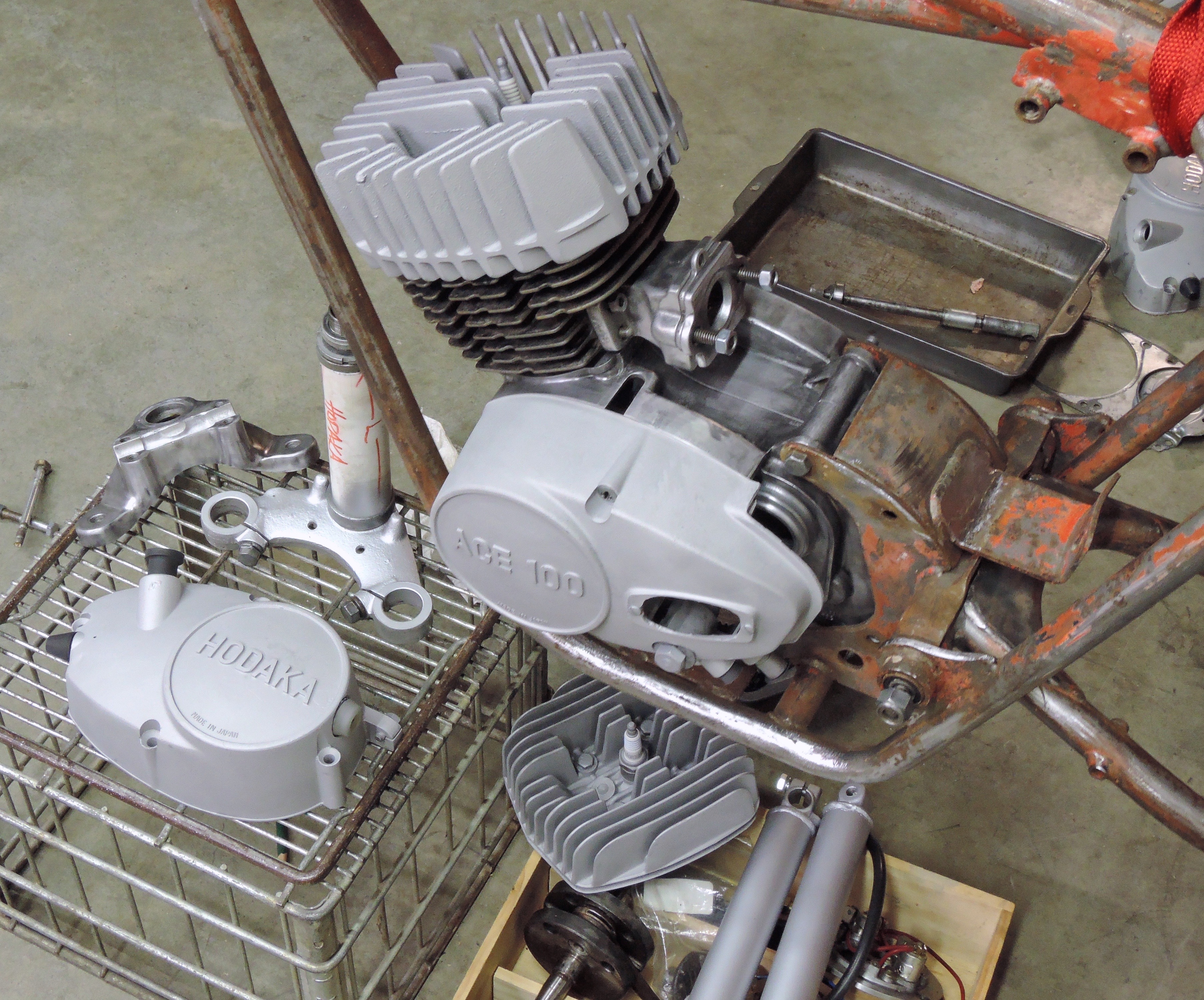

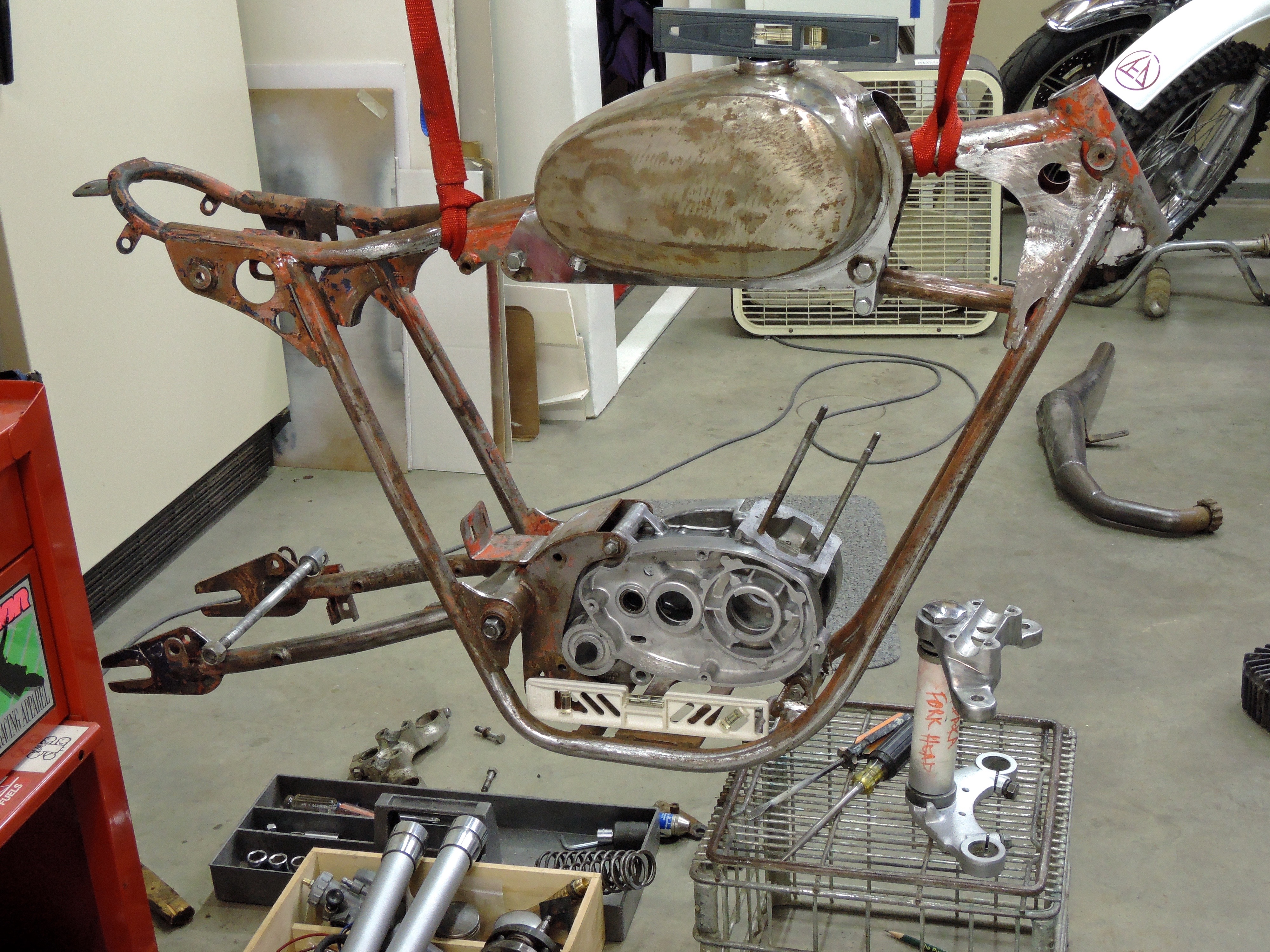

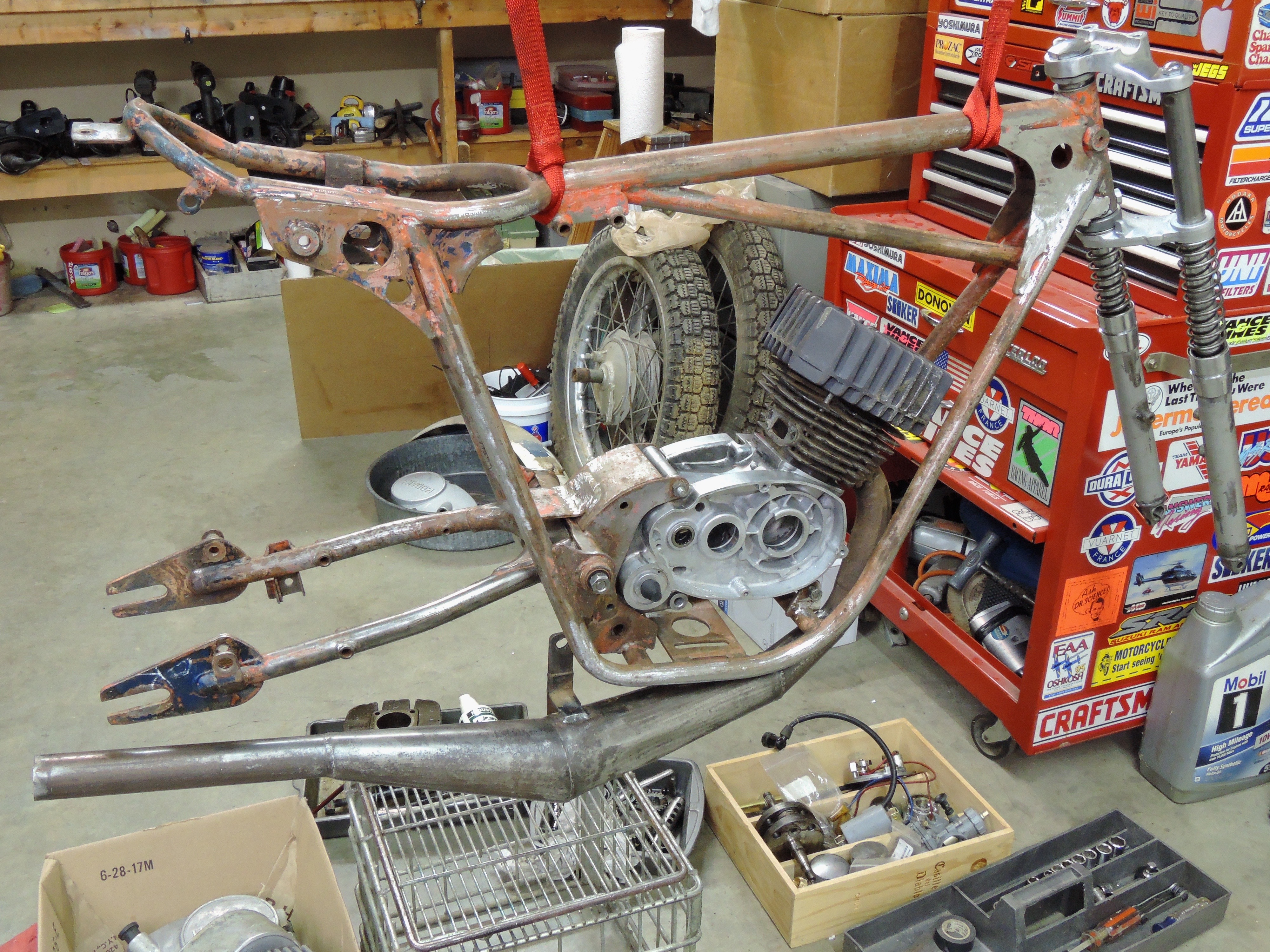

The mission for the day has been accomplished. I did gather enough pieces up to mock-up the forks with a set of grim Ace 100 forks from the last project. The upper tubes above the seals were solid rust but most of it came off. We'll get cosmetic later. The Ace 100 forks are 5 3/4'' center to center on the fork tubes where the Rat ones are 6 1/2''. Everything is smaller, narrower and lighter. Just what I need for this project. The Cerianis still might be used if they become available.

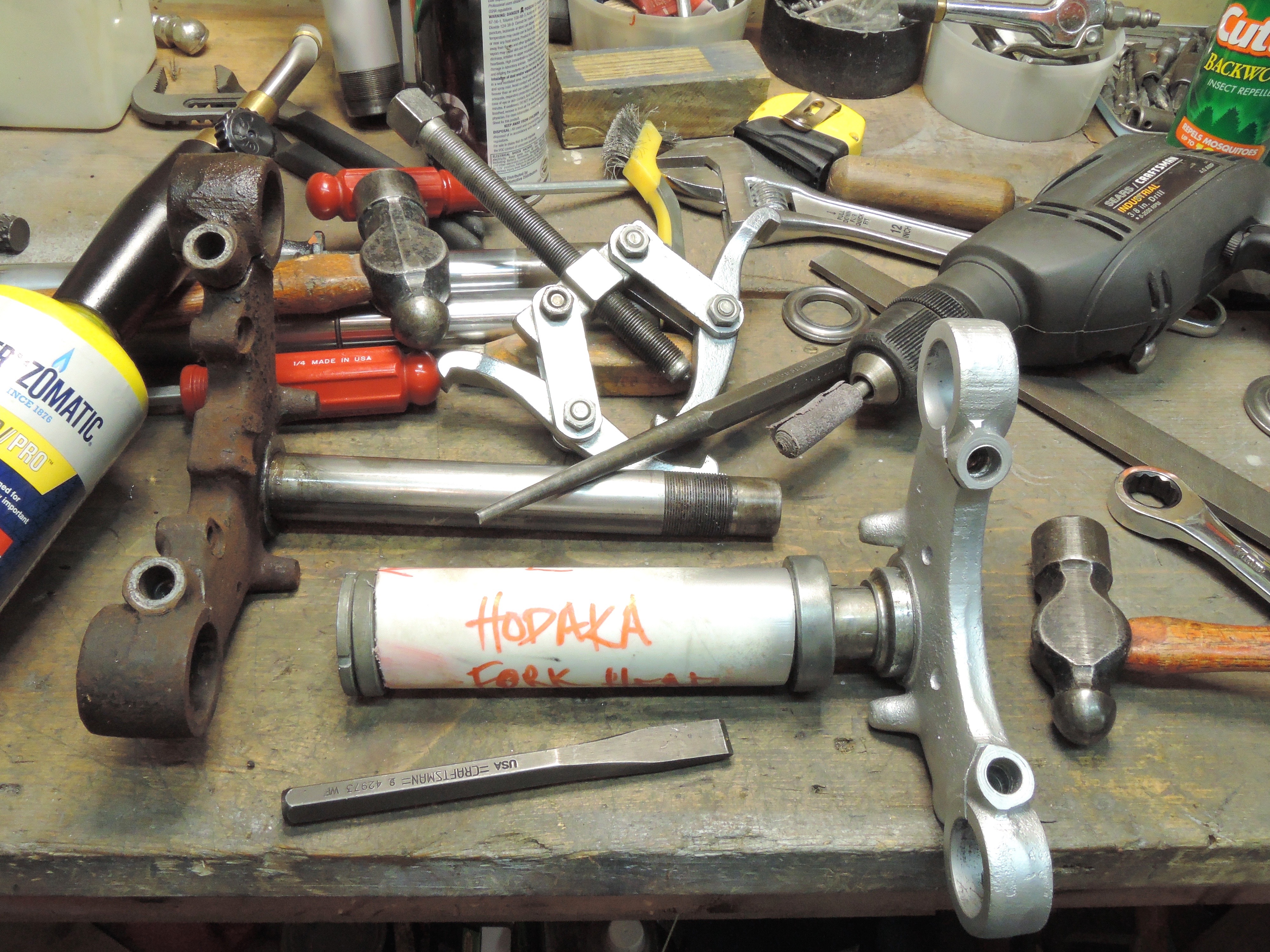

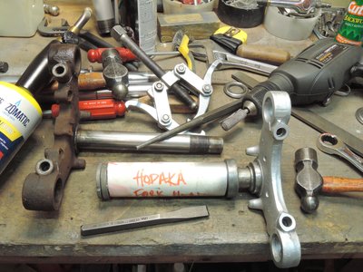

Fun day. A motorcycle friend who now lives in California is staying with us while on business here. We've been wineing and dineing every night and plotting the future of the 2 the Max project each and every day on what to do next. Today we transferred the lower fork bearing race from the old Rat stem to the old Ace 100 forks for the project. All sounds easy. Two people attempting to drive off the Rat race to install on the chosen Ace 100 fork stem, This was serious. Torches, pullers, hammers, drifts and chisels, a worthy opponent. Two man hours with the ultimate challenge. Neither of us are mechanical babes in the woods and will not be defeated. The race did not come off easy or go on the Ace stem easy. Why is this happening? Hmm, a bit of precision measuring with calipers and micrometers reveals that the bearing race is oval rather than round. We're not easily fooled. We finally won with a big laugh and the satisfaction of a job analyzed and done. Again, kinda the Zen experience. This is what motorcycle repair and friends are all about.

Yeah, I'll bet a lot of planning comes after the wining after dinner.
Old bearing races can always be a problem. The Beemer uses a tapered roller bearing that sneers at the biggest hammer, both in the headstock and on the spindle.
Cycle Works is a company om Kansas that makes specialty tools for.BMW and Isetta. They have a website and may have a tool or idea that will wprl on our Hodies. Another similar shop is Northwoods Airheads. Google them, my Smartphone is really sucky about transferring Web addresses.

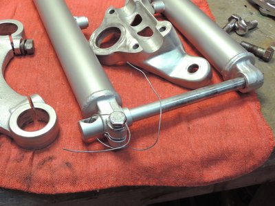

OK, more seemingly small details, (actually the fun part of the project). The little Ace 100 forks are shaping up with paint and polish along with safety items. In my early days of racing an Ace 90 the axle pinch bolt backed out releasing the front axle to also back out at the worst possible moment in a fast corner putting me on my face. No serious injuries but lessons learned about pre-flight checks and/or poor maintenance for sure. Hopefully this will never happen again with proper torque and inspections along with safety wiring. It seems I always learned the hard but effective way. :?

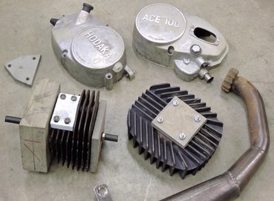

Beware of blast or Prepare for blast is the phrase I'm looking for. Anyway, blast masking done on some sub assemblies and I'll soon have the prototype finish that I like. The cylinder will be black but there's lotsa baked on crud. The blaster is at the local body shop that I use and I'll consult with them on removing dents in the pipe. I've been working on the fragged combustion chamber on the Webco head and I think it's saved. I might give this thing a chance. Onward. 8-)

hodakamax wrote:OK, more seemingly small details, (actually the fun part of the project). The little Ace 100 forks are shaping up with paint and polish along with safety items. In my early days of racing an Ace 90 the axle pinch bolt backed out releasing the front axle to also back out at the worst possible moment in a fast corner putting me on my face. No serious injuries but lessons learned about pre-flight checks and/or poor maintenance for sure. Hopefully this will never happen again with proper torque and inspections along with safety wiring. It seems I always learned the hard but effective way. :?
Reporting,
Max, wiring that pinch bolt reminded me of my desert riding days on my '71 Husky. No matter how tight you tightened the rear axle nuts on that bike, they would eventually vibrate loose. Once, after finishing a 100 mile h & h, noticed that both nuts were missing and the chain being the only thing holding the wheel on. Whew!! After that, the nuts were drilled and wired on.

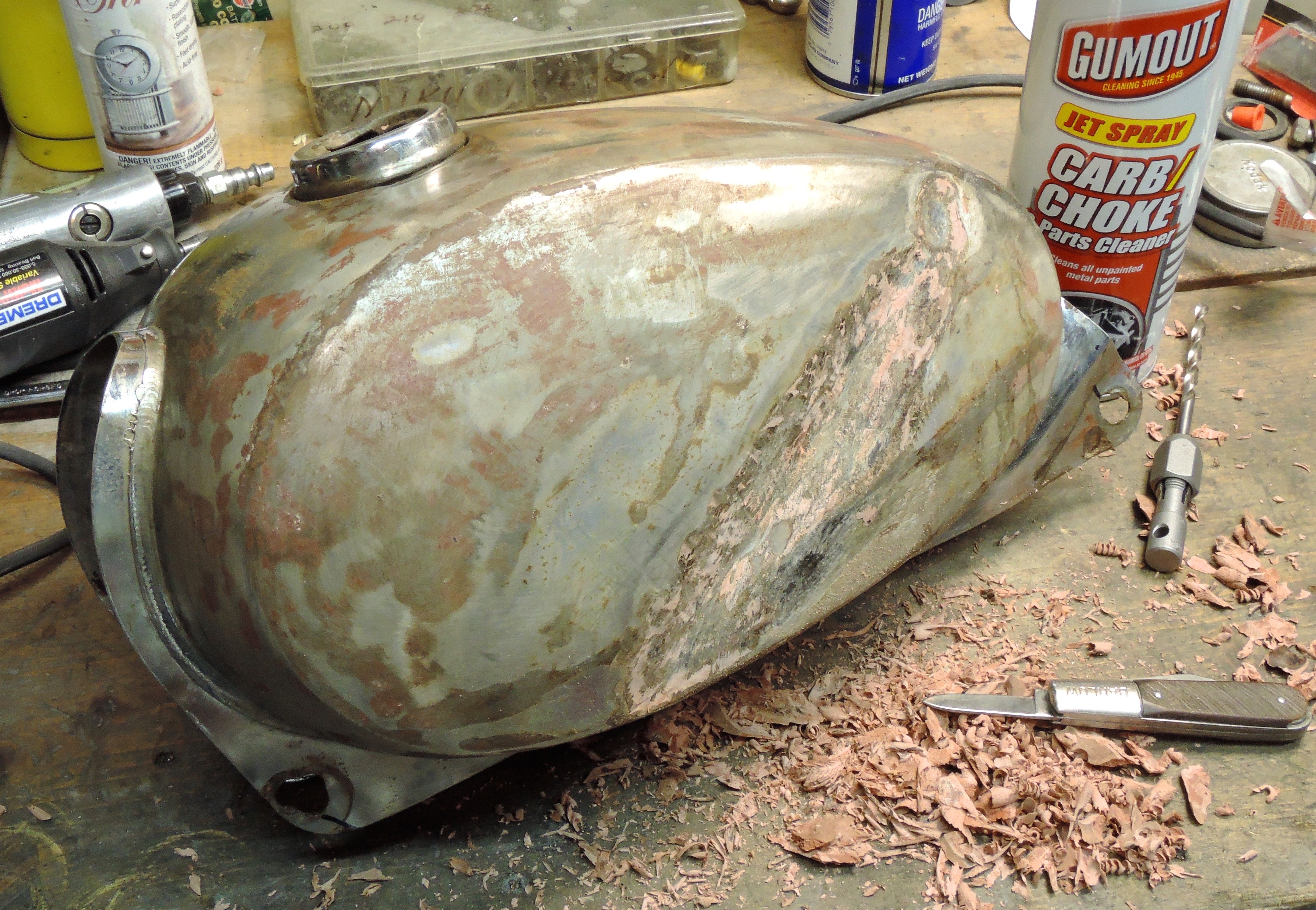

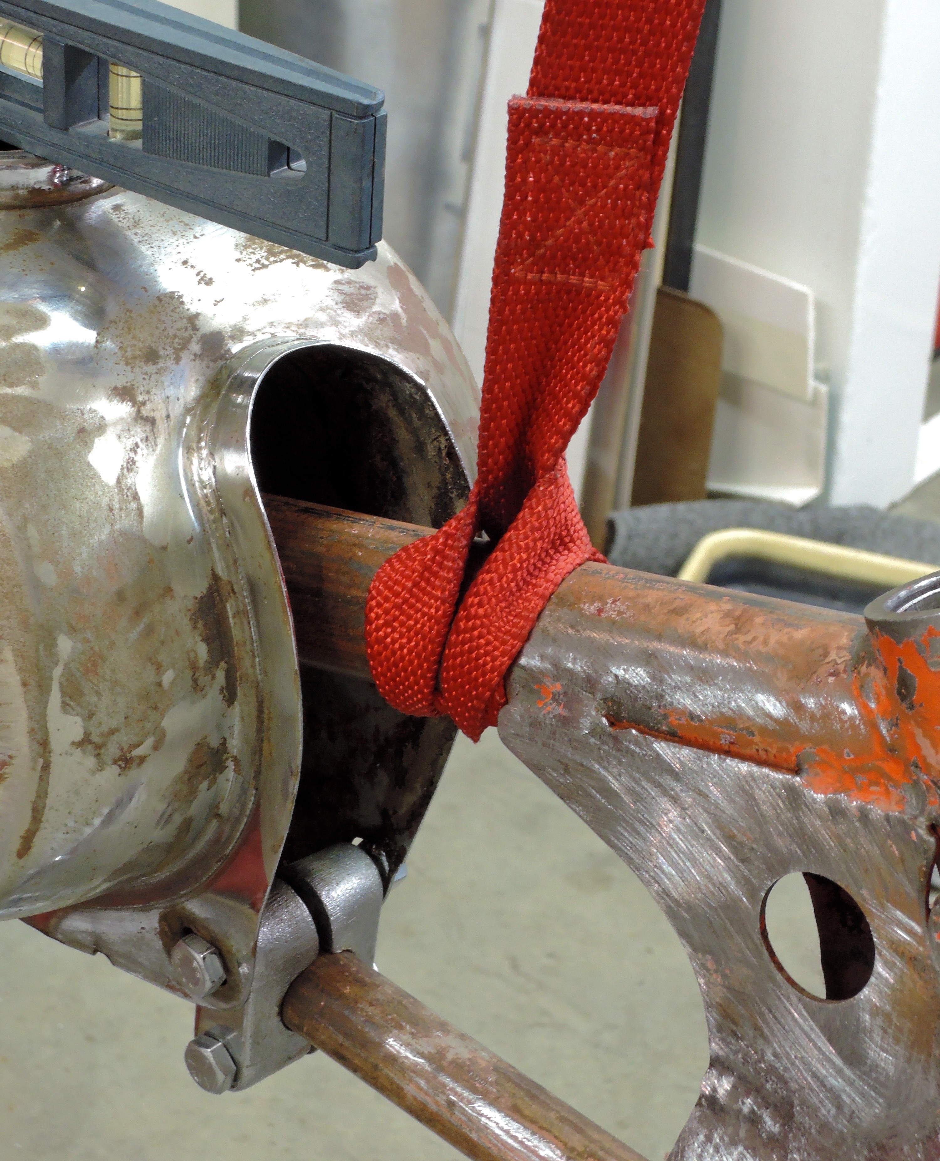

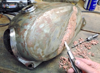

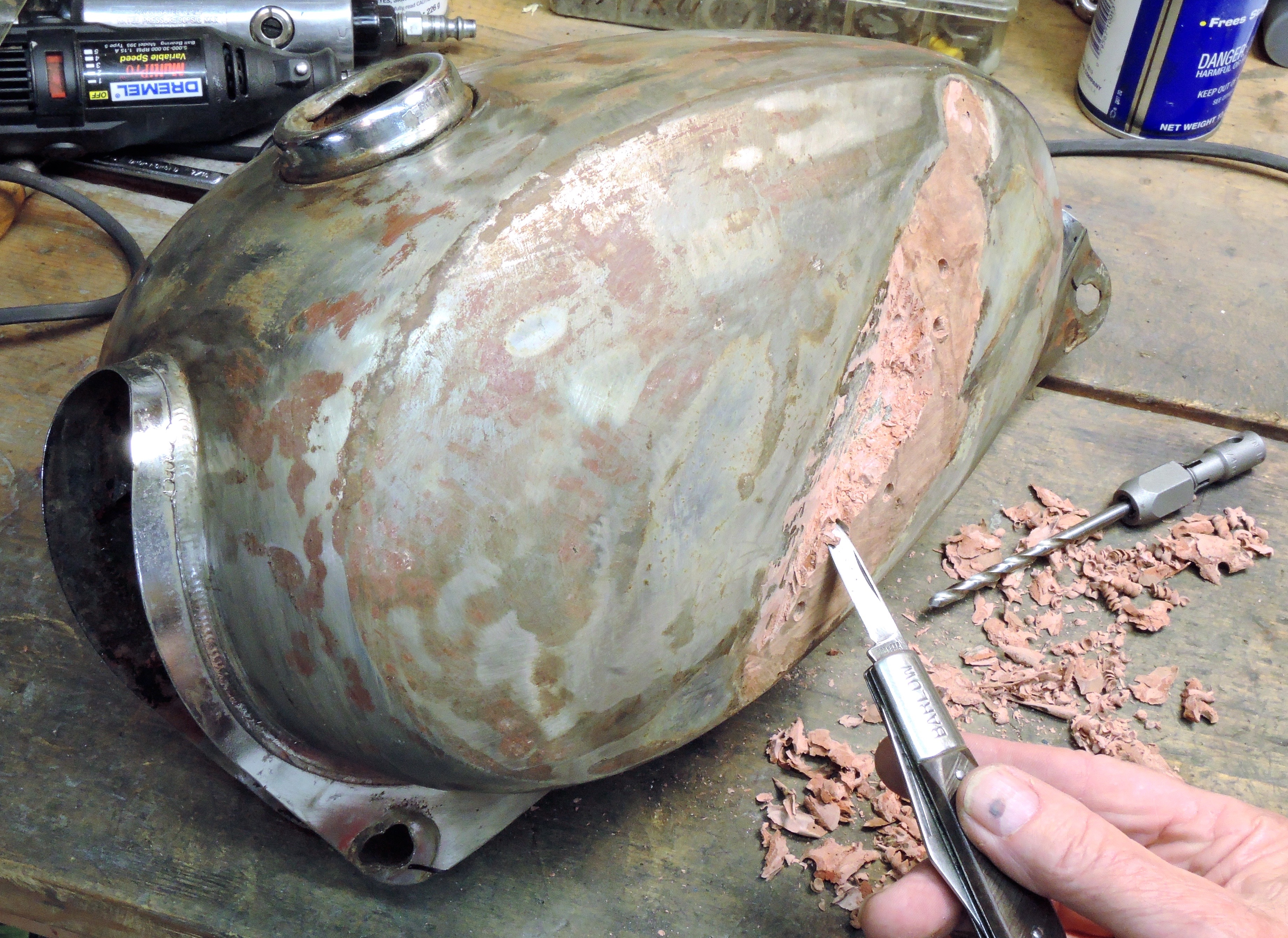

Some small steps accomplished on the project yesterday, one being the stripping of the tank. I see why they painted the chrome tank as there is a large clunk of Bondo on the left side. I'll also take it to the body shop along with the pipe to see if they can improve the situation. There's no reason to reduce fuel capacity with heavy Bondo. :roll: I was trying to figure out how to mount the front of the tank when I noticed the old handlebar clamps on the floor beside the bike. Perfect! The right height and adjustable front to back. A bit heavy for the overall plan but good for now. Aluminum would be better. Hey! it all adds up!

Ouch. More dreaded previous owner work. A hand turned bit depth test reveals about 1/2'' Bondo depth. Ugly. Again, this can happen on a $65 motorcycle. :shock: Onward still. Remove the filler and pull the dent as best can. Definitely not a candidate for re-chrome. Another challenge to keep the historic tank on it. We'll see.
Record Bondo depth for a motorcycle tank.
Re: The 2 the Max Project
You might consider getting a paintless dent puller, aka "pops-a-dent" from your local WallyWorld or AutoZone. About $20 and won't last decades, but for our use it's OK.
Google for info.
What do you think, Maxie? That looks like a crease - tough sledding for a dent puller. Maybe a cut it out and blend in a welded patch situation? A surprise at every turn, huh? That makes the resurrection all the sweeter!
Hey guys, thanks for your info and sympathy! The body shop lets me use their blaster so it's the least I can do to to give them some business rounding out the tank. A skim of Bondo will be OK compared to the whole quart! I think we can save it. One more shot to show the fun of restoration! 8-)

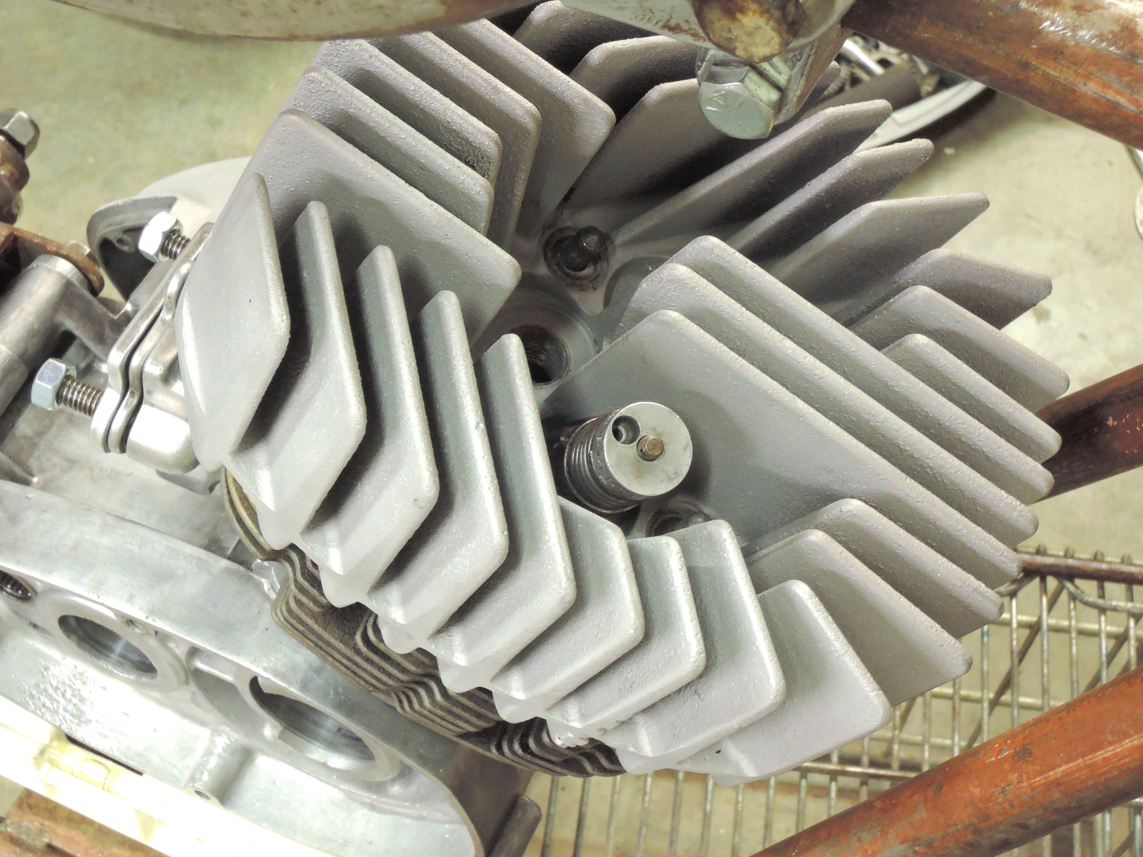

Nothing like blasting to freshen things up. The mock-up is looking much better. I even blasted my optional 93 Rat head. The pipe is at the body shop to be assessed on how to proceed on dent removal. Most of the dents are in one cone. We might have to build a new cone. We'll see how he does on the pulling. The fork tubes are at my friend's machine shop for truing up. Lots done today or at least moving.

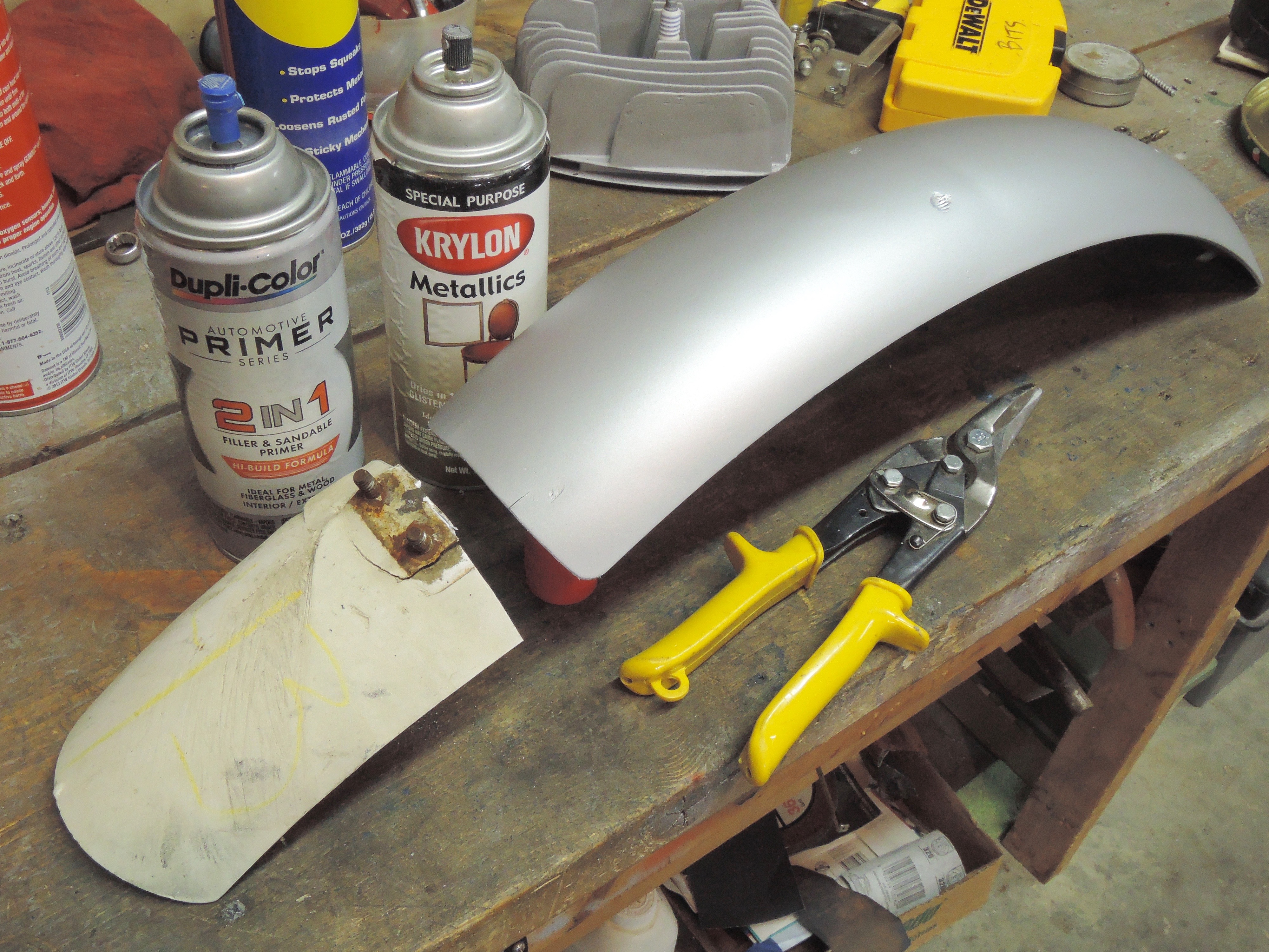

Man, this project is addictive. I'm trying to be responsible but every time I walk by this thing I'm distracted. I keep trying to sort out useable stuff and end up rebuilding it. The fender is an example. I will need a short fender on the back and rather than throw away stuff, I re-cycle it so to speak. I also rebuilt the compression release and rethreaded the head. I had to plug the hole with something. I'll try to be more responsible tomorrow I always say. 8-)

On your top pic above with the repurposed fender. The plder BMW "/2" had a hinged section on the rear of the rear fender. Made removal.pf the rear tire easier.
Not suggesting that you need to do this, it just caught my eye.
