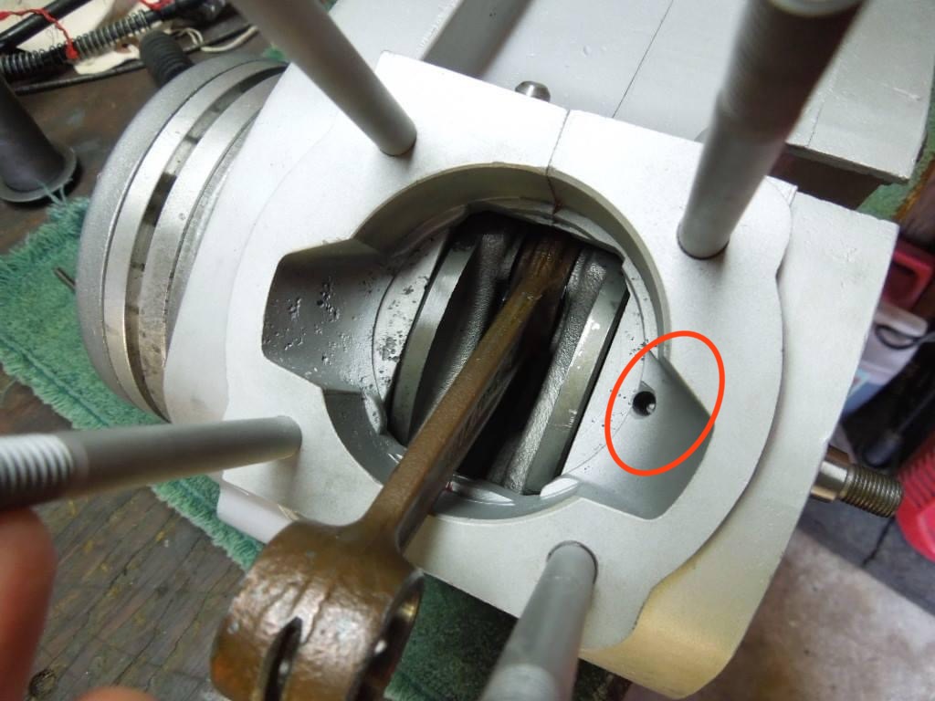

I’ve been running my 03 with injection for years, with many rides under our belt. The only way to not run the injection on the 03 Wombat is to split the cases, modify the left inner case by drilling an oil hole for the main bearing.

socalhodaka wrote: Mon Apr 01, 2024 4:49 am IMG_0955.jpeg
Photo by Danny Cooke
Wow.....thank you so much for the tip.
Is there more info about the hole?....diameter?....angle of drill?
Posts: 926
Re: Metallic sound
I think about a 1/8. Here’s a photo from the FB group.
