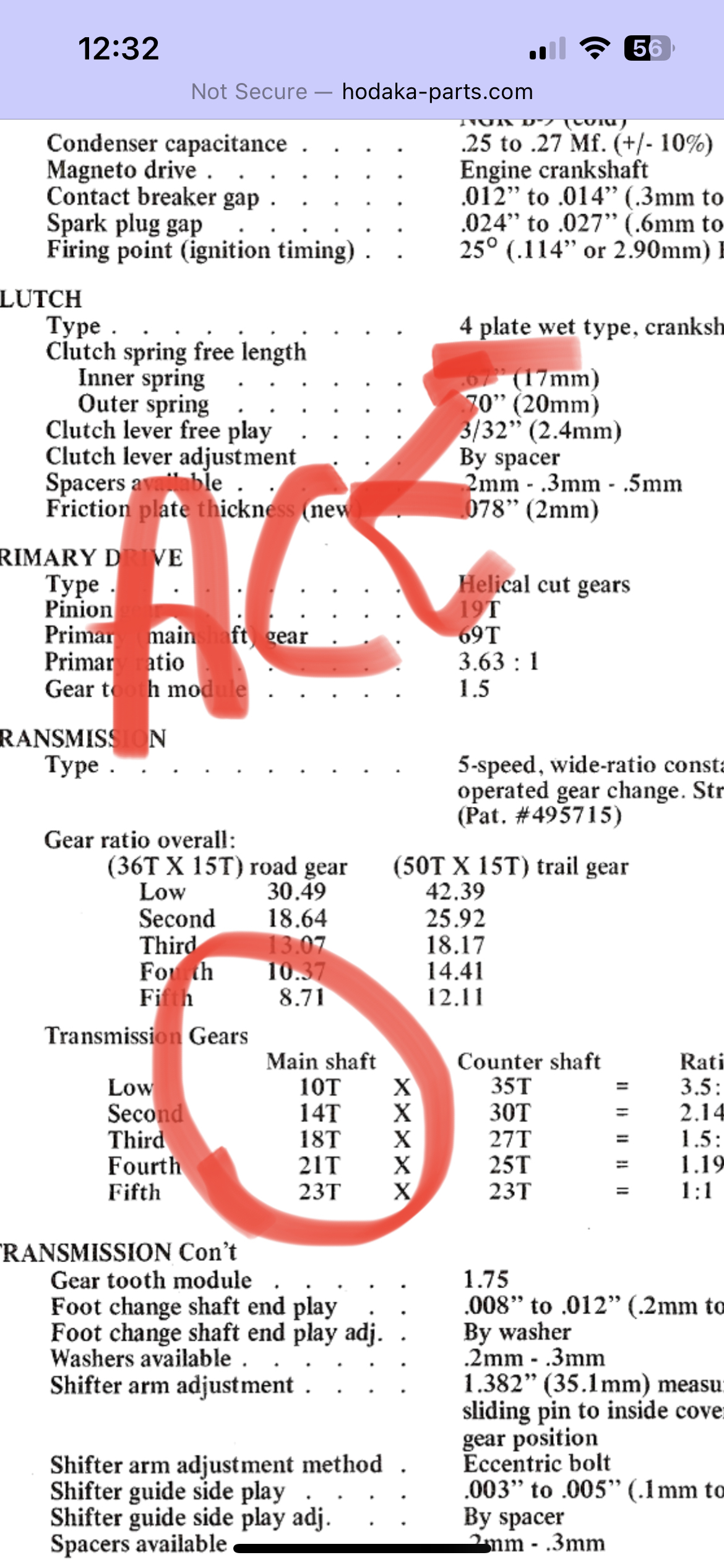

We were comparing main shafts because Alan asked me if the Ace & Wombat used the same main shaft. So I looked it up in Terry’s library. Ace & Wombat use different main shafts, which makes sense because the gearing is different.
Then I thought about the Dirt Squirt and told Alan since the Squirt has a Wombat tranny, per Ed & others in the past, that it should have the same main shaft as the Wombat. But, the library lists it as the same as the Ace. So, I’m guessing this is a publishing error??? Here’s the main shaft specs from the Hodaka-Parts library on all 3 models.
So I’m guessing this is a publication error and they published the Ace specs for the 96 Dirt Squirt? I haven’t opened up my Model 96’s yet. So confirmation would be nice.
So, does the 96 Squirt have the Wombat main shaft & gears or the Ace main shaft & gears? I’m not ready to pull one apart just to look & see.

Ed, minor error in your post. The part number for the mainshafts on the Wombat model 94&94a; the Dirt Squirt model 92C&96 and the Combat Wombat model 95 should be 944500. The Ace 100 models and the various model 93 Super Rats had mainshaft # 924500.
Victor, the spec sheet at hodaka-parts.com for the model 96 Dirt Squirt is the wrong sheet. It is actually the sheet from the Ace 100 B and B+ (look at the wheel sizes, etc.) The model 96 Dirt Squirt used the same transmission (1st - 5th gears) as the model 95 Combat Wombat. The Dirt Squirt did use a different primary gear from all the other Hodaka's. If you look at the parts diagrams it shows the correct parts and part #'s there.

OK. I thought there was a publication error. Not sure who brought in the 95? I thought the 96 Dirt Squirt had a Wombat bottom end not a Combat Wombat??? Clarification on that??? I’ll talk to Terry about the 96 Squirt library sheet. Victor

I did notice while on the Hodaka-Parts dot com website, that the first page of the Dirt Squirt (96) specifications - very near the top - lists that the specs are indeed Ace 100 specs. So, yes, publication error.

Yes, the "schematics" (Illustrated Parts List) is correct for the Model 96 Dirt Squirt - but the "Specifications" are not correct for this model.
