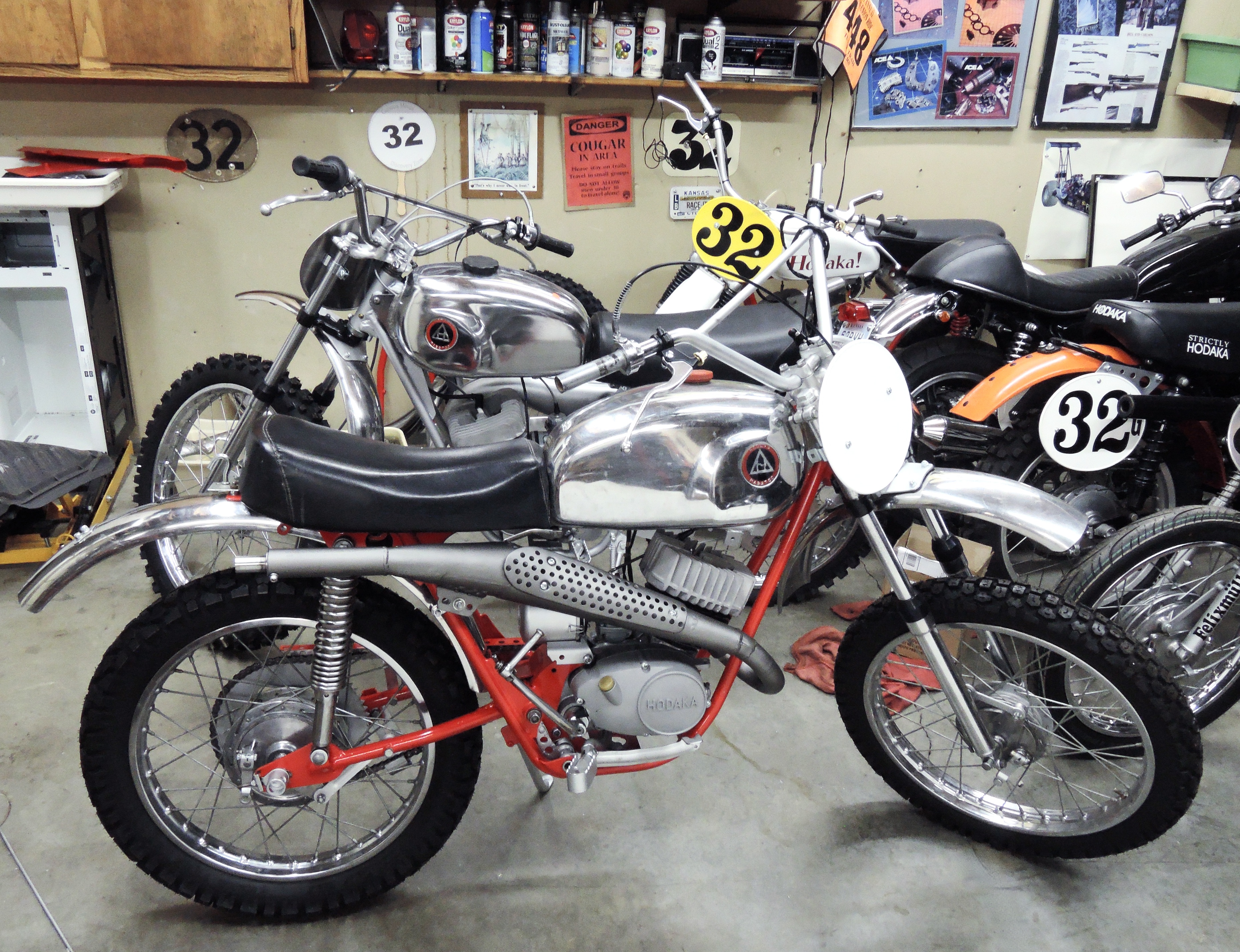

Been gone awhile but busy. #3 Hodaka project. Third in-line for restoration. Ace 100B+. Coming together with extra things and hand-me-downs from #1 and #2. Package deal, all from the same barn. Starting to look interesting and even fun. Has an engine but this stock Ace 100 E engine from #2 looks lower miles. Did a nice rebuild on this, bearing/seals, updated clutch parts, bore and new Wiseco piston. Vintage Webco head from the Hodaka shed. Ratty rat pipe. Had to weld together a new header pipe, muffler and mount. Fake titanium paint, who would know? New stump puller 64T rear sprocket for crawling around in the woods. Starting to remind of first Hodaka mods. New tires, chain and all that stuff. Starting to worry me with spring coming, I need to check this thing out in the proper habitat, tight trails. Looks like a hoot to drive. Optional engines to try but I’ll start here. Maxie

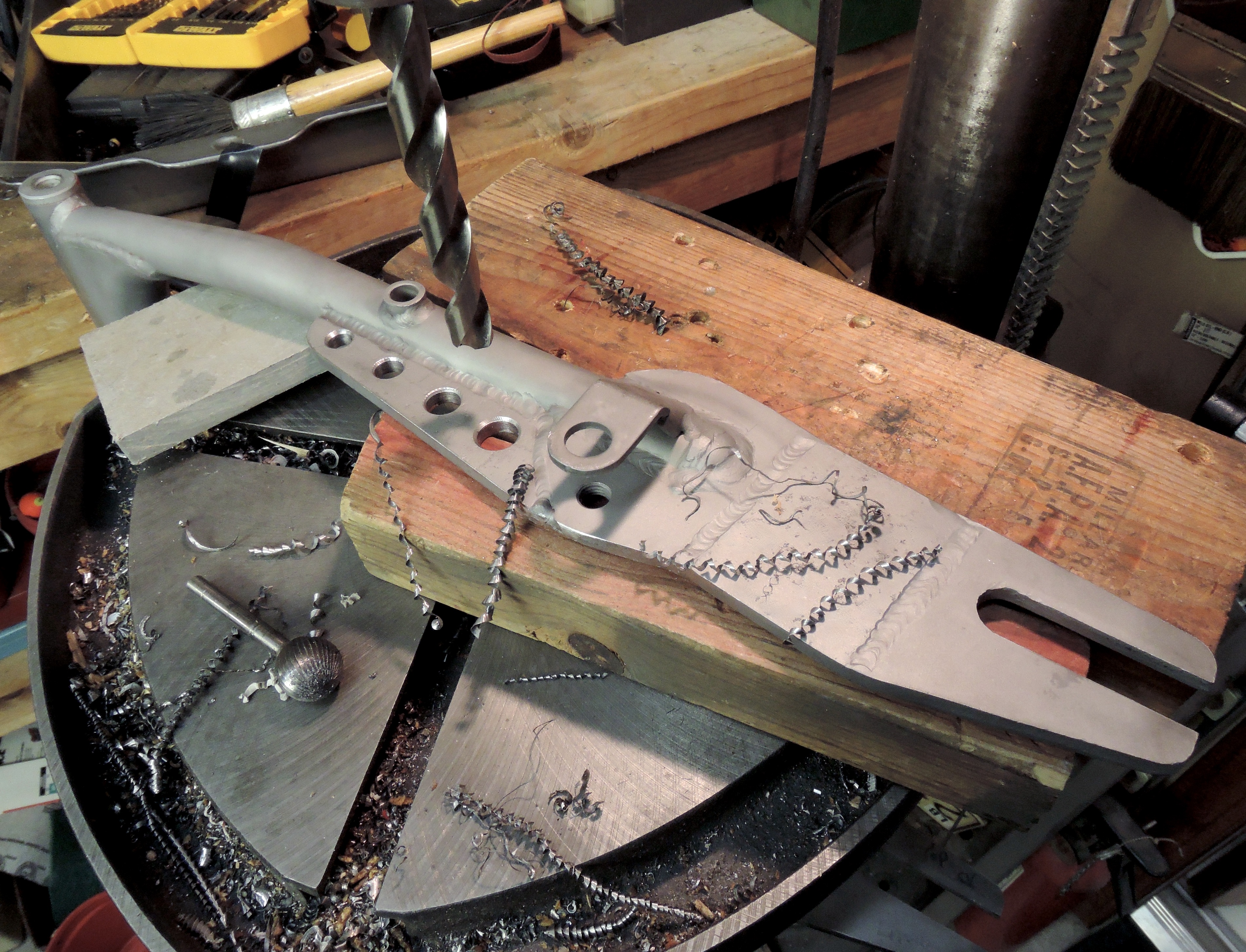

#3 is, well, third in line for restoration. Handy for a jig for trying things for the #1 project, also an Ace 100 B+. Last of the Aces but still just a bit short. Did fit a model 94 Wombat swing arm and with some effort, the conversion works really well, being longer and wider in the right places. Worked so good I took it off and installed it on the #1 Super Brat project. Now I feel guilty about #3 being shorter again. I'm now doing the old method of lengthening the original swing arm about two inches. Off to the welder guy for brace and a stretch.
Re: #3 Hodaka Project
Nice job at the weld shop, just what the doctor ordered!
Two inch extension and bracing.
My home-made chain guard you keep seeing looks, well, home made. Keeps me out of the chain though. Does wipe the tire but the back is open and I’ve done the mud thing enough times in life. This lengthened swing arm brace does add an attachment point and maybe I can get the mount down to one piece rather than two. Probably time to switch to an all aluminum assembly. Just a mock up but something that might work with some tuning and I did get the mounting holes located and drilled before paint. Something to fiddle with. A “we’ll see” thing. Forecast; 62F today. Onward with primer and paint.
Clever as always. Great problem solving here. Will you be able to go to a more aggressive tire if the mood strikes?
8-) Yes!
Max it looks good but the head is on backward, the air flow would bring heated air to the center of the head verses moving the hot air away from the head?? ------- Clarence
Joe Ormonde
Posts: 355
Post by Joe Ormonde »
That`s how I would have bolted the head on. The air gets pulled in and would get blown right out the back. It may be installed backwards from what Webco intended but I can bet the engine will run cooler the way Max installed it. I don`t want to piss anyone off BUT Webco Designed that head wrong and Webco Heads ran WAY hotter than the Model 93 Head and made less power. The ACE90 Race Head was also better than the Webco stuff. Webco heads look FANTASTIC and that`s all. Sorry. The truth is that some aftermarket Parts are not as good as the Factory parts are. Joe
Posts: 2222
I would bet the head would run cooler turned around but i would only bet a quarter .25 cents It looks best whatever way max installs it. They are a cool looking head, but I agree with every thing Joe said about the Webco heads. There were other some great after market items that webco manufactured, like the cush hub for the ace 90. We like what we see Max! ------------- Clarence
Don't want to streamline a head so the air goes around it. Most holes to the front. Scoop all you can in, at least if you are going forward. Clarence is plenty clever and I thought he might be pulling my leg as he sometimes does or worse might be right. Worried me enough to look up some old advertising pictures 'cause I just hate it when he's right and I'm wrong. Whew, looks like I have it right. Probably makes no difference sitting still and I rarely roll that far backwards. Maybe once. Maxie
