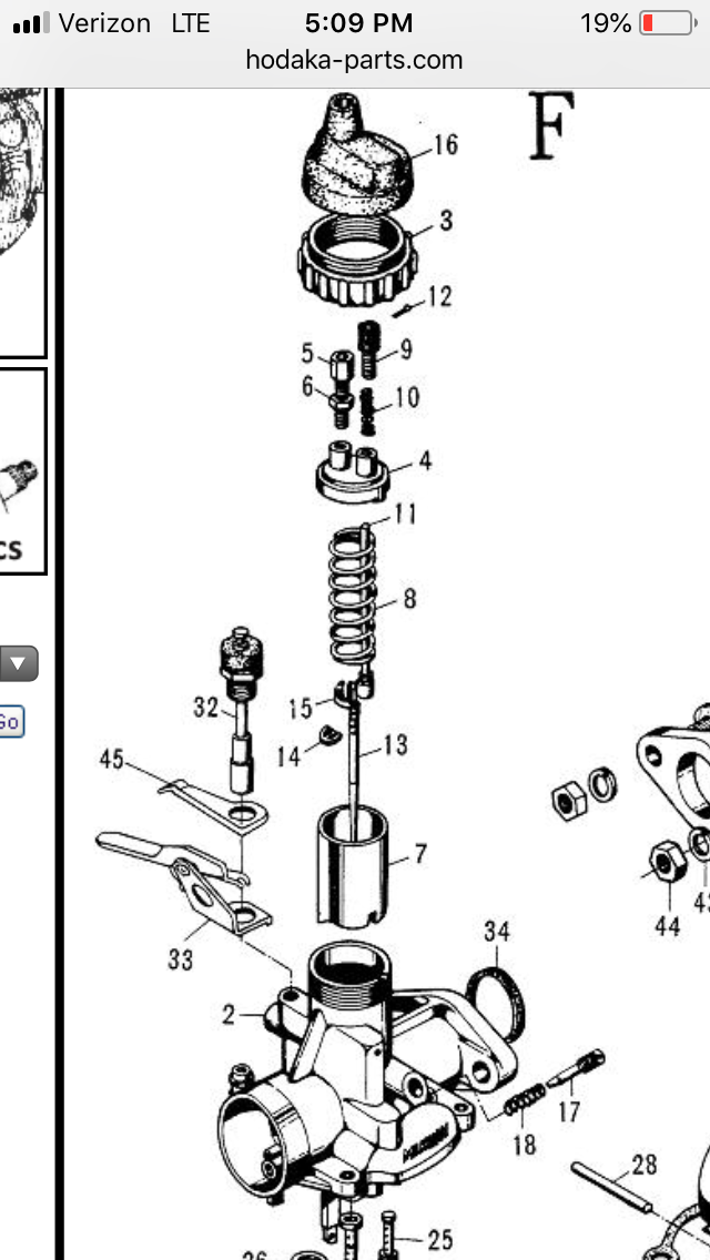

Hello everyone! I’m working on this new to me Ace carb, a stock VM20. Most of it was there but not all.
I put in a stock size 95 Main Jet, & it has a stock #25 pilot jet. I also had a couple of really nice 20mm 2.0 stock slides. It was missing the cap & spring, #5 the throttle adjuster, all of which I had in my carb parts box!
But I’m still missing #9 the throttle adjuster, #10 the throttle adjuster spring, #11 the throttle bar, #12 the cotter pin, #13 the jet needle #4F6, #14 the needle clip & #15 the needle jet spring seat.
Is there anyone out there who has these parts they can spare? Condition usable is all I ask, so I can rebuild this carb to specs! I can also offer a swap for something like carb floats, main jets, other size needles, VM 24 bowl gaskets, etc. for VM 24 carbs and some spare slides as well!
Let me know if you can spare any of these parts. Otherwise it’s probably better for me to purchase a complete used carb. These parts will run around $35 plus about $7-10 shipping to buy them new, IF they are available in stock!
Let me know! Thanks! Victor

Victor, thanks for your offer, but the original owner had cobbled together a reed-valve set-up with a 24mm carb, but the cylinder was no good. I have an original cylinder/head/manifold and need a carb to match up. The part that Al mentions may be just what I'm looking for, if I can figure out how it mounts. (I'm getting old. Can somebody please draw me a picture) lol Thanks, guys.
