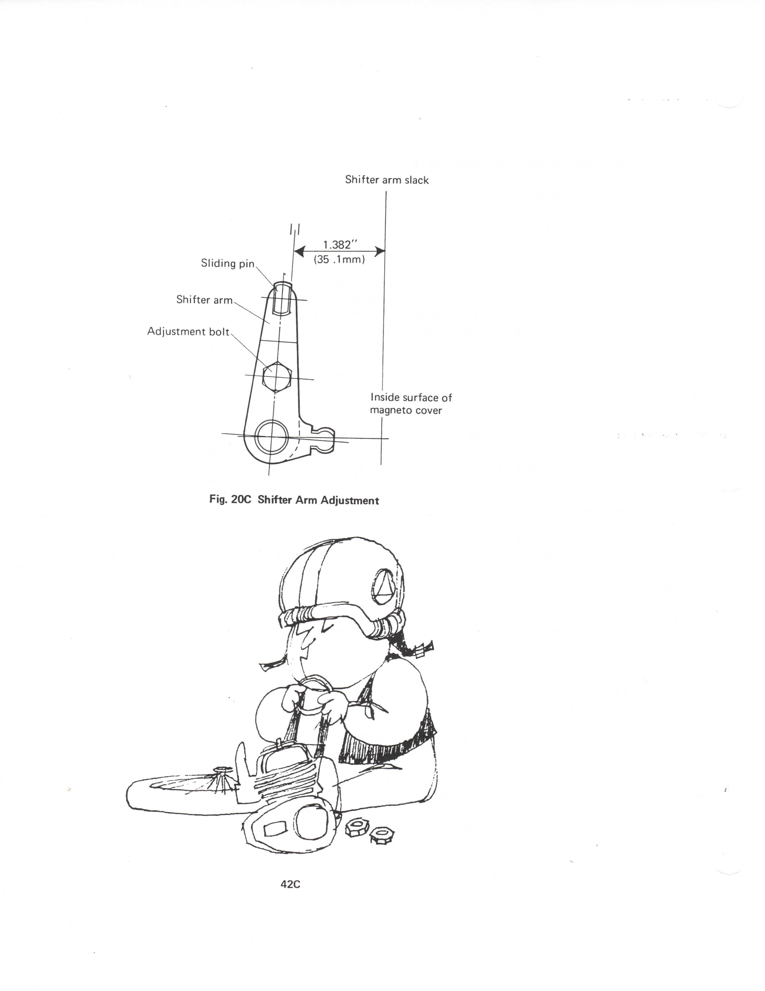

You might take a look at these attachments from the Ace Workshop Manual.
Remove the little inspection cover where you can adjust the cam screw.
Take the sheet metal dust cover off the case by removing all those little screws and set the shift cover it on a flat surface.
Flat surface like a Glass plate, piece of smooth marble or granite tile from Home D, or something you think is quite flat.
Make a block that's 1.382 tall by maybe 3/8" thick.
See how that gage block seems to fit when shifter is in Third Gear.
I made a block out of wood and measured it with the cheap Harbor Freight type calipers. Not great, but a start.
The trial and error method is on pages 67 and 68 of the work shop manual. If you don't have a manual you will probably be best served by getting one.
If you can't work out the problem with these two methods you may consider taking the shift mechanism apart and looking for the worst worn components.
One last note, if it shifted ok before, it should be able to do so again.

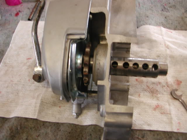

Well I removed the control shaft, springs and ball receiver today. Photo shows that Ed, (and others) were right on the money.
I'm ordering the kit from Paul tonight. Hoping he has the space age set in stock.
I notice a groove in the ball receiver where the engagement balls ride. Is this wear or is this the way they are?
I'm pretty certain I have too much play between the sliding pin and the arm as well. I want this bike to be a good runner and reliable so I'm going to order one of the repro shifter guide arm assembly as well.
Anything that I need to order to swap out the guide arm?
thank you.
Ken

Re: B+ shift adjustment
Looks normal, the ball receiver is starting to wear very slightly, I'd use it. There's a couple of spacers that you can order to tighten the shifter arm, # 90202502 and 03. You're on the right track!
Like Max, I'd be perfectly comfortable re-using the ball receiver. Note that it has a slight "groove" (shallow valley) around the middle as part of the design.
Yowee, that one spring is really collapsed! But you are now on the right track. New space age springs and spiffing up the shifter mechanism and you'll have it shifting great!
PS: When you get it together, snick those shifts. No "stomp and hold". No.

Spring kit is in. If I had any notion of doing this job more than once I'd spring for the special tool, (pun intended
Now onto installing the new arm. On disassembly I removed the slot headed bolt that retains the ratchet spring. I see now that I didn't need to do that.
So first question --- How tight should that bolt be? I suspect only tight enough to retain the spring in place but not bind the spring arms?
Second question --- What is the trick to opening the spring to allow the ratchet shaft key to drop in place? Do you pull the spring arms open with some sort of home made bent hook tool?
thanks once more!
Ken

No special tool required. It is a feel thing. Start the shaft down into place. Apply pressure down and then turn the shaft first in one direction and then the other while keeping that downward pressure. It doesn't take much pressure nor side to side movement and it will drop into place.relic wrote: Second question --- What is the trick to opening the spring to allow the ratchet shaft key to drop in place? Do you pull the spring arms open with some sort of home made bent hook tool?
thanks once more!
Ken
Hey Ken, I'm impressed that you got the shifter spring clip on without the special tool. Bravo! As for the screw it screws tight into the case. The head is only a spacer for the ends of the spring. Tighten the screw in the case and then spread the spring over the head. Then it should be spaced enough to slip the key in as Dale says.
That makes sense. The head of the bolt spreading the spring a touch will help. Off the to garage to give this a try. (before the locktite sets up on the bolt).
Ken
